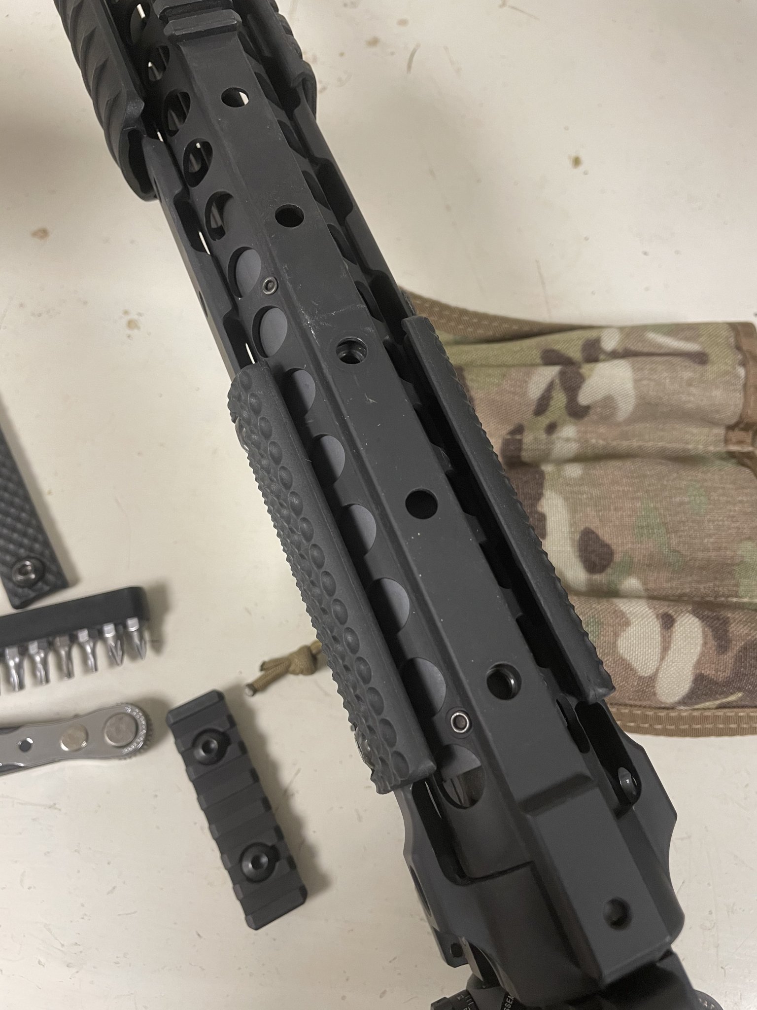

deersniper Protecting the Sheep Banned ! Minuteman Feb 22, 2007 13,711 19,962 Northeast Aug 28, 2022 #1 Aug 28, 2022 #1 Anyone know an arca that will fit this ? 8” would be perfect I have the screws ans nuts that fit
charnicus Major Hide Member Full Member Minuteman Supporter Oct 29, 2018 2,078 1,269 Mos Eisley Aug 28, 2022 #2 Aug 28, 2022 #2 I would think you could run a universal plate. Reactions: deersniper

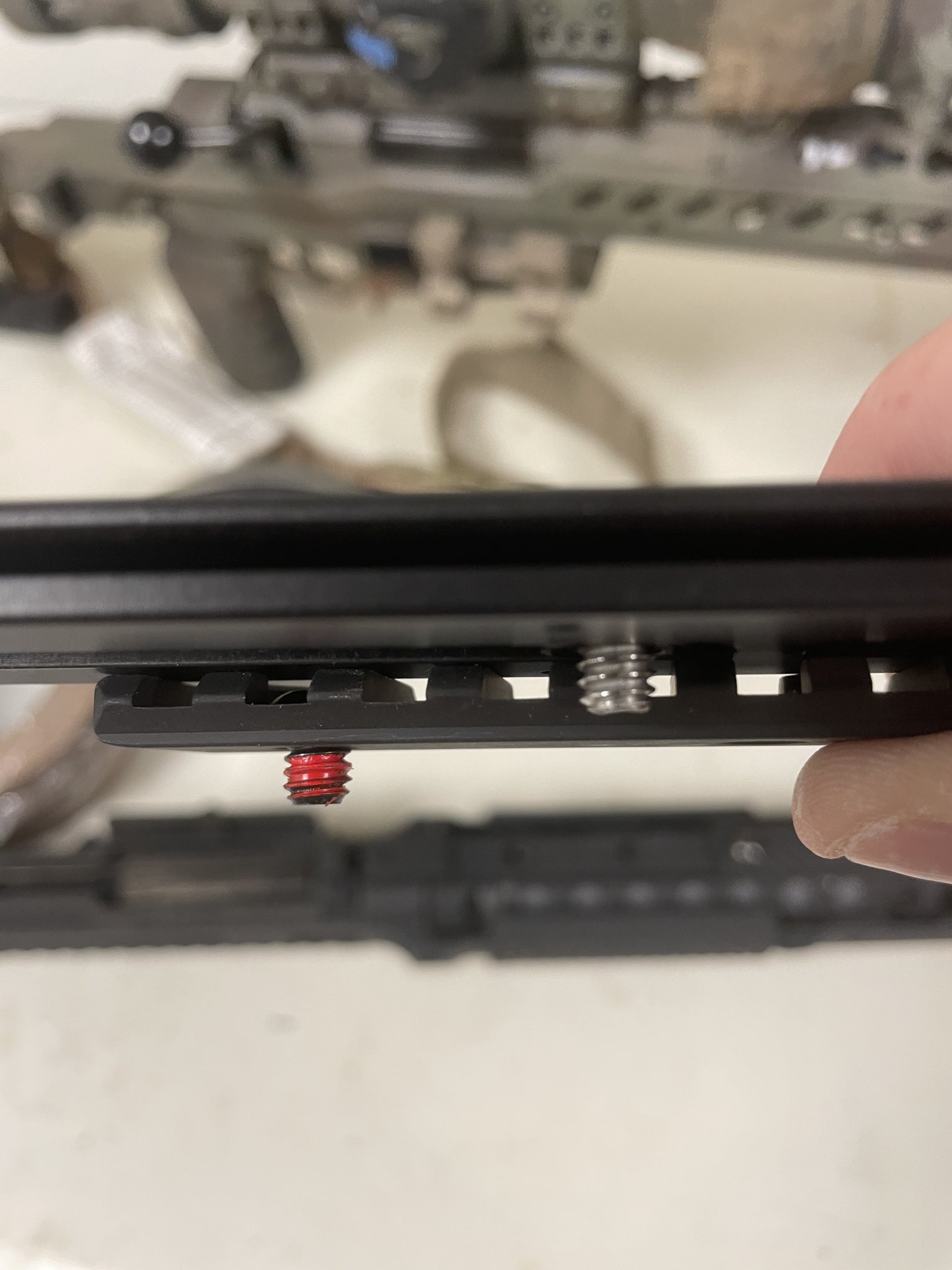

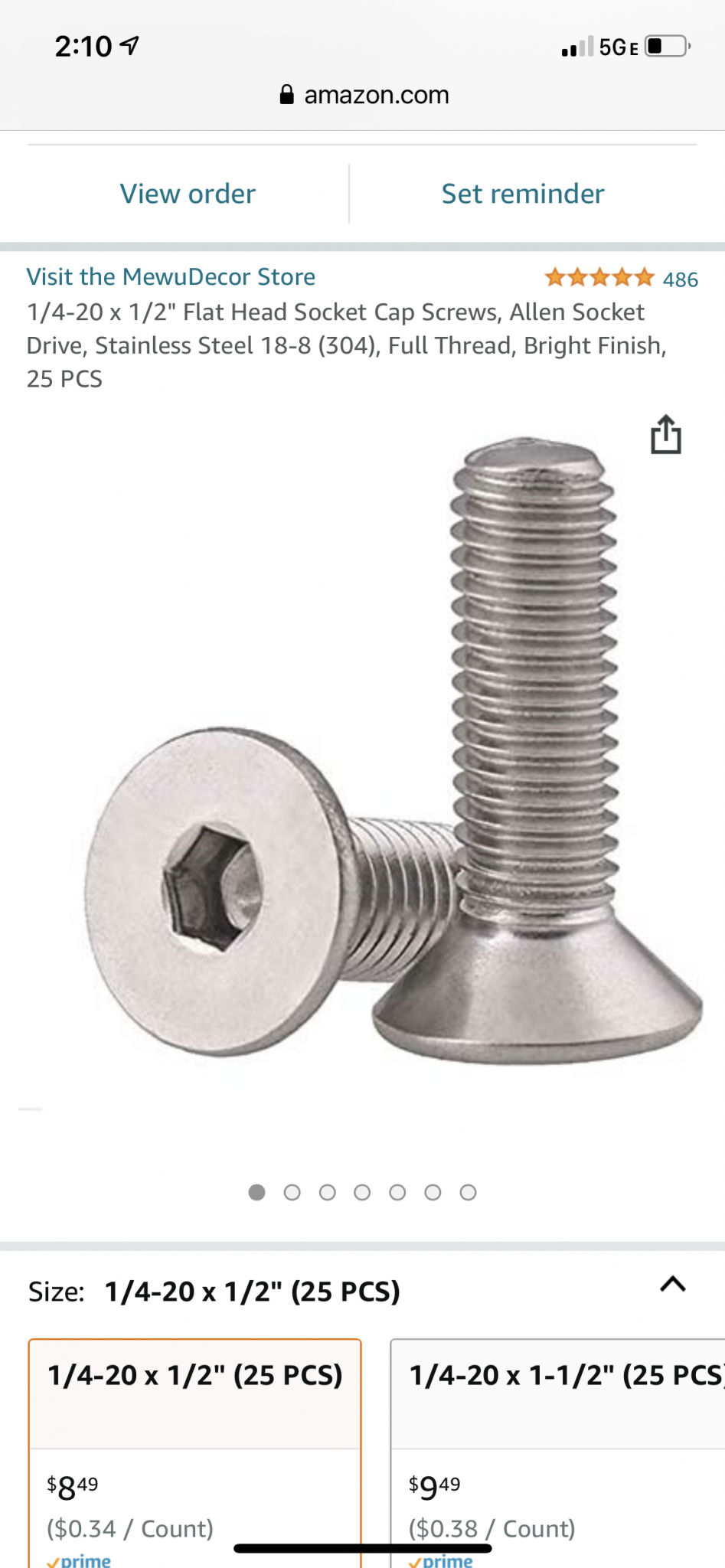

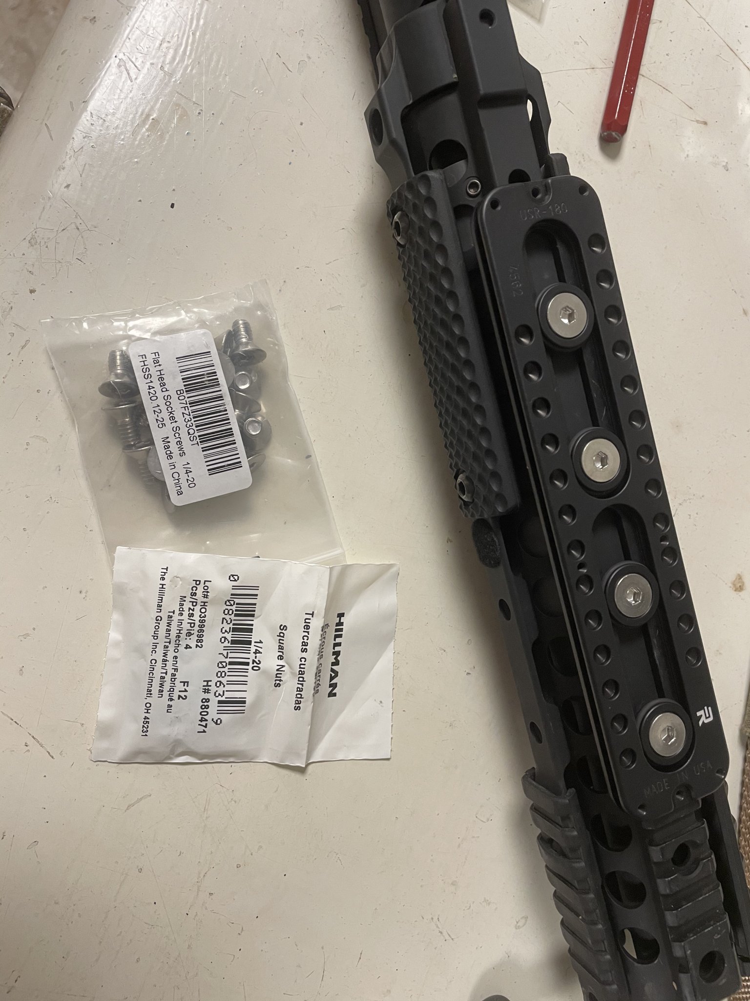

deersniper Protecting the Sheep Banned ! Minuteman Feb 22, 2007 13,711 19,962 Northeast Sep 11, 2022 #3 Sep 11, 2022 #3 Got it done thanks. For anyone else looking Used a RRS universal rail 1/4-20x1/2” bolts Reactions: LV Precision
