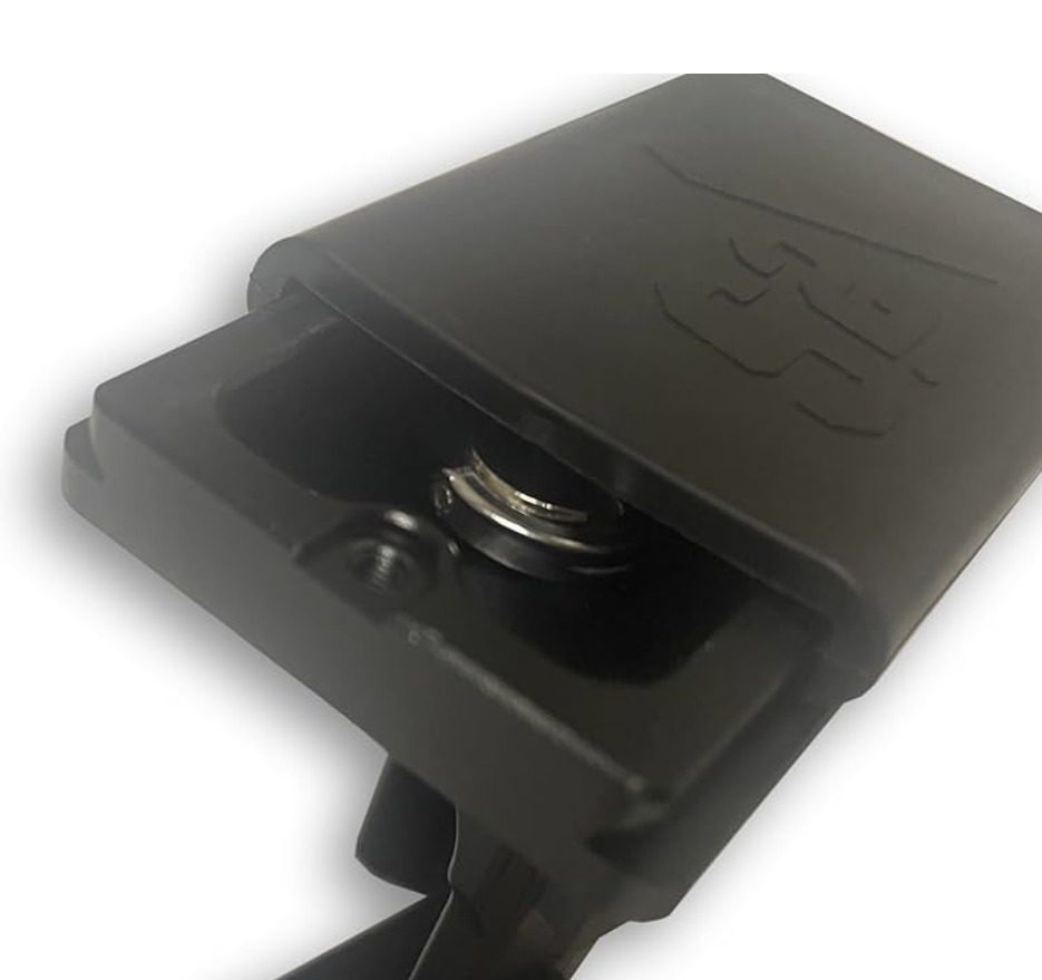

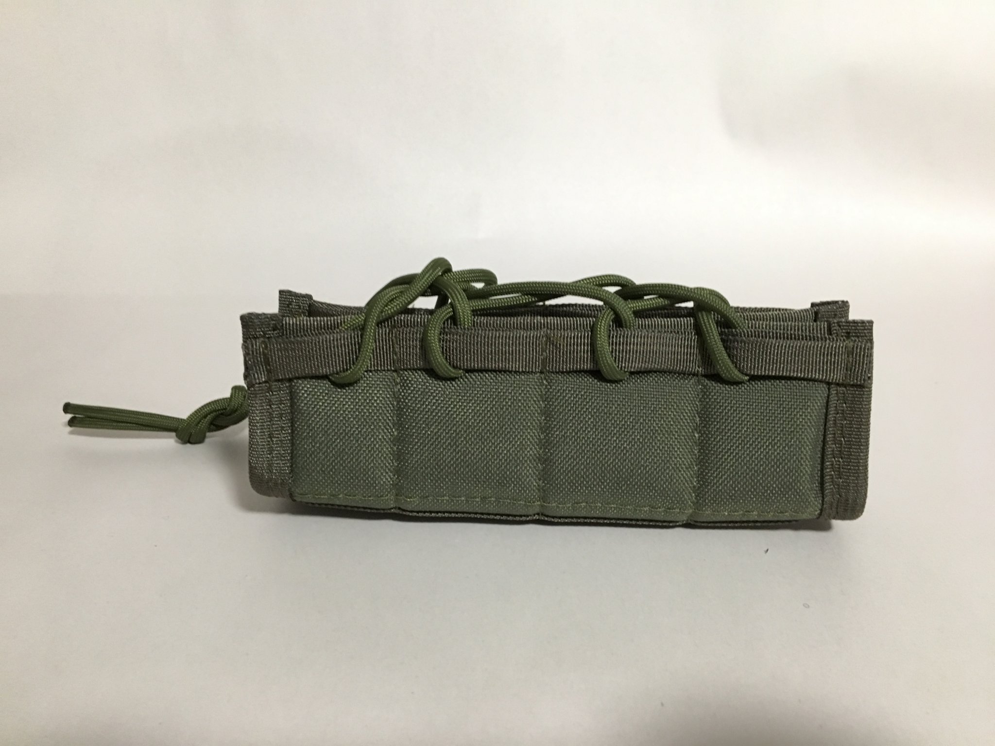

    Anyone make one like this. Ideally able to be peeled off like the magpuls. Maybe we should petition magpul
    I think you are on to something about there being a need/demand for it. KMW also talked about unprotected arcas forends on work guns tend to get wrecked (this was in the KMW chassis thread).

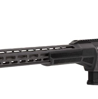

    AFAIK, SIG makes one for the cross , it hasn't been released yet to the public, but there are pics of it online. (1/2 cove for its gen2 arca rail forend)
    I could print these.
    As you can see in the sig cross, they need to be make specific to the gun, or else it'll stick out and be funky.
    Get me forends and it can happen, and not at the quality you think of from typical printing :)

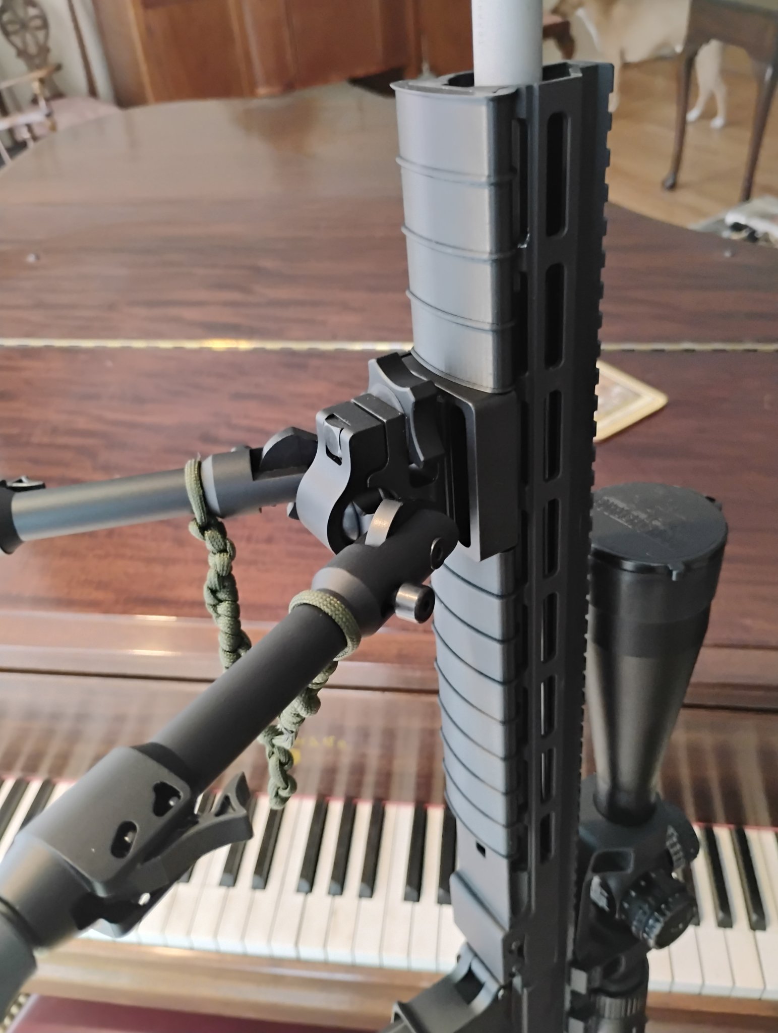

    Would they be flexible to pull off. ? Instead of slide off.
    So bipod can stay in front. Pull off a section of cover to slap tripod on ?

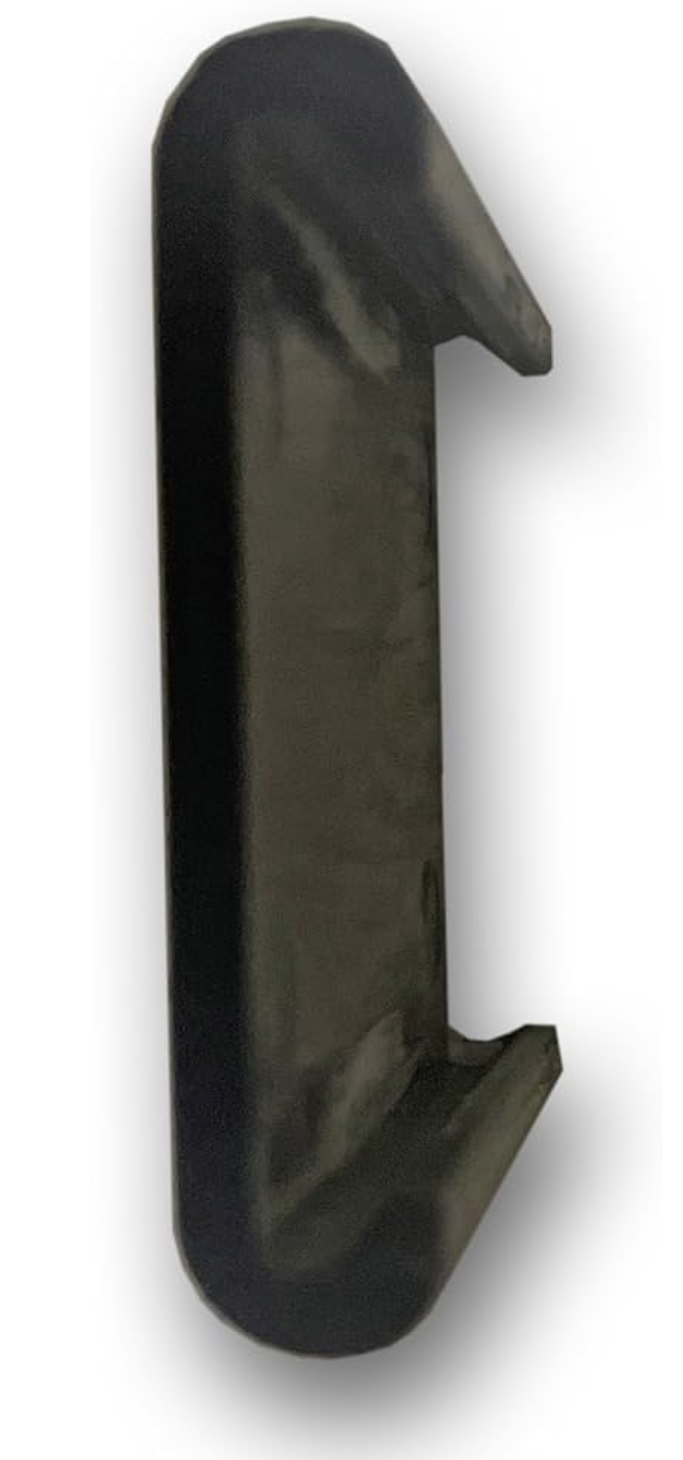

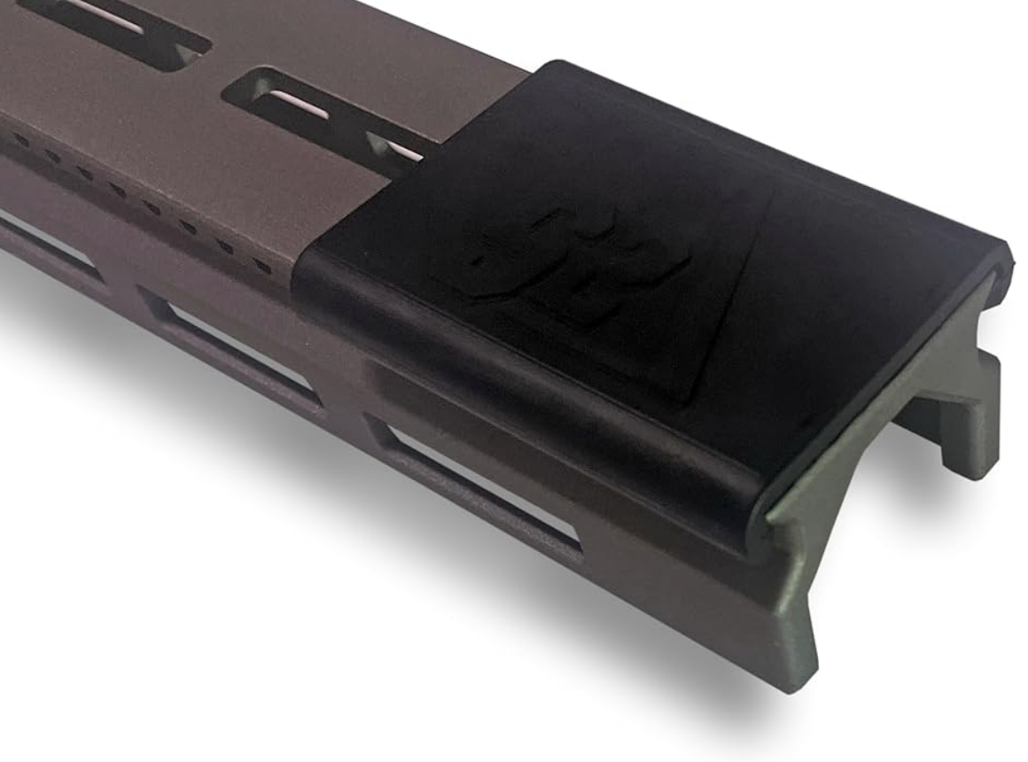

    So, some time ago I bought the Amazon one here
    • Really only works if you slip it on vs snap it on (but I knew this going in)
    • But it’s extremely stiff…can barely slip it on, and removing it is even harder
    • The fatal issue for me is that it doesn’t really even improve comfort. It has a too narrow side profile.
    The KRG W3 aluminum Arca forend gets it right, and its cross-section profile is what dudes who are designing these things should copy.

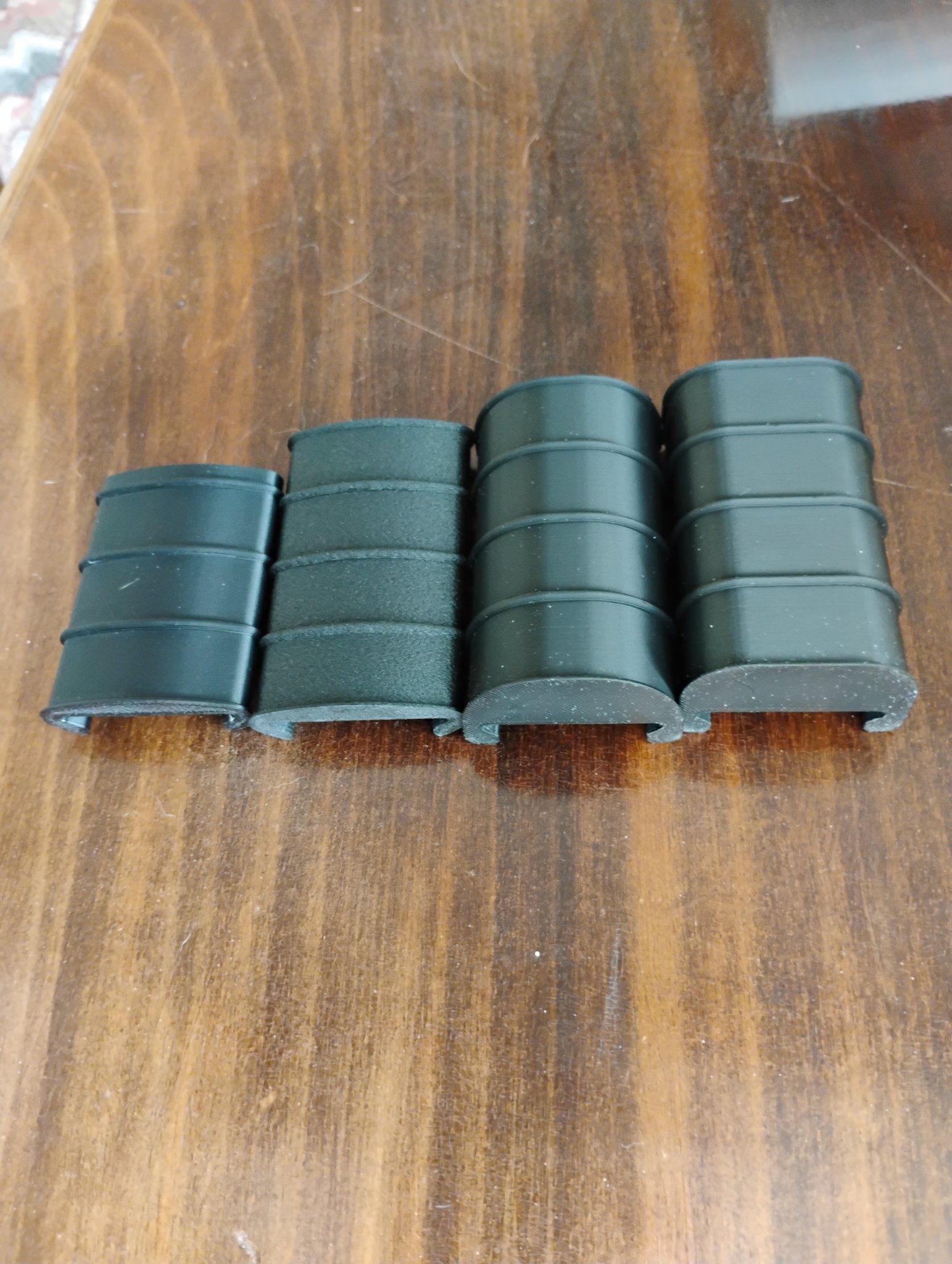

    I can ask my associate doing the cad drawings if he can make a set that works with the krg forend. I think that if we just take a small amount off of the top where it wraps around the dovetail, our current design will probably fit great. Would you prefer something with a more rounded profile, as shown 3rd from the right in my samples photo? I may be able to get you a prototype set to try out.

    And it’s not enough to just have a small radius curve like the S2Delta ones that I bought from Amazon (below and linked above in my prev post). That hurts too.
    These S2Delta covers above are painful. And I can barely remove them, but that’s a different story.
    Perhaps your right two designs (below) would not hurt, but see that u-boat profile?
    I’m a little sketchy on the far left one and maybe on the second to left too.
    I don’t think you need to make the covers so vertically thick, but I suggest you extend the cover up past the Arca onto the side of the forend (where the KRG bump is).
    That might give you some other fitment issues, or it might not. You could make a design for AR’s, which are among the worst offenders for Arca pain, and experiment with designs for flat-bottomed chassis rifles.
    Consider user-mouldable material for other use-cases. No idea if heat-mouldable kydex screwed to an Arca cover (made of some other material) would be an option.
    Edit: I think the “ribbed for pleasure“ things on your covers are not going to be that useful outside of some AR bros that are obsessed with pulling the gun into the shoulder while shooting offhand. In fact, those might hurt as well, especially when shooting in the cold (I’m in MN).
    When it’s really cold, even with thin gloves, crap that you don’t even think about when it’s warm starts really mattering. Ever catch a hard-thrown football with cold bare hands when it’s even mildly cold? Like 32°F?
    Your damn hands feel like Thor smacked them.
    I guess you could use one of your two thick designs (far right, above) and route out a KRG-like finger groove on each side. It would give you a less integrated looking design but it would fit whatever stock you put it on.
