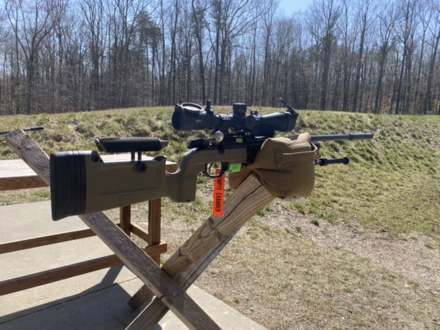

On my KRG Bravo for my T1x, I put on a 9.5” KRG Arca rail.

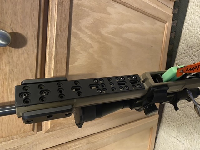

I purchased a Nelson Precision 12" arca rail for one of my bravos. I was disappointed when I figured out it covers up the front action screw. Means I would have to remove the rail every time I wanted to remove the action from the stock. Seems silly they don't update their design to fix that. I emailed Nelson Precision pointing this out. Haven't heard a peep back from them.
I did hear back Nelson Precision. They said I'm the first person to bring this concern to their attention. They said a redesign is possible in the future but not sure when they can make time to get it done.

Drill a hole?

I almost did. But I decided to give a spigot a try instead. I’m getting lazy in my old age and am gravitated towards plug and play designs. Plus I’m tired of bubba-ing my stuff.
