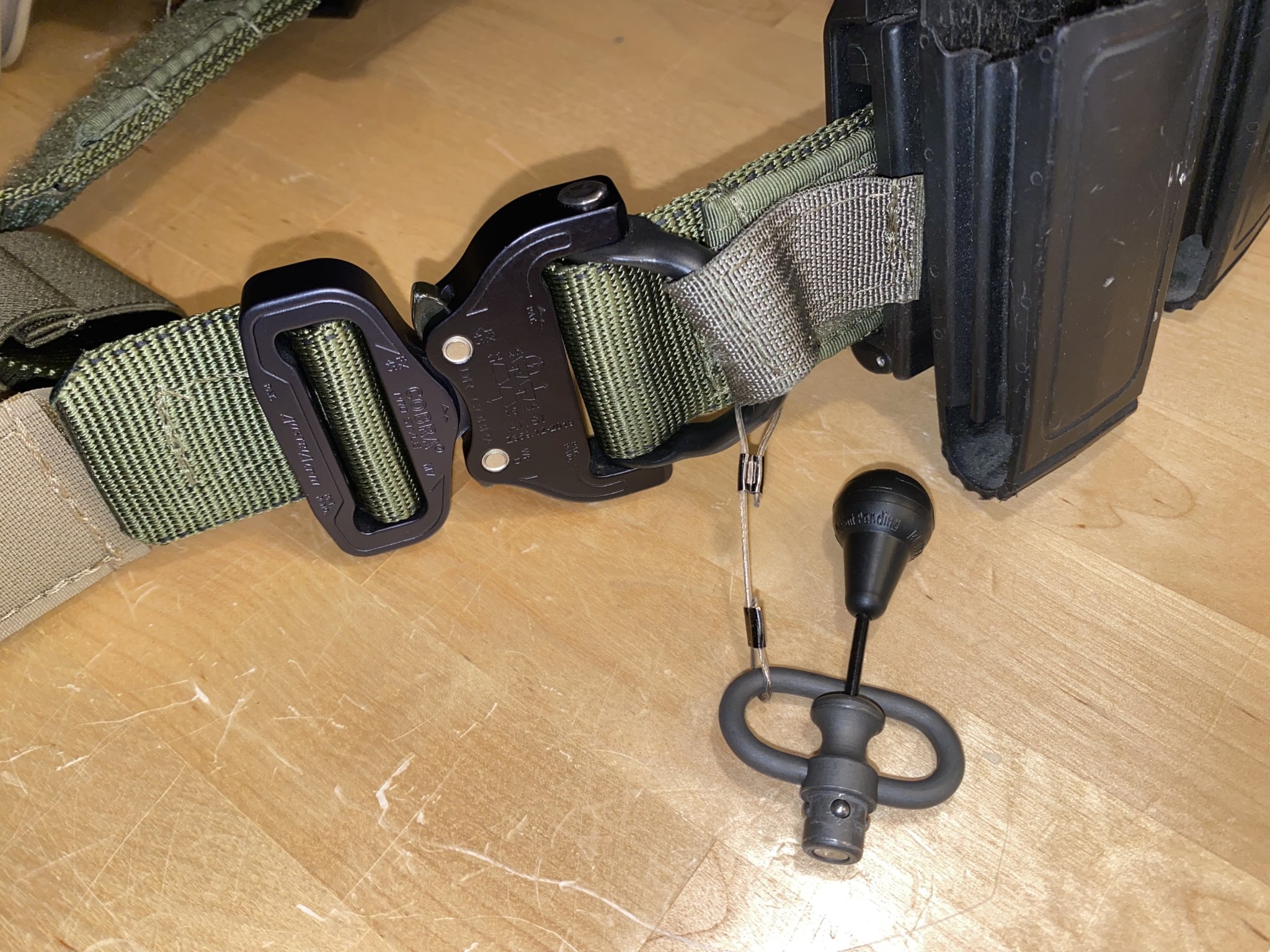

On the QD side I like to use the Blue Force Gear RED (Rapid Emergency Deployment)
devices as the operator has to actively pull the release, no accident!

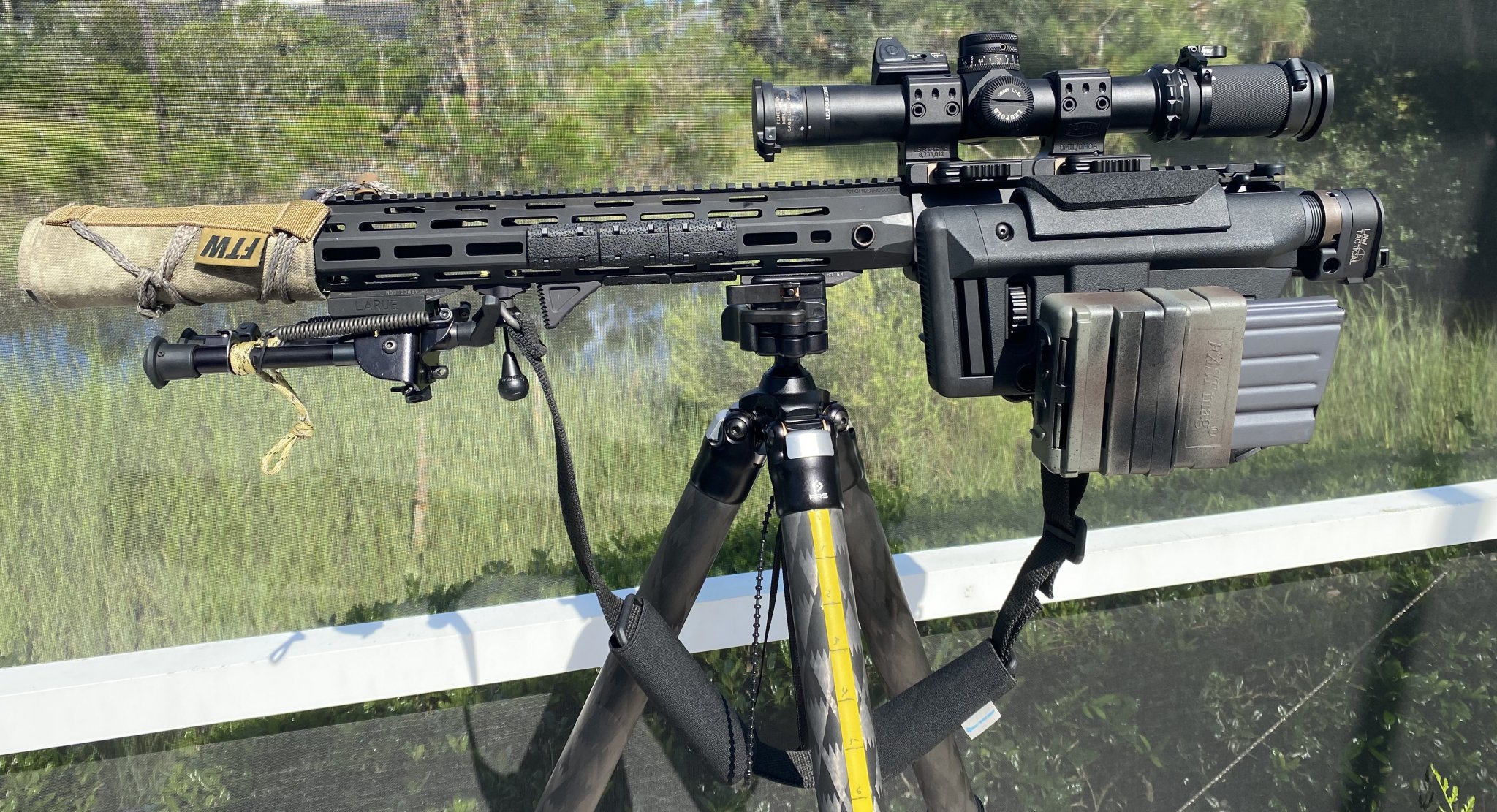

I’m also looking for the best way to integrate ARCA rail and Slings. I find that most of the solutions available, like pic rails and adapters use flush cups. I have a chassis that was spray painted before I bought it and all 3 of the flush cups fail. But after looking for alternate sling stud and HK Hook solutions, I am not sure there is a better mouse trap out there. Sling studs screwed into a stock can move, come unscrewed. HK hooks are noisy and sloppy.
I have decided it makes the most sense to stick with flush cups, make sure they’re clean/unpainted. Also decided it makes the most sense to have the sling mounted to left side of stock or chassis to keep the ARCA rail travel free and clear for moving rifle fwd/back for best positioning on the rest, barricade, bipod or tripod.
