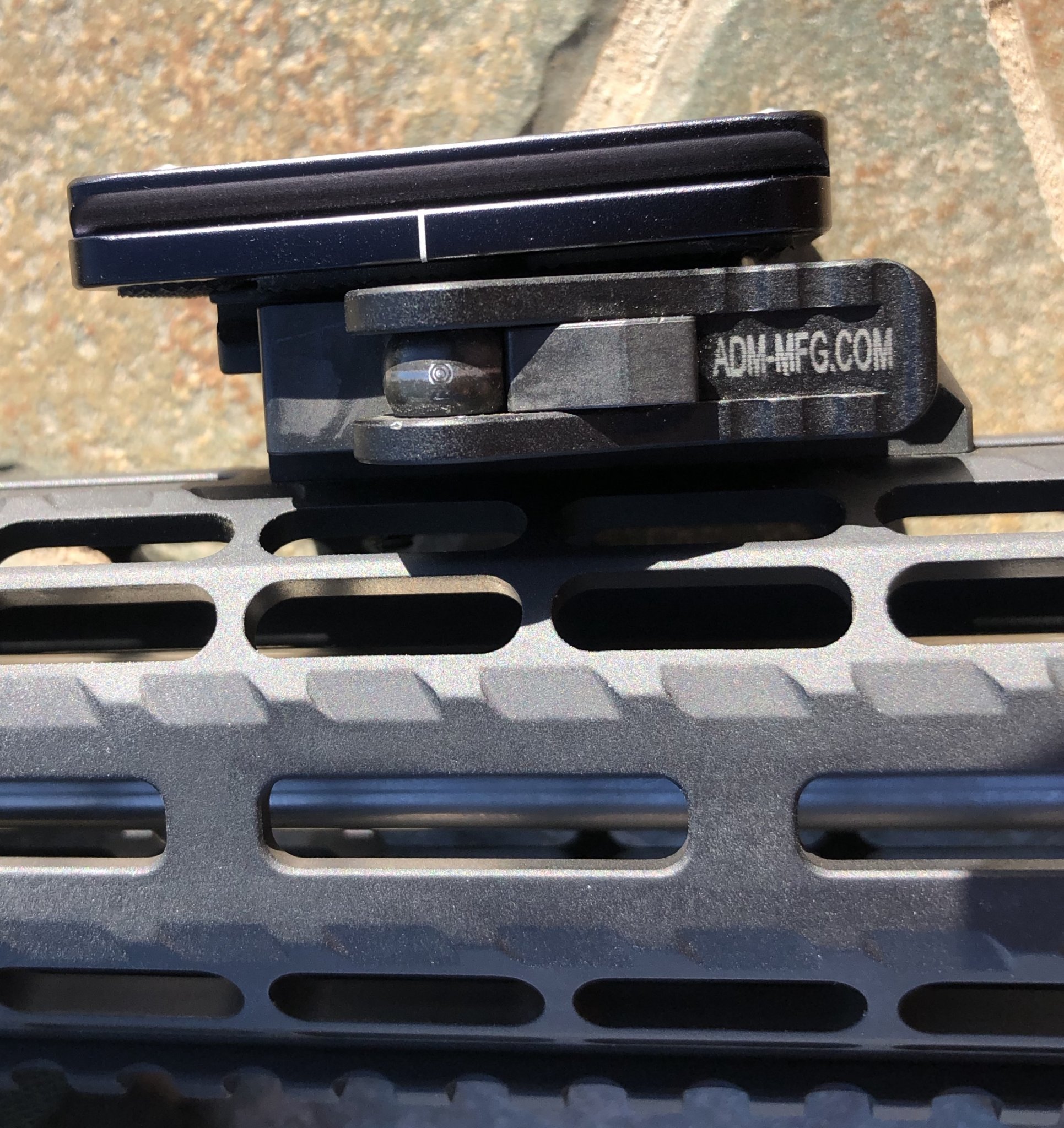

I used an old ADM AD22 I had laying around and tapped it 1/4-20. I normally use it to mount my CONX to my Legend spotter.

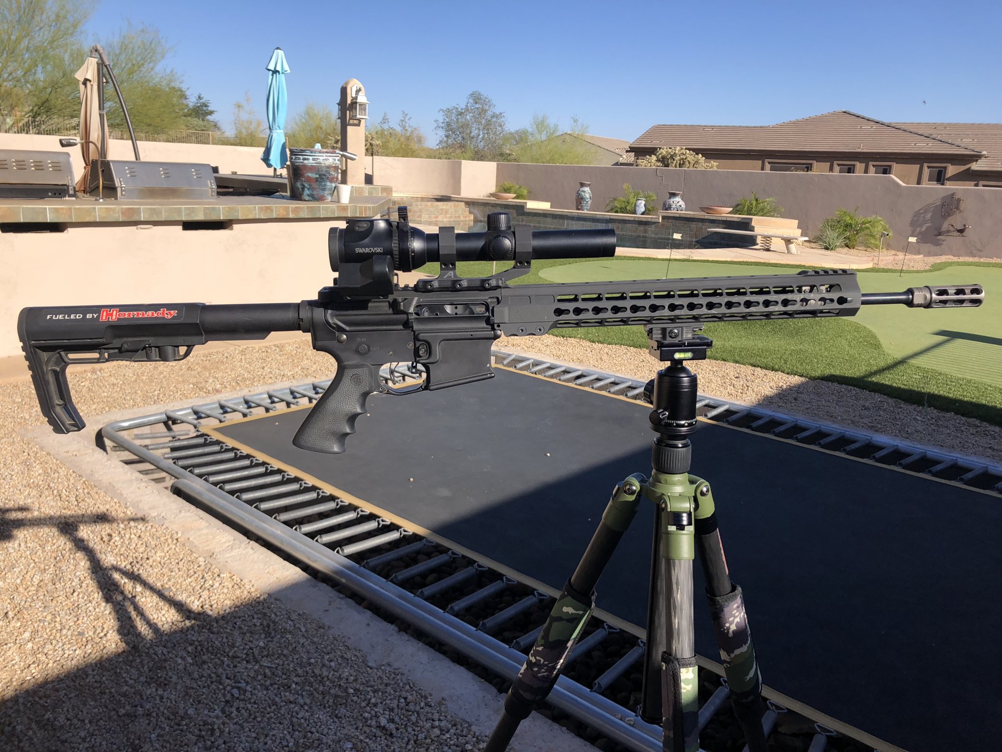

Bolting a plate to it works fine on lightweight AR’s. Think I’d run the rail closer to the center of gravity on heavier rifles or continued use.2FB841E1-8791-42DB-B19E-474738CEA921.jpeg04AFC78B-5680-4E5C-A9B3-B3ACEE7C1CF3.jpeg
Bolting a plate to it works fine on lightweight AR’s. Think I’d run the rail closer to the center of gravity on heavier rifles or continued use.View attachment 6911930View attachment 6911929
I did the same thing with a QD sling stud adapter that I had on a harris bipod for my AR10. Pulled it apart, took the sling stud out of the adapter, and replaced it with a 1/4 bolt, put the QD adapter onto the Arca plate with the bolt, then ran a lock washer and nut on the backside and tightened it down. So far it's been rock solid with my RPR. I run it close to the center of gravity, but it works.
