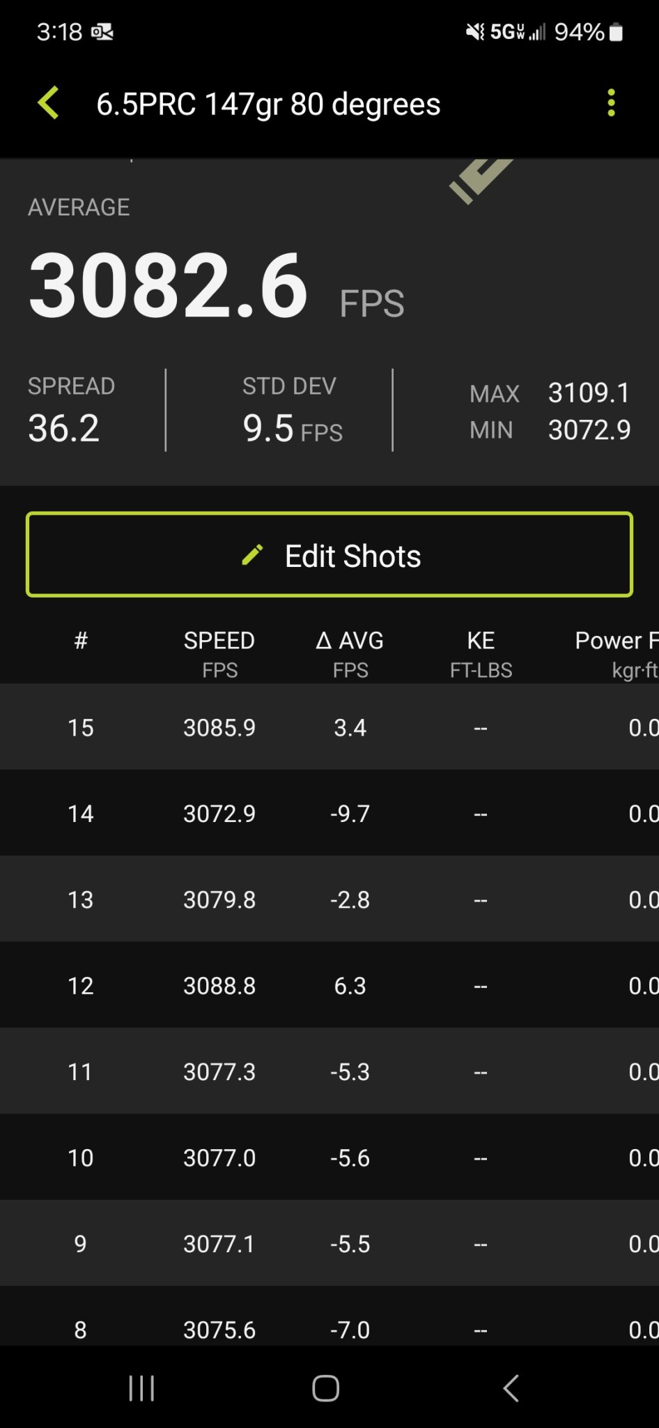

I am running the 147's out of a 6.5PRC averaging over 3080fps and have yet to blow one up. Accurate too.
