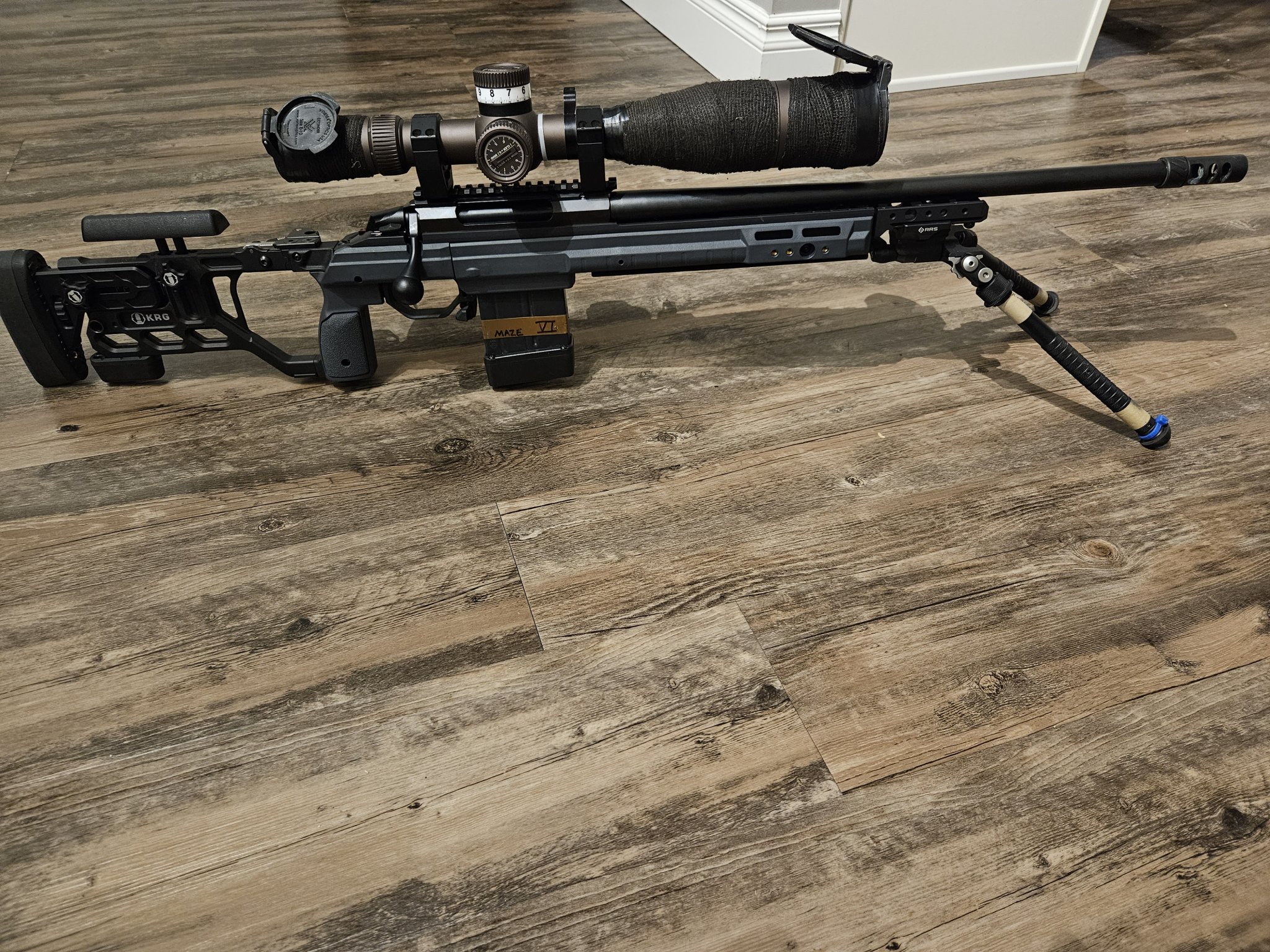

I was going to get MDT but accidentally got the Vortex already. My buddy bought a CTR at the same time and his rail was really stuck on but I was able to just pull mine off. Maybe I'm stronger than him. I have extra high (too high) Vortex rings from another rifle I'm using.
Check out the mpa mount. With one of the 20% discount codes they are one of the best deals out there. Spuhr, greyops and Badger are tier 1 but if you don't need to attach anything ( if it's a precision gun you should run a send it level fyi) you don't need those ecosystems.
I just wanted the mount for the 20 MOA which I have now with the base so any good 1.25" rings will do I think.
Trying to keep the weight from getting any higher for NRL hunter. The Razor Is already heavy enough.
