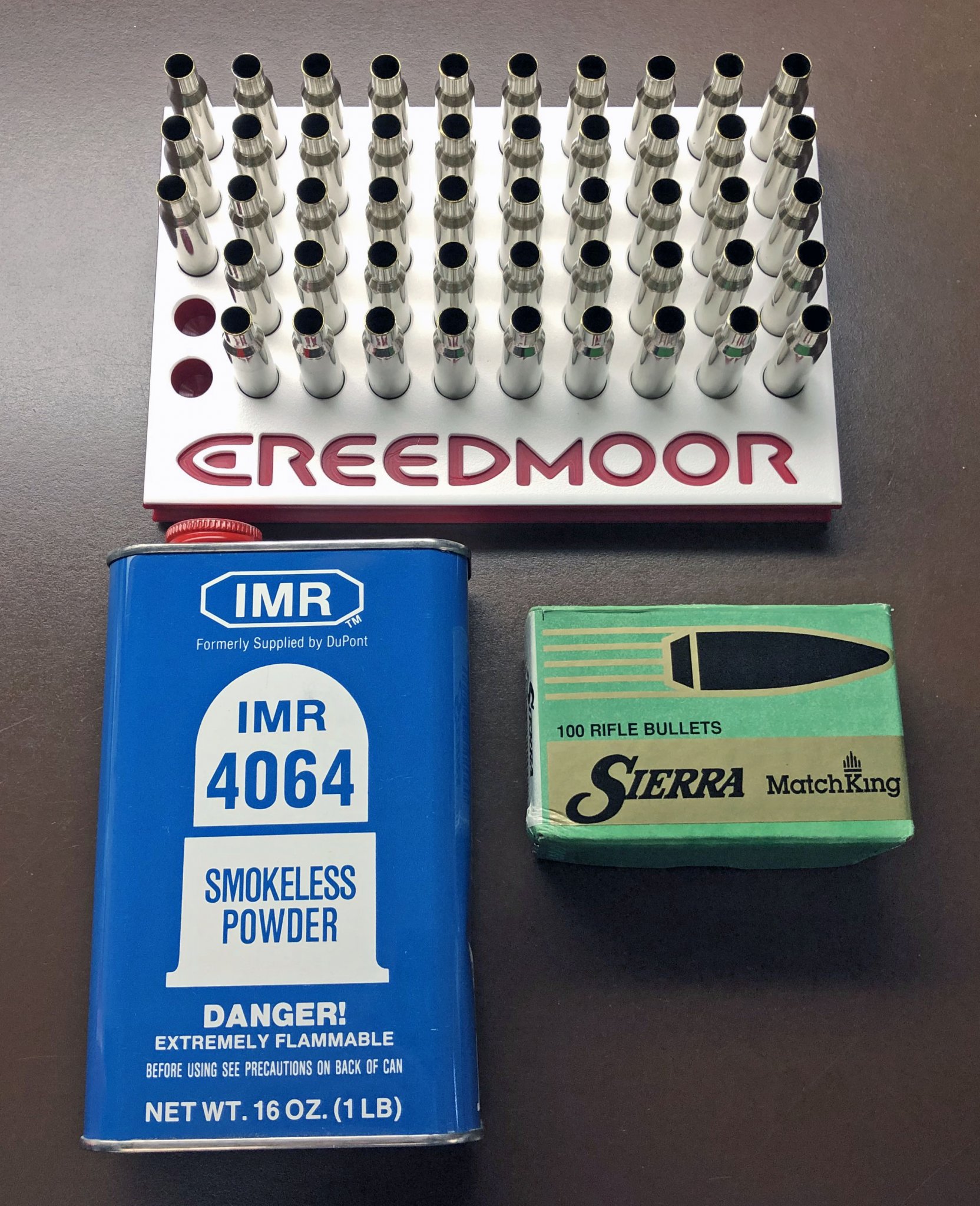

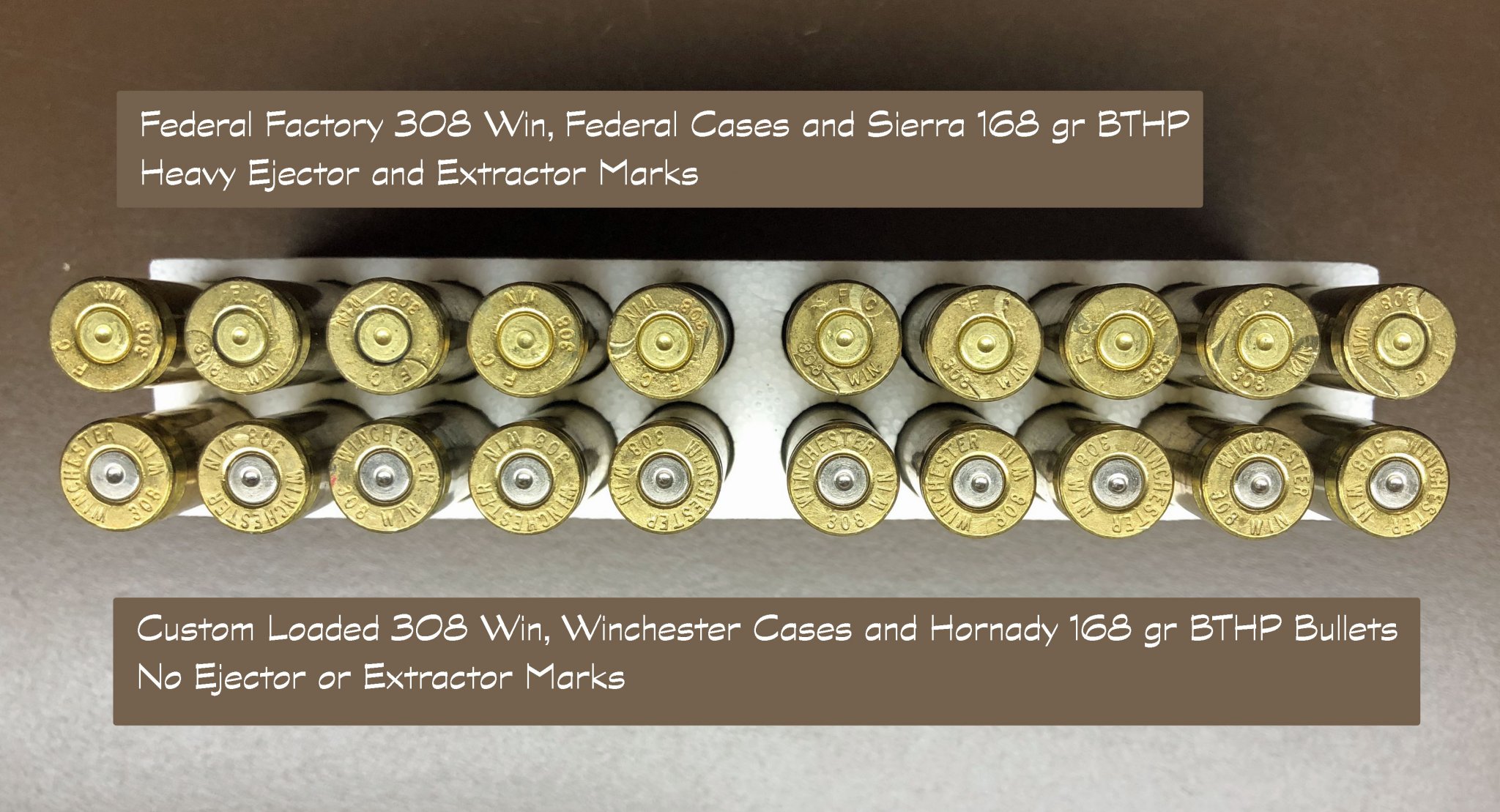

Below are 20 cartridges I recently fired from my early Knights SR-25. It has a tight chamber and is very accurate. The rifle is 100% reliable, but I have noticed that Federal ammo, either 168 gr or 175 gr Matchkings, have pronounced ejector and extractor marks on the fired brass. Any other 308 ammo I shoot from this rifle does not exhibit these marks. See comparison photo below. I would imagine that the displaced metal on the back of the rims would create inconsistent reloading results and the cases should be condemned.

These are Federal factory loads and custom loads from DS Mfg. I have not fired any reloads from this rifle, but I intend too as soon as the fires settle down and they reopen our range. I am inclined to start with some once fired Remington cases I loaded new a log time ago and shot from other rifles. I will use IMR 4064 powder and I have a boat load of Sierra 168 gr HPBT I bought decades ago. The nickel plated brass is all ready to go.

Gas guns are hard on brass. I have a SR-25 I bought in 1993. Ejector marks show up on FGGM and Hornady TAP. Les Baer also does it as does the GAP 10. I shoot with a few guys that have these rifles and I get the fired brass. We use FGMM and Hornady TAP.
When reloading for the gas guns, typically, the powder charges have to be reduced 1-2 grains from the bolt gun loads I load. You can still get a number of loads out of the brass if you don't hot rod it and stretch the primer pockets out. I can get over 6 loadings out of the brass. Hot loads will smear the ejector on the case head.
When my SR-25 was new, I was getting blown primers with 168 FGMM ammo. I put in a call to Knights and was told to keep shooting it, it would settle down. It did. They said they chambered these rifles with tight chambers. My fired cases from this rifle measure 1.631" @ the datum line. My GAP 10 brass measures out @ 1.634-5".
