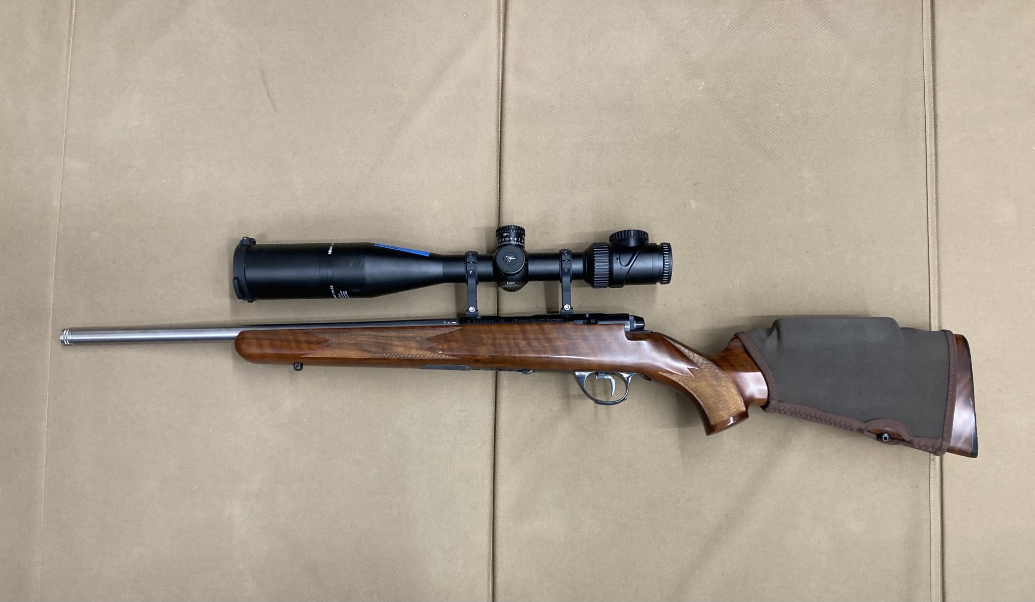

Hi I am wondering if my scope is too low? It seems to me that I have to tilt my head too much to get behind the scope in order to use the scope properly. This puts a lot of undo stress in my neck. I have a Ruger Precision in 6.5 cm the stock cheek weld is as low as it can go. How would I know what height of rings do I need? My scope is a 30mm tube, thanks for the help, Robert
Get taller rings. Last thing you want is to be forcing yourself to look through the scope. The rifle/optic should feel like an extension of your body. Something comfortable that doesn’t strain muscles and set up properly so when you get on the rifle the optic is naturally in your field of view
The old “low as you can go” style of mounting an optic has gone to the wayside.

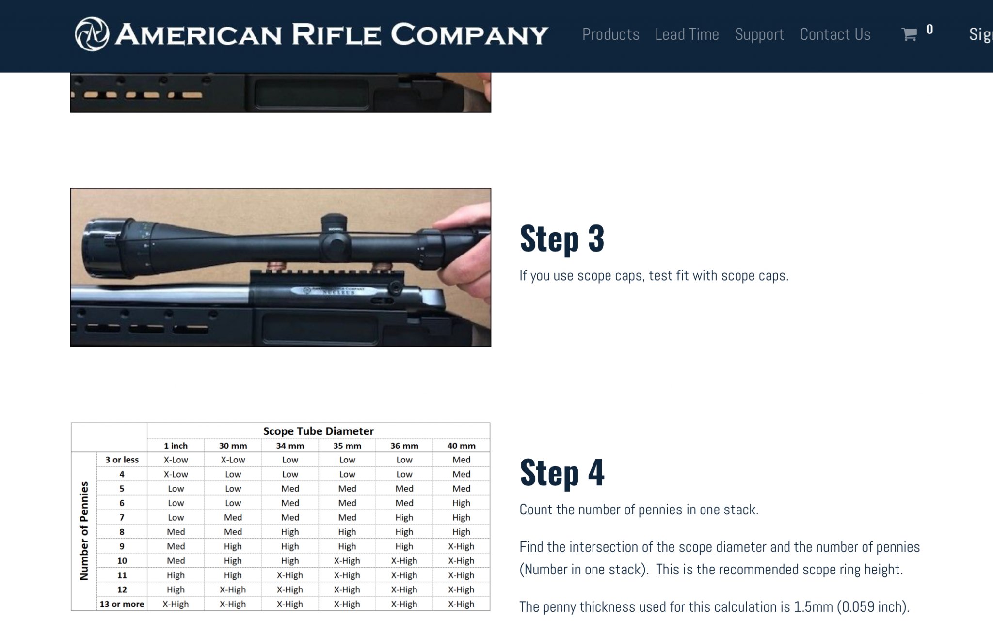

Try This https://www.americanrifle.com/shop/m-brace-scope-rings-1414#attr=207,304
