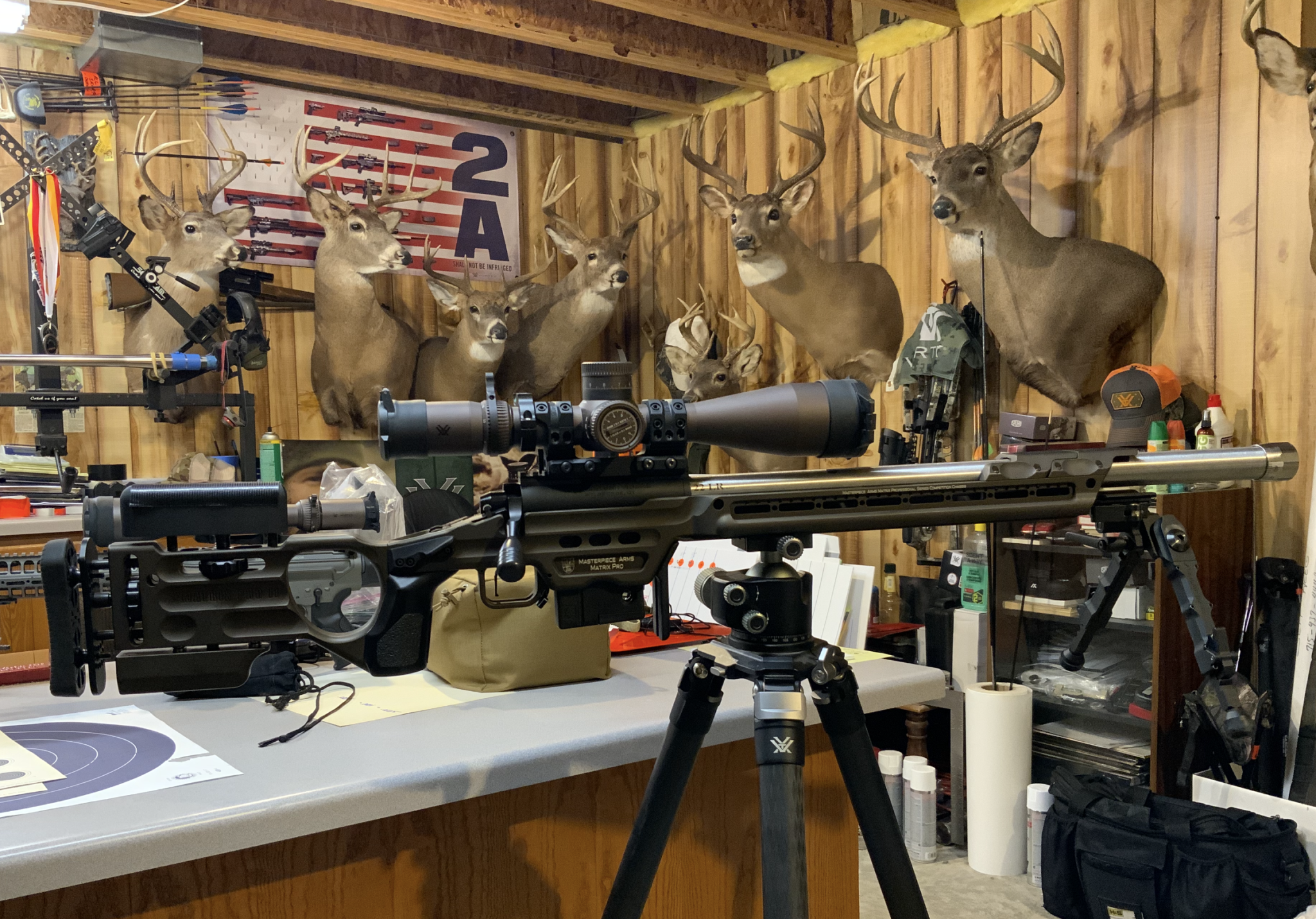

"It depends." My first-gen Vudoo (Bartlein barrel cut & installed at Vudoo) does quite well with a variety of Lapua, SK, Eley, and RWS SKUs. The labels it doesn't like - it definitely doesn't like and lots seem to have relatively little influence.
My Rim-X with Shilen barrel is far pickier. It was chambered by a highly-respected personal-friend smith who was reluctant to do the work - now we understand why. Eventually I'll either ask @jelrod1 to do a setback/rechamber or just ditch the thing and let somebody else fiddle with it (if I sell it, full disclosure is part of the deal).

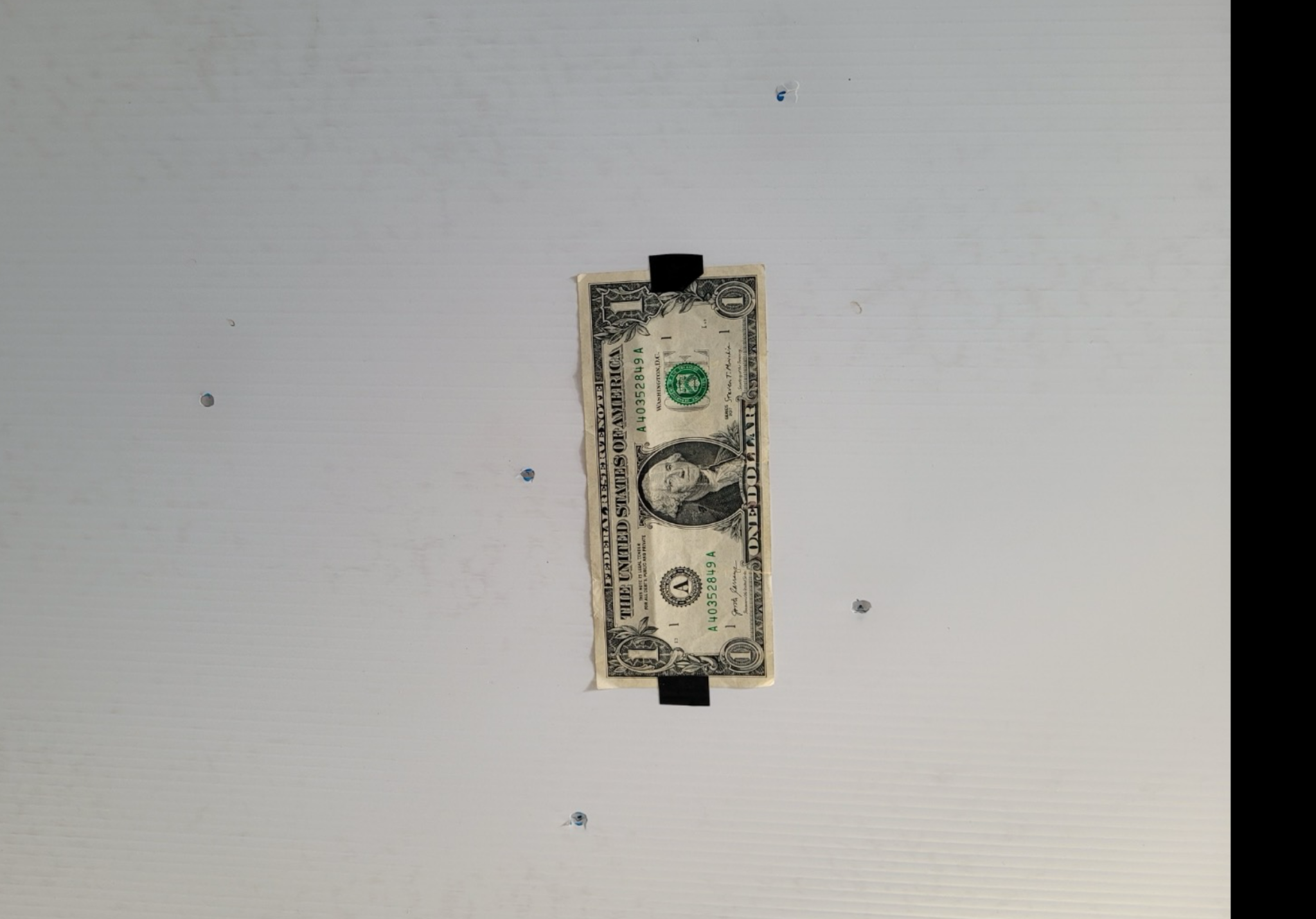

My personal experience says that it might, but I don't have a wide enough sample size to support that other than anecdotal as there were a few variables at play.
My first Vudoo was a factory barreled action, threaded 20" MTU, 1 in 16" twist. I shot a variety of Center-X and SK offerings through it fairly decently, but there were many Center-X and SK LR lots that it did not like. Best performance was one lot of SK LR, but I would currently classify that performance as "ok" at best. I was not yet really shooting Eley, and I wasn't in love with the idea of sending my only rifle off for lot testing. I played with different muzzle devices and tuners on it, and just never really found a substitute for lot testing. I couldn't get the tuner to really make the gun shoot any better than what I was already getting, but I sure could make it worse.
Vudoo #2 was a 360, and I had a 22" 1 in 12" twist 1.20 straight Lothar spun on by Modacam. I decided to go with a non-threaded muzzle/no tuner, and just commit to lot testing. I only shot Eley Tenex and Match through it, doing lot testing on my own via lot selection through Killough. It was more picky than my previous Vudoo, but was very good with the lots it liked.
I recently picked up a Vudoo 360 with a 25" 1.25 straight non-threaded 1 in 13" twist Mullerworks from DI Precision (wink). It shoots most of the lots of Eley and Lapua that I have on-hand pretty well. Definitely less picky than the 1 in 12" twist Lothar, which was really nice because I can use lots that did not do well in the previous rifles with it. There are still some lots that are not acceptable, but I went from having 1 "good" lot and 1 "ok" lot with 7 or 8 "not good" lots to having 2 "good" lots and 5 or 6 "ok" lots.
I also have a Bergara factory steel 18" threaded rifle that shoots one lot of Wolf Match almost as well as "ok" lots of Tenex and Center-X from my Vudoos, but shows very decent performance with one of my lots of Eley Match. It's currently getting rebarreled, as the 18" barrel is a pain in the ass to get balanced, and I like what I have been seeing with the 25" 13 twist Mullerworks barrels.
My factory T1X (first attempt at "precision" .22LR) was only really tested with SK offerings, but did decent with the Biathlon and Pistol lots I initially bought. I rebarreled it with a drop-in International mostly in an effort to get better balance in the chassis I had for it for my kid to shoot. It was also picky on ammo, and I never really found anything that I would consider "good". I retired it to the back of the safe and switched over to the Bergara (pre-rebarrel) for him due to never really getting what I wanted out of it, to include reliability after the barrel swap.
I don't know much about .22LR "match" chambers other than the fact that there are around 150 of them. I don't know exactly who does what, but I know that at least in the barrels I have I can see different performance with the same lot of ammo, and some are more picky than others. I am unsure how much of that is caused by the chamber or crown.
I have been through many rifles over the years. If they were lot picky I sold them. I have 6 custom built vudoos and 4 custom built rimx rifles now. Not one of them are picky with ammo. I believe it is no tight spots in barrel and headspace that make a barrel not picky. I have a variety of different match chambers. All 1.5 degree leads. But they all still shoot eley well too.

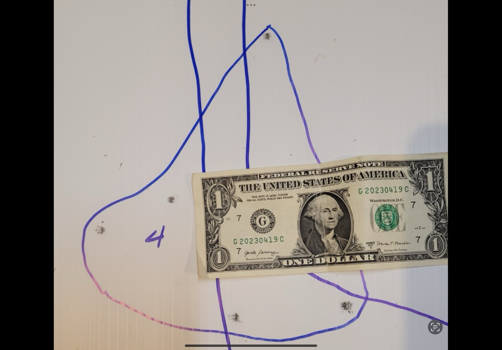

Nobody here has good sample sizes for this kind of (rhetorical) question.
For me, sample sizes for accuracy and velocity for a given rifle/barrel are decided with a minimum of 25 rounds, preferably double that.
  • Accuracy: consistent 3/8" at 50, one-MOA at 100 in optimal conditions, with a fair number of 5-shot groups 2/3 or even half that size. I am fortunate to have an indoor range with a 100-yard bay nearby. More and more, though, I check performance at 200 and 300 yards. So far, I'm finding the higher-velocity offerings from Lapua (Long Range) and RWS (R100) to be better "wayward out there." Unfortunately, both my rifles distinctly dislike the two lots of SK Long Range Match I've tried.
  • Velocity: ES of 30-35, SD of ~8 over dozens (or in the case of my lot-tested Center-X, thousands) of rounds. A fair n umber of 5- or 10-shot strings will show ES/SD values in the 15/6 range.

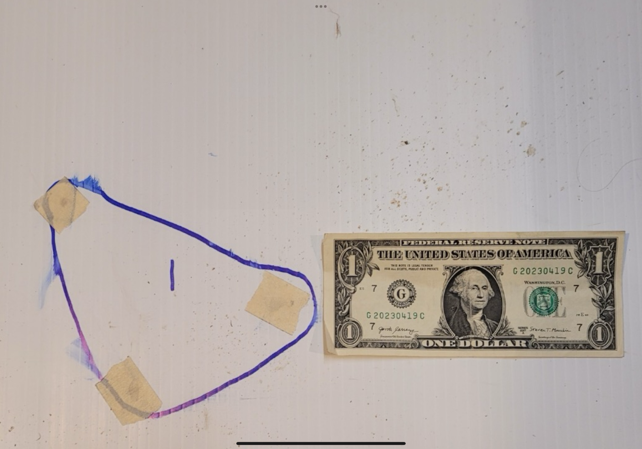

I want to see 3-5 reamers in 3-5 copies of each barrel. I want each barrel made in blanks from 3-5 makers. I wan to see 3-5 ammo types per brand/factory, and I want to see min 3-5 lots per type (but probably more like 10-20), across a production run is at least 5 if not 10 year in width. To be close to real world expectation, you'd also need to cut barrels in sharp, mid-life, and end-of life configurations of each specific reamer.
And that's not even being very demanding ... :ROFLMAO:
Reactions: David Lott
With everything the same you will still see a difference in one to the next due to the tooling used in the rifling one barrel could have a sharper edge on possibly just one of the lands versus another even though they are the same - at the end it distorts the bullet differently from the next barrel thus changing the BC slightly and impacts. Harmonics should be close but yet could be different the rifling/ lands after being cut by the same will still effect the end result.
When it gets close in reference to the comparisons then distance will weed things apart.

The rifle was built in 2024 from DI Precision
Using Midas Plus ammo
A 3 shot group at 500 while trueing up Balistics APP
Another 5 shot group at 500 same time these two groups had a 4 MPH wind from 10:00
33.8 Mil elevation was needed and 3.4 mils of windage
Then an overlap of two 3 shot groups at 700 yards - yes a bullet is missing it went off the target plate just right of group. I was was holding for windage 12’ that was running 2 to 10pm from 10:30
58.5 mils of elevation and 6.6 mils of windage
Yes the $ bill was vertical in the target versus horizontal at 500
The dollar $ Bill represents the group size for reference
