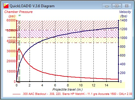

Not just slower powder. Heavier bullet as well. You can shoot light bullets at low velocities but then it gets weird with pressure and consistency etc and people generally dont to it for that reason.
The majority of velocity is picked up in the first couple inches.
In this graph its a heavy SUBsonic in quickload I plucked off the net.
In 16" of barrel its topping out at ~1250 fps.
In only 4" of barrel though its already going 950 fps, thats 76% of its total end velocity in only the first 1/4 of the barrels length.
A super sonic is only going to be more pronounced and hit higher velocities even more rapidly. A lighter bullet with less mass requires less force to accelerate to the same speed. Acceleration=Force/Mass

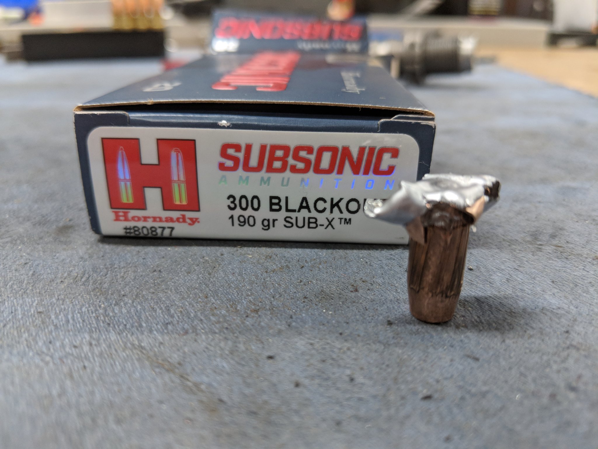

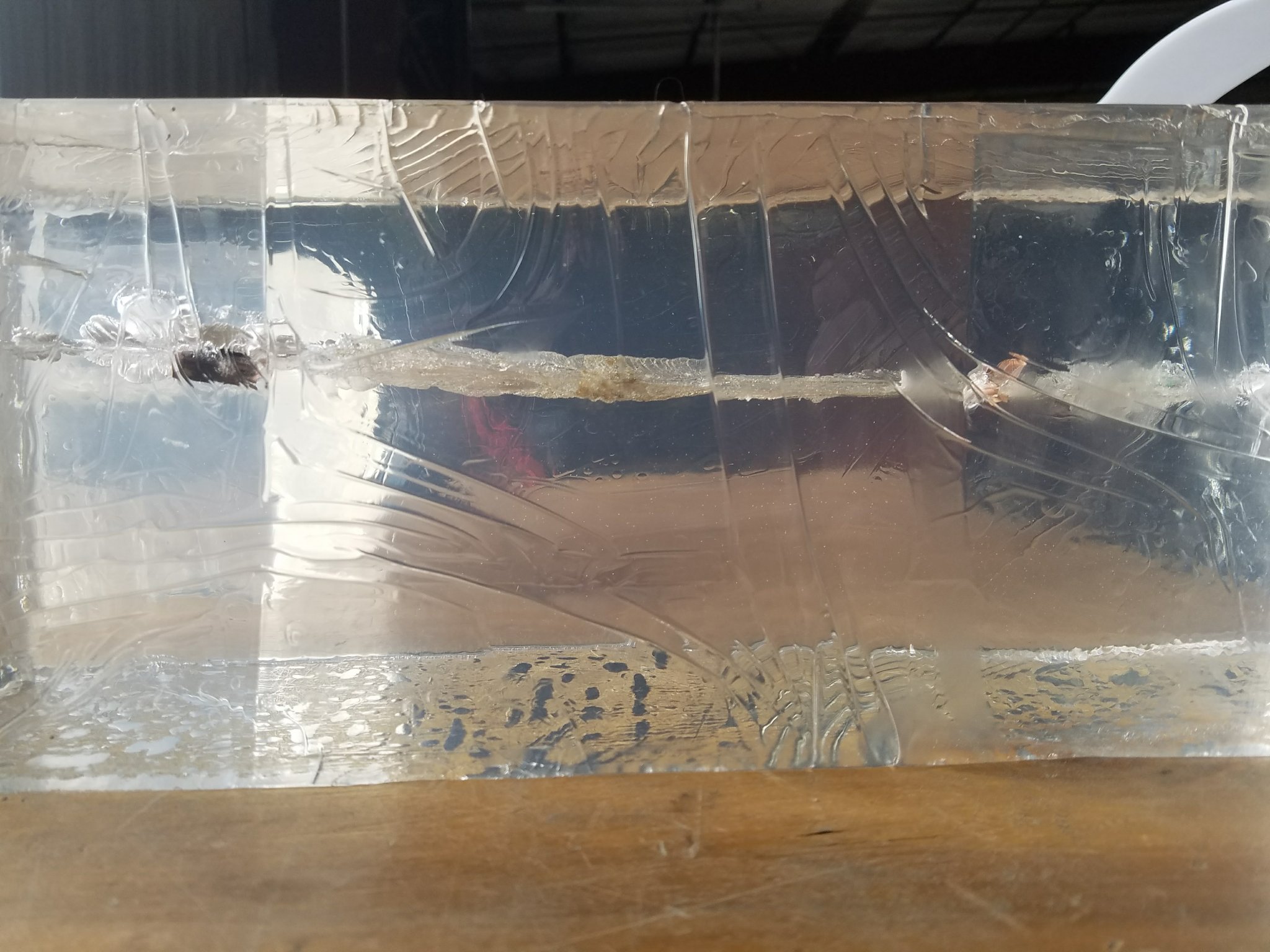

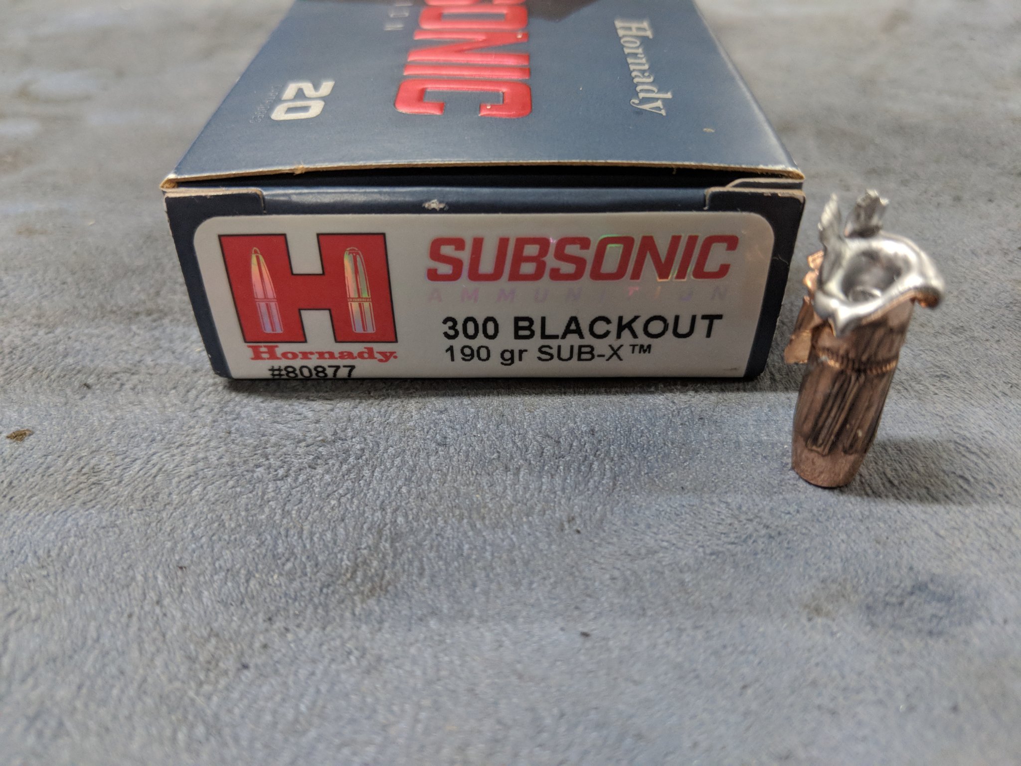

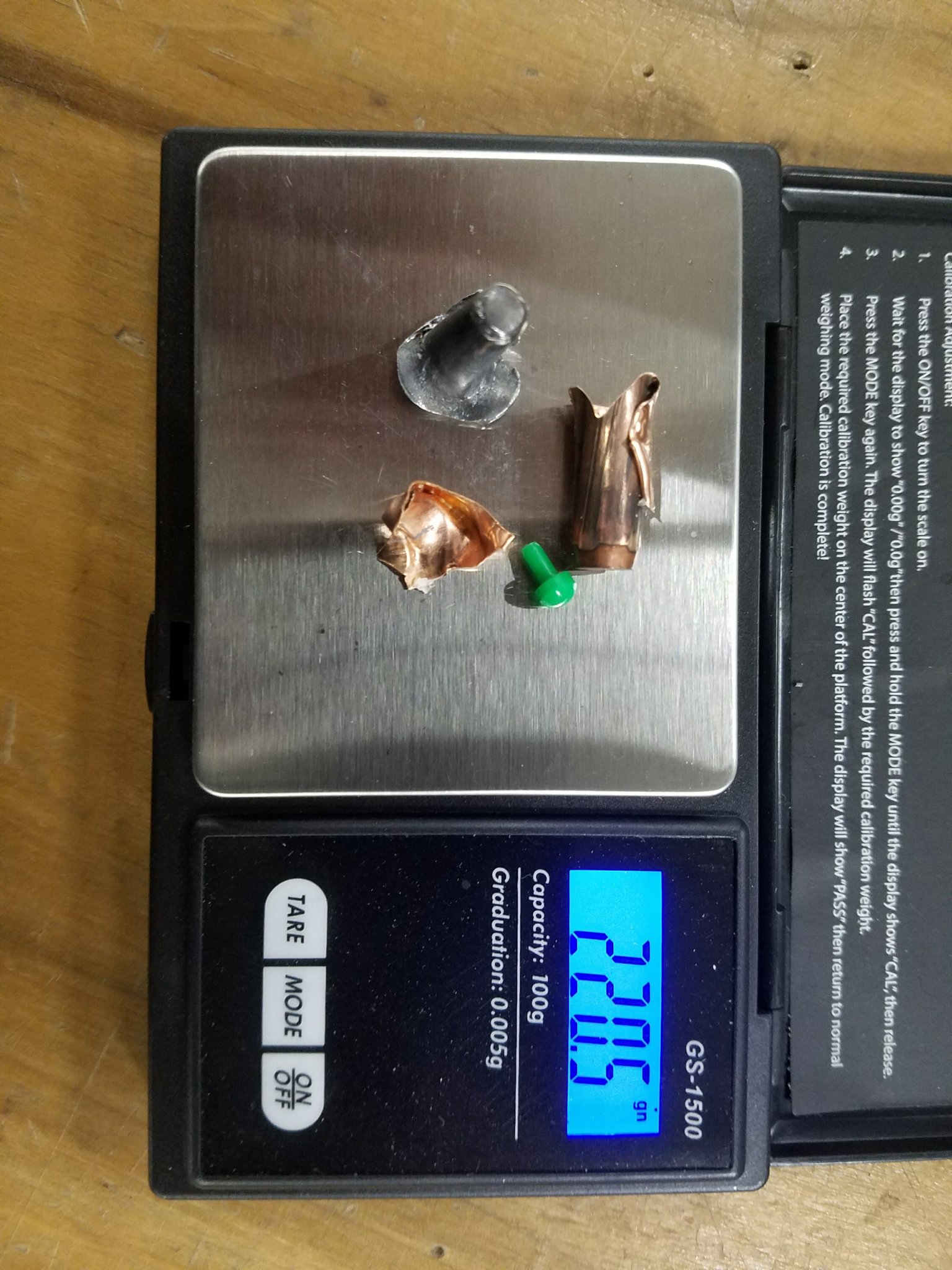

Here's two of the Hornady 190 in Clear Ballistics 10% gel.
Factory loading at around 1150 fps
Downloaded to 750 fps
