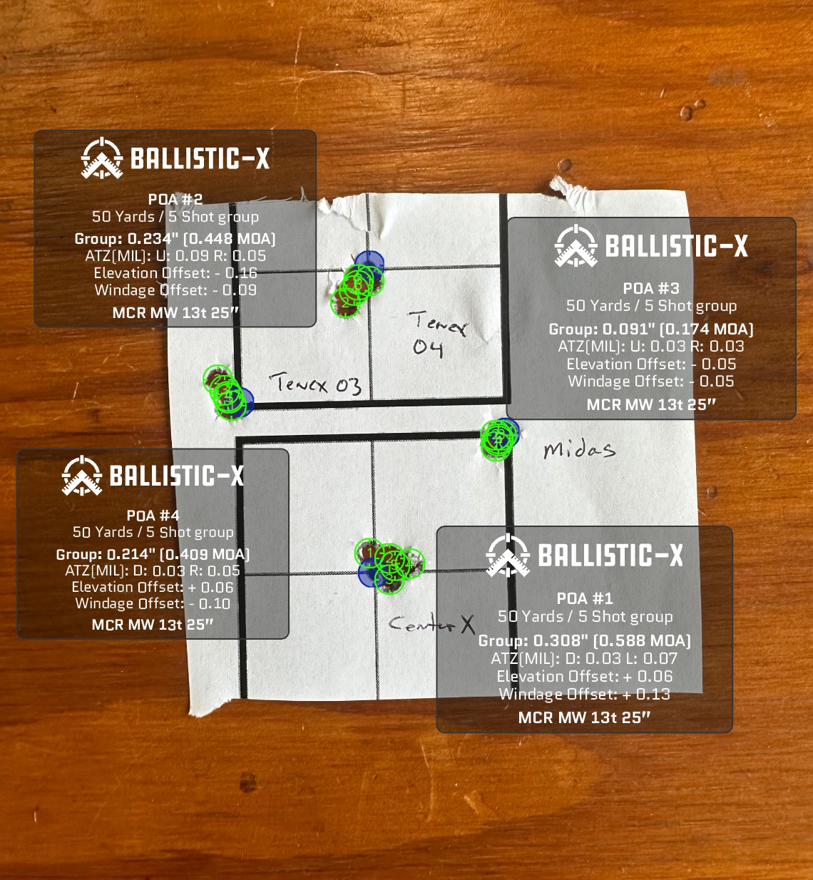

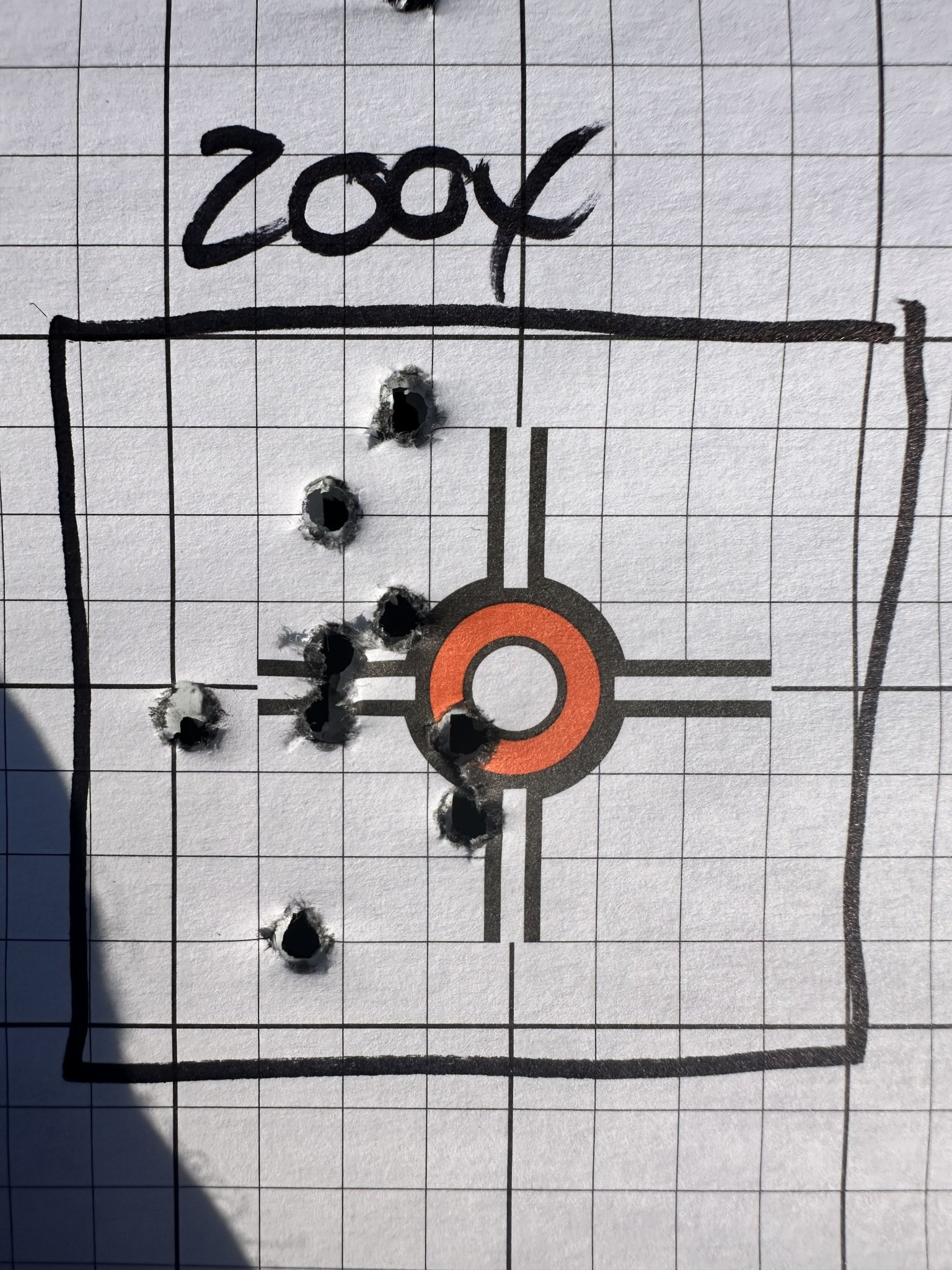

My first precision 22lr rifle was built by Ga Precision back in 2020. Had Mullerworks send them a 24” mtu blank in 1:12 twist. He was recommending 1:13 but i wanted 1:12. They got one done for me and sent to gap to be built on rimx action. Gap built full blown custom rifle that is a work of art. It never performed very well at 50 yards. Shoots most ammo between .3 and .4. Shoots around 1-1.25 at 100. But it out shoots all my other builds at distance. It shines at 250 and out. Just wonder if anyone else has shared same experience.
It’s not dead , others are playing and barrel manufactures are making barrels , you wil get answers ranging all over the spectrum but what you are experiencing is normal , some get good groups at 50/100 but most don’t out shoot 1/16 until they go past 100/150 then the faster twist takes over if you have a good barrel and smith and ammo
Maybe others will chime in
Reactions: Emerson0311

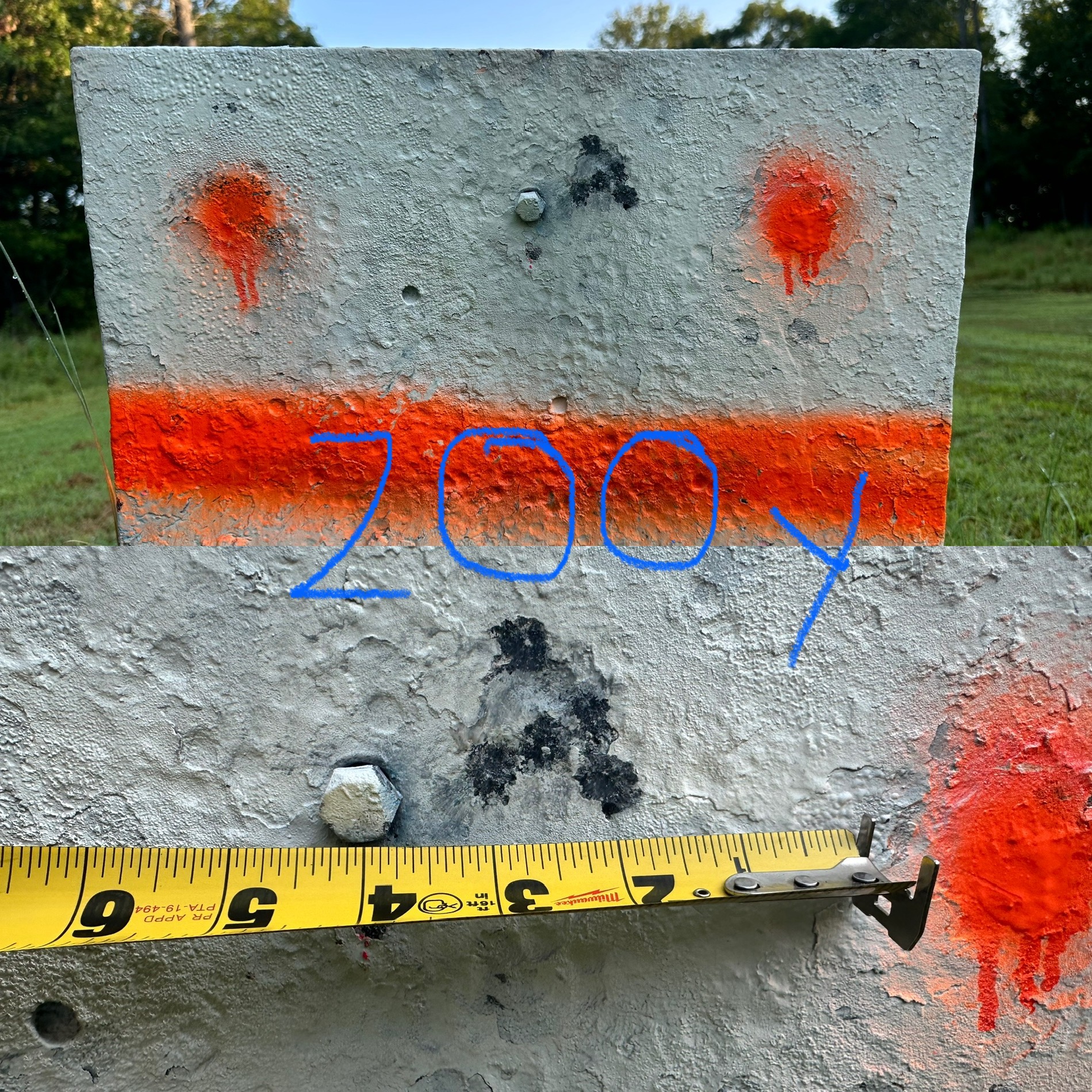

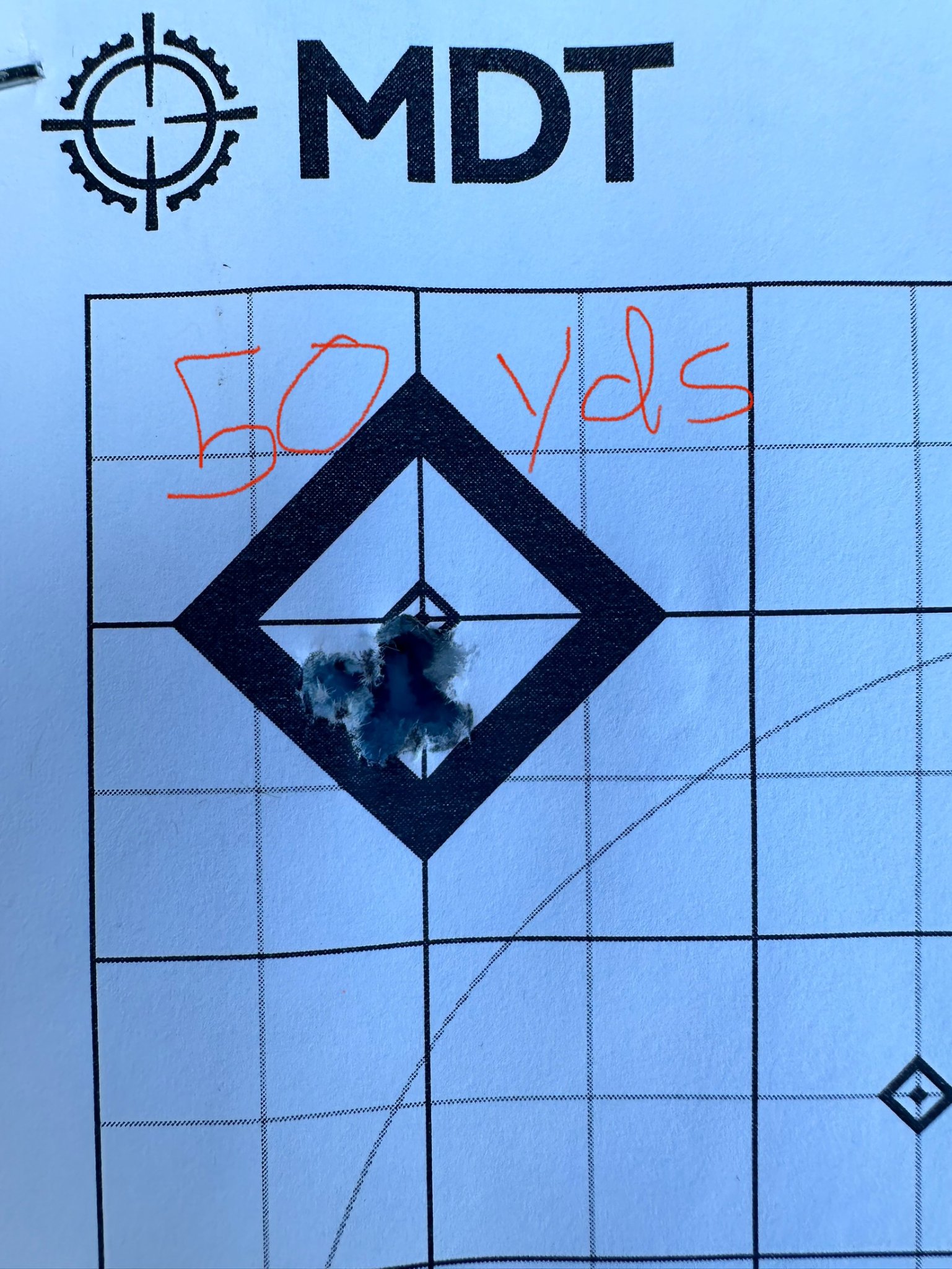

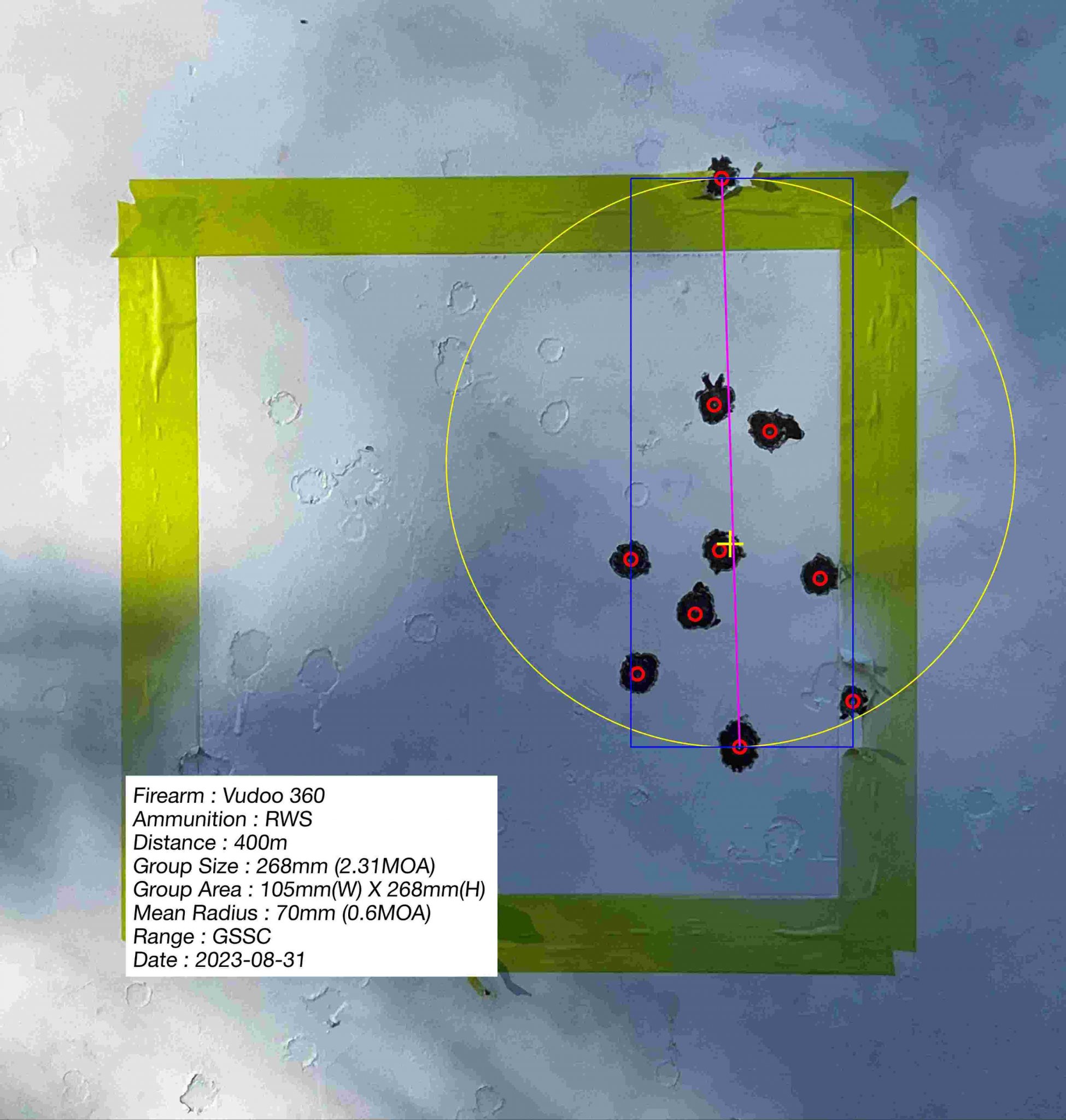

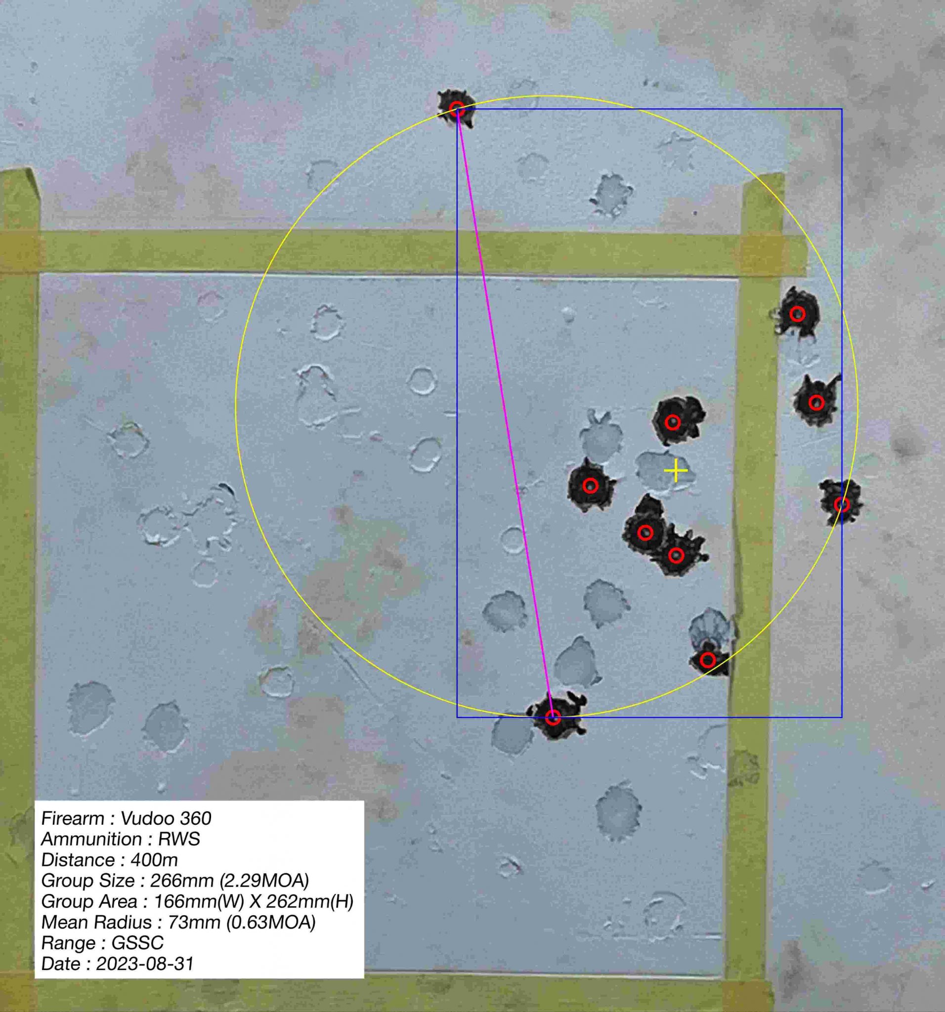

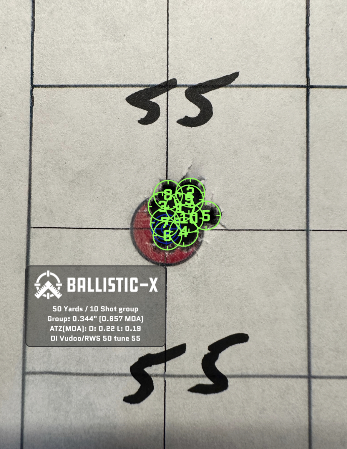

I have found some lots of r50 and tenex that will do better at 50. Average in 2’s. But most are in 3’s-4

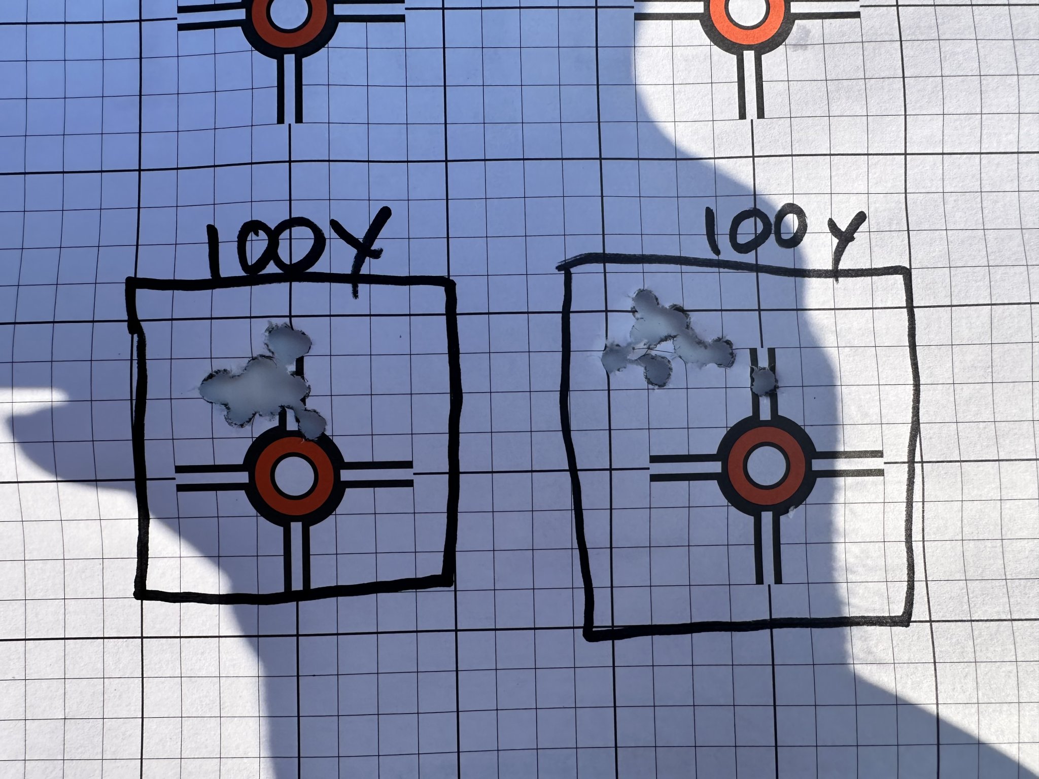

By what I see people are still doing a lot of 1-13 and 1-12t. I shot these groups back to back at 50yds a couple weeks ago with my 25” 1-13t muller works chambered by DI. I was using R50. Haven’t had a chance to really stretch it out at distance. It’s coming though.

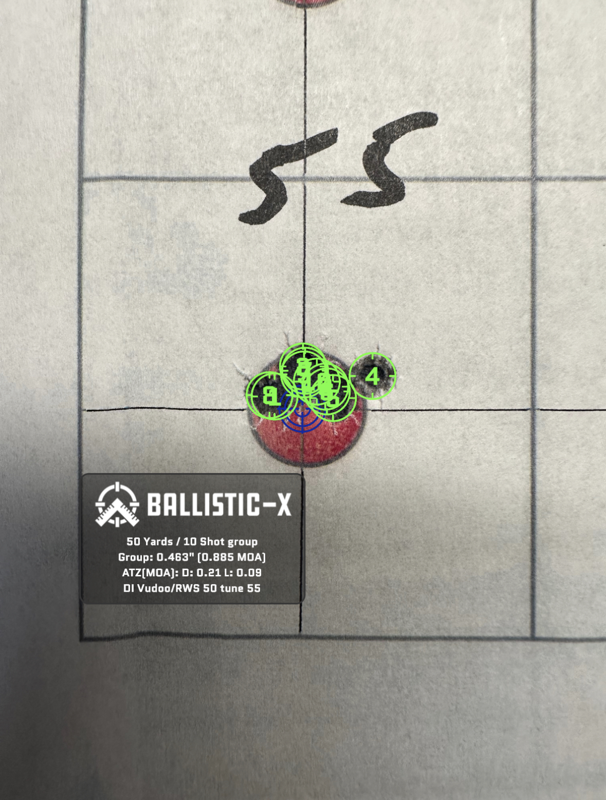

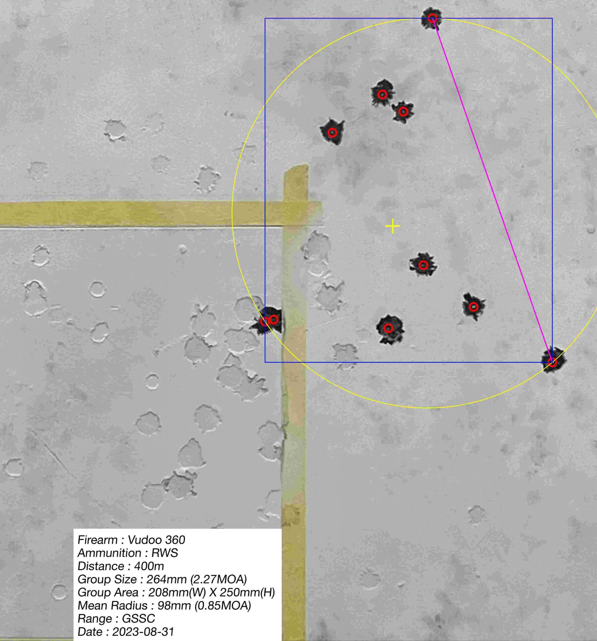

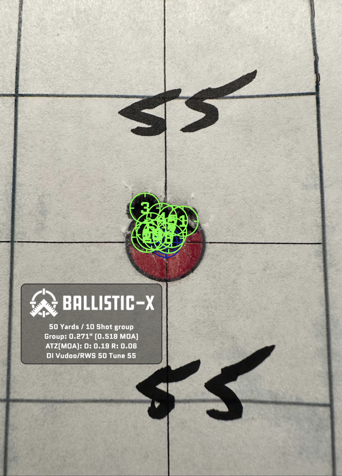

I have a vudoo built by di precision! 24 inch mullerworks 1:16 mtu. Hammer. But 1:12 is better at 250 and out. Only have 450 yards to shoot. 1:12 mullerworks does better at these distances

The best 100 yard 50 shot group I've seen with 22lr was 0.85 inch.
The best 200 yard 50 shot group was 3 inches.
I would be interested in seeing if a fast twist could better those results.
Assuming someone could obtain some decent ammunition. :sneaky:
Conditions, always a player. My 13 tw shoots .5-6 at 50 yards, yet I have shot numerous 5 shot 3/4" groups at 250 yards. I cannot do this on command.
By my CF past, makes no logical sense. My scope, ZCO 525 is bottomed out at 50 yards, optical center??? I don't buy that with these modern scopes.
It is definatly backwards from my experience also! Been playing with rimfire since early 70’s. 52’s, 40x, 54’s. And have been playig with these latest since jonathon converted a 40x into a repeater. Been a trip down the rabbit hole for years🤣

50 shots at 200 yards in 3" is a feat, IMO. Could it be bested by someone, no doubt, but the shooter accomplishing it better pull the plug at 25 rds and concentrate at 400 yards and have a talking point.

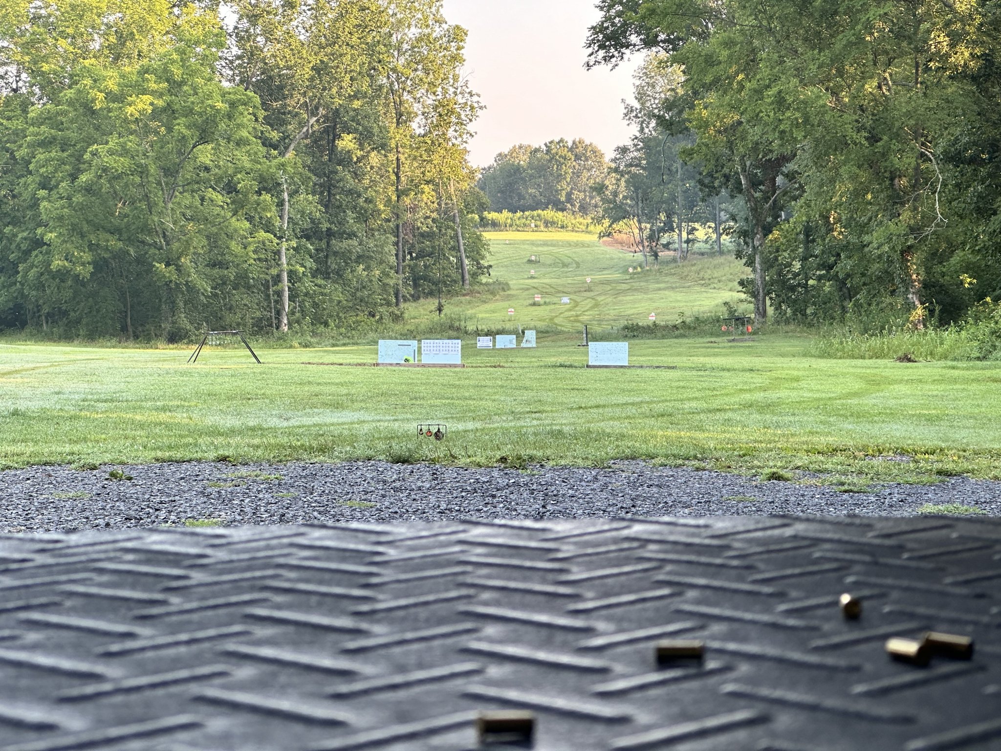

Last Thursday morning I kept a 3" NRL target paddle swinging at 300 yards with 10 shots from Rim X from one 10 rd mag. Sunday, I tried again and failed to come close, yet my 16tw Vudoo was almost up to the task!
Rimfire!
I have ordered a Shilen 1:12" twist blank to test, but don't expect better results than my standard 1:16" twist Bartlein barrel on my Vudoo. These groups were shot with my 1:16" twist Bartlein barrel at 437 yards recently. Attached groups were all shot with 3 different lots of RWS ammo. The block inside the tape on the steel plate measures 300mm x 300mm (almost 12" x 12").
I have a Bore Buddy Apogee 21" barrel with 1-12 twist. I have only shot about 100-125 rounds through it at 50 and 100 yards. I have shot CCI Standard, CCI AR Tactical, Norma Tac22 and SK Rifle Match through it. So far I keep getting 1 flyer in every 5 shot group with all the ammo I have tried. The flyers are anywhere from 3/4" to 1" out from the rest of the group.
Maybe I need to shoot it more to break it in, who knows. I did notice that I have two tight spots in the bore towards the middle of the barrel and that might be causing me issues too.
Needless to say, my heavy 16" CMMG barrel with 1-16 test and my Savage MkII with its heavy varmint barrel with 1-16 twist definitely outshoots the 1-12 Apogee barrel out to 100 yards with zero flyers (unless I mess up).

My example:
Vudoo 22", 16tw, Lapua Long range at 1119 fps muzzle velocity
Rim X 24", 13tw, RWS R50 at 1127 fps MV
At 300 yards my up dopes are, Vudoo 11.9 mils, Rim X 11.6 mils with a 50 yard zero. By 600 there is about a 1 mil split with the Rim X needing less.
By running a .137 BC across the board with Vudoo, my dopes are pretty sound from 200 yards and out.
The Rim X needs a fair amount of manipulation, adjust MV to 1140, up BC to .140, and things match up relatively well.
To my eye, the bullets look comparable, and actually putting 3 or more on a bullseye is more of a pipe dream than reality at 5-600 yards. I don't think there is a ballistic solver that will give the spread differences with just an 8 fps difference.
I don't have the education to figure this out, but somewhere around 250 yards, the additional spin adds to the BC of the bullet, which of course results in the bullet flying better, more speed, increased stability, more BC.

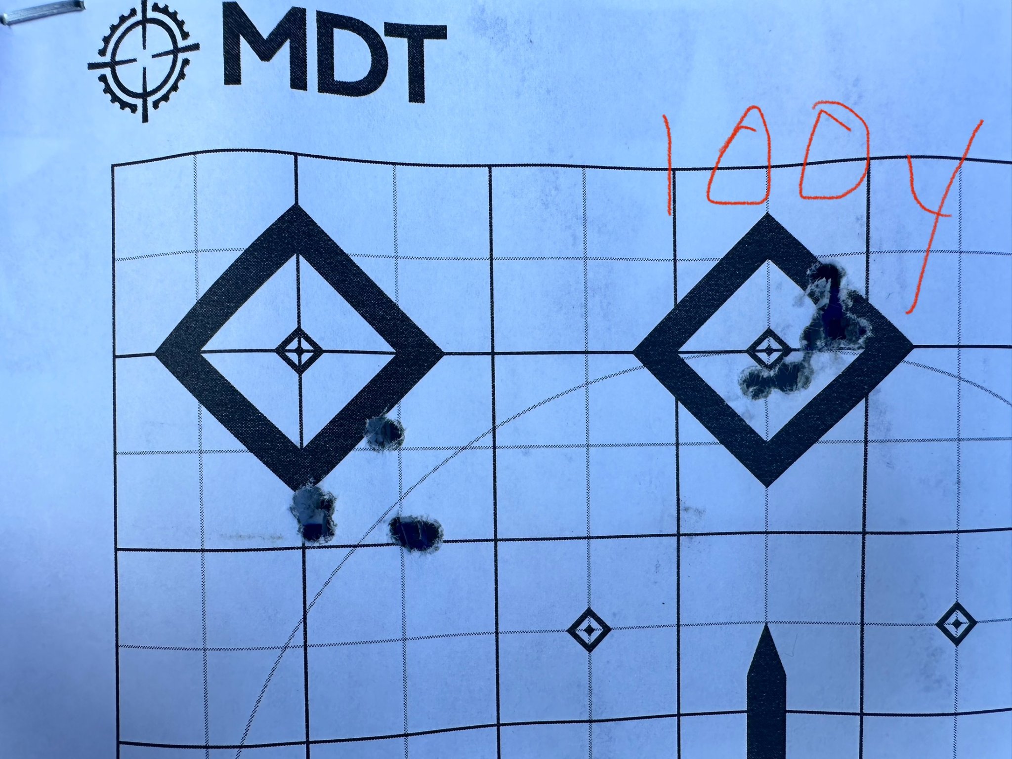

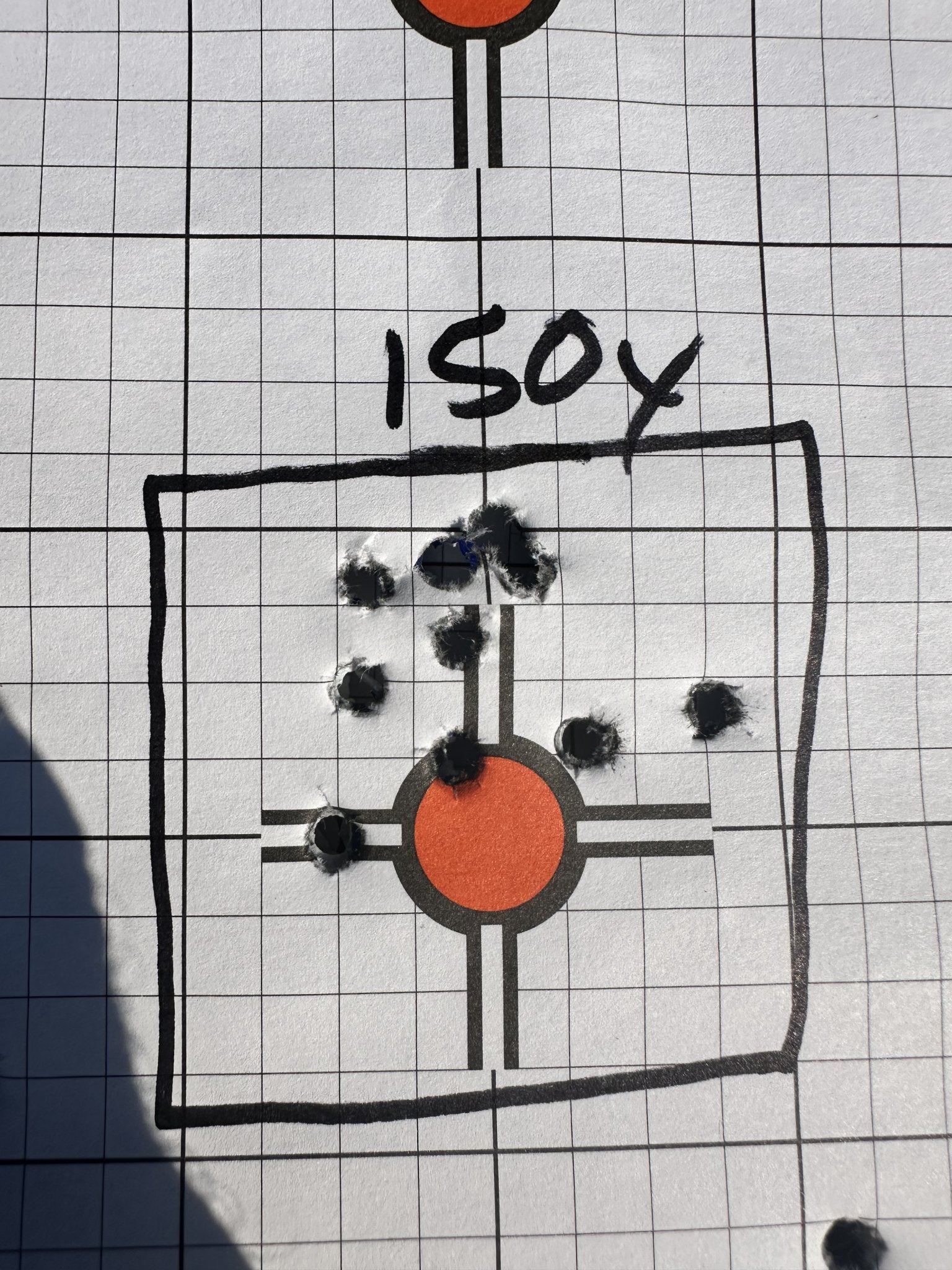

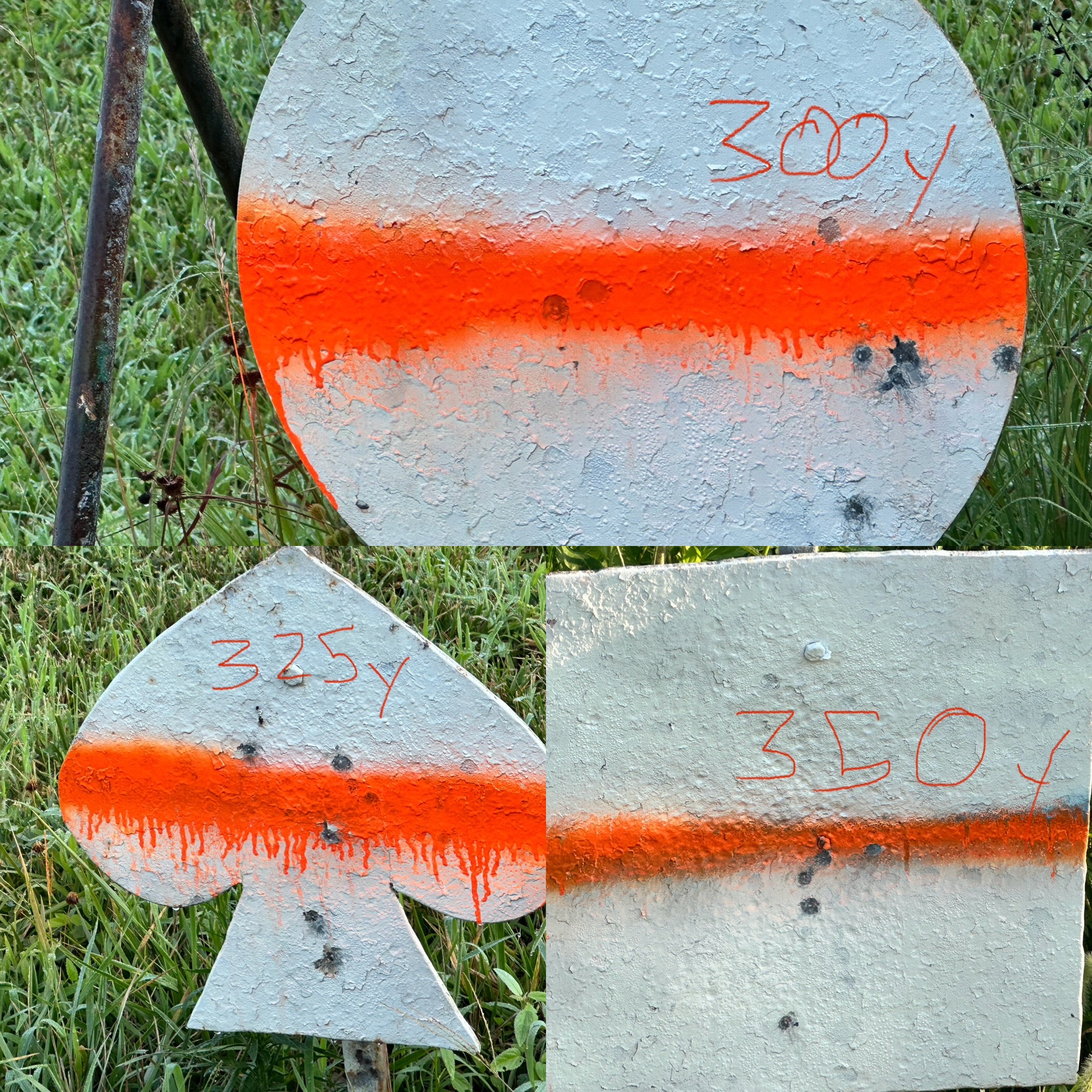

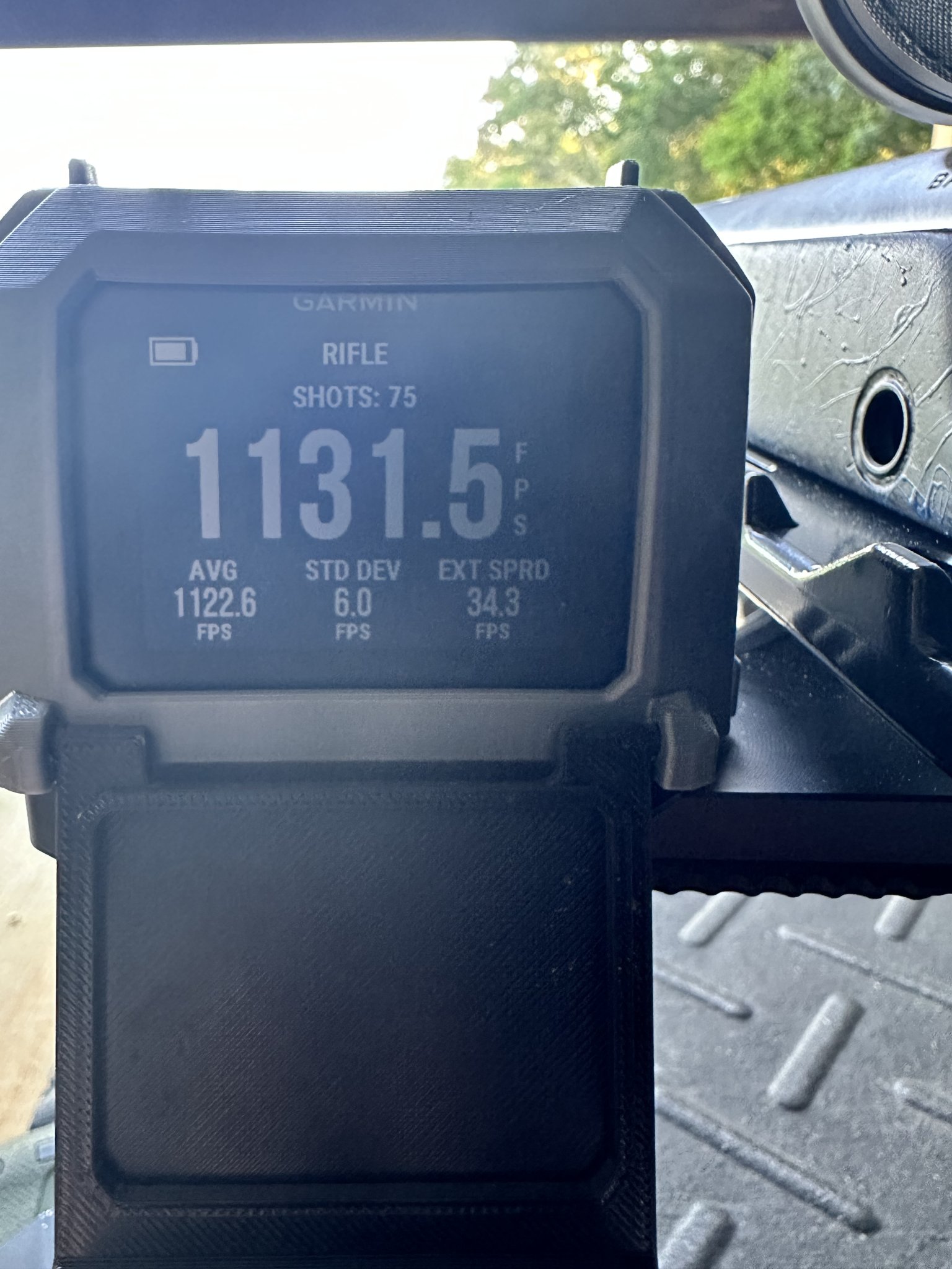

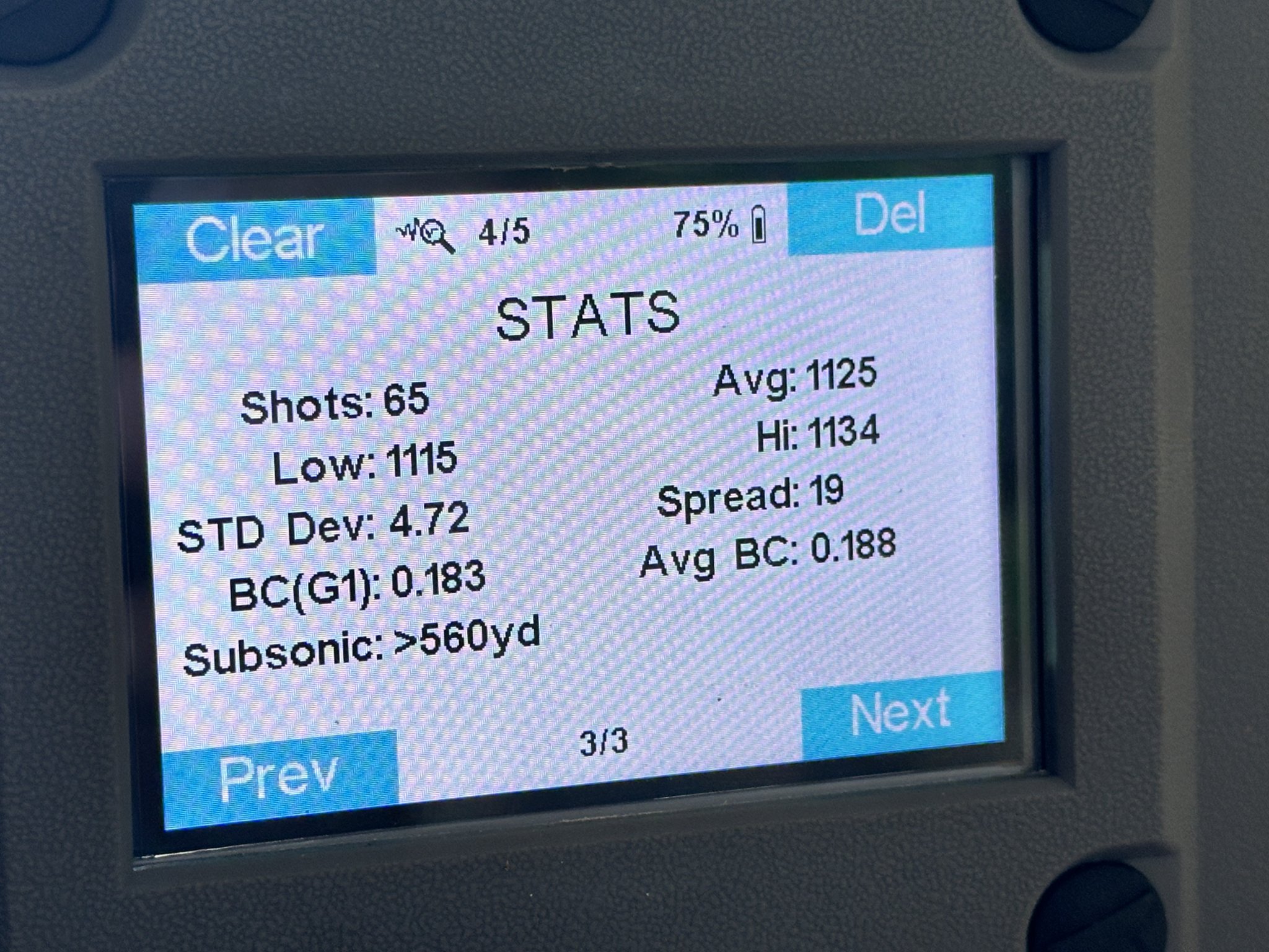

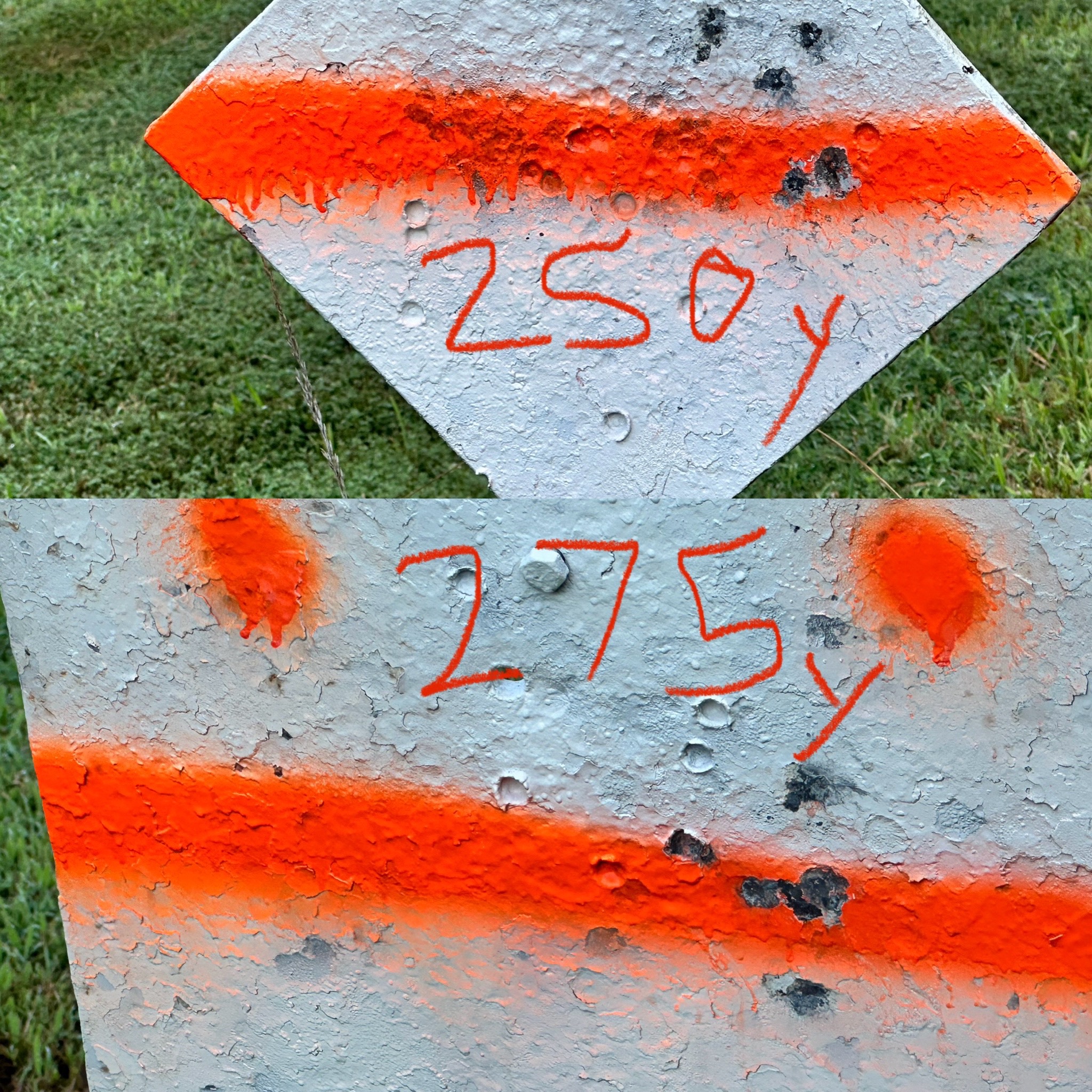

I have a new Brux 14T that is shooting lots of ammo very well. I just finished a lot test with it on Eley Match. I settled on 1 lot but had 3 that were real close on numbers. All photos of groups are of the same lot Shot on different mornings over this past weekend. Barrel was done by Rachel Precision on a Gen 1 Vudoo. It is 25' long and has a Gen 1 EC Tuner. The tuner adjustment has not been touched with any of these groups.
IMG_2177.jpegIMG_2176.jpeg65144BCA-0EA1-4AA1-9463-50488A5C186D.jpeg7D42DCF4-4AED-43D4-BB97-6E34E4C68594.jpeg68A03CA4-D888-40AC-BF71-0559533C936F.jpegIMG_2161.jpegIMG_2164.jpegIMG_2154.jpegIMG_2155.jpegIMG_2156.jpegIMG_2151.jpeg
View attachment 8473403View attachment 8473404View attachment 8473405View attachment 8473406View attachment 8473407View attachment 8473408View attachment 8473409View attachment 8473410View attachment 8473411View attachment 8473412View attachment 8473413
Nice. 1131fps with a 25” barrel. What chamber?
