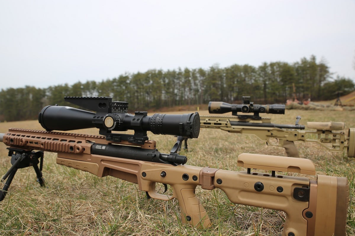

    I heard that the marines are dropping the S&B scopes because they break them. Has anyone else heard this and can it be confirmed. What scope are they going to also.
    That is an old story,
    the S&B being used was a hybrid of Premier and S&B, when they divorced the USMC went to Premier. Since Premier really does not exist I am sure they need a new scope about now, especially with the changes in the industry.
    The USMC has not bought new S&Bs for a while, which is why you see both S&B and Premier and recently I know they bought some NF scopes
    But the stories are a mix of old and new. They didn't want to replay the contract process when the two divorced so they opted to just change it over to Premier, we all know there is no Premier now.

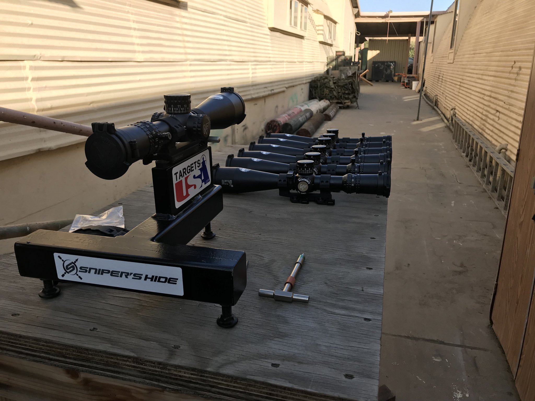

    PS we donated SH Scope Tools to all the School Houses,
    7108946
    These are school House scopes
