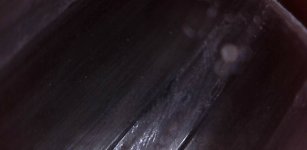

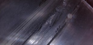

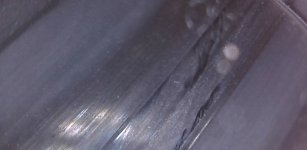

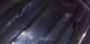

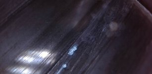

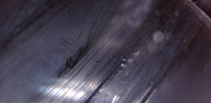

Are these tooling marks unacceptable in a barrel ?

How bad are these ? Can they be firelapped away with the wheeler kit ? Or am I just a retard with a borescope.

Pics are not great and they are dark, are the marks all in one area or in multiple sections in the barrel?
Is this something you sent to a smith or is it a ready to go prefit?

As far as I can tell from the dark images, these rather ugly marks look much more like marks from chambering or crown reaming, and not from barrel production. Is this a barrel blank or a chambered barrel? Where in the barrel are these marks? (I suspect within 3/4" forward of the end of the chamber, caused by the reamer pilot, or within 3/4" of the muzzle from a crowning tool.) As has been said, if the barrel shoots and does not copper up at these marks, no issue. But if the barrel is not up to your expectations, talk to the smith first and then barrelmaker if needed.

This barrel is not acceptable to me....but it's your barrel. I send those back before chambering, unless it's on a rifle, and you own it.
I will still purchase from a company that puts out a defective product, if they replace it right away, without argument. That sometimes depends on who answers the phone.
Accepting substandard work is on you, and the manufacturer never has to change their mediocre to crappy production, because the people accept it.
If I decide to use it, I lapp it before I shoot it. Then borescope it again, then sometimes lapp it again.
