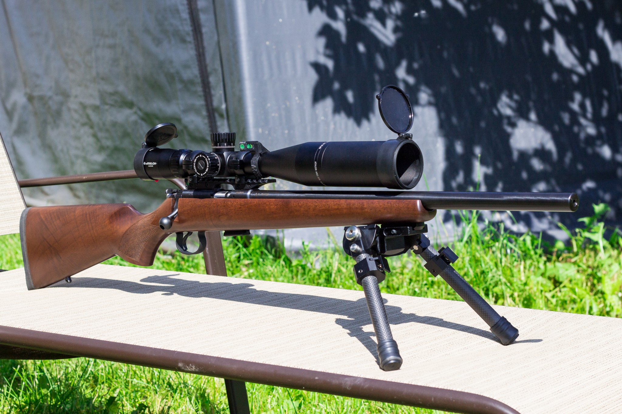

I have a CZ455 Varmint in the wood CZ stock with the 30 MOA Area 419 rail and an Athlon Ares BTR 4.5-27x50. Using the lowest rings I could find (Vortex Hunter lows) the cheek weld is perfect with no riser. Disclaimer - I have a big fat Korean head so your mileage may vary. It takes me about 11 mils to get to 300y so I can get to about 400 on the turrets and 10 mils more on the reticle.
