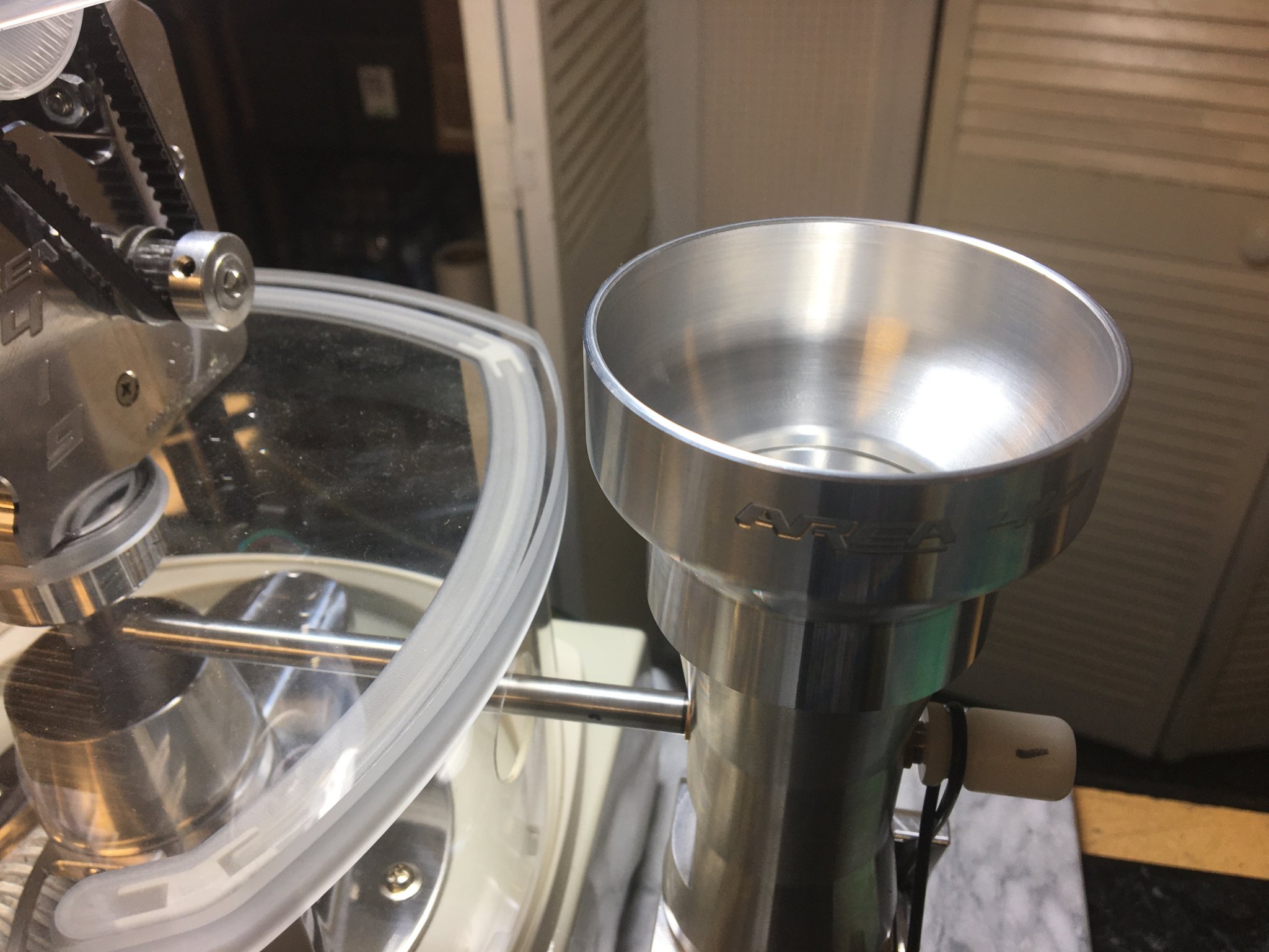

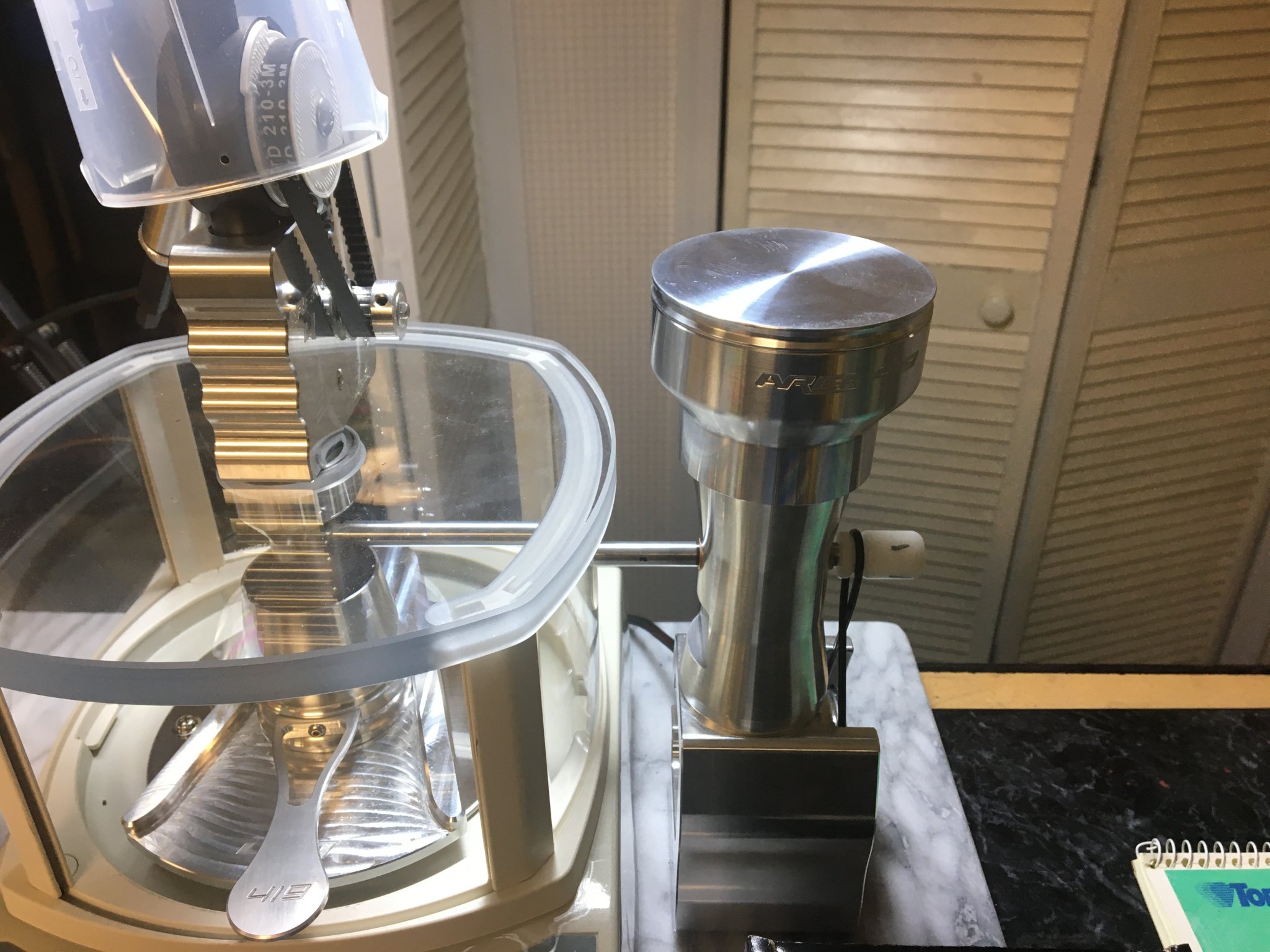

Grab your patchThe area 419 stuff is great but to be honest, it's not really needed with the V3 upgrade. I'm only using the platen, cup and trickler base now. Oh yeah.... and the clear lid.

I found only the clear lid was worth it. Everything else on v3 was as good or better than 419
