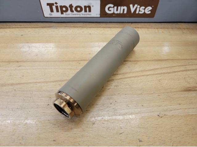

As a side note ECCO machine has converted a few Rugged cans to use a hub style mount. I’ve attached a photo of a Razor converted by ECCO, it has a Q plan B installed.
