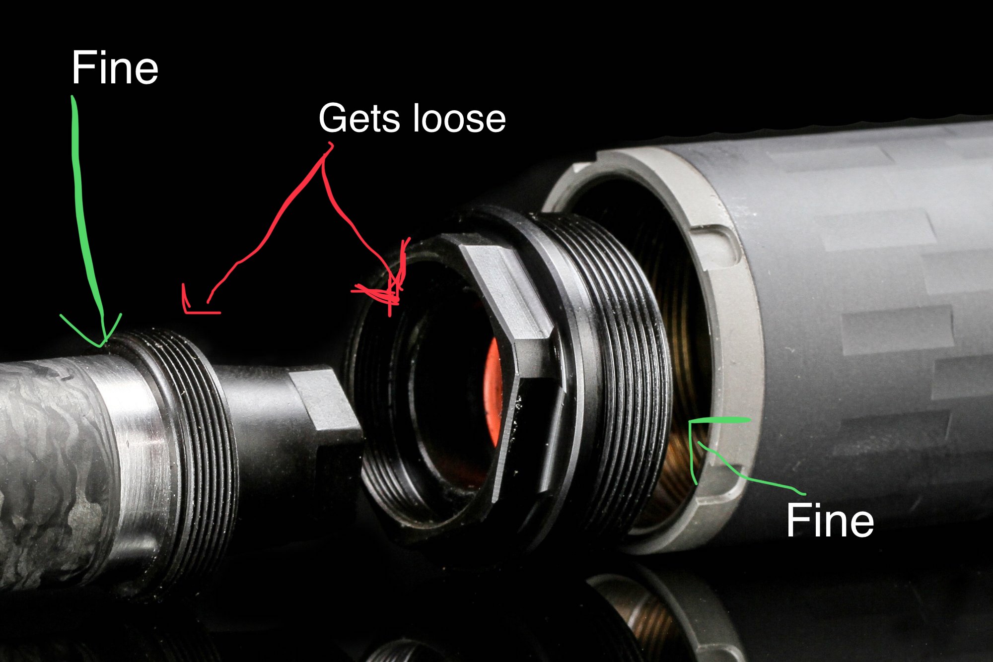

I’m having some issues with these mounts that’s been bugging me.

Anyway, after installing the mount it’s nice and tight. After some time it get loose and am having to re-tighten every 20-30 shots or so. I’m using the wrench every time. It happens on both my omega and hybrid.
Anyone having this issue?
Thanks!

That’s not where my issue is. My issue is between 419 mount and the universal adapter.
Are used rocksett on the muzzle where the universal adapter goes and on the mount that attaches to the suppressor on the suppressor threaded area.
I have no issues with hellfire brake coming loose.
Ahh, I see. I've not had this issue.
Not had that issue with mine. Maybe tighten the mount to the adaptor first and the insert and tighten the adaptor into the can?
That’s a thought, but that defeats the purpose don’t you think?
I’m also wondering if a small film of carbon is ending up on the conical area of the mount causing a gap not allowing lock up.
Will use some steel wool and m7 to try. That’s a pain in the ass though.
