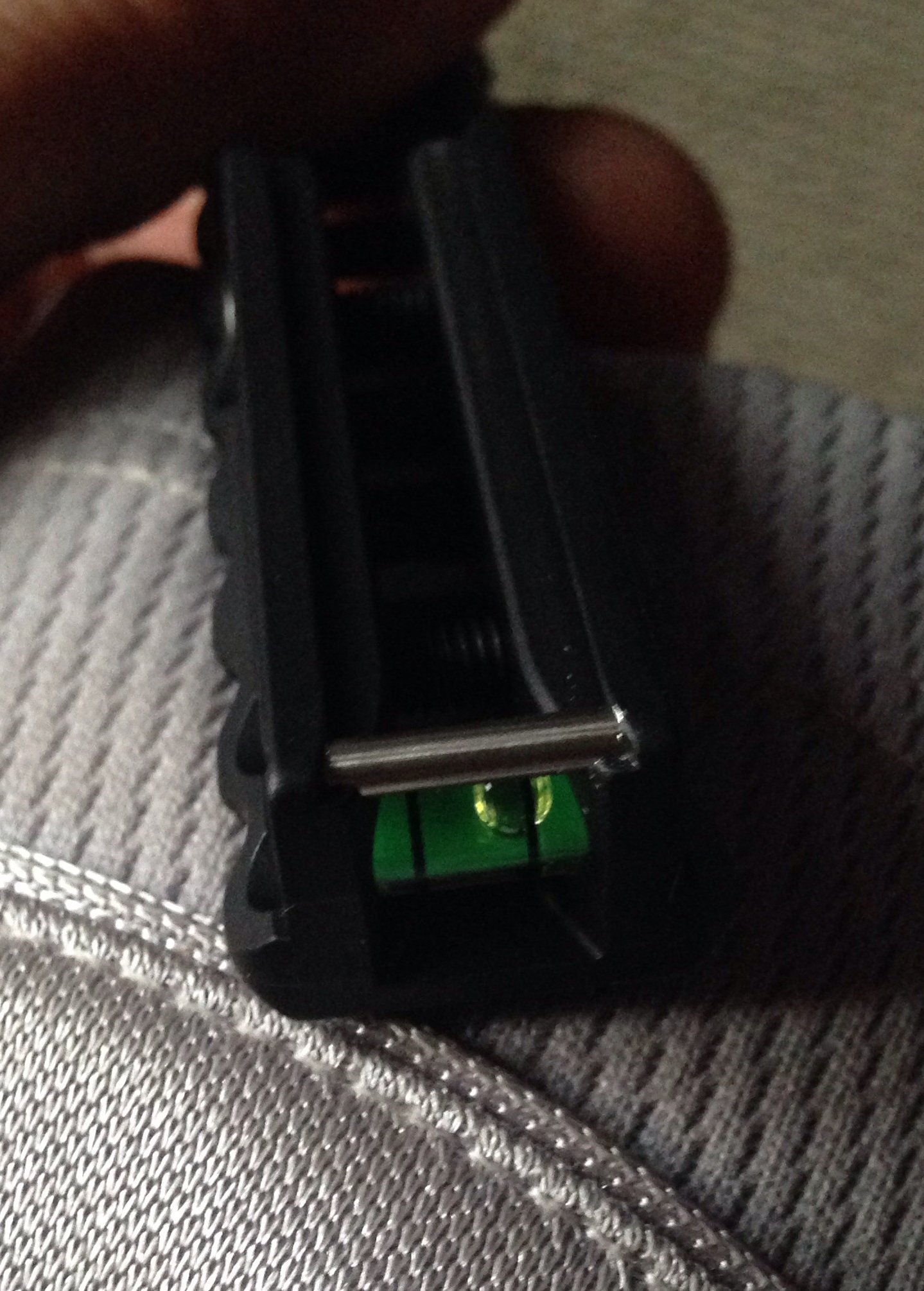

    I have a 419 on my CZ, and am picking up a Savage tomorrow with an EGW. Can't compare them now, but I will say that the 419 is awesome, and works great. You will most likely want low rings with the 419, as it sits a bit higher than standard.

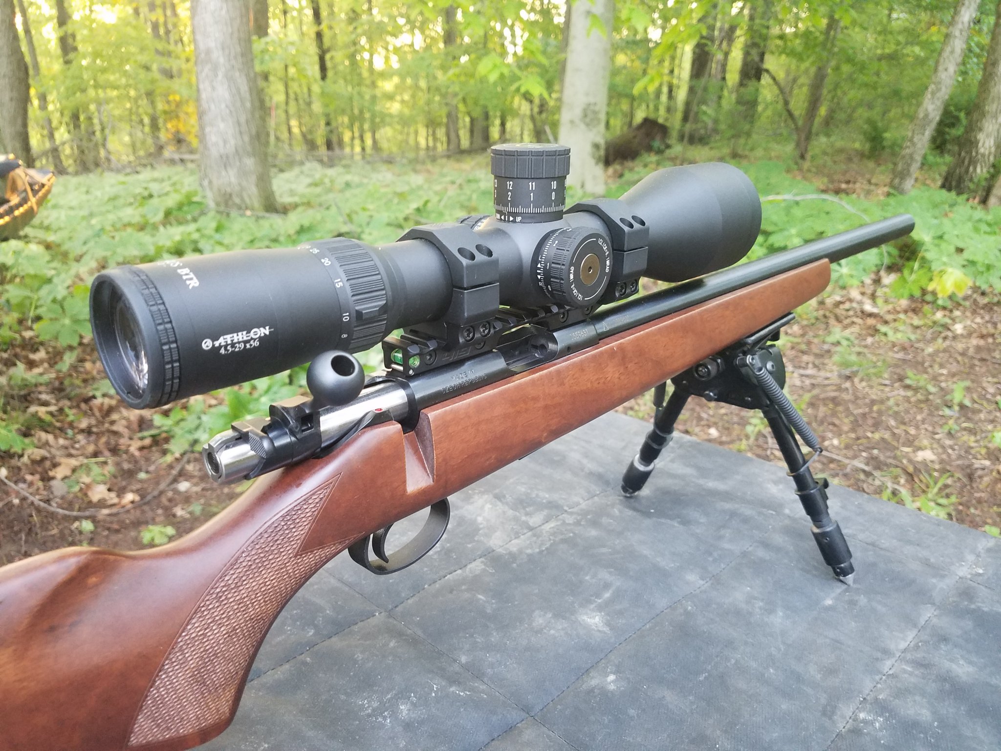

    Just changed out a DIP for a 419 and really like it. Shot it today ... very happy with the purchase. Agree on the rings ... using Seekins lows on a Athlon Ares BTR (50mm objective). Seems about perfect.
    Reactions: Basher

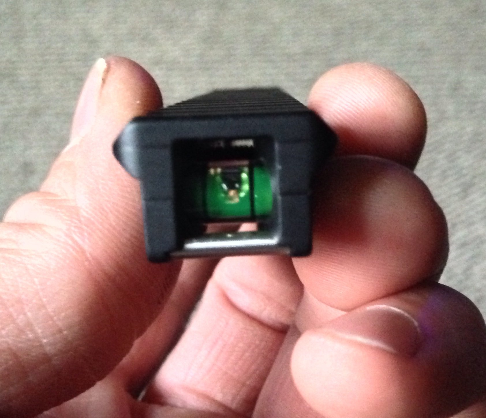

    I've had DIP and 419. While DIP is nice, they do have a tendency to drift under recoil over time, as there's no recoil lug on them. The 419 is NICE. They do sit higher, and they're very snug going on, but they have a recoil lug and a built in bubble level. Well worth the coin.
