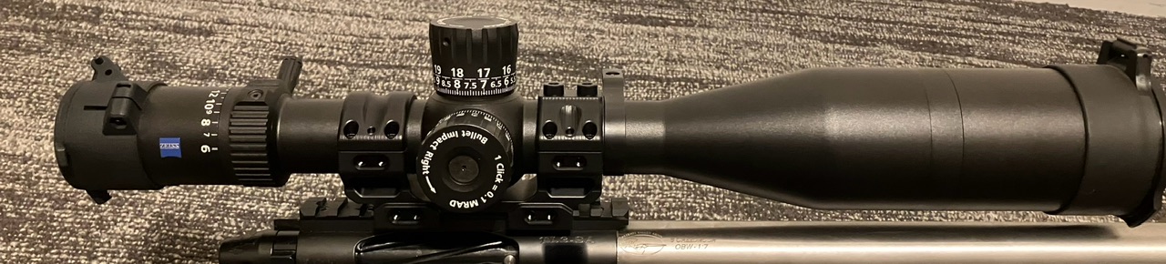

Area 419 Tactical One-Piece Scope Mount
Caba
Feb 25, 2024
131
77
Canada
I'm thinking of switching my scope mounts to the Area 419 One-Piece mounts 9and their hunt rings for my hunting scope. One of my rifles is a switch barrel and I'll be switching out to a different scope for hunting.
For the folks that use these mounts, are there any issues with the fasteners? The ones on my spuhr mount are soft and seem to mar easily.
Also, I'm debating between the send it level adapter or accesory picatinny rail for my send it level. Any reason do go with one over the other?
Thank you.

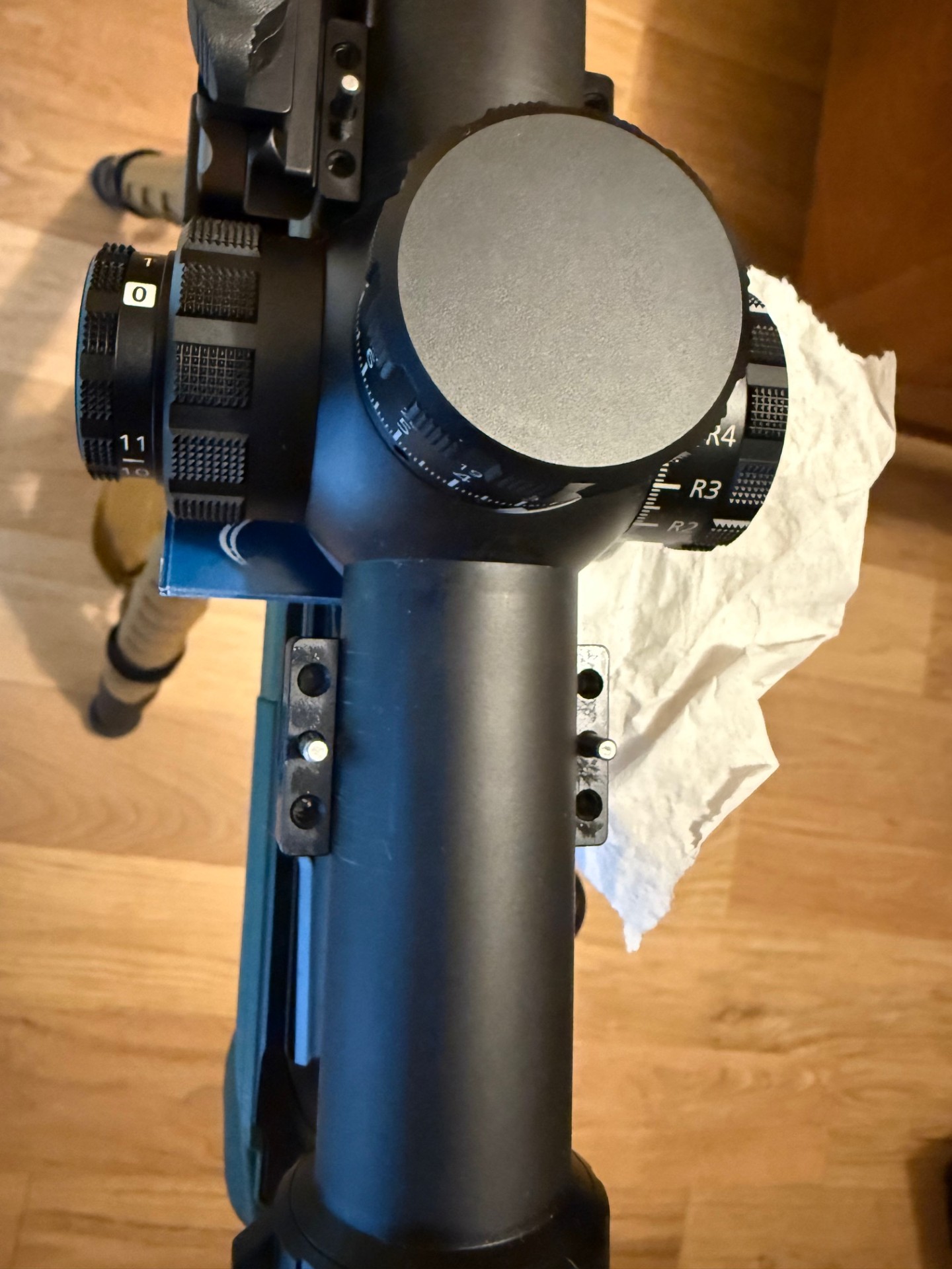

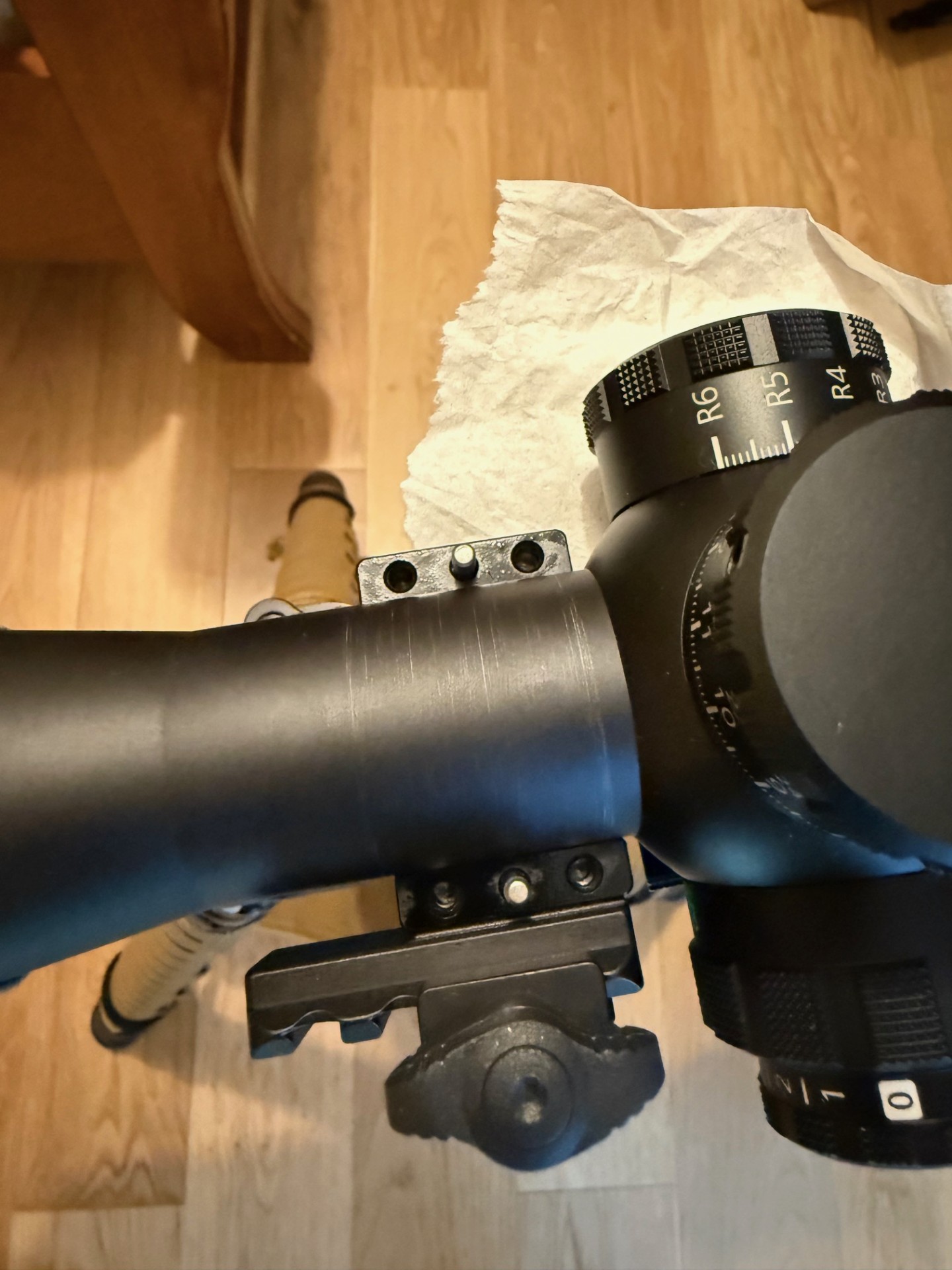

The two 39mm high one piece scope mounts and accessory pic rails I ordered were delivered today.
My first impressions:
-The machining is top notch with no rough edges. Just like all of my area 419 pic rails.
- The case and custom foam is the best packaging I've seen when it comes to accessories and they've included an actual T20 bit and thread locker.
-The steel guide pins made it easy to install the rings, though my rear ring was a bit tight.
-The raw aluminum finish rings seems to hold the scope more securely than other rings I've used.
I followed the youtube installation instructions. After tightening the base screws and going back to level the the scope I noticed a lot of scratches on the scope tube. Most of them seem to be aluminum residue., and I was able to remove most of them with an alcohol patch on the area covered by the ring halves.

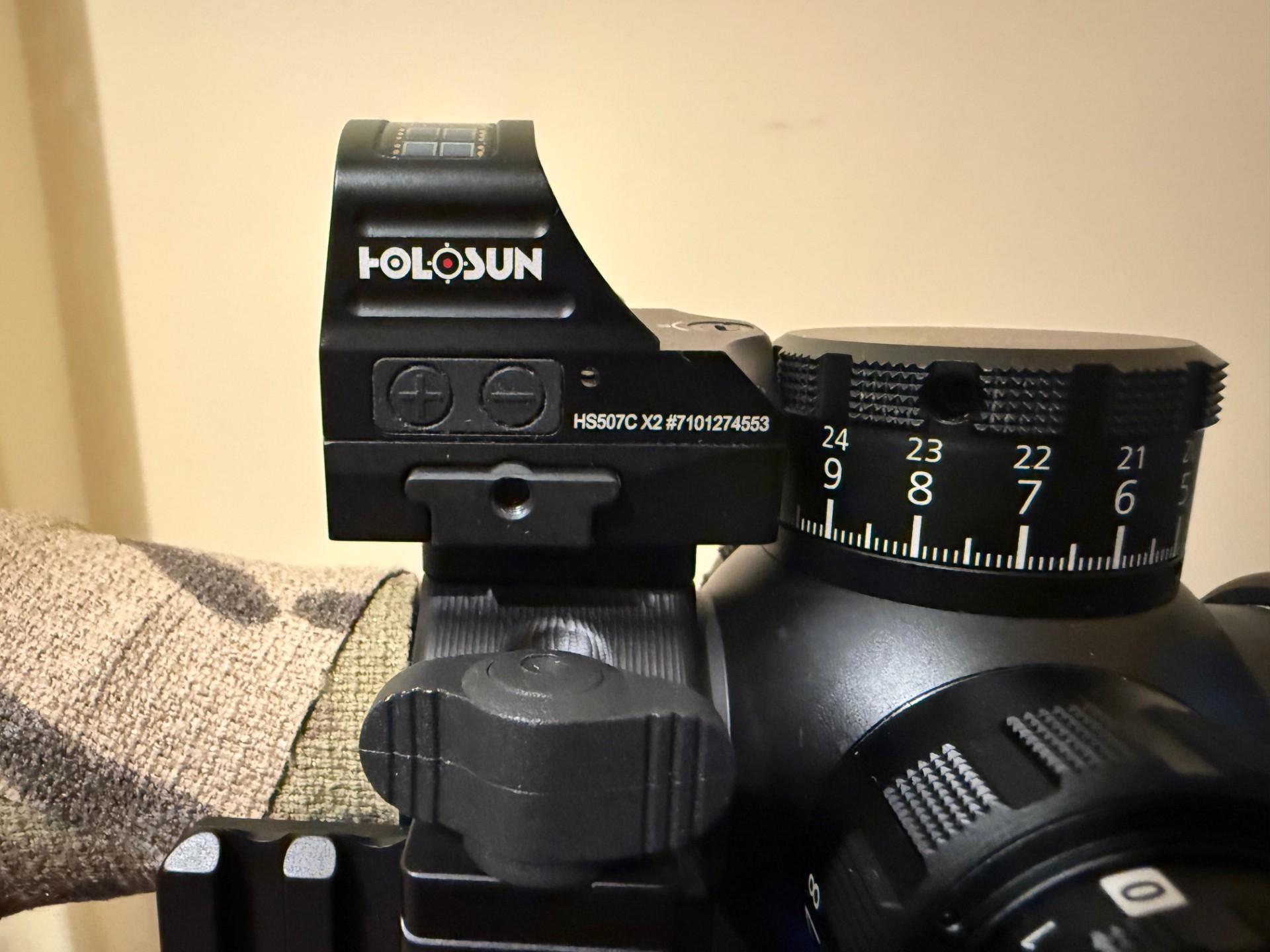

The pic rail at 12 o'clock is the perfect height for my red dot but there isn't enough room to mount it I'll have to look for a different solution or just ditch the dot. I think a low diving board is too high but I don't think there's another alternative. Maye they'll make a 2-3 section pic rail in the future.
In case anyone needs the info, the 39mm 0 MOA 34mm tube mount is 9 oz and 9.7 oz with the side mounted accessory rail.

Oh, and this in RMR (low vs high is up to you) is what you want for that dot.
Low Profile: https://www.area419.com/product/optics-plates-for-offset-mounts/
High Profile: https://www.area419.com/product/highpro-dot-plates/

I ended up removing the scope to see if I can fit the red dot. The mounts did leave faint scratches all around the scope tube. WD40 didn't get them off.
I also found a scratch in the forward ring of my unused mount, that can catch a fingernail. It's going back for a refund. The previous posts stands but I'm not fan of the scratches, I haven't had this problem with other mounts.
