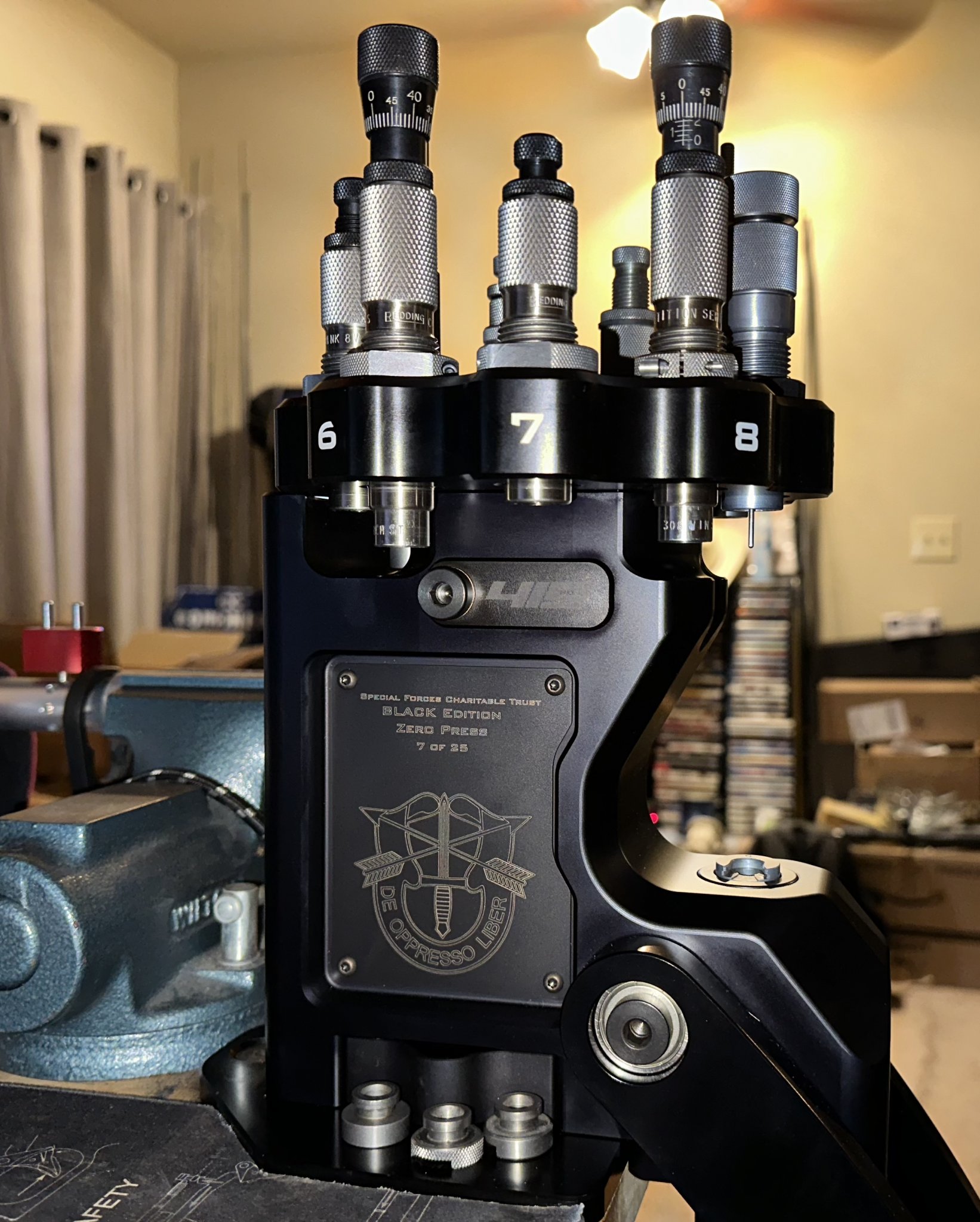

@USMCRUZ You can use any standard shell holder (I have found Redding works best), regular die rings will work just fine after you adjust them to the right depth on your press...I like using the Hornady lock rings (as seen below) because they use a clamping style with the screw, instead of a set-screw that digs into the die threads, so adjusting them while fitting to your press is easier. Also, I recommend getting the Hornady lock ring tool, as well, it's cheap. And the press will mount right to a bench if you drill 3 holes. I recommend putting the bottom plate on your bench as a template, then use a sharpie and trace-out the holes. Then find center and drill them out. Simple as that. You don't HAVE to have all that other stuff, but they are nice to have if you want to spend the money on them.
One other thing about using those locking lock-rings, is that you can remove and swap-out the dies and reinstall them and you don't have to reset them each time, because the lock ring holds it's place because it's tightened to the die, not the turret.

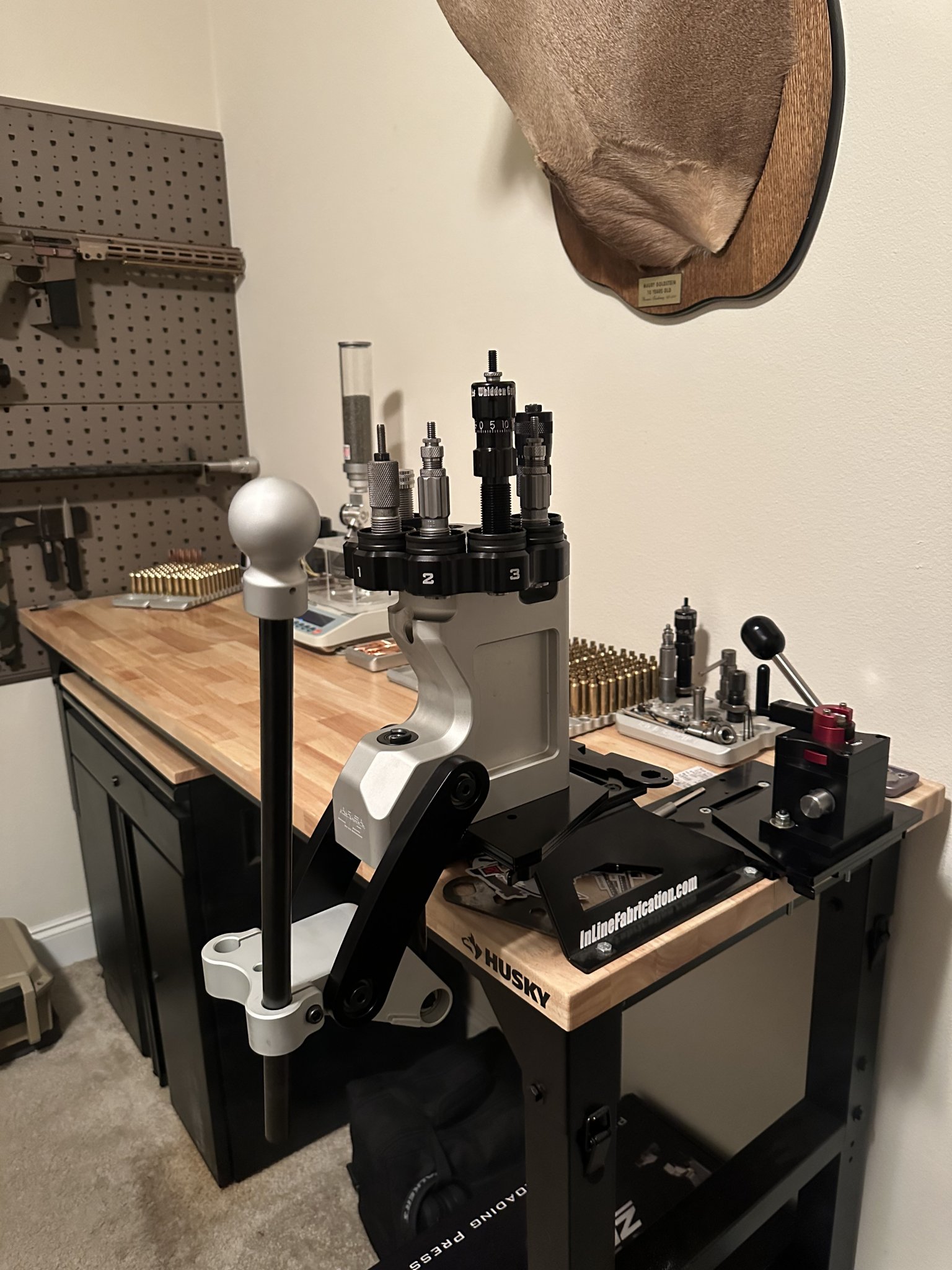

The stand is handy especially if you will be doing large batches of cartridges as it is a better height. I like the lock rings for the solid purchase and wider surface area. I reload a 450 No2 Nitro Express cartridge on this press (barely) the case is 3.5 inches long and COAL is 4.28-4.30.
The stand is definitely not necessary if you are permanently mounting the press. I use the stand and clamps because I move my press around and also take it to the range. My T7 is also on a stand and I switch them around depending on what I’m doing. At the range I can have them all loaded long and do a bullet seating test with minimal waste of components and time.
