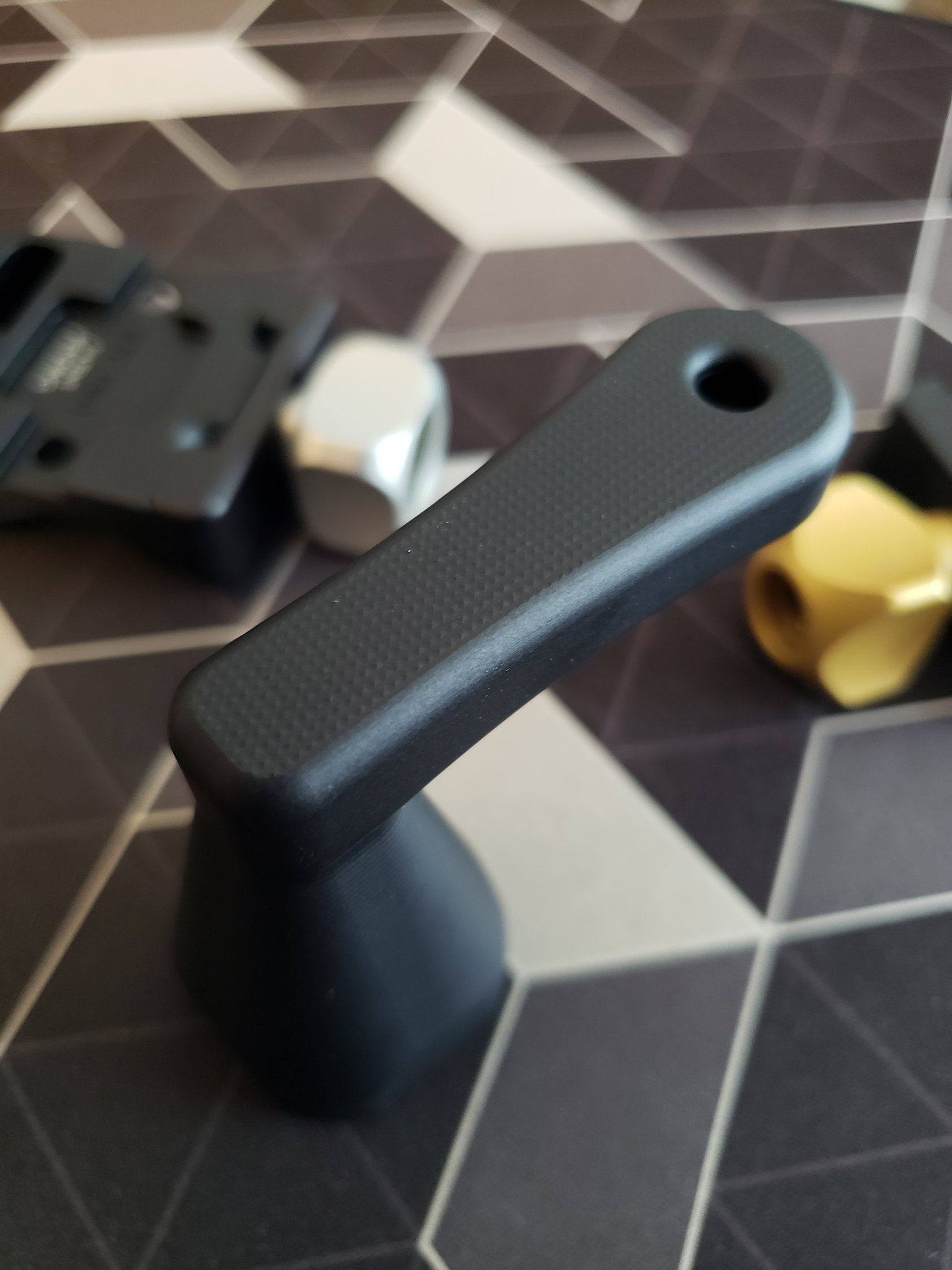

The ACC rail likely too narrow and you'll need to keep the pins installed
These help though

Interesting lever. Does that replace the gold thumb nut on the Arcalock? Or does the big end slide over it? Are those for sale anywhere?
