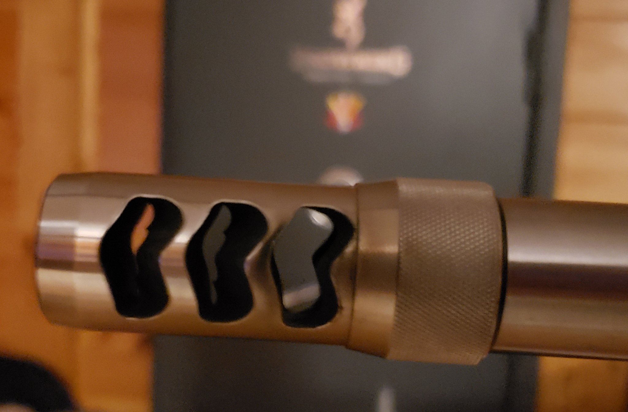

Area419 Hellfire is AWESOME
BisSilent
Trailer Park Engineer
Jun 15, 2020
442
620

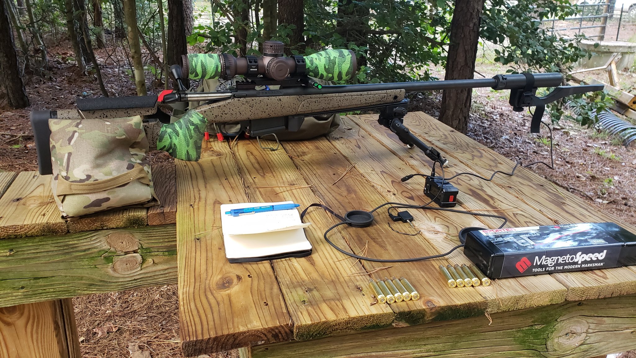

@NorthWesterner said, "Get the Hellfire!!!"
He is right, this brake is amazing!!! The rifle barely moves with a 6.5 CM.
Nice looking rig, were you running a different brake before or no brake?
Thanks, this one is a new rifle(18.8lbs) but I was shooting a Bergara 6.5CM HMR(21 lbs) with a Surfire Supressor. No comparison for sure even with the Supressor off and using the Surfire Brake.

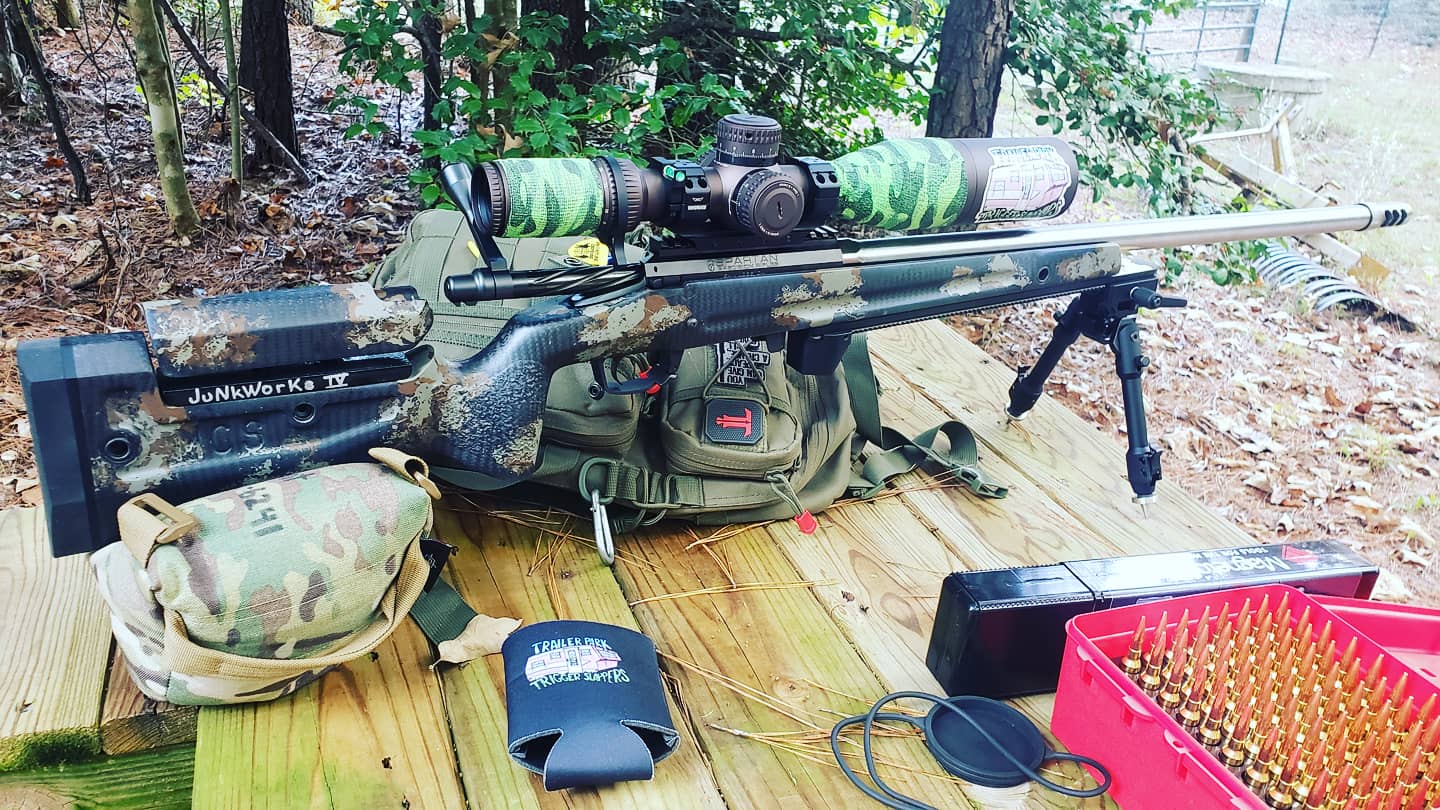

It is a great brake. As wade says above, they are something when you're just a few inches from them. I was at a local range recently doing some load development, I guess the RO thought it would be a joke to put a guy right next to me (about 18 inches away). There were several spots, but he seats him almost touching me. The first few range hots, I didn't shoot as he had a magnetospeed and was doing the same thing. He asked why I wasn't shooting, I told him because my brake will jar him a bit. He blew it off and said no problem go ahead. Next session, I fired a 5 shot, blew over his LCD for his chrono, sent some of his loose brass across the table. He looked at me wide eyed and said "That thing has a bit of a breeze doesn't it?" We laughed, no harm no foul, he wanted to look through my rig and I let him run a few shots. It was a good day, still I felt bad haha.
I'm liking the Area 419 Hellfire as well. I changed from a ZRO Delta Cowl Induction brake which was very good at reducing recoil, this is now going to be for sale. The reason I changed was so that I could use the 419 suppressor mount.
I run the same system paired with TBAC ultra can’s. Just wait till @BisSilent tries @TBACRAY cans!
Reactions: BisSilent

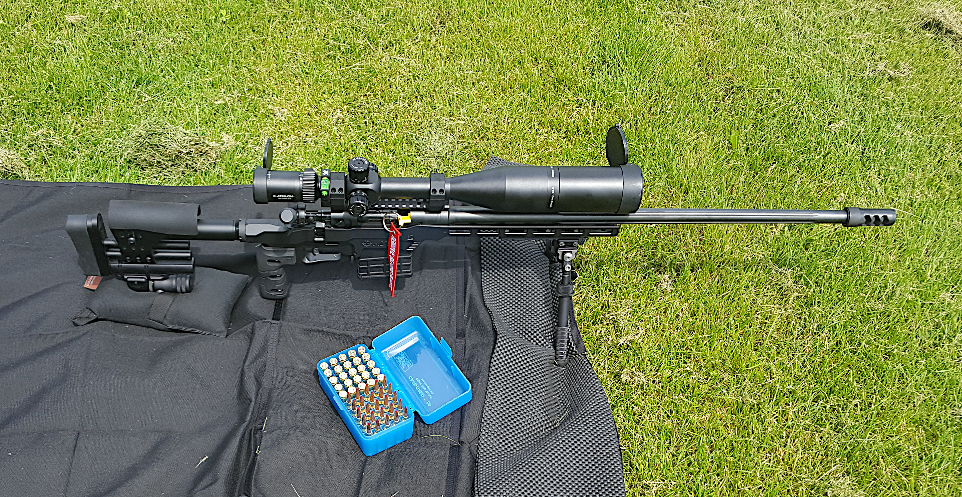

Love my Area 419 Hellfire, best break I have used. Super easy install like others have said.
The easy on easy off is great, for some reason I always thought it was a pain cleaning with the brake on. I guess because I had to clean solvent out of each port and it seemed to hold just a bit of solvent in front of the crown.
I have a Hellfire on a 6.5 Grendel 20 Inch barrel and I have no issues with it. I also like how quickly you can remove it and switch it with a can since they make adapters for them to fit the break adapter.
Agreed. I just pop the brake off and put it in a dish with CLP and let it soak while I clean everything else and then scrub it down and wipe it off and pop it back on.

Back on point. I ran a test by switching between each shot from the brake to suppressor, back and forth for three shots, then adjusted the scope up 1.3 mils and with the suppressor on, I shot three more rounds into the same group as the brake. I was using Federal 168 GMM. I do like how this AR10 shoots. Very mild recoil with brake.
