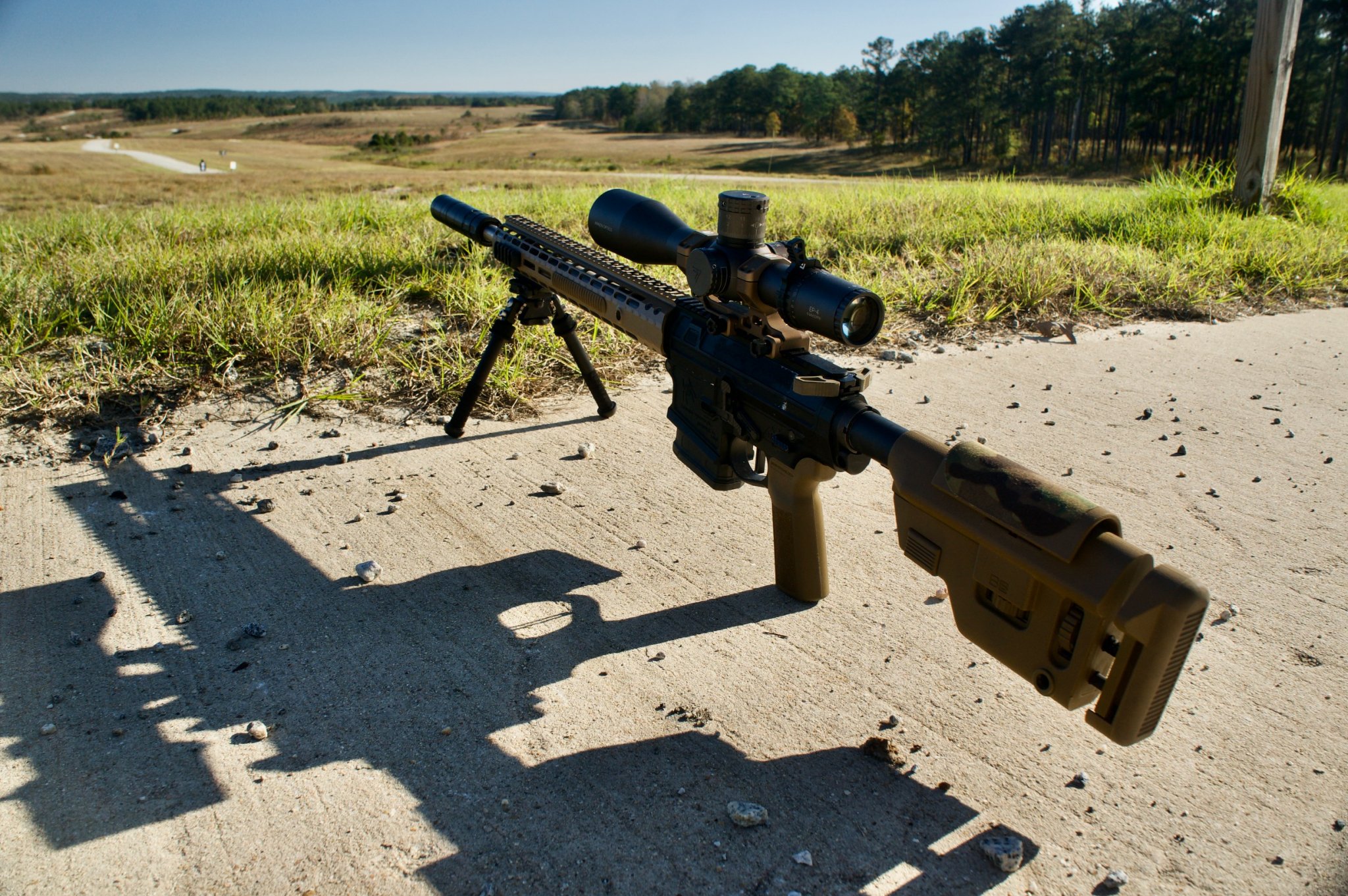

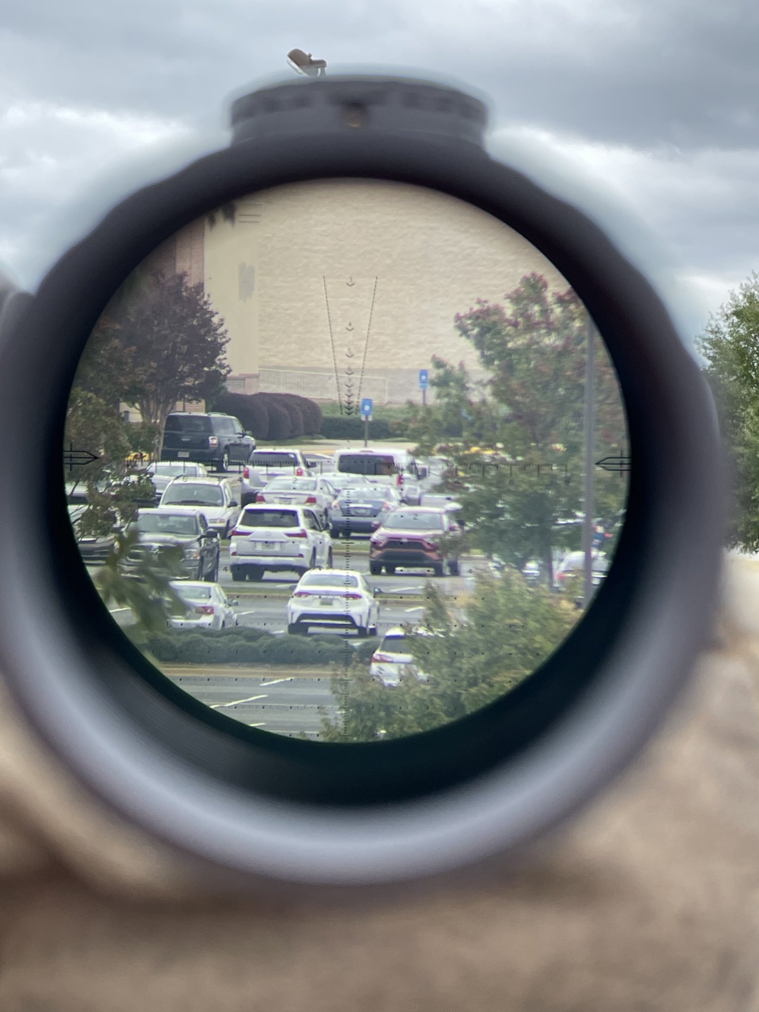

This rifle is my trainer and loaner for when we run courses. She a pretty run of the mill .308 Franken rifle. But shoots tight, is super reliable and predictable with 175gr match ammo. What I do want to highlight is the optic. This is the Arken Optics USA EP-4 6-24x I picked up a few weeks back. Other than zeroing the rifle I hadn’t spent much time behind it. The more time I spend behind the optic the more impressed I am. The glass is what really sets this optic apart from anything else in its class. It is clear that Arken spent the majority of their focus on the glass quality (puns intended). I am super impressed with the clarity, crispness of the reticle and color transmission. I don’t have any quantifiable evidence to bring to you on it’s performance thus far. But I can say that switching to this after spending time on other quality optics, I wasn’t disappointed. Full disclosure: the reticle picture taken with an iPhone held behind the optic, white car is at ~860yds.
