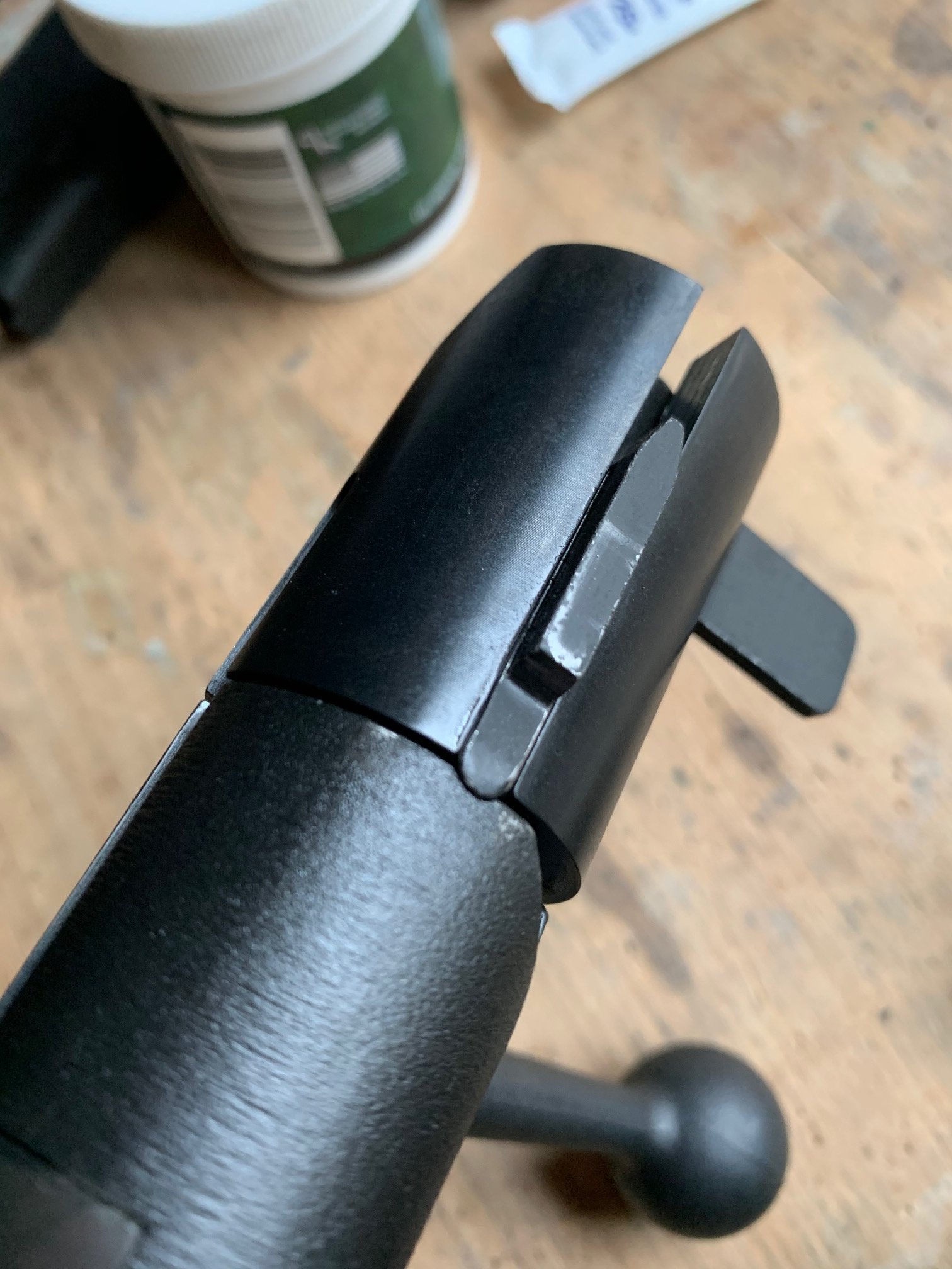

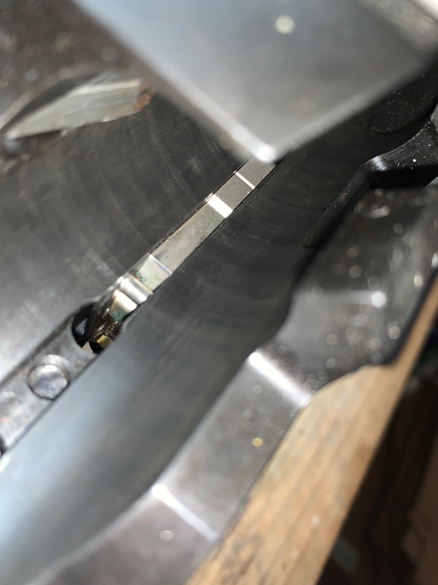

So I take out the bolt, looking at the striker face where it engages the trigger facing -- there's an odd angled portion where it appears to be receiving abnormal wear. I can't see how that would be related, but photos attached -- because why not....
Looking at how this trigger works, what I've observed prior -- I think the issue really comes down to tolerances -- if you force that bolt all the way forward it's going to push that trigger bar down. To test this, I held the trigger forward and slammed the bolt a few times. I can definitely feel it pushing that trigger back when you run the bolt hard. When I say running it hard -- I don't mean some obscene amount of force that one would think might damage parts -- especially on a 50BMG. You can run it with one finger and cause this failure.
