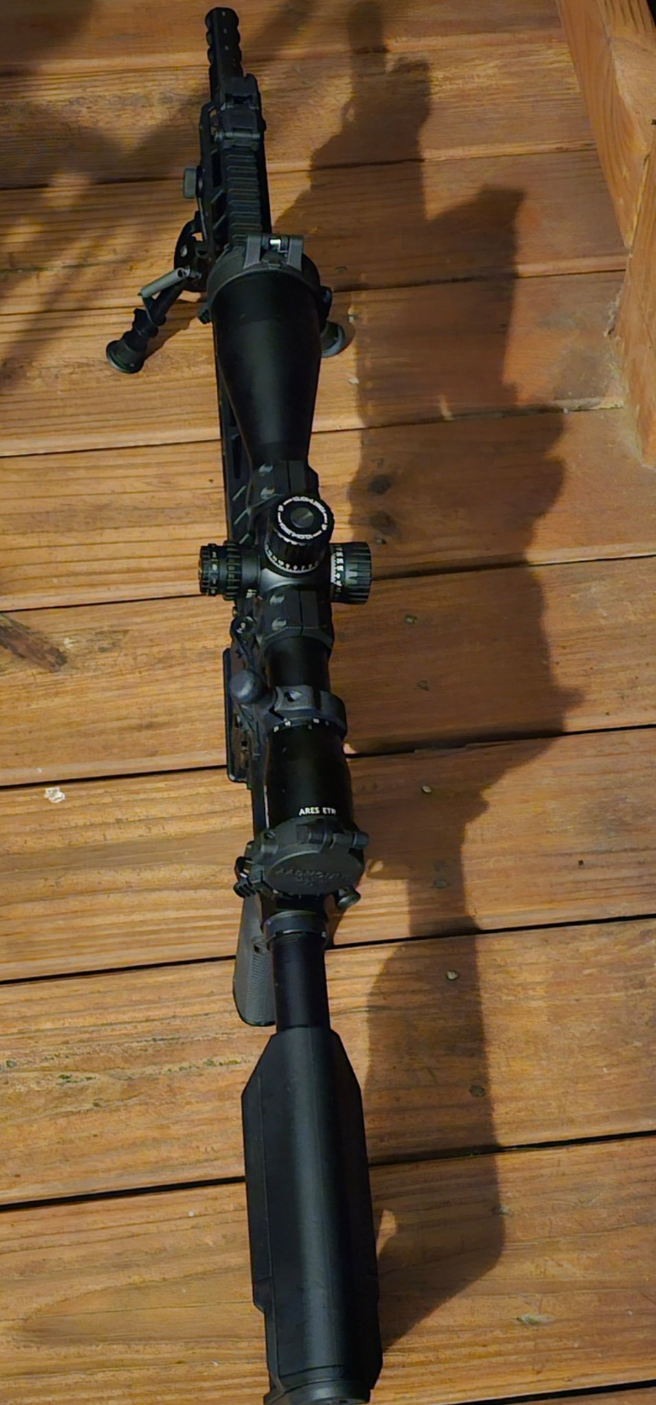

I cleaned, lubed, removed the brake, added a Surefire 3 prong, attached my Atlas bipod, borrowed a scope and mount from another of my rifles, and headed to our property to see how it shot.
I shot 4 different types of ammo. I didn’t have a ton of time so I didn’t take pics of all the groups. I tend to shoot my gas guns faster than most do while shooting groups. I break a shot, follow through, and as soon as the reticle settles back on target, break the next shot. I don’t usually wait for a cool down. I tend to find out fairly quickly if the gun strings shots or chokes when it heats up. Everything I shot today was at 100 yards prone. Atlas bipod and a rear squeeze bag.
I got a rough zero and just plinked a box of federal xm80 away. No malfunctions. The gun had a soft recoil impulse so I didn’t mess with the gas block. For those who care, 4:30 ejection. Brass piled up about 5’ away. Roughly 2.5-4 moa groups from 2.5-4 moa ammo. Cool
I had half a box of 168gr Black Hills Red box ammo. This ammo has always shot well in my LMT guns. It usually produces .8-1.2 moa groups from the chrome lined LMT barrels. 5 shot groups from the Armalite were about the same, one .75 and one 1 moa. No malfunctions. 4:00 ejection pattern. Didn’t adjust the gas.
Next up was Hornady 168ELDM Match. No joke, 3 moa 5 shot groups. I shot 2 groups and quit with this ammo. 4:00 ejection. No malfunctions.
Last ammo I shot was Hornady Black 168gr AMAX. I shot a 5 round group that was about .7 moa. I figured I’d give myself and the rifle a good challenge and loaded up a 20 round mag and shot 1 20 round group. 4:00 ejection. No malfunctions.

Since my last post, my can was approved. Socom2 mini. Gas block is still wide open. The gun functions perfectly and accuracy has stayed consistent. 600 yards is as far as I’ve gotten to shoot with it. On clean steel the first 5 shots with factory 168 amax measured 4 1/2”. This was shot prone with a bipod and rear squeeze bag. I’ve fired almost 300 rounds of various ammo, factory and hand loads, suppressed and unsuppressed with no malfunctions. The only change from the factory configuration was removing the brake and installing a Surefire 3 prong flash hider.
