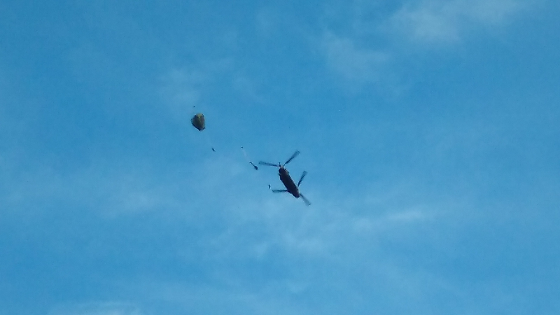

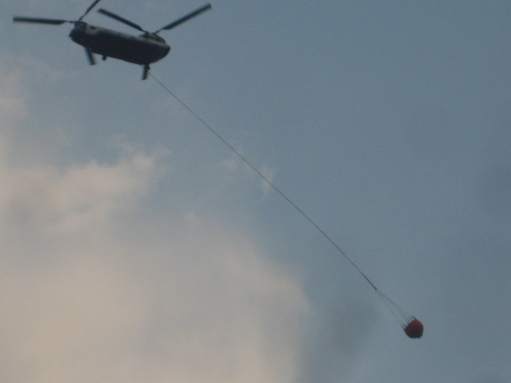

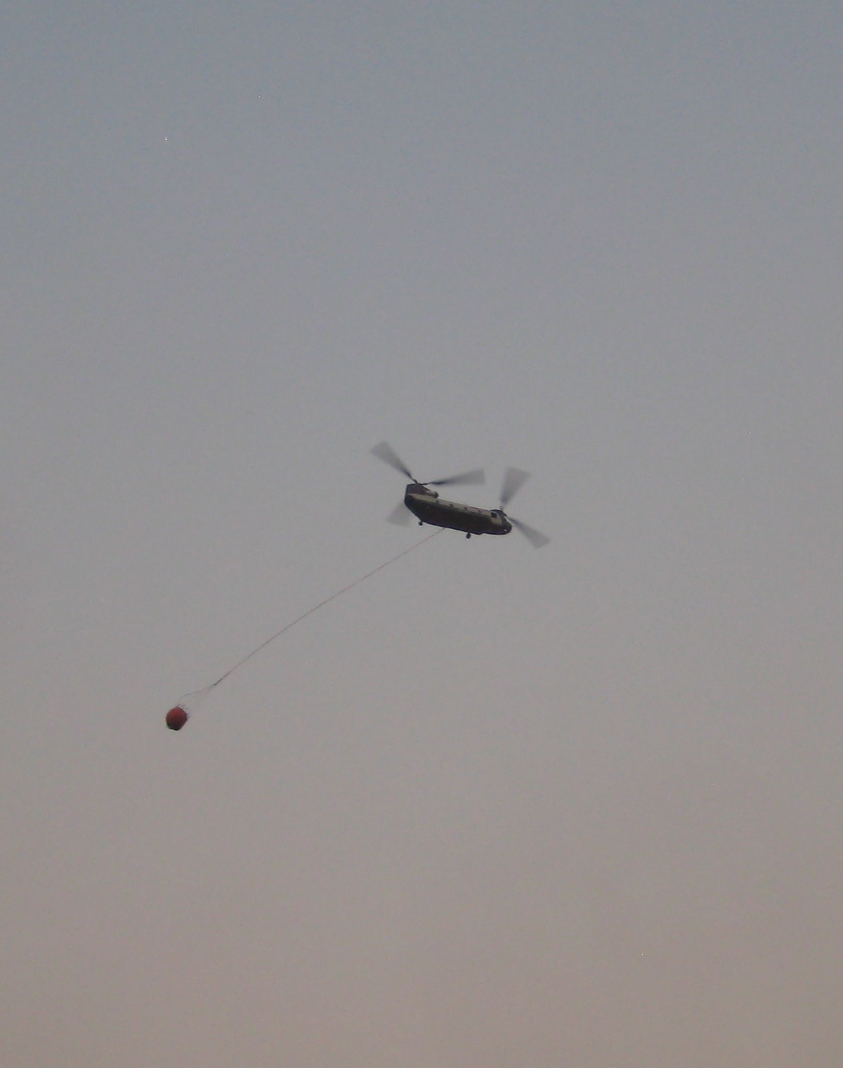

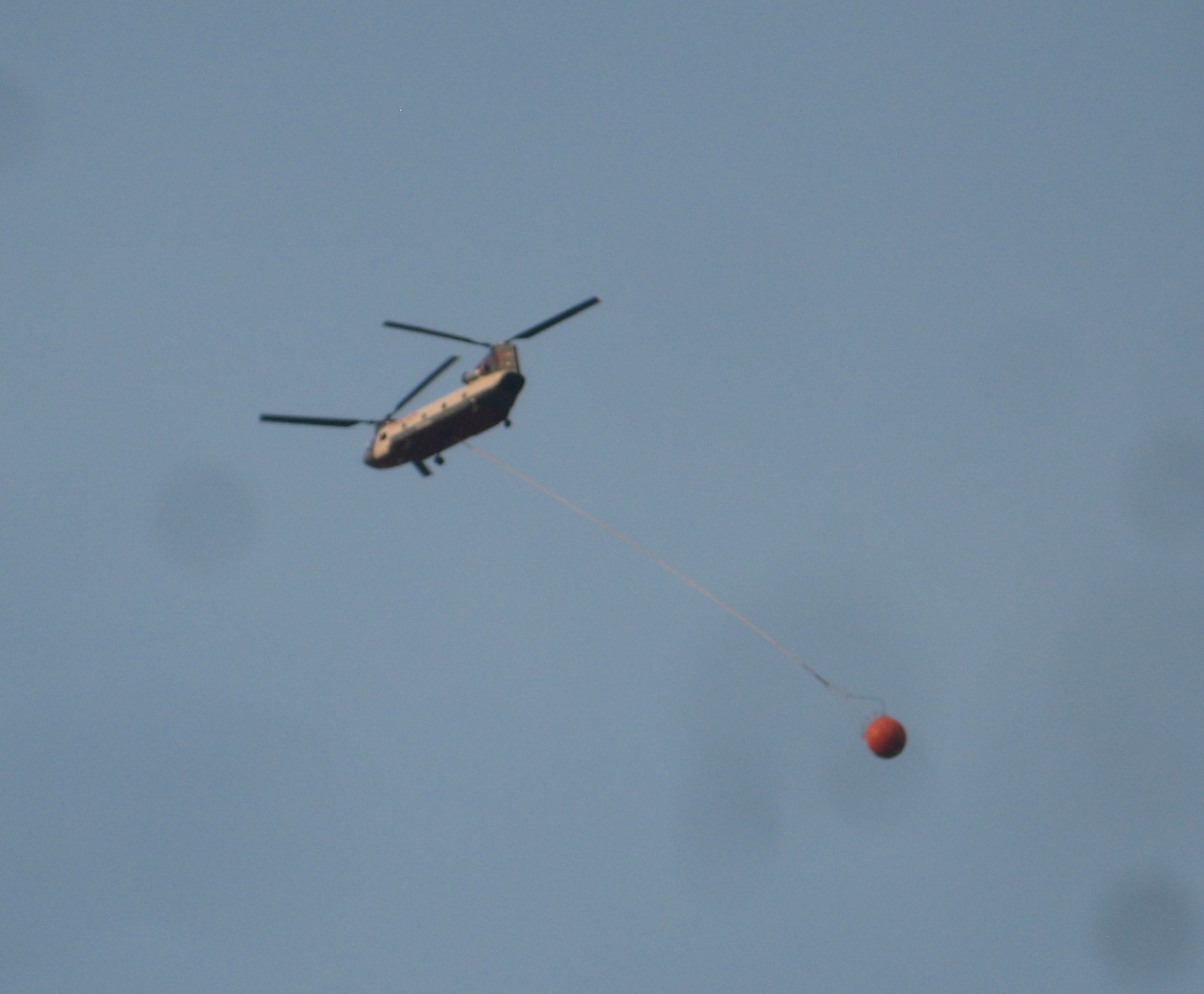

This one is flying over my place while fighting a fire near Lolo, MT
Reactions: brianf
