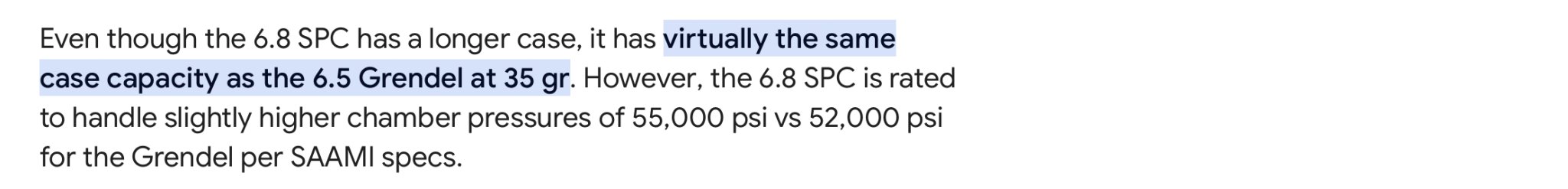

I agree, it’s a bummer it didn’t take off. I think it all comes down to marketing, hype, and the name. Oh and the fact that it was neutered by the spec 1 and 2 chamber so factory ammo has to be de tuned to work in all guns.
Reactions: Edsel
I think the 6.8 SPC suffered from not being 6.5, in a time when EVERYTHING new was 6.5. And, the 6.8 mm caliber has always had lackluster bullet options. And, that’s from a 270 win slut…
Reactions: simonp and Edsel
That is my understanding. Something with the first gen having a short or tight freebore that raised pressure. What ever they did on the 2nd gen allowed higher velocity/pressure. But since both chamber the same ammo the factory ammo has to load to the worst chamber to keep it safe in all guns.
Kinda the same reason you won’t find factory 223 ammo with bullets seated long to allow max performance. Most factory ammo is loaded to allow it to fit in AR mags which neuters it.

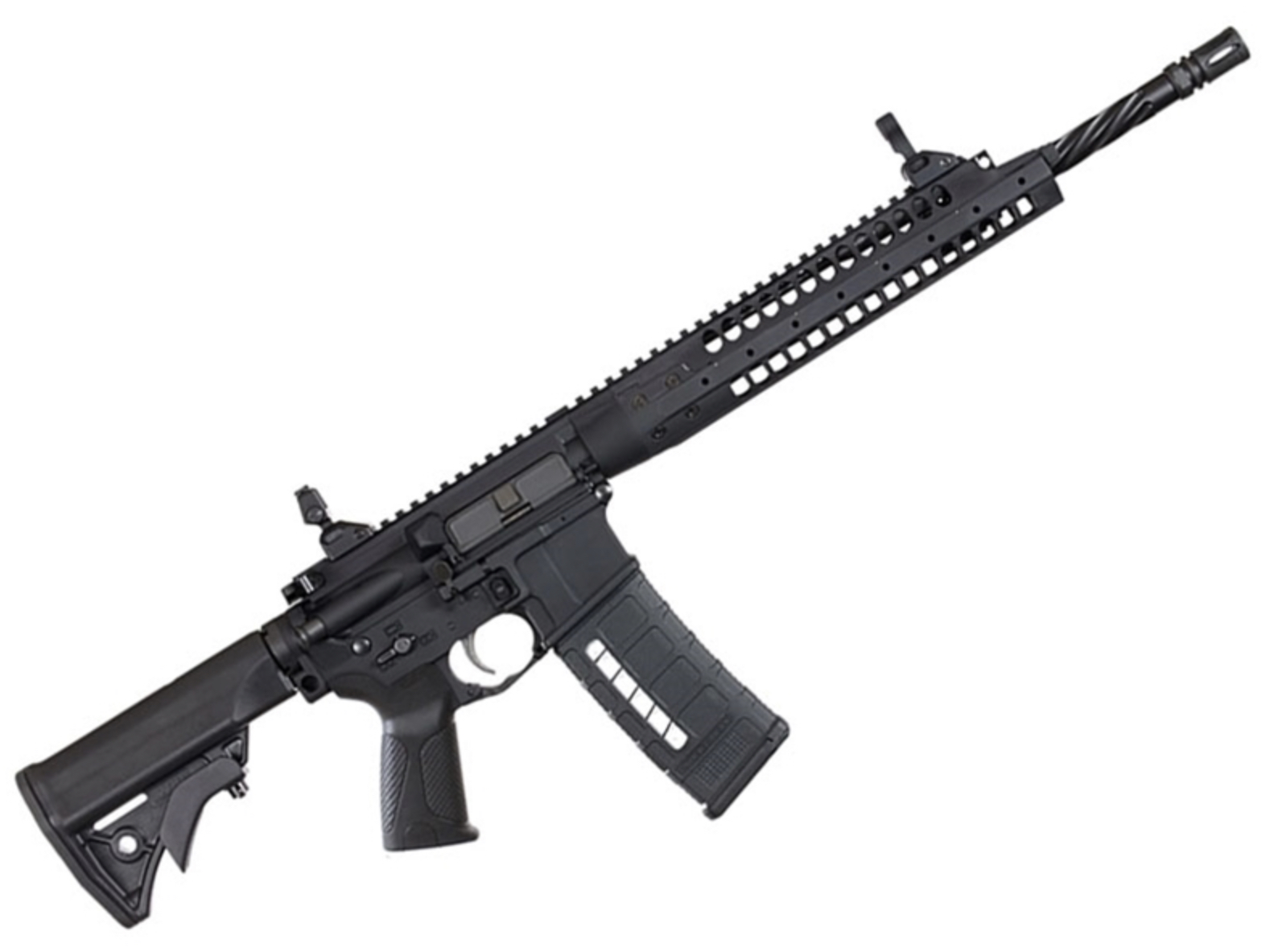

What the hey.
Well, I personally would not like to have Kalashnikov - curved magazines in an AR platform unless they were rockers.
Damn.
I can’t help but drool over the looks of that (already assumed to be grossly inaccurate) LWRCi.
Buying one will be like welcoming another Kalashnikov, only that there’s no cheap blaster ammunition to take for granted.
Giving in will sink a number of projects!…
