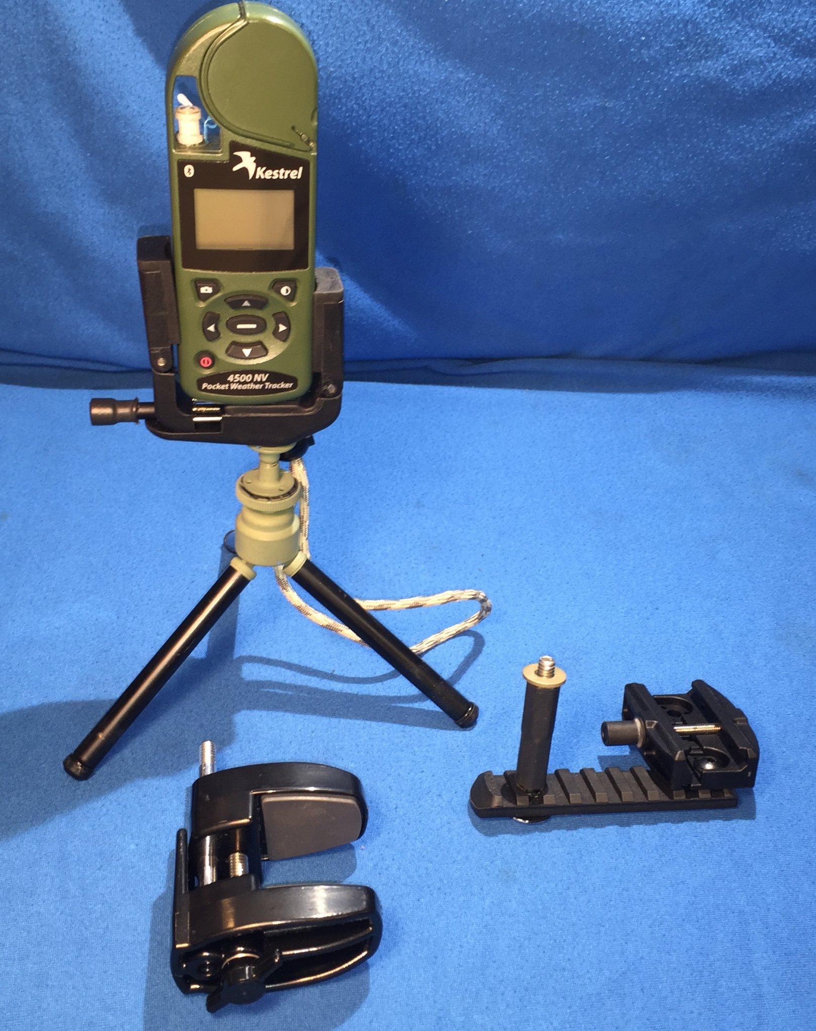

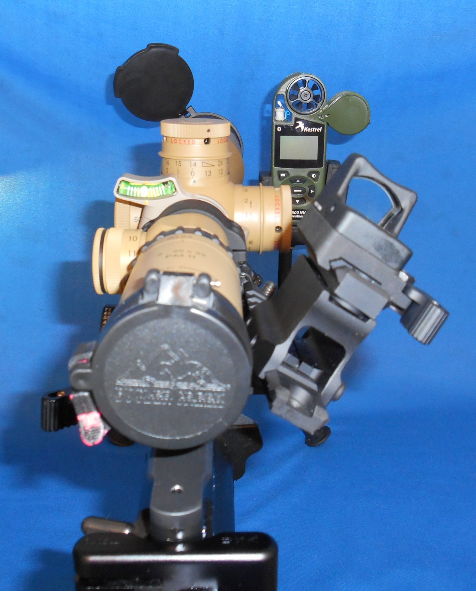

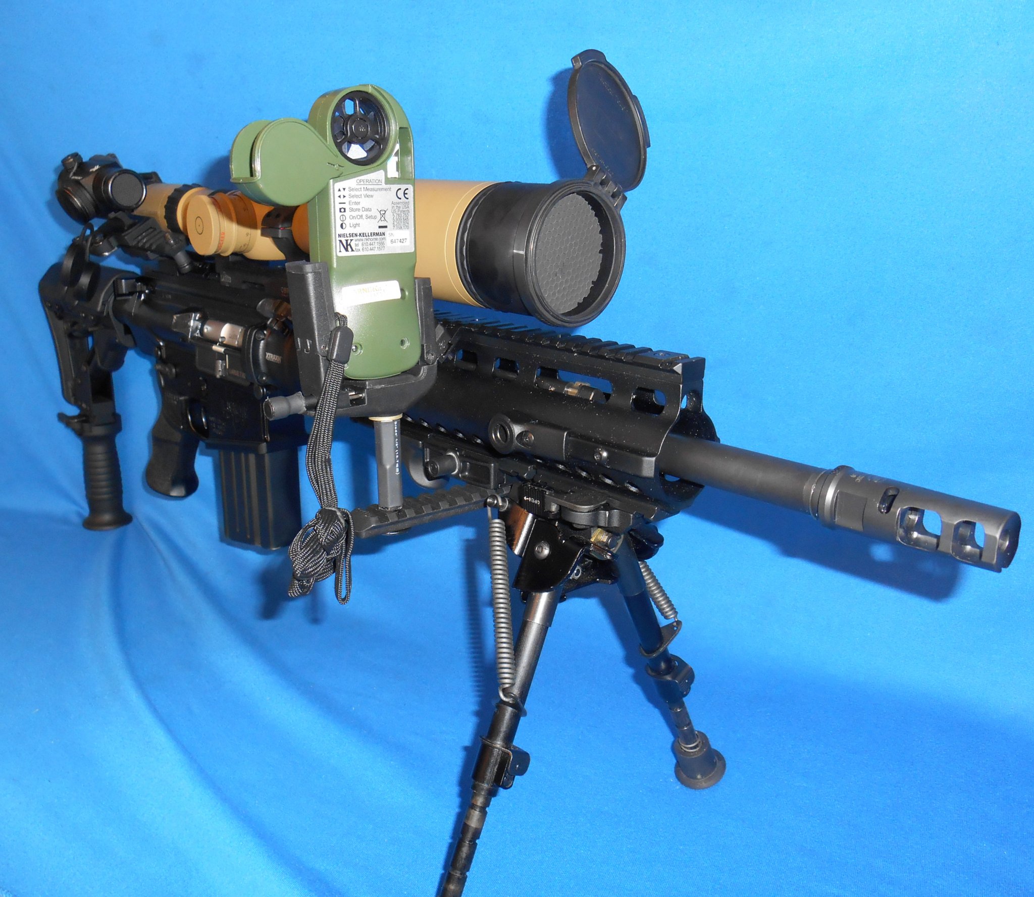

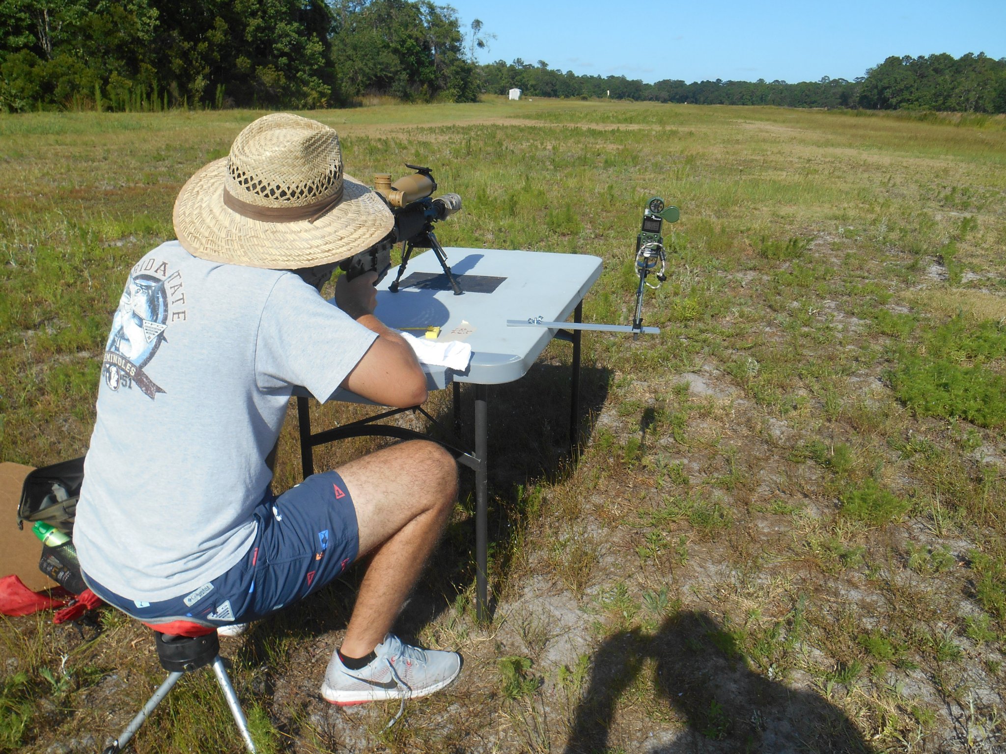

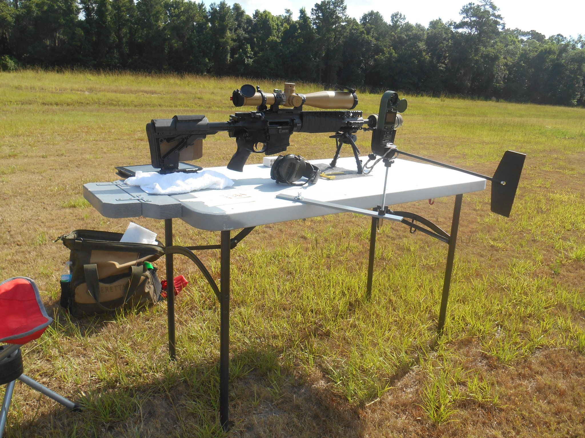

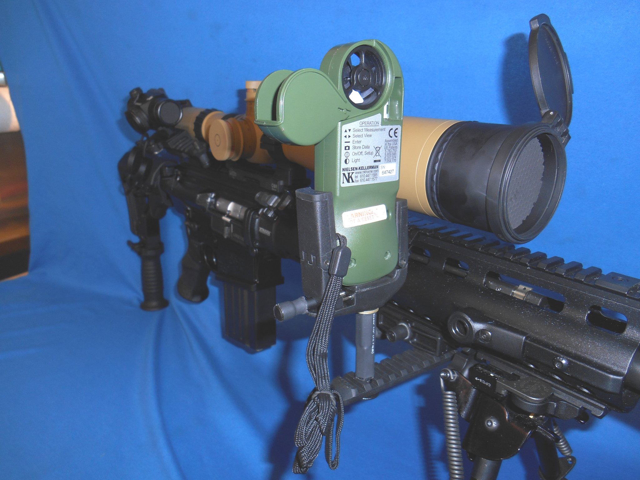

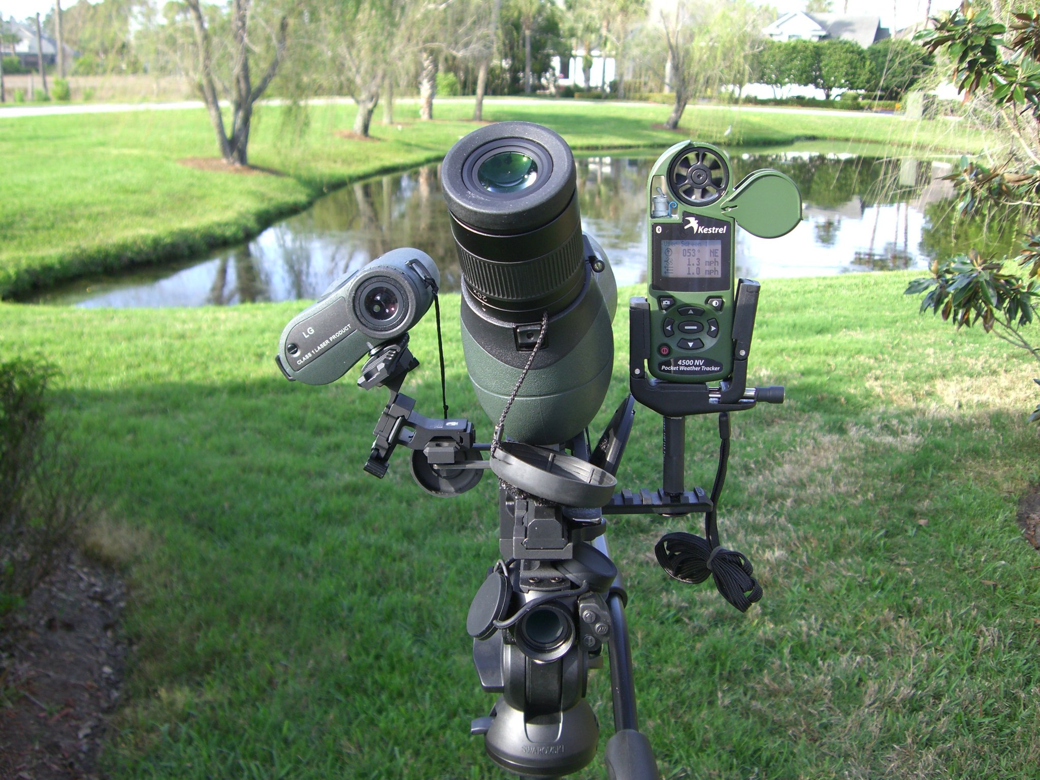

A few different ways I have mounted the Kestrel......apologies in advance for any Butler Creek cap sightings...they have since all been relegated to unworthy door stops. Kestrel was useful for this 800M 16" LaRue OBR cold bore shot.

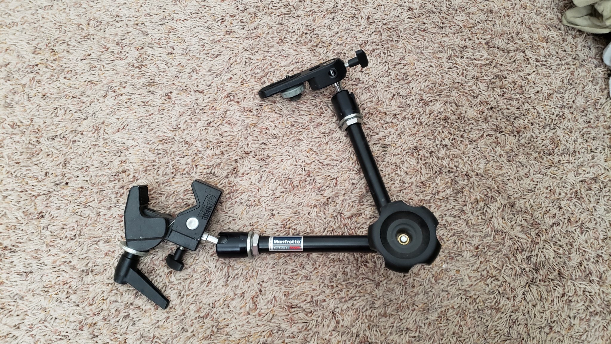

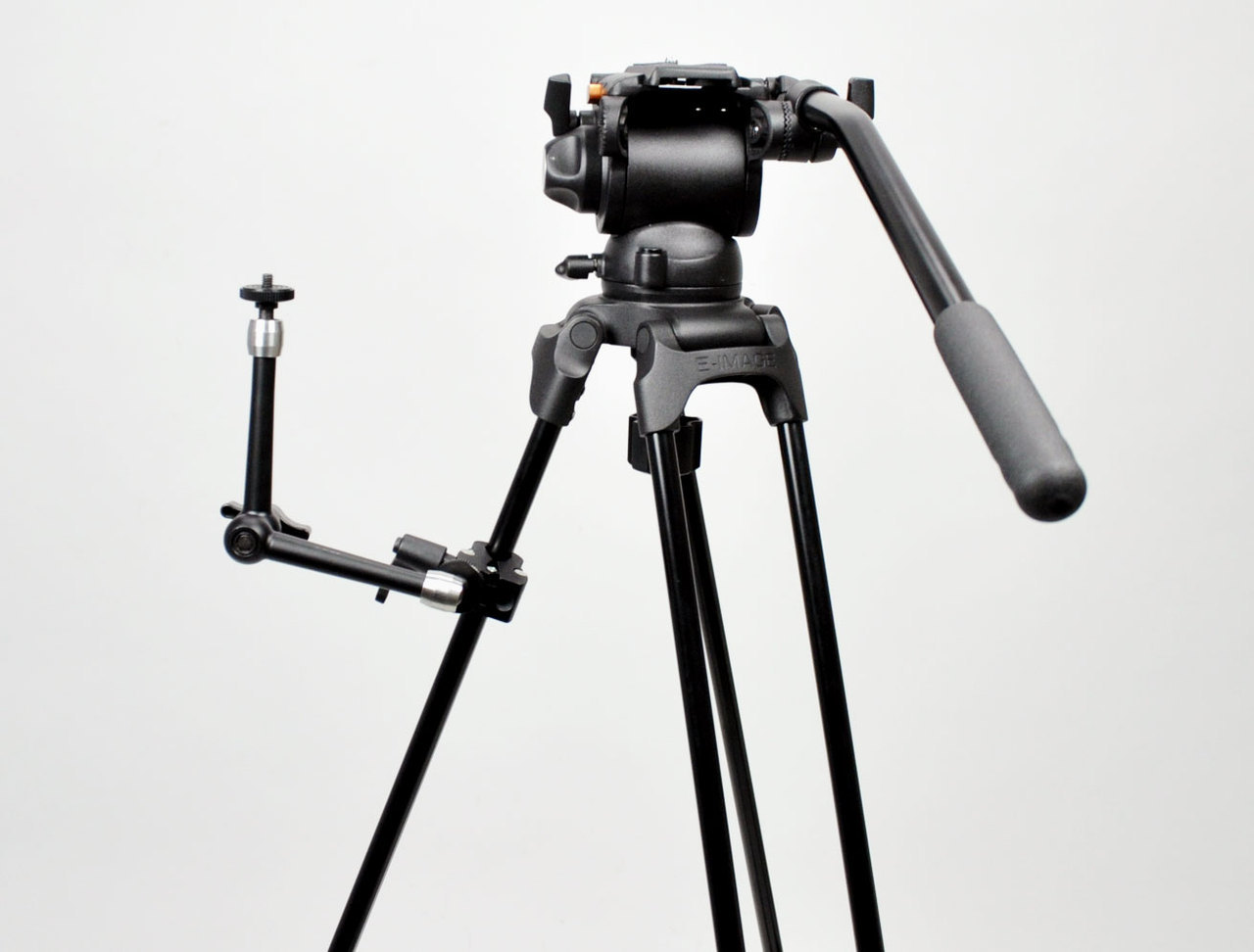

A 1/4” 20 all thread and a tripod table of some sort...or a camera bar...I’m going to build something this weekend...just a simple mount that attaches to the tripod and holds my binos range finger and the kestrel in the vain.
Weighs 3lbs 4oz as pictured. Take off camera bracket and it makes it 2lb 14 oz. It's made to hold a full size camera with lens so you can get away with something significantly smaller
The big clamp is really what you need. It has threaded holes so you can stick the smaller articulating arms on it.
Edit, this is what you want
The plus side of the arm I have is the one knob controls tension on everything. No need to adjust the arms, and each individual end. Loosen large knob, move in place, tighten.
