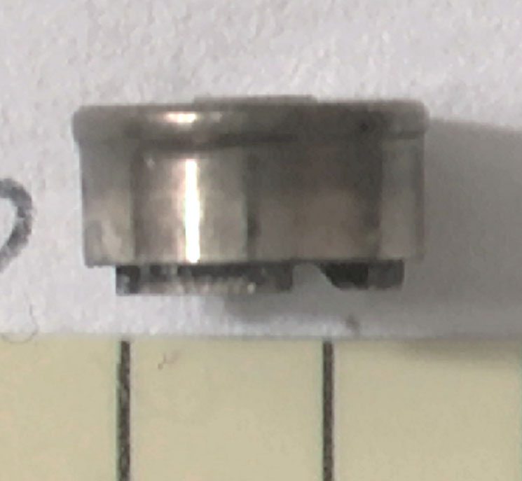

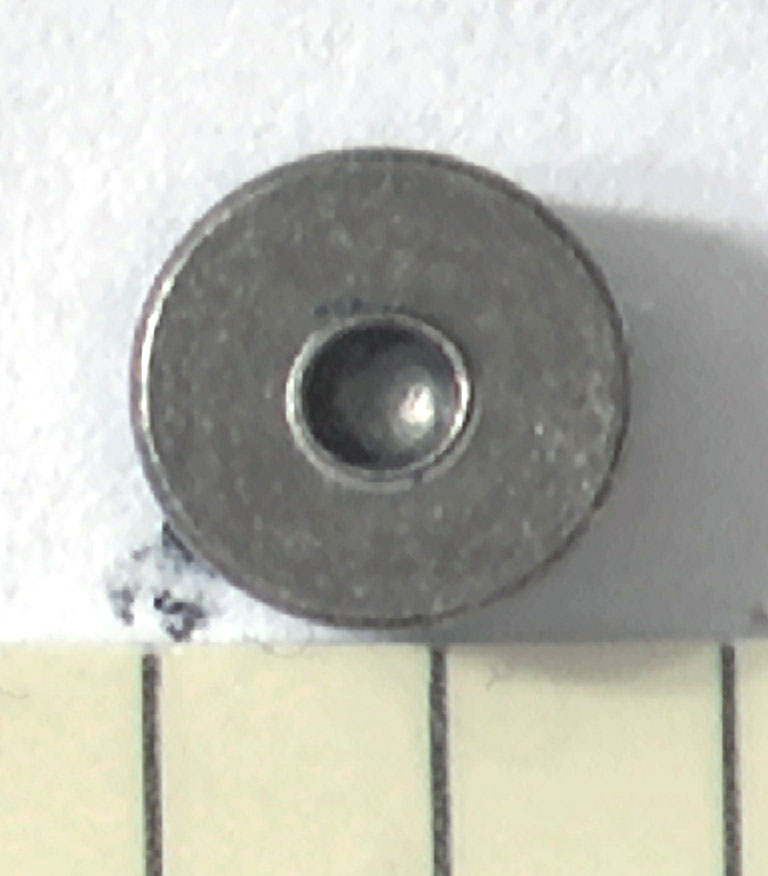

What exactly is cratering? Are we talking about the firing pin impression on the primer or the primer metal flow into the firing pin channel, which makes the concentric raised ring around the fp impression, or both? Apologies for the fuzzy pics, notice the flattened primer too!
7099975
7099977
The ridge around impact, where primer flow goes in between fp and fp aperature. Its usually a indicator of pressure, as most factory actions are sloppy around the FP. I normally dont pay attention to cratering, looking for fully flattened edges are a more true indicator of pressure, followed by ejector swipe, then pierced primers.
