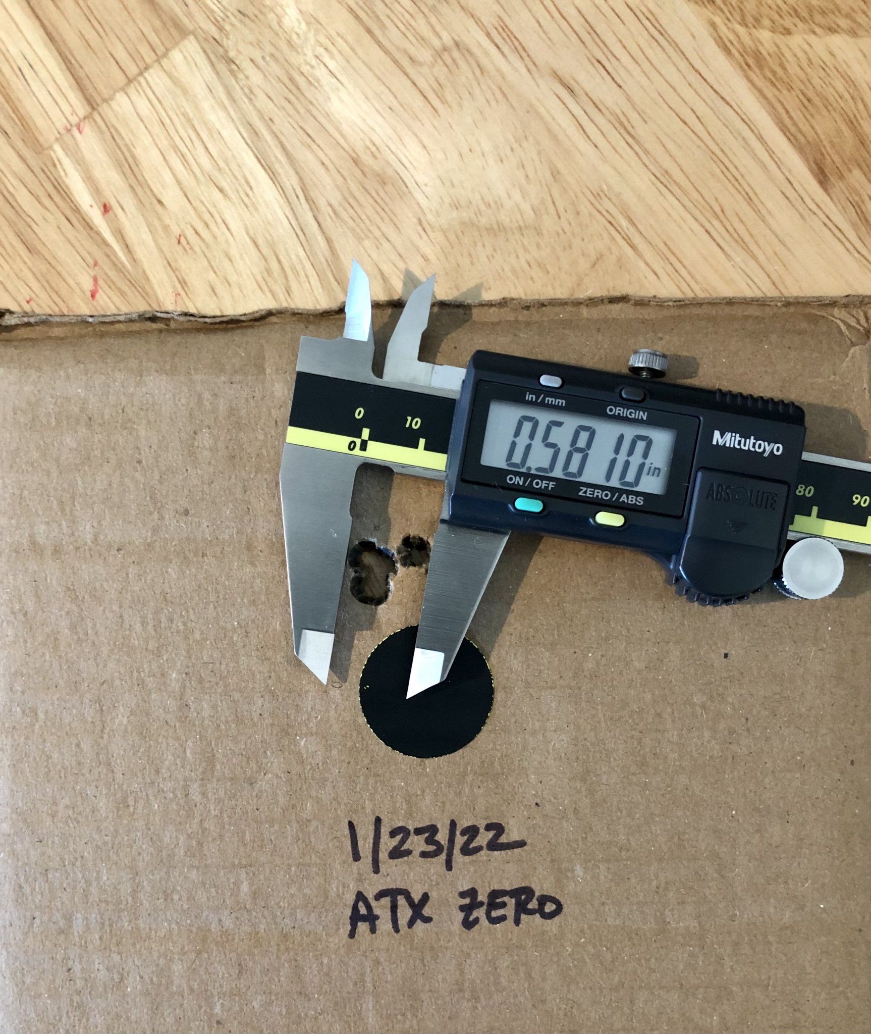

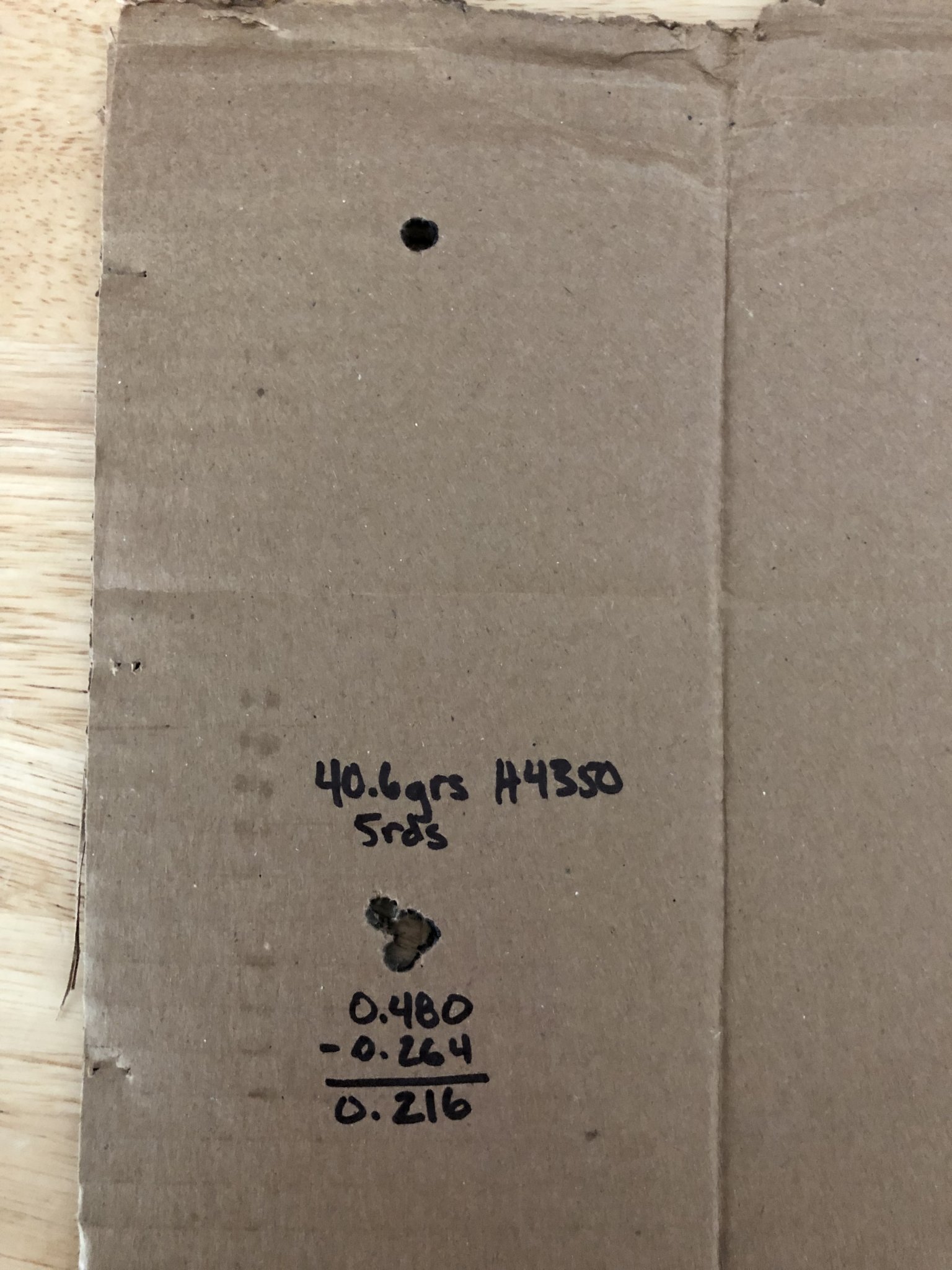

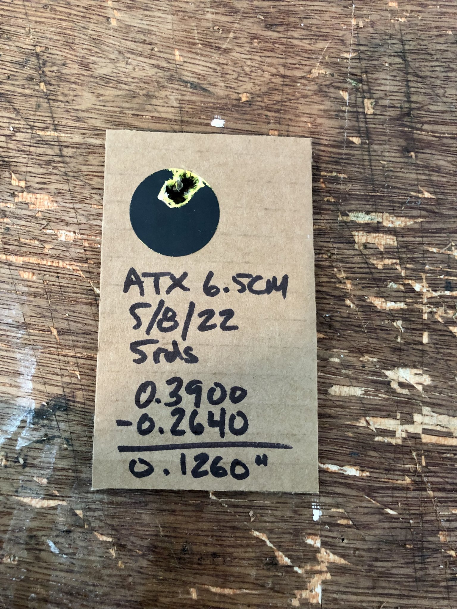

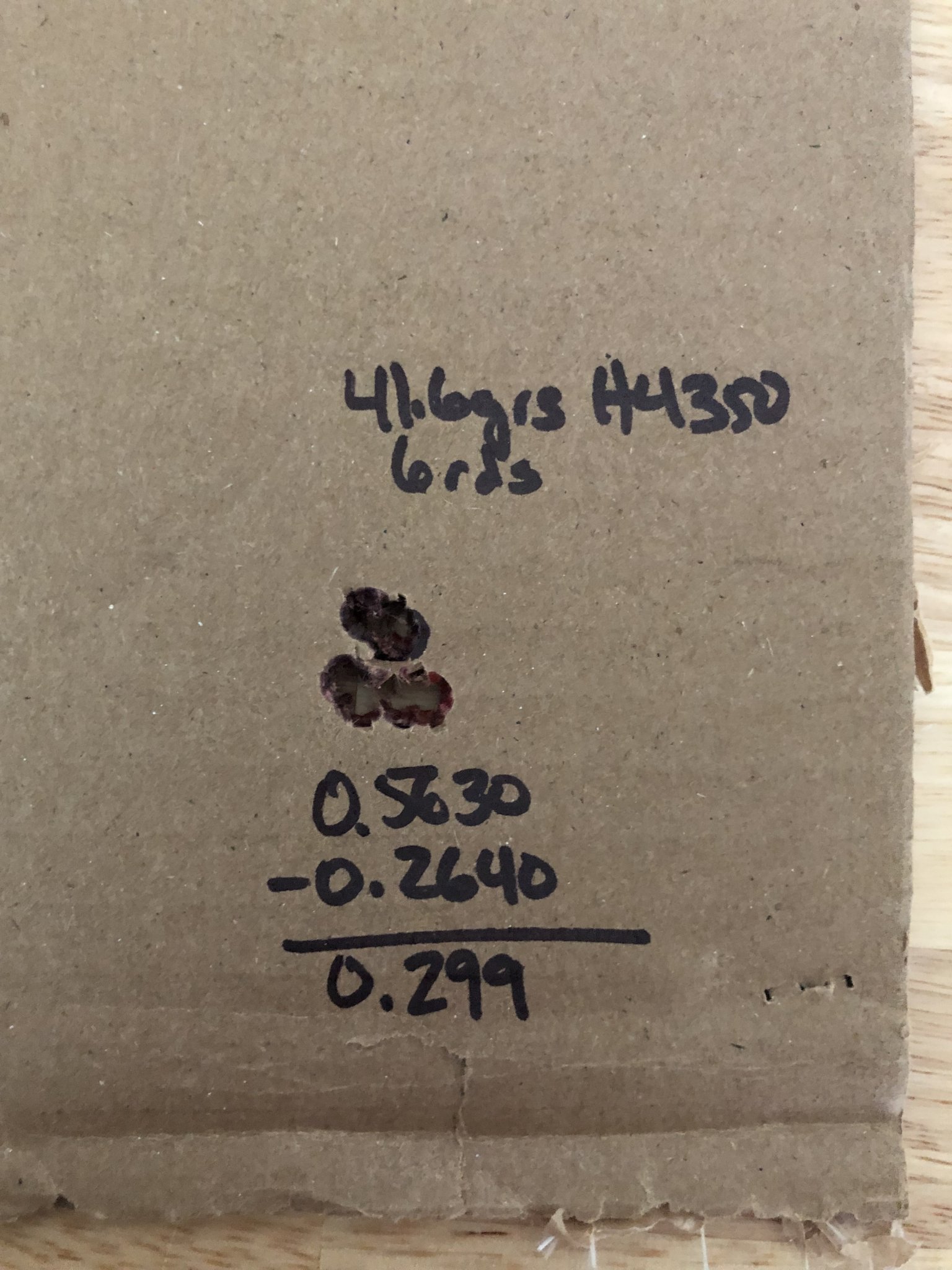

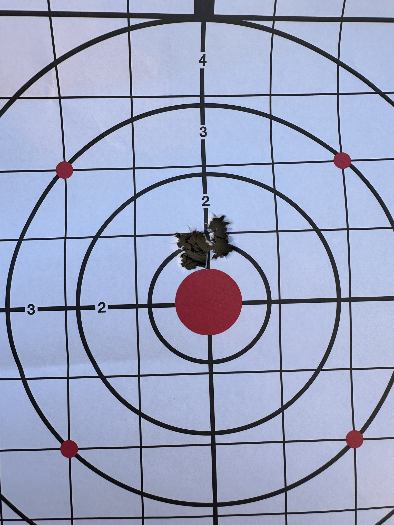

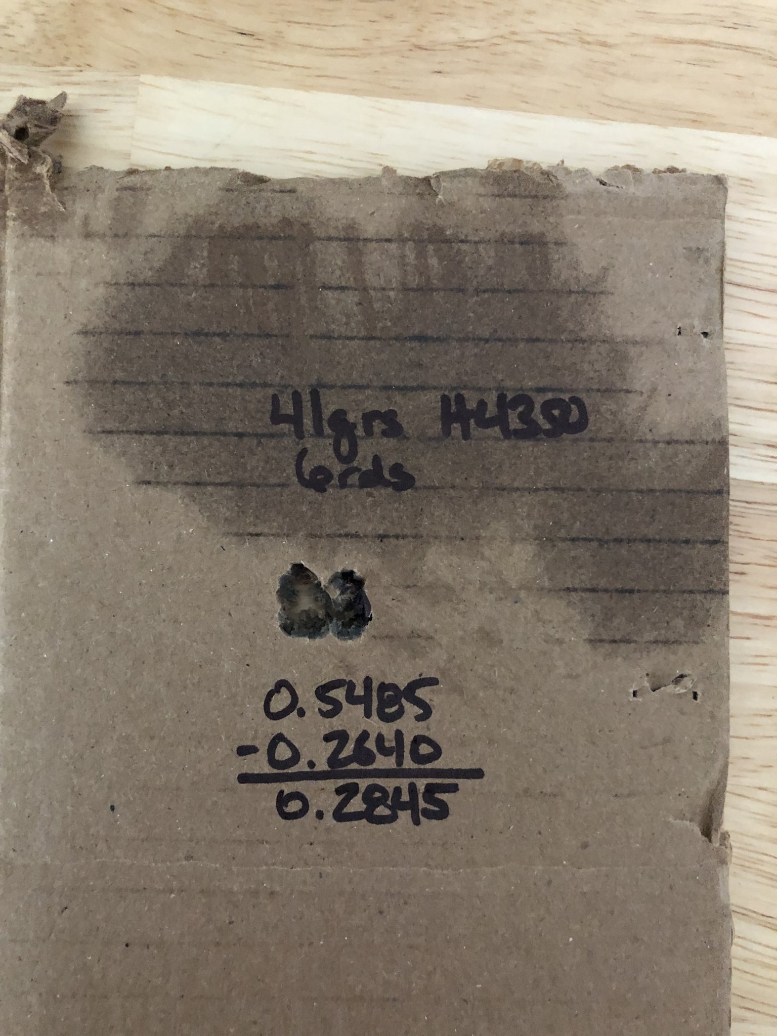

    My ATX is from the very first run. 21 serial number. I have assumed the barrel is a win tac chambered bartlein. Very accurate, groups look exactly like @just browsing.
    143eldx, 41.5 h4350, lapua brass. No seating depth tests, easiest load development ever. No break in. No unusual fouling, barrel cleans very easy.

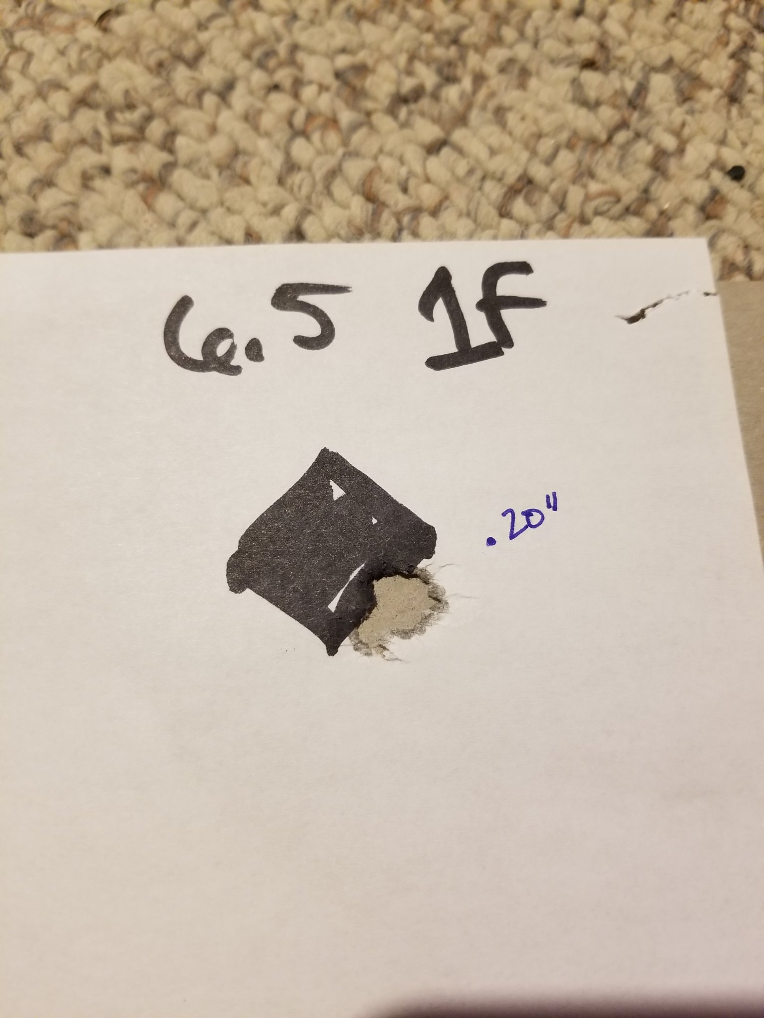

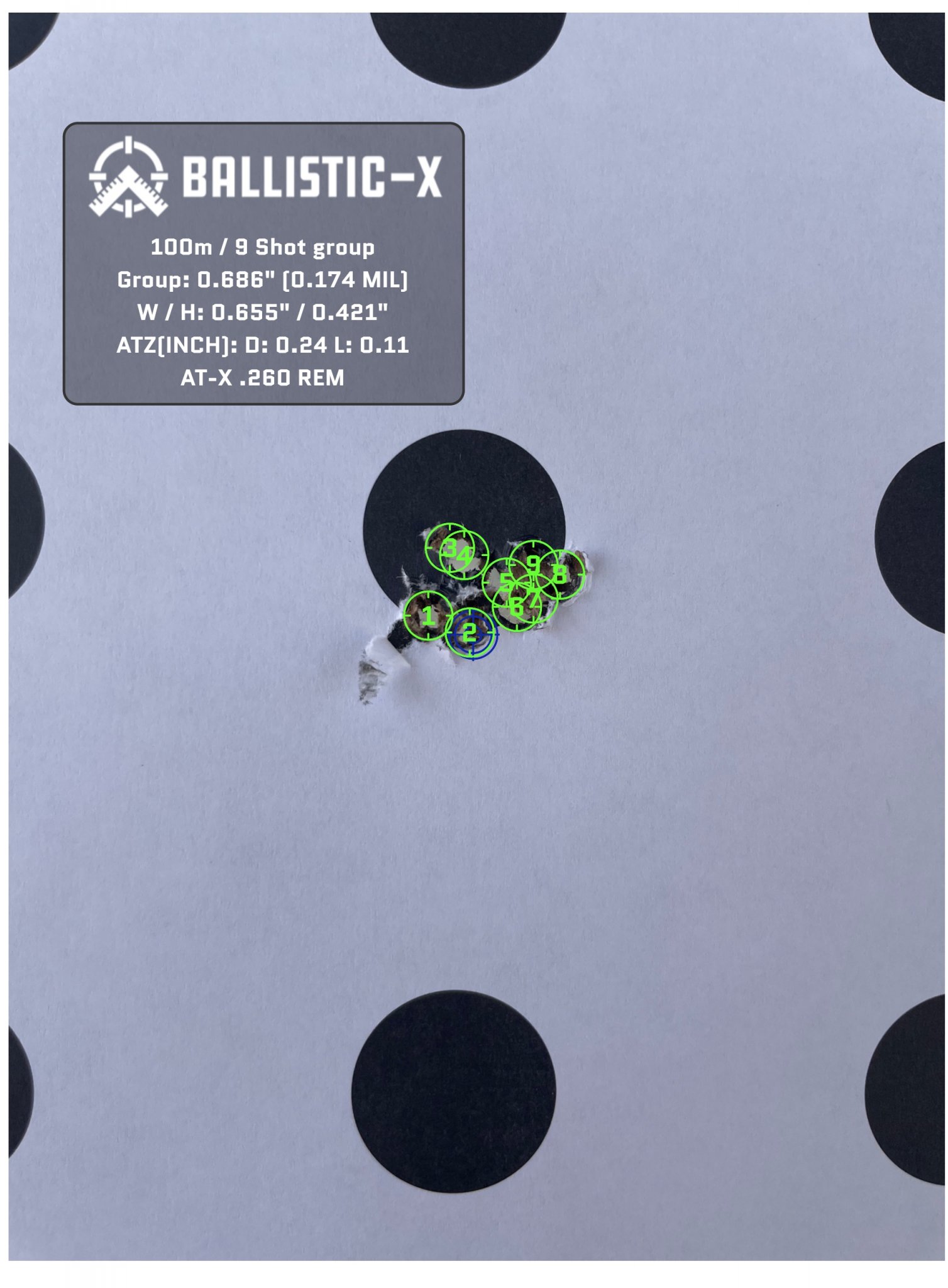

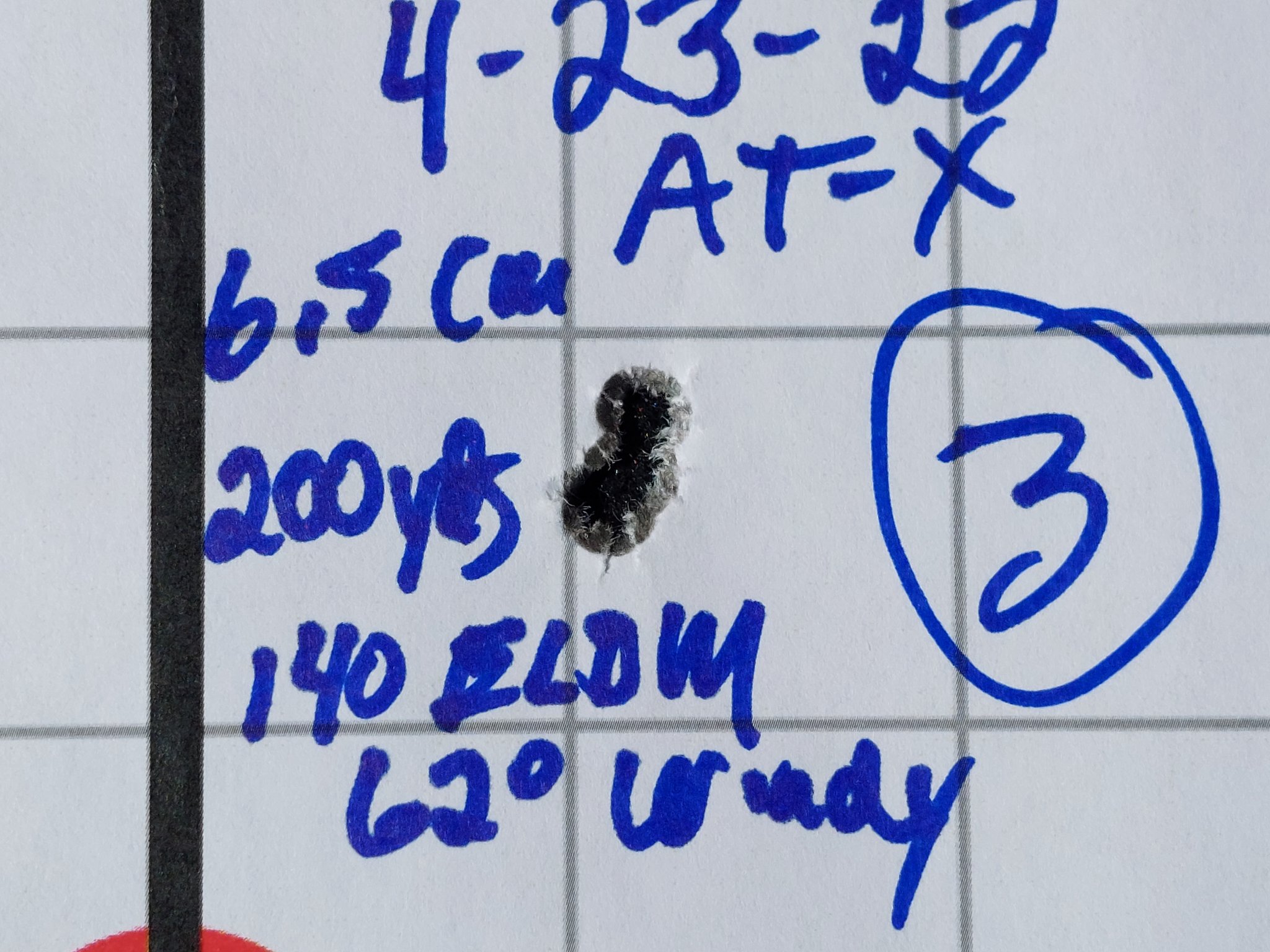

    My ATX is Gen.3 bought from the UK (probably Lothar Valter barrel) with the 22AT series. It shot 0.2-0.3 MOA right from the start with factory Hornady 147 ELDM TAP ammo. I bought 3 boxes of NORMA Golden Target MATCH 143 gr ammo to try it out. I hope it will be ok, especially since in the meantime he also received a competition tunner

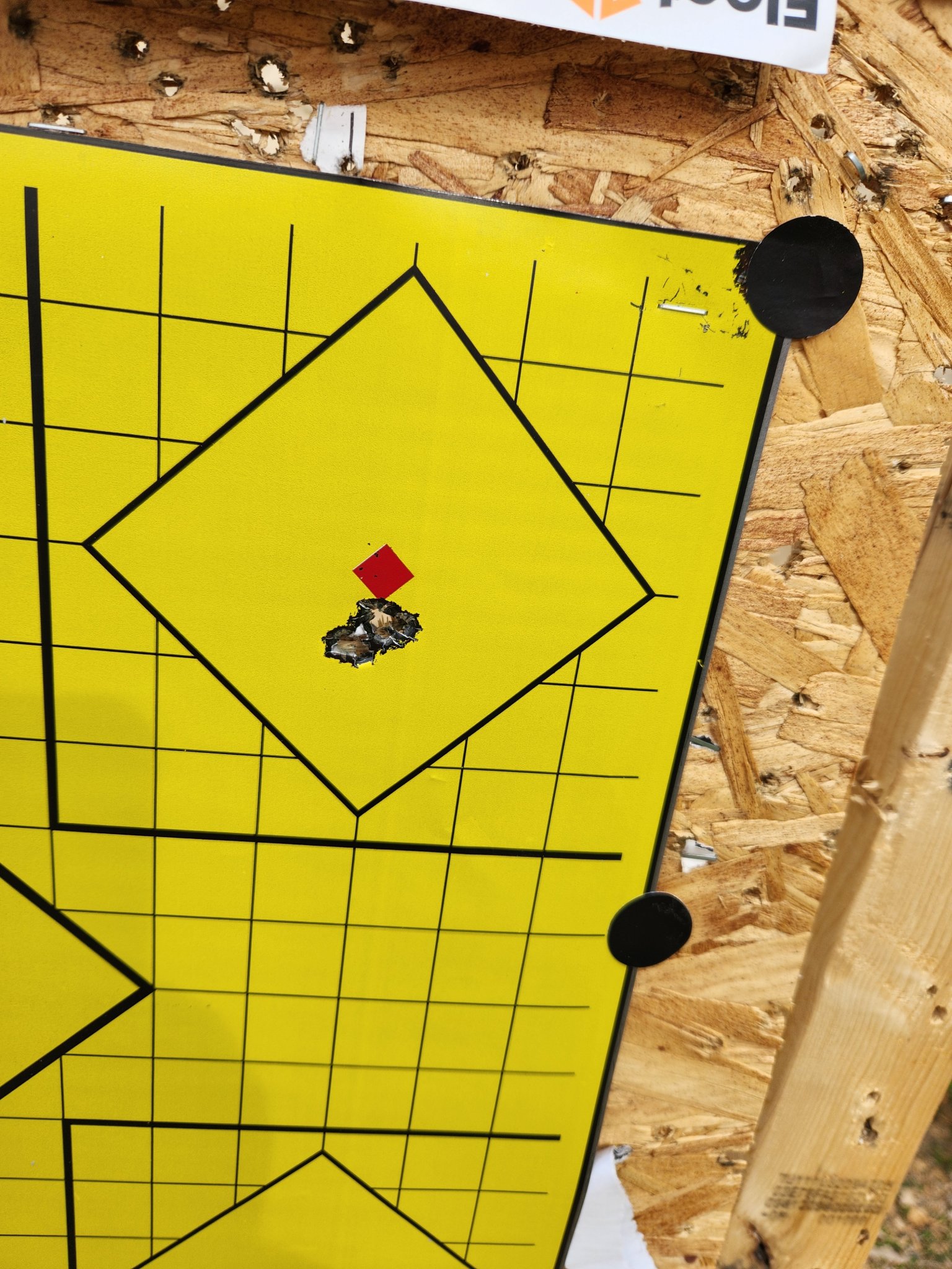

    Honestly first I’ve heard of this. The LW 308 I have on my AT and win tac 6.5 I had on my AXMC were 1/4 moa without much trouble

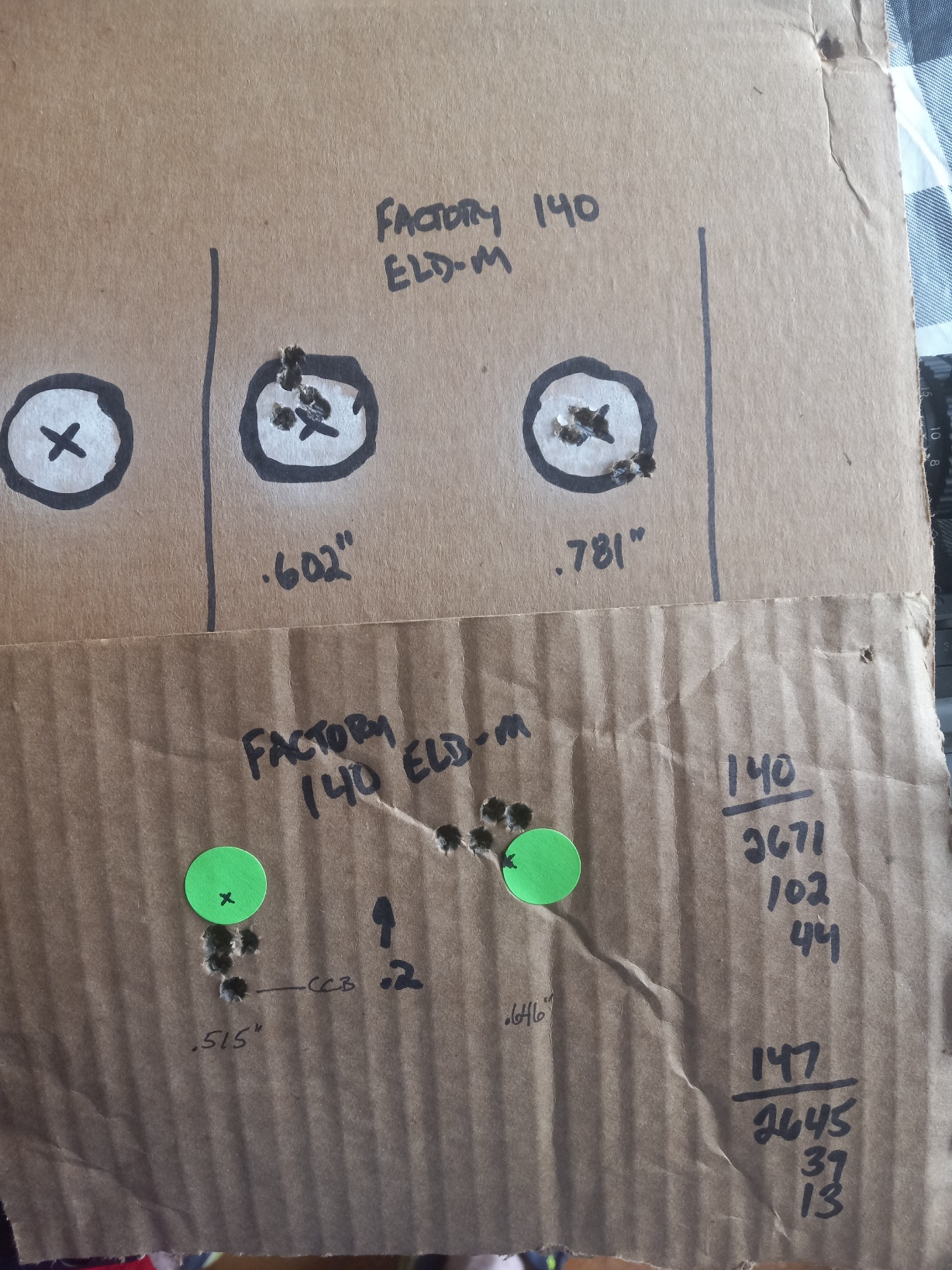

    1 box of factory 140 ELD-M gave me (4) 5-shot groups of .515 (on a clean barrel), .602, .646, and .781". Not quite what others are getting, but decent enough that I cant complain. I chronographed the final 5 shots...Avg: 2671 with an ES of 102, and SD of 44. Oof. I also chronographed my last group of 147gr ELD-M, and it was 2645 with an ES and SD of 39 and 13.
    Guess I'll try screwing with some handloads while I continue to have to pull and scrub the bore every 20 rounds. At least the CCB shot seems to be within the group average.

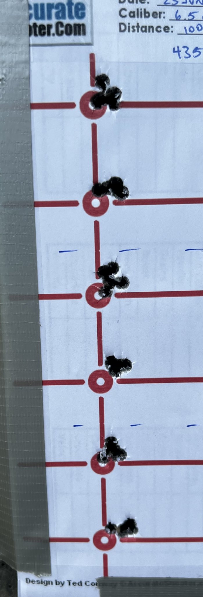

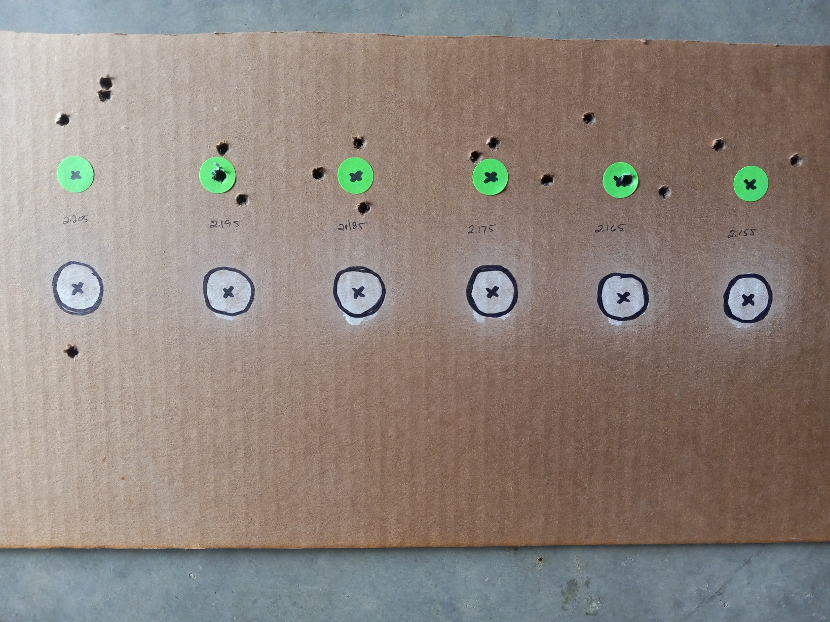

    Here's my rough seating depth test today with the 130gr SMK and Reloader 16.
    I've had "custom" barrels that would shoot the occasional 5-shot group over 1 MOA during load development...but I've never had a "custom" barrel do it on 6 consecutive 3-shot groups.
    Not even worth measuring. Didn't even fire the third shot on the last group...I'll use it as a fouling shot after I scrub the fantastic amount of copper that this barrel accumulates.
    After the third group I checked every screw on the rifle and optic. Perfect.
    Two days ago it put out a .515 and .646 with factory Hornady ammo...so obviously this is a combo the barrel hates...but this is temperamental.
    Oh well.
    To those with barrels that hammer: I'm envious.

    There are three or four of us in this thread shooting 140 elds with approximately 41.5 grains of h4350. Might be worth trying that combo since it seems to work so consistently.
