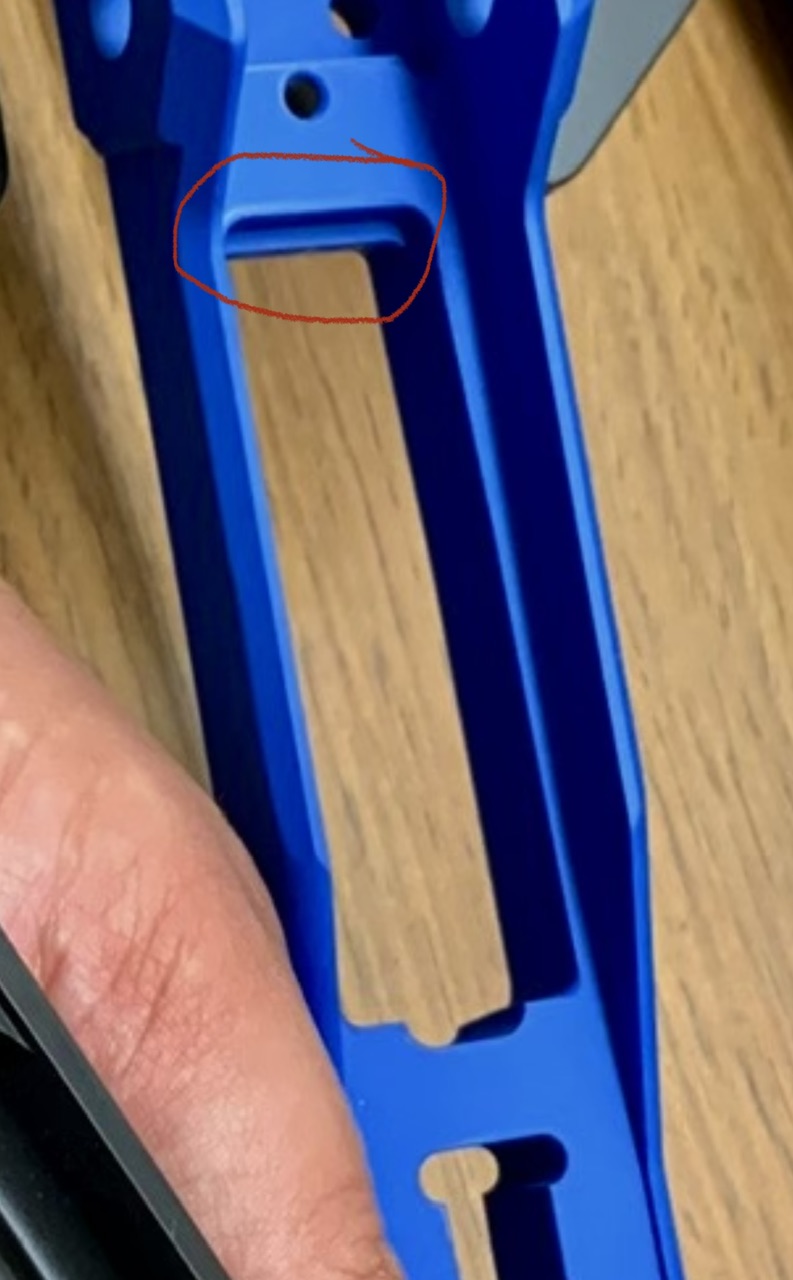

That’s not correct, ATX’s are designed to use the AX style mags with the lip in the front that catches and locks in, you can however use the mags without it too but they don’t lock in solid like the AX style. They should never fall out though.
That true for the ATX rifle. We are discussing the ATX AISC/chassis.
AT-X mag, .308 AICS pmag, and .223 AICS pmag all measure .970ish wide and 3.05ish long at the bottom of the catch. My pmags don't seem to be jumping out of the AT-X AICS.
I’m well aware of that captain obvious, the chassis has the shelf for the AX style mag lip to lock into just like the rifle chassis. Just like the AX AICS has… that uses you guessed it… AX AICS magazines…

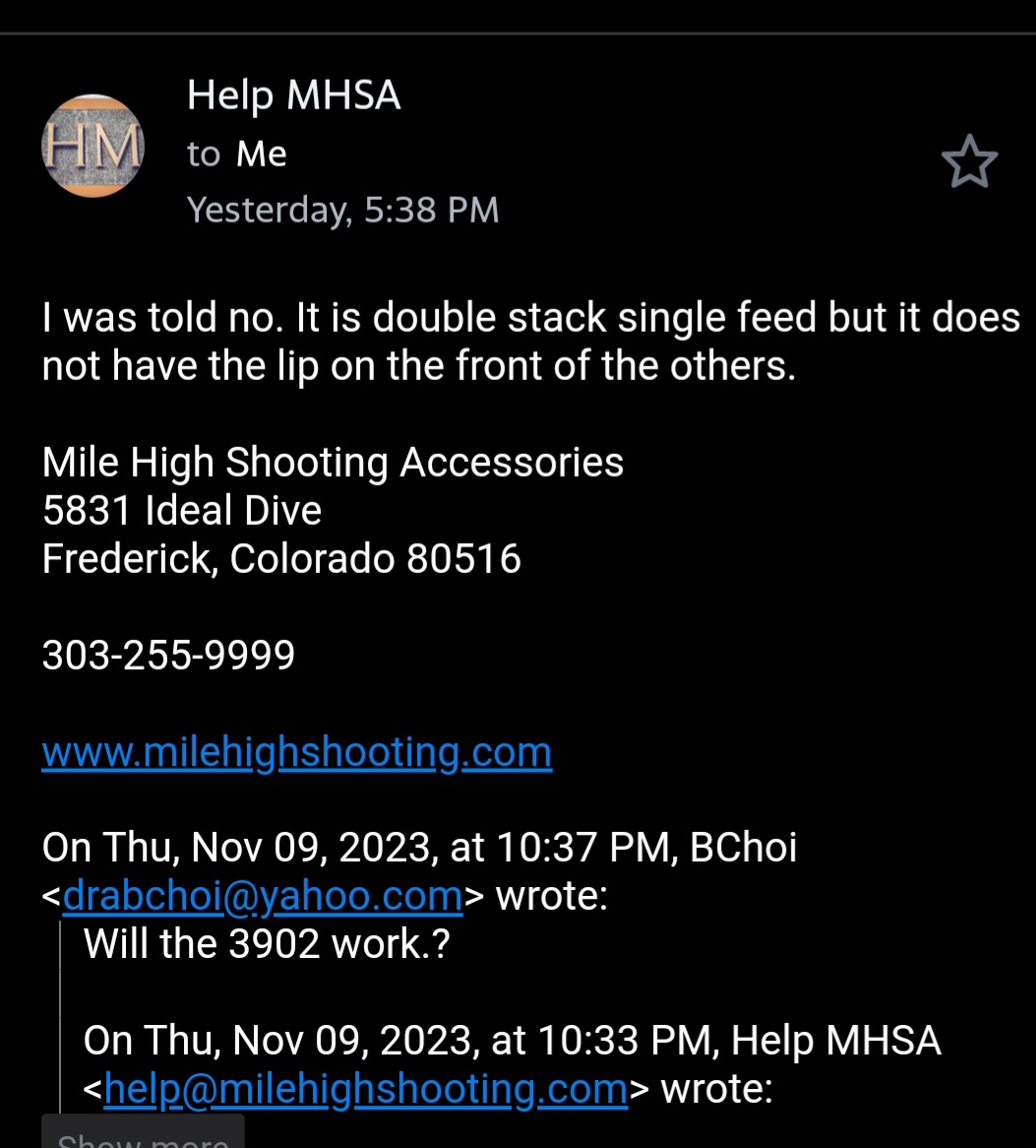

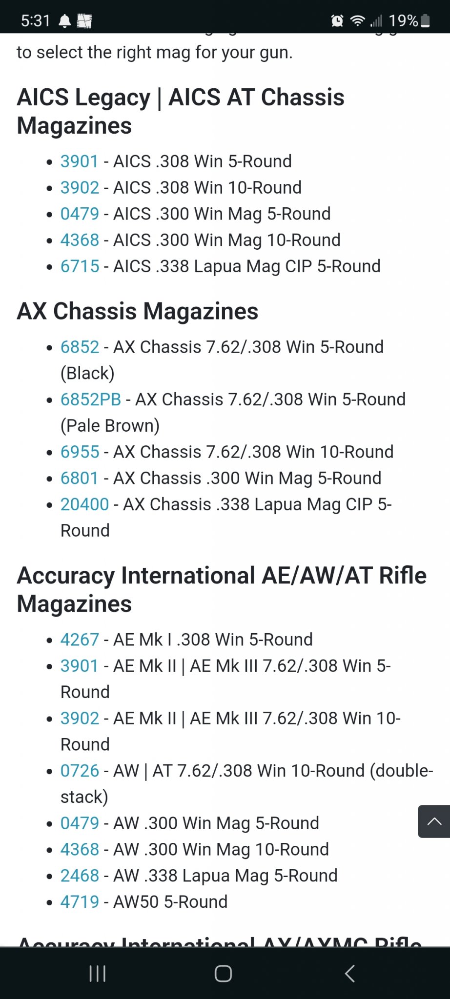

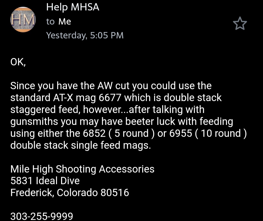

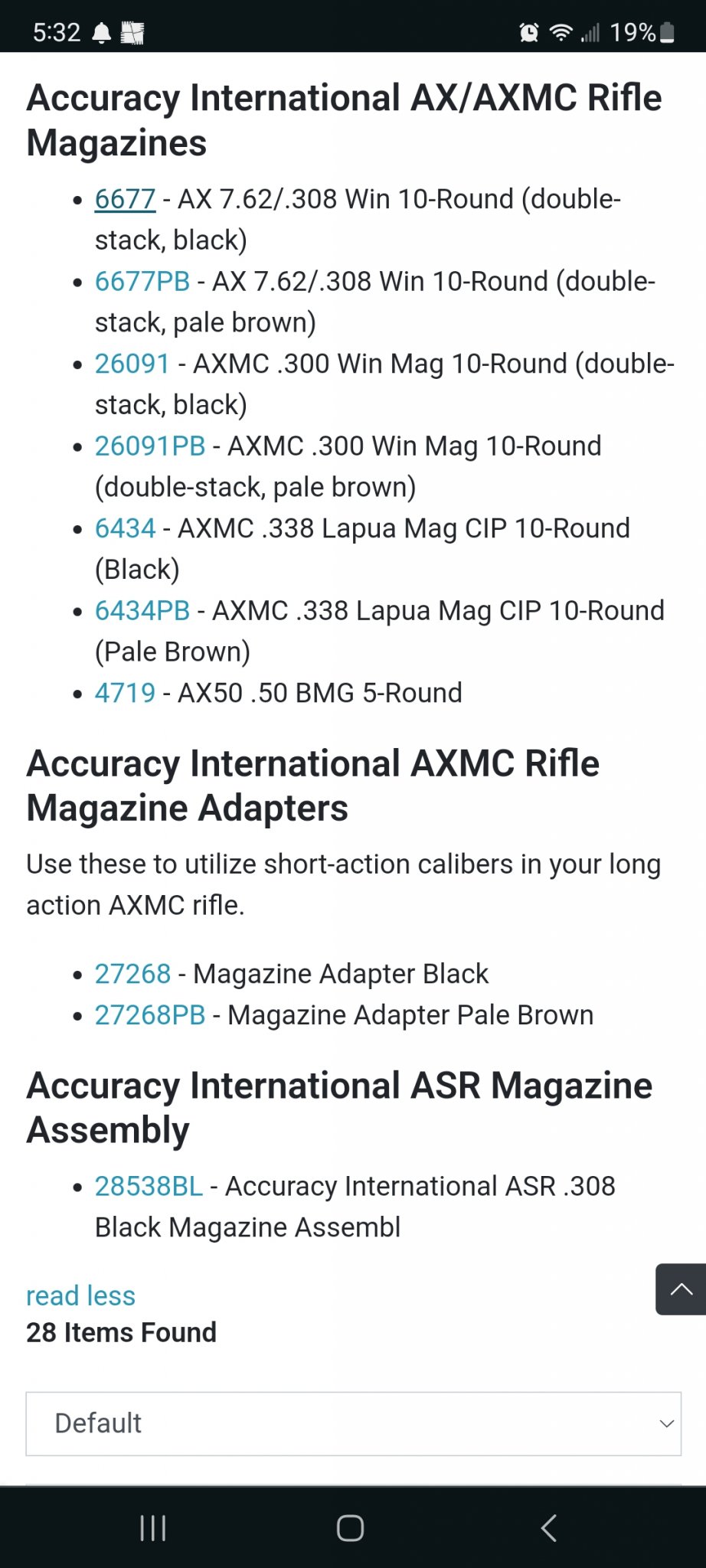

Ok guys..I finally got it clarified from Mile High.
The guy helping confirmed with the gunsmith. The ATX chassis needs the mags listed under AX chassis if u re look at the parts listing I posted above .
The mags under AI legacy or AT AICS does not work.
Here is a copy of the email. Hopefully this clears it up.
For the mag part #3902 won't work
Here is a copy of the email. Hopefully this clears it up.View attachment 8268704

Accurate and all the other aftermarket AI pattern manufacturers only make standard AICS pattern mags.
If you want AX AICS mags (AICS with the lip) the sole source is AI. 6955 is the PN for the 10rd and 6852 for 5rd.

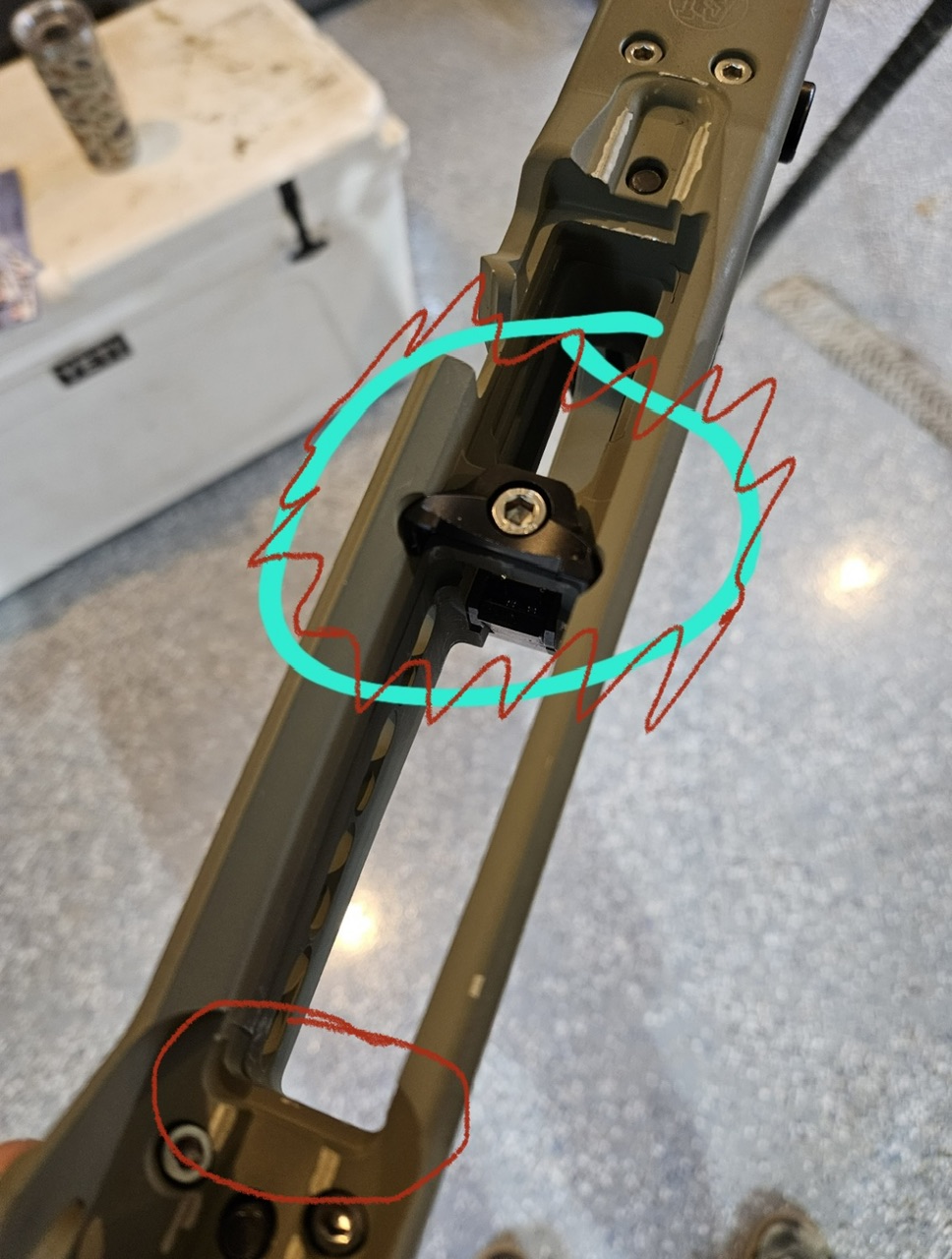

I have a few atx aics 700 actions, I've ran mdt, aw, arc, accurate and ai aics mags in it. To get aw mags to function in the atx aics chassis the rear mag height limiter block needs removed, it's circled in one my old pics above of my FDE chassis.

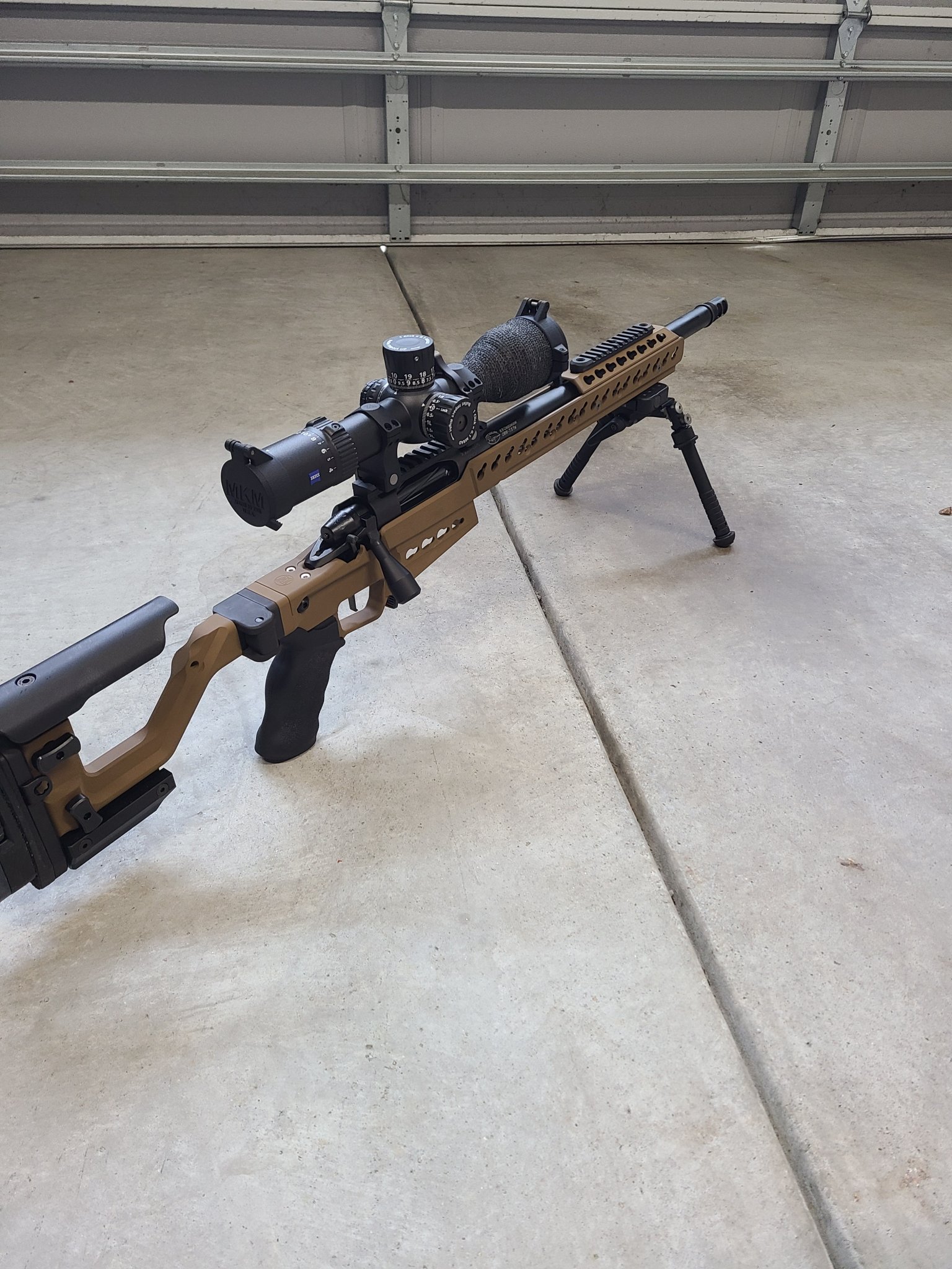

Just finished this build with an AW cut TL3 and the bolt rides right over the rounds with AW mags. Will try removing the mag block. Hopefully that resolves my issue. Also have AX mags to try.View attachment 8393884
I can't even get aw mags to latch unless I remove the silver screw and mag height block. Removing that should solve your issues. Good looking rifle by the way! Aw and ax mags have been very reliable after a slight feed lip tweak in my 65cm.
Thanks man! Definitely very happy with how it turned out but really want it to run with AW or AX mags. I hope you are right. The AWs are latching in but won't feed unless I put some upward pressure on the mag at the rear.
So I pulled the mag height block and my two AW mags are slightly improved. Now the bolt makes contact with the rounds but still passes over them. With upward pressure on the rear of the mag they seem to work great so a slightly higher mag latch would be awesome. My three AX mags are slightly improved over the AW as they occasionally maybe half the time do feed. One of them feeds everytime but the bolt binds up as the round starts to leave the magazine and begins chambering.....

What cartridge? Opening the lips for a bit more case head presentation would help, but do it in very small amounts, aw mags rely on the internal pressure of the two offsetting double stacked rounds as part of physics that keep them in the magazine. Aw's can be picky!
6.5 creedmoor. I find it odd that AWs will seat in my chassis with the mag block installed but wouldn't in yours. Would suggest the mag latch in mine is shorter than yours...
I'm tempted to just order some mdt 10 rounders and run those.
I had some the very first atx-aics chassis that were available, believe late 22, early 23, they may have made some unannounced revision. I currently run 2 cdg actions with aw mags in my atx chassis(no mag height limiter in place), but they're designed around the aw mag, and run very well. I have also had a lone peak fuzion in one and it ran aw's fine. Never a tl3 though. I have a right tl3 now, and will install and test when I get home next weekend and give you feedback.
Sounds good! Yea the Aws I have run very smooth even better than my AX mags if I give the rear of the mag probably a millimiter or two of lift.

Not necessarily. Impact, lone peak, zermatt, defiance all have aw cut action and lugs are 90/270 when running the bolt. As long as the aw mags high and tight to action, there will be case head presentation above the bolt face and they will run. Keeping that mag up high is key.
