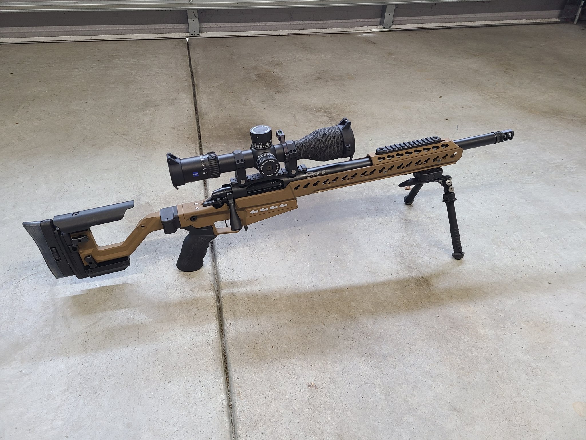

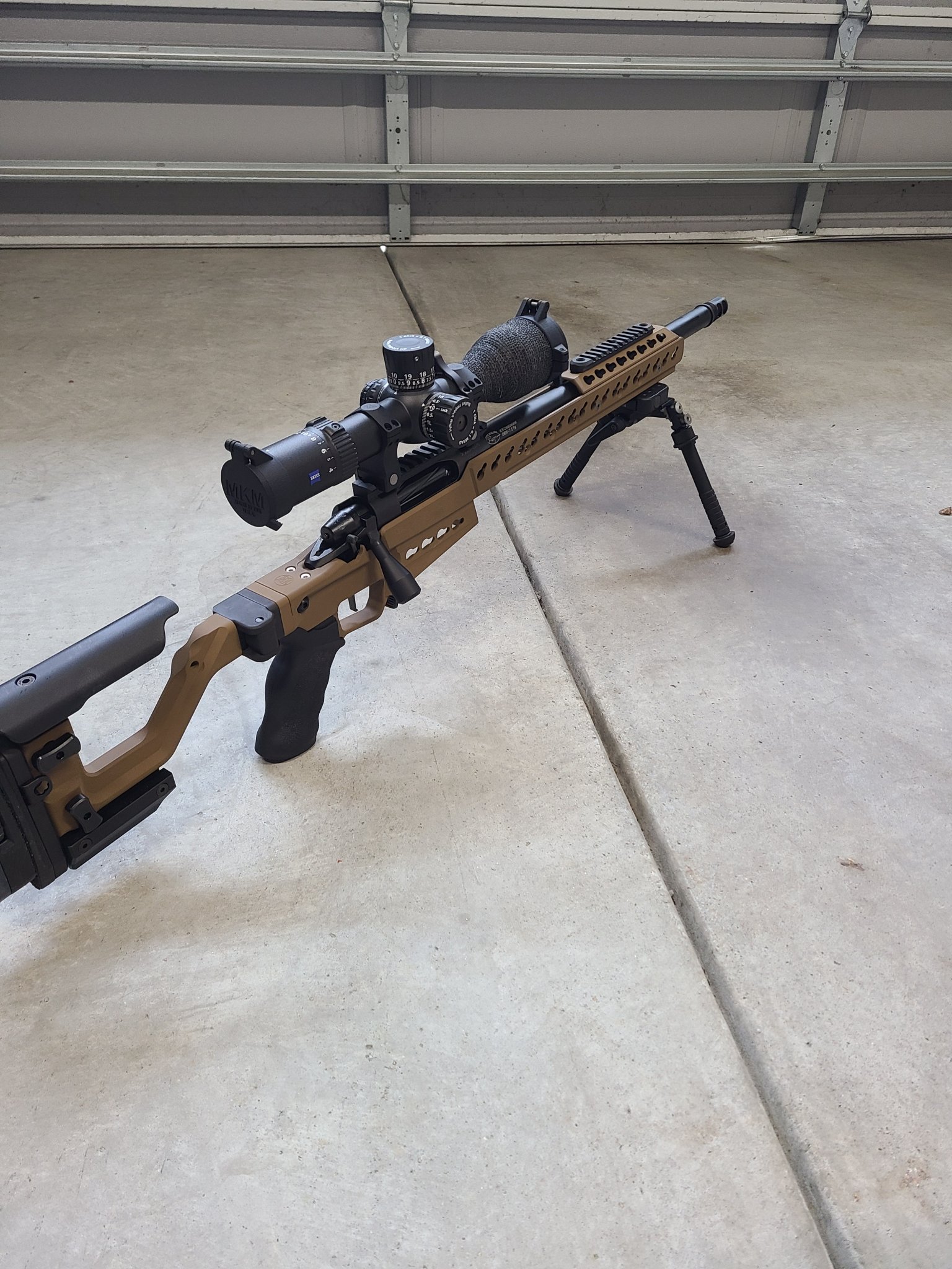

I am running the 13" with an 18" barrel to give you an idea...

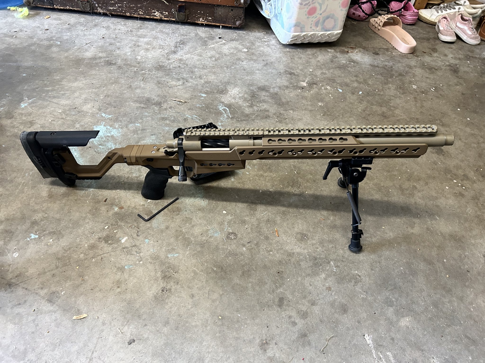

My buddy brought over his short chassis ATX for us to mock up some rail situations.
It seems there are no 20 moa top rails that will fit the 13" forend.
The top rail in the picture is off of my 13" AXSA AICS chassis. It would need to be slightly shortened and it also sits about 1/16" lower than the action rail.
Also, just realized they make a medium sized bridge to work with the 13" forend. The short is on there as we thought you would need to chop the long bridge to work.
16" barrel installed on a WTO switch Lug
The 13" forend looks great, I personally don't tend to run a bipod too far out (cant reach of for adjustment) so don't see the point in the 16" version other than more real estate for weights.
