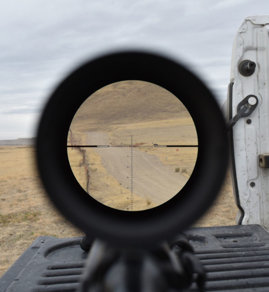

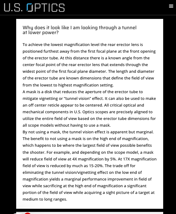

Speaking of the T6xi, I happen to jump off my Razor Gen 2 and onto a T6xi and I was kinda impressed. The glass on the objective lense felt like it touched the edge of the scope body. You almost couldn't see any of the objective lense body. The glass was super clear too.
I know it's from US Optics, but I believe that Nightforce and S&B do the same thing, hence the tunneling. TL;DR if you optimize a scope for higher FOV at higher magnification, you get tunneling.
Both my main scopes (ATACR 7-35 and USO FDN 25X) have tunneling. It doesn't bother me, or my buddies who run ATACRs, but I get it if it bothers you too much. We all have preferences, and I'll respect that.
Reactions: adavis1138
My Kahles scopes are the same way. The Helia KX is not, but all my K-series scopes are. The K318i is not as bad as the K624i scopes, but still thought it was a bit odd, since Vortex Razors aren’t like that, and neither is my Zeiss LRP S3 6-36x56… And come to think of it, my Burris XTR-2i 5-35x50 and XTR-3i 5.5-30x56 scopes don’t really have any tunneling , either… 🤔
I don't think the OP was referring to tunneling (the 4-16 doesn't tunnel), more the effect of looking through a tunnel throughout the whole mag range.
Some people refer to it as seeing the scope body.
It's the eyepiece design that does this, some scopes are known for this effects, whereas others are known for giving a more HUD type display.

What the image in post #7 above is showing is a thick periphery of the sight picture, not necessarily tunneling. It's what Secant mentions above, some scopes do a much better job at eliminating as much of the periphery as possible. You want one of the best at this then check out the ZCO 4-20, very thin periphery. That being said, having a thicker periphery won't allow to hit targets any better, but our brains do perceive the thinner periphery to be more pleasing and we often think a scope is better just because of this phenomenon. Similar can be said about edge to edge sharpness, our eyes like to see the whole image being sharp as we tend to be distracted by out of focus portions. That being said, the ATACR 4-16x42 is an excellent scope optically and mechanically.
