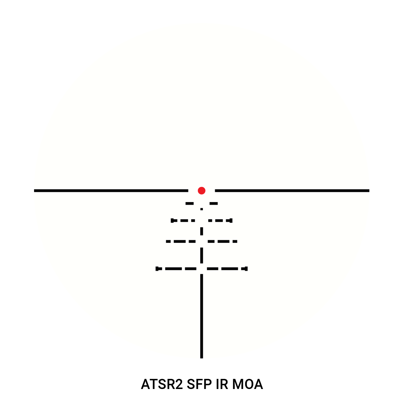

Doug over at Cameraland gave me this Athlon Optics Cronus BTR 1-6x24 SFP - ATSR2 SFP IR MOA to review for him. Athlon is the new kid on the block. They seemed to have an optic for every shooters budget. I’m always leery with new companies in regards to quality and standing behind their products. This year I was able to attend Shot and made sure I stopped at their booth. Being a Firearms Examiner I try to keep up to date on the latest firearms and accessories on the market.
A few months back I reviewed two of their scopes and couldn’t believe how well they performed. For the money you get lots of features and a package that works. This review was more exciting since its their top tier line the Cronus BTR which is made in Japan. This is the same factory that makes several high end scopes.
Overall this scope is very similar to my Vortex Razor except that its approximately $450 cheaper. It’s got a 30mm tube, lit reticle, locking turrets, HD glass, and an etched reticle. First impressions were that the turrets have very positive clicks, smooth power ring knob, and extremely clear glass. The reticle is perfect for my needs and not overly busy. Its designed for the 68gr and 69gr ammunition and has holdovers out to 600 yards.
For testing I mounted the optic using the Vortex CM202 mount. (seems Athlon doesn't make mount as of yet) Figures it was pouring raining when I made it to the range. Perfect opportunity for inclement weather testing. I made sure the scope got good and wet. The locking turrets were easy to zero and the lit reticle was very crisp only 1.4 MOA so no obstruction of your target. It has half clicks that allow it to turn off between each intensity setting. This is a nice feature. Optics were extremely bright and clear even in poor conditions. Excellent relief and no issues with the eye box. I ran 300 rounds though my rifle during my first day out.
Over the next 2 weeks I used the optic indoors at my job. We have a 25 yard range. Its tough to get to my outdoor range as often as I’d like. I did countless drills with my shot timer maybe shooting another 400 rounds. I can honestly say I’m extremely impressed. Running side by side with my Razor there was no difference. The Athlon comes in slightly lighter by 6oz. Its a solid well built unit. The field of view is within a few feet as well. Athlon gives you 120 MOA which is more then you'll ever need. As far as looks I love it. Low profile turrets and a clean look to the scope. Perfect scope for 3 gun matches.
Athlon hit the ground running and seemed to have caught up to the big guys rather quickly. They have an excellent warranty and the products are readily available. I didn't conduct any tracking test due to the fact that once this is zeroed there is no reason to crank the turrets. I did give the gun a bunch of hard hits and exposed it to pretty bad weather. My main concern was function and optic quality. Hands down awesome bang for the buck and I wouldn't hesitate purchasing one. Sure its not cheap but its not made in China or the Philippines. You get what you pay for. My pet peeve is when new optics come out and your waiting a year to get one. Doug showed me everything is in stock which is a plus. Next I’d love to test out the 4.5x29 on my 6x47 Lapua out to 700 yards. (HINT HINT DOUG!!)

Reticle ATSR2 SFP IR MOA, Glass Etched

Yes, I agree you rarely dial with a LPVO, but I would like a Mil reticle just to stay consistent with all my other optics. SFP in a low power is desirable in my opinion since I wouldn't be needing to do holds unless I'm at max power anyway. I just don't want to have all my rifles in a MIL/MIL and then be doing holds in MOA on one rifle. I am certain I will screw it up and forget that its MOA and not mil.
Almost all BDC LPVOs are MOA. It doesn't matter generally because you zero it and leave it. If you're looking to dial then normally you're not using 1-6. Obviously there are exceptions to this, but that's the norm.
I'd use holdovers on this. Its not a scope you'll be shooting extreme distances with. 6x is limiting. Doesn't really matter if its MRAD or MOA. With .5 MOA its a corse adjustment.
I'm of the same mind set. I can't say I've ever had an issue with .5 MOA in this style scope, Even in 3gun matches I've never had an issue with the coarse adjustments as we are shooting 8" or bigger plates. The max distance I've run a 1-6x on 3gun targets was about 600 yards. A couple folks in this thread mentioned a desire for a MIL version. I was just trying to get an idea as to why it would there was a demand for it on a "set it and forget it" scope.
It's one of those can't please everybody things.
Guys used to holdovers with their mil or moa reticles don't need BDC, although some guys like BDC in these type of scopes, it can be a tad faster.
Some guys might be shooting different loads or cartridges that are faster or slower than typical 55fmj. They might want to holdover instead of dial and the BDC reticles wouldn't suffice.
I used to have a SFP NF 2.5-10x24 with LV BDC reticle. Even though that reticle was close to my reloads it was off enough that I needed to tune the sight in distance, less I risked missing too high or low on smaller steel when holding over.
While were on the subject, it's high time Kevin started offering different reticles in the more popular scopes, especially the Argos BTR 6-24, because that's a cool inexpensive scope and us .2 mil guys want that on the main crosshair. Just thin down the reticle used in Ares and you'll be GTG, maybe offer a dot in it as well.

Strelok Pro phone app, Any caliber, any load. Change your zero distance and get your subtensions to stay in the "kill zone" at your longest distance hash mark. A lot of times that keeps all the other subtensions in the "kill zone" as well. IE, 53 yard zero instead of 200 yard zero. This is what I do for 68gr handloads in 3gun as well as 300 Blackout subsonic 240gr rounds...
I agree with the more reticle options. Did you hear the Ares ETR floating dot reticle is going to make its way into the Cronus BTR?! It's a start at adding more reticle options to popular models! You guys should see the Cronus with floating dot reticle next year at shot show.
