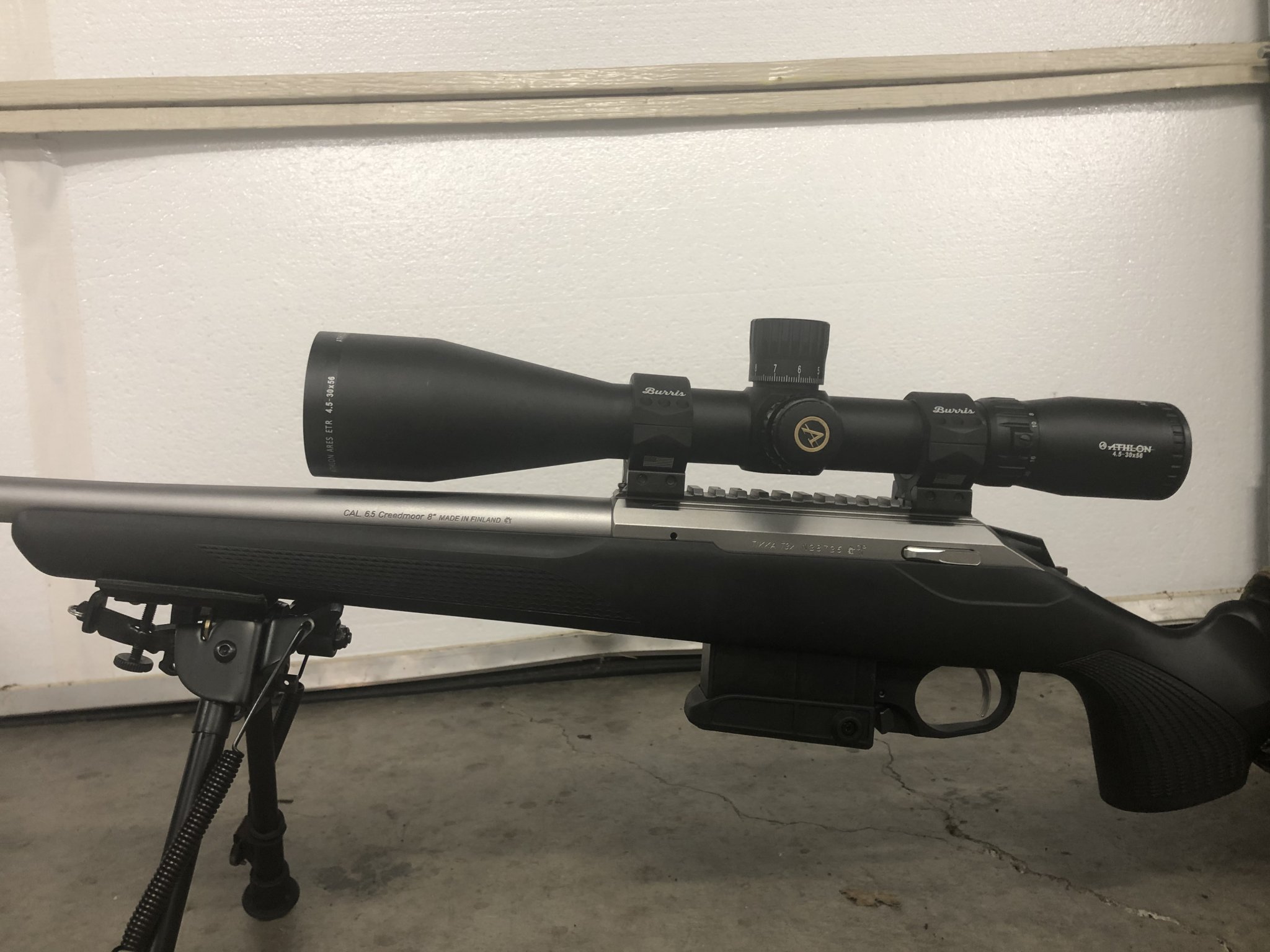

Got my ETR mounted on a Tikka CTR in 6.5 this week. 25 moa built into the burris rings gives me 20.7 total mils elevation up from 0 plus the hold over in the reticle. Really crisp glass and love the floating dot.
