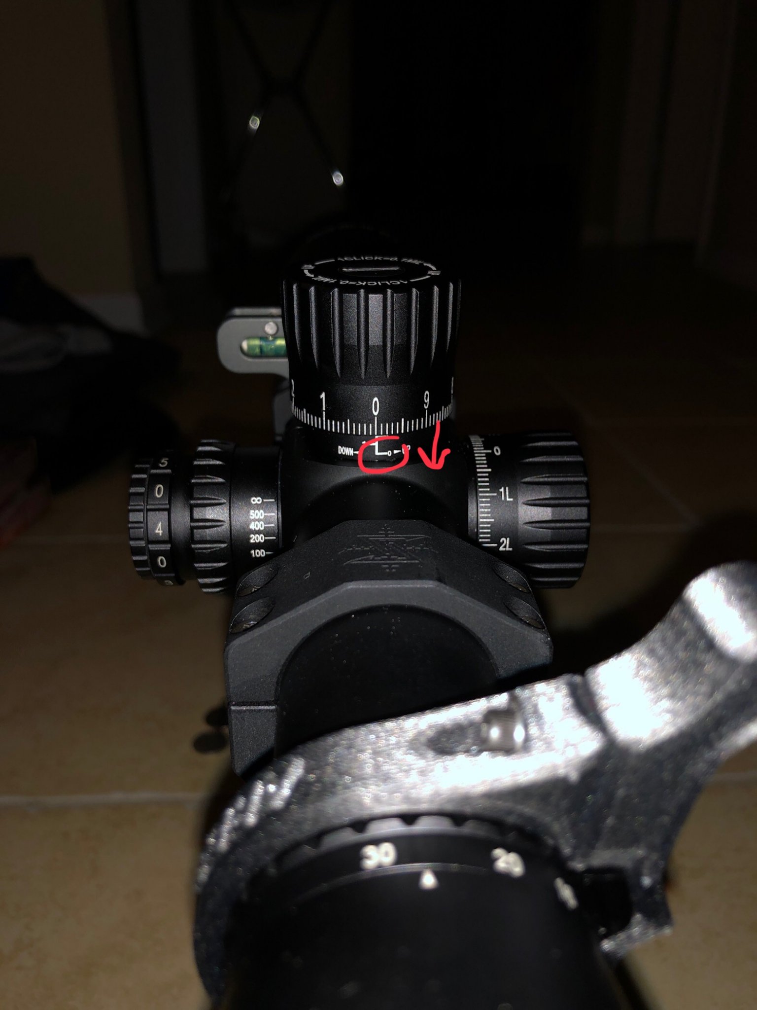

Honestly asking for a buddy of mine. We zeroed his Ares yesterday. It’s really nice for the money. Anyway he loosened the inner ring and got it back to where it’s supposed to be. The turret cap right now cannot be pushed back down and is currently sitting at the 2nd rev mark. Is this normal?

Pertaining to setting the zero stop. After the inner brass ring was set, the turret cap is stopping here when putting it back on.. Shouldn’t it be able to go back down to zero?
Zero isn't the bottom of the elevation scale range, it's a point on the scale where the rifle is zero'd at X yardage. The bottom of the scale is the lowest point of internal elevation adjustment, just as the top is the highest point.

Where ever the zero is on that "revolution scale" facing towards us in that pic, just at 1 rev above bottomed out, is a function of the relationship the angle the scope is set at on the mount and barrel axis. So if the turret is stopped on the ZS that's as far as it'll go down.
It should be right unless there is something wrong.
It just seems that it wouldn't make use of the rev count markings on the body. He's pushed down as far as it would go and it's stopping on the 2nd rev mark. Just seems a little weird. He's only getting about 14 mils of adjustment as well.
I'd start over, maybe check for burrs or some type of obstruction in the turrets or under the ZS. Right now with the 10 mils from bottom at zero and another 14 mils available, is 24 mils so around 8 mils are missing somehow???

If you guys dont have any build in cant, this is how it's supposed to be. Scope will zero around middle of adjustment range, like 16-17 Mil for Ares which has total of 32. It seems yours zeroed on 18mil, then you got 14 mil to go up. If you want to get more adjustment range, get some cant mount/rail, I think 40MOA one will work great for you. However, do you really need more than 14 mils up for your shooting?

Yeah even at 1000 I ran his ballistic data and it’s 10 mils up or so. We were just wondering why the cap can’t be placed all the way down. He has a Rem 700 SPS Tac. Not sure what MOA rail it has from the factory.

The Ares ETR has little teeth all the way around the knob. Both male and female. When I zeroed mine I needed to wiggle it a little to get the teeth to line up so the cap would go all the way down. Mine looked exactly like the photo you posted before I got the teeth to engage. Once I ligned it up it went on another 3/16-1/4”.

Yes, that is a normal situation with this type of zero stop system. The revolution indicator on the Athlon scopes is not influenced by / indexed to the zero stop. The revolution indicator instead always indicates which revolution you are on starting from the bottom of the scopes total adjustment range, not from where you set the zero stop.
The reason for all of this is that both Athlon's zero stop, and rev indicator system, utilize the natural threading in and out of the adjustment to function instead of having a much more elaborate system like those you might see in more expensive scopes such as the Vortex razor HD2's etc. The Athlon system is very inexpensive to do, robust, and allows you to easily set any number of mils below zero if you so desire. So, you get a lot out of it, just not the ability to have your turn indicator index to your zero setting.
