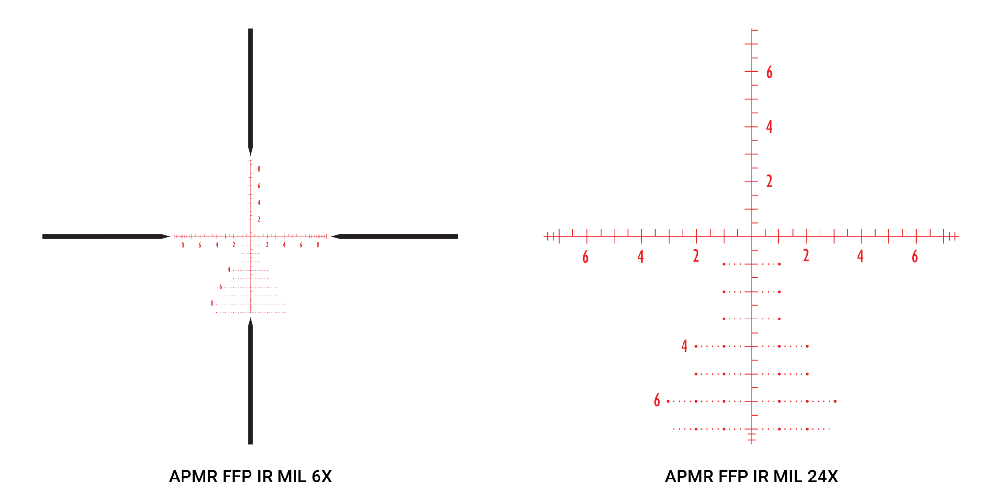

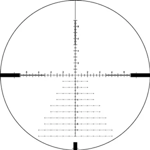

The reticles look almost the same. Whats better about the Vortex?
First is the Athlon, from there website
Second is the vortex, From there website.

Not sure what Athlon is doing now for reticles, but the MOA version was different than the MIL on the gen 1 Argos BTR. I had the MIL since I wanted a Christmas tree reticle. No open center and I thought it was too thick at higher magnification. The EBR2C from Vortex is much more clean in my opinion.

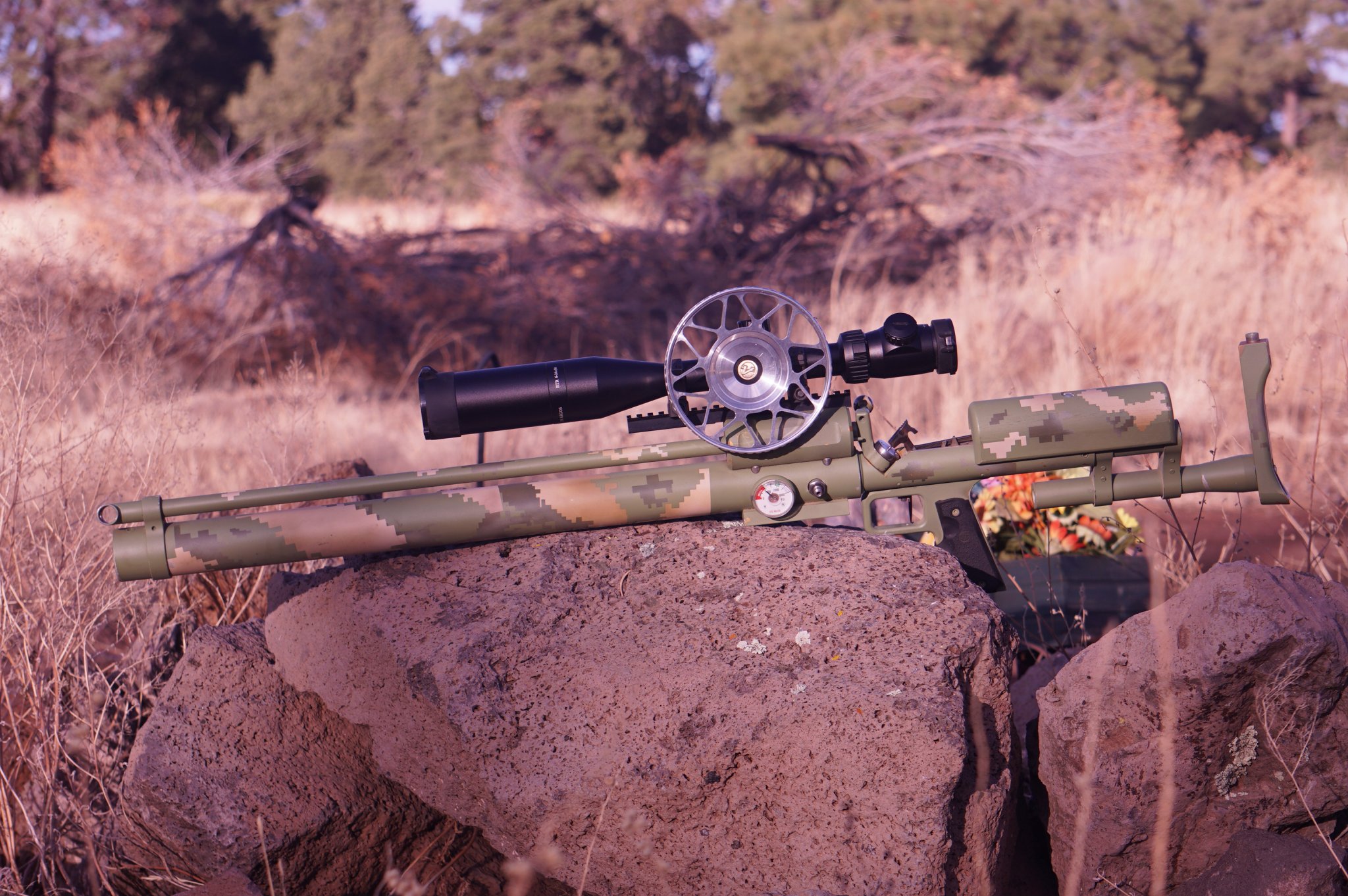

It was in Field Target air rifle matches and I shot in Freestyle division. I've dialed this Argos BTR 6-24 waaay more than any of my other scopes including my S&B's.
Mac1 USFT PCP is a semi custom match 20fpe rifle specifically made for FT. In calm conditions it'll put down sub 1/2" at 50Y.
Also have won our AZ state match 5 times with this rifle in open division, once using this scope.
I have S&B's on my go-to $3000+ match centerfires but have had Argos BTR's on my lesser rifles, but I have since gone to the Ares BTR 4.5-27x50 for them.
Here is my USFT rifle.

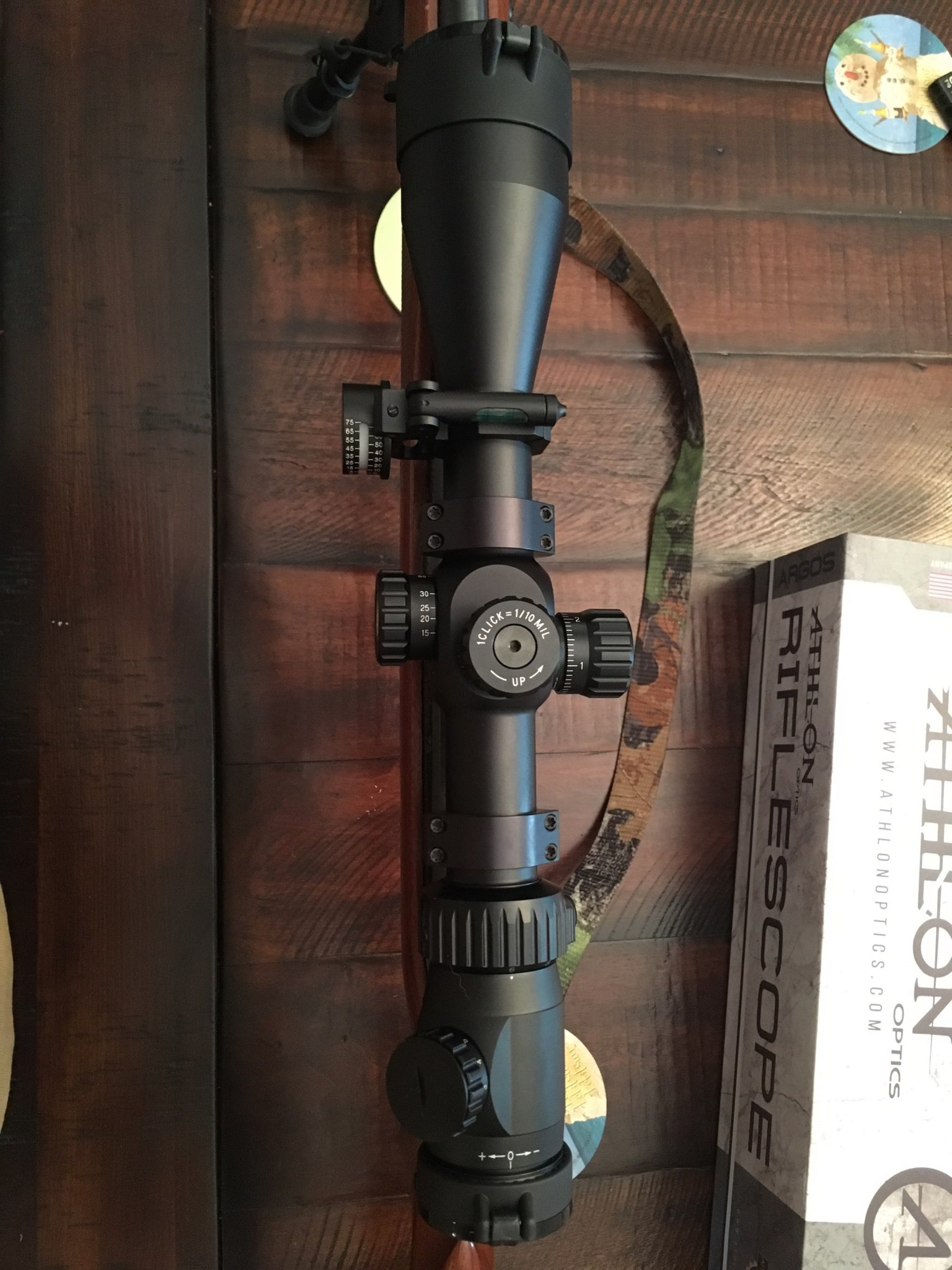

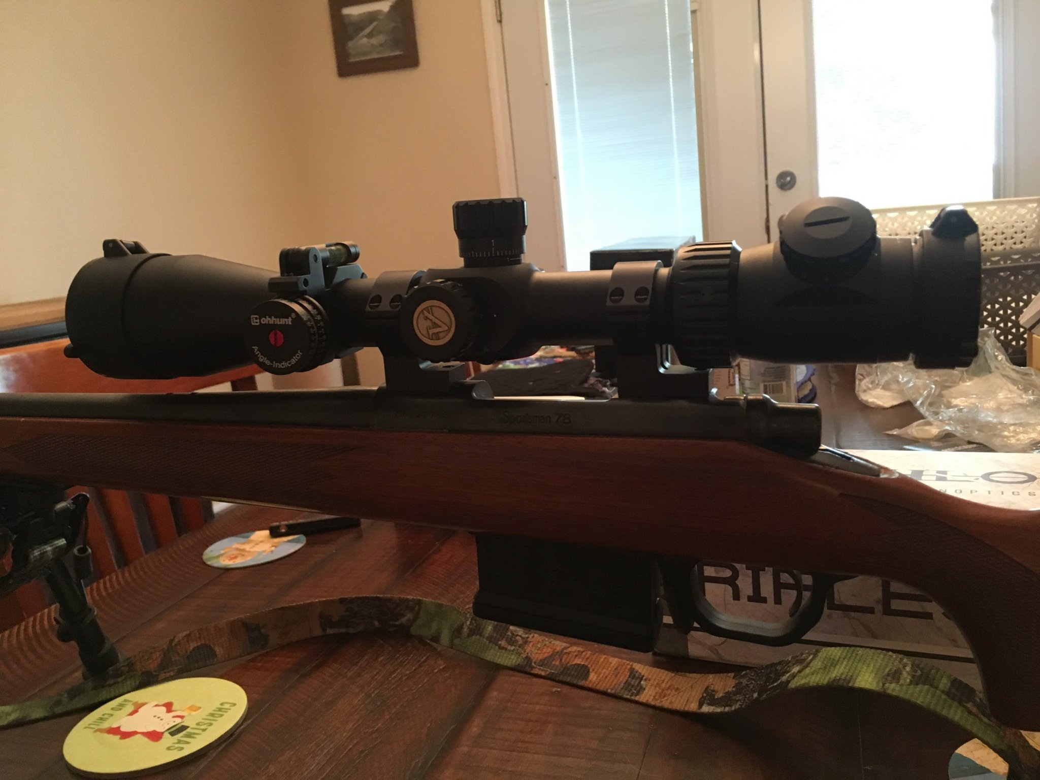

Scope showed up yesterday. Its pretty nice. Mounted it up this morning. Added a level and angle cosine indicator, just because it was cheap and if I ever do get to shoot from a tower I'll have it. It rained 2 inches last night so I wont be driving in the field for a few weeks. Maybe I can talk the wife into going to the range this evening or tomorrow.....

Shot it today. First shot at 25 yards was a couple inches low. Moved to 100, fired 1, adjusted up some and a hair left, shot up the 1in bulleye. Took the turret caps off and set them at zero. 3 clicks up, moved to 200 and was on. I need to improve my fundamentals but the scope seems to be good. I guess a real test would be to attempt shooting a 4 or 6 inch square at 100? Figure 2 shots in each corner? I've read about shooting the square but have never actually done it. That would basically show that my scope is or is not capable of tracking. I was thinking about a throw lever for the power ring, but looking at it I dont think it will clear my bolt handle... And that's something I can easily live without.
My buddy came out with me today. My mom ordered the new 5-25 Vortex Strike Eagle for him on her law enforcement discount. His glass looks about the same. The reticle is almost the same. The Strike Eagle turrets are way bigger and lock. The Athlon has slightly crisper clicks and the lines on the turret knob and body line up, the Strike Eagle is slightly mushy and the lines do not line up. The Athlon is mushy, the Strike Eagle is slightly more so. I like them both about the same.
Time and punishment will tell what the quality really is, but I try to be good to my equipment. Once the neighbors field dries up some I'll push it out further.
