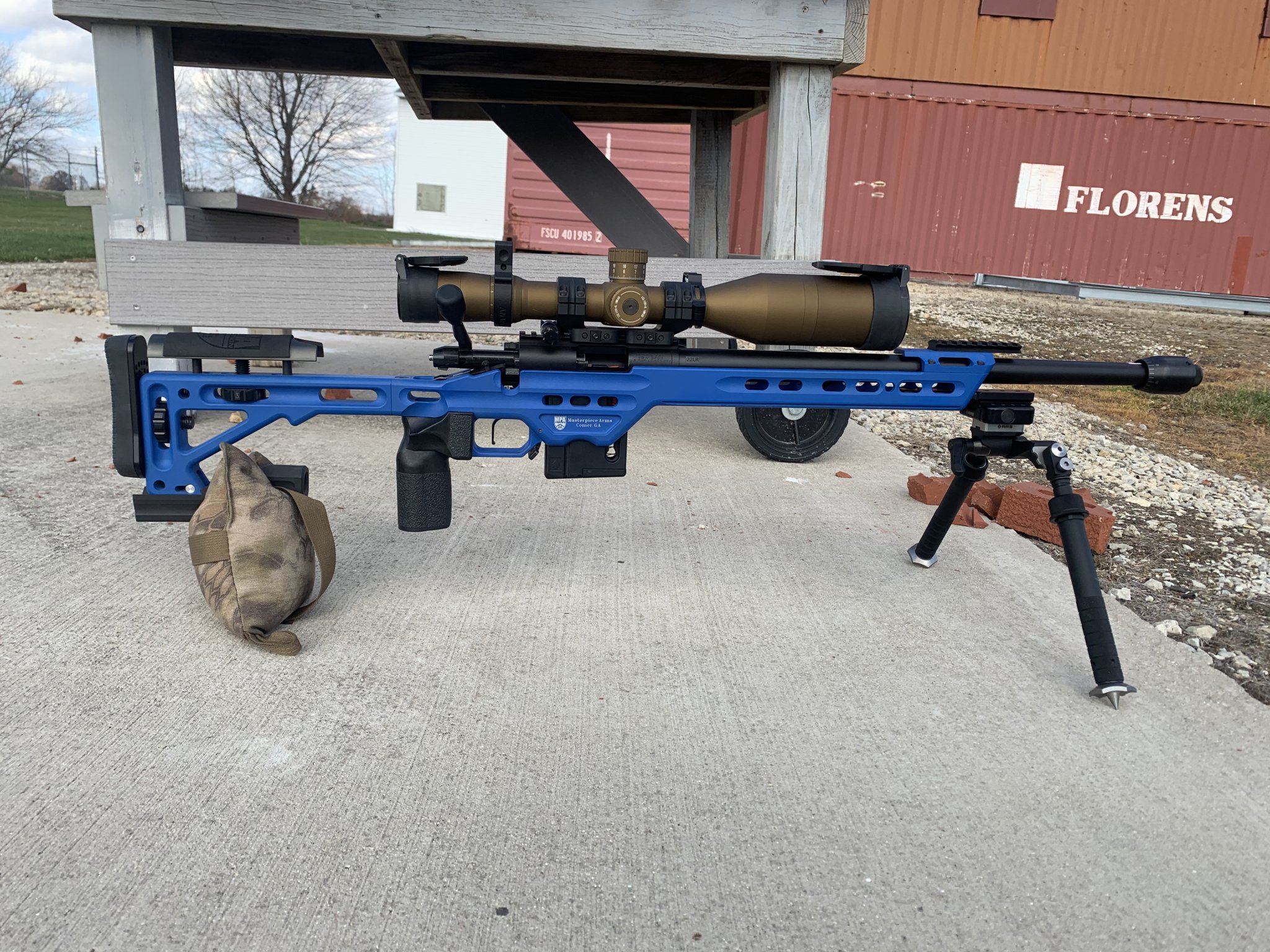

    I ordered an Athlon Cronus BTR GEN2 4.5-29×56 APRS6; going to put it on top of a Vudoo Apparition in an MPA BA Competition chassis with a 20" MTU barrel. Just waiting on Vudoo to call me for the build confirmation. Got a set of Warne 34mm Precision Scope Rings MEDIUM 7221M with the scope for a buck.
    Am I hunting down the right lane, or should I make some changes?
    Sounds pretty close to mine. Athlon Cronus gen 1 with a 22” MTU in an MPA chassis. Only thing different is I used a MPA scope mount on a 30 MOA rail.

    Ordered. Decided to go with a 40 MOA base, 20" Ace MTU barrel (FDE), MPA BA chassis (FDE), MPA ultra bag rider, Trigger Tech Diamond Pro Curve. In just 16 long miserable weeks I should have it.
    Now to decide what bipod to get for it. I have four Harris 6-9" bipods, but probably will go with an Atlas for the Vudoo.
    With the 40 MOA base, I'm hoping I can still dial/zero at 25 yards for short distance. Can either of you confirm that? It's unlikely to find a range around here beyond 100 yards, but I want to keep that option open.
    Edit add: the Cronus is supposed to have 32 Mils of vertical elevation.

    I don't use a Cronus, but I have an Ares ETR with the same 32 mrad of elevation on my Vudoo in an MPA. It is on a 30 moa rail and I use the Burris XTR rings that have another ~32 MOA in them for a total of around 62moa. My rifle is zeroed at 32m without issue. You'll have no problem with a 40 moa rail.

    With a 30 MOA base I have 24 mils elevation. You will be fine.

    You can go up to a 60moa base with the Cronus with no issues. so 40moa you'll have more than enough room
