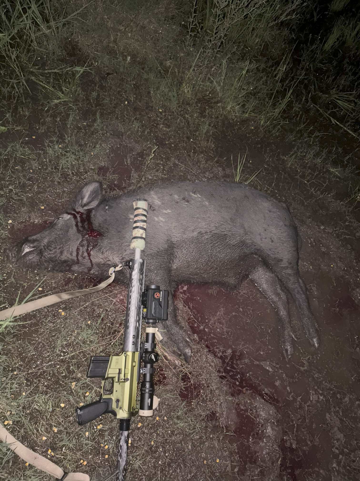

    I got the unit in hand at 7 PM and we had a 7AM departure, so time for reading and learning was very limited. We were happy to find the optic was minute of pig close to POA/POI without having to even go into a zero menu, so it did make it into the field and did put a pig on the ground.

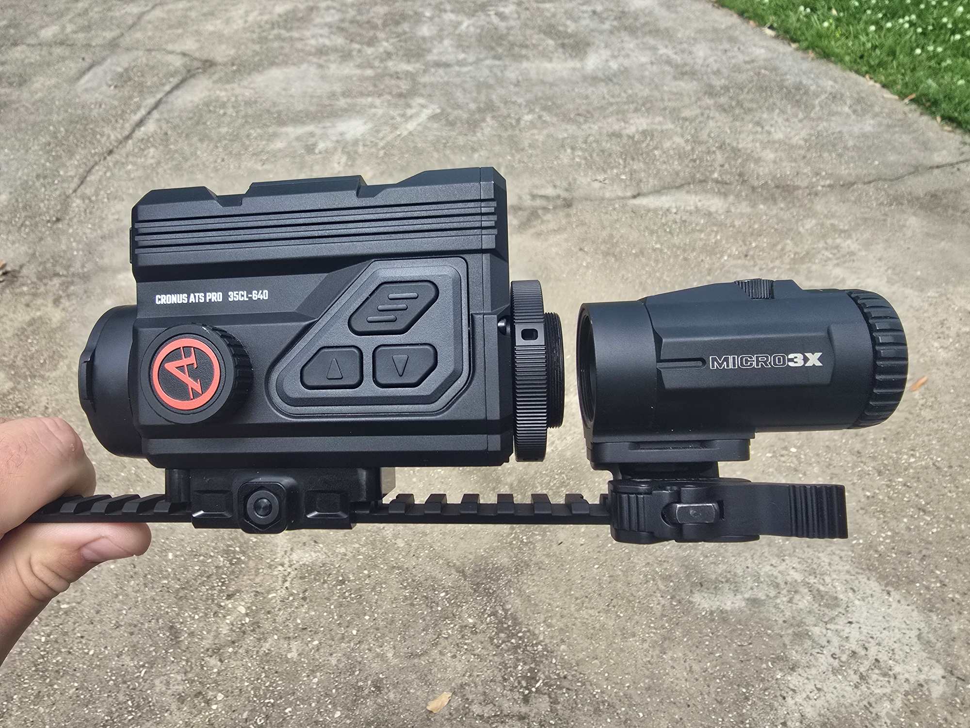

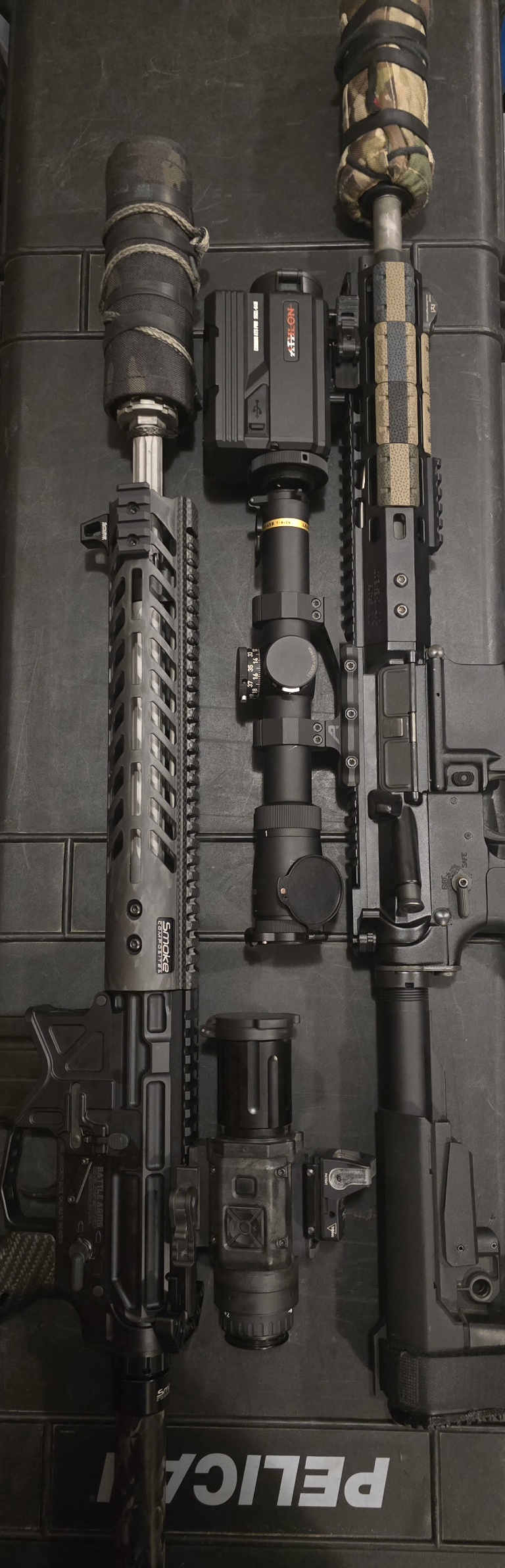

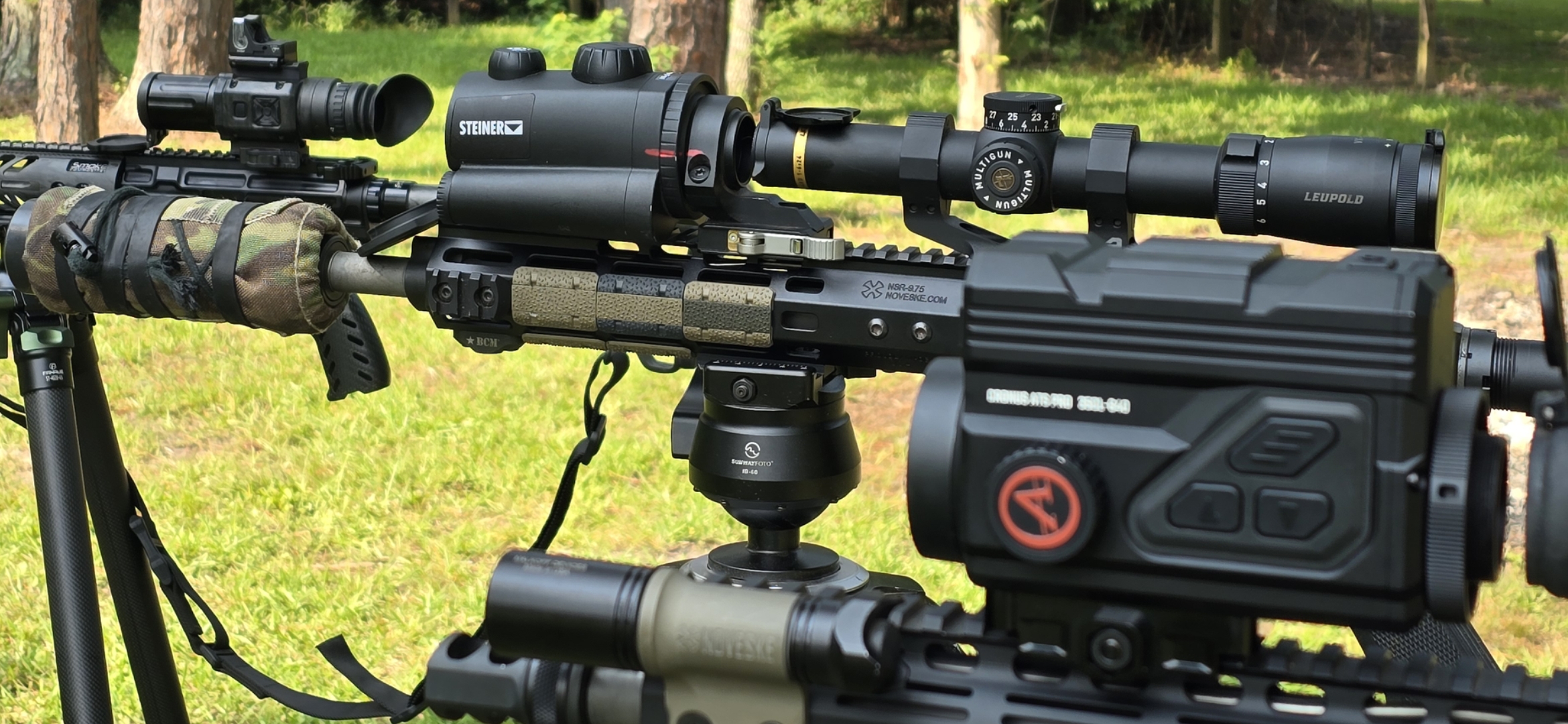

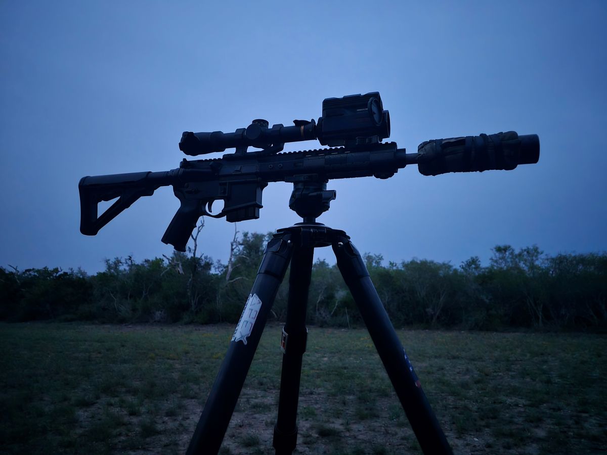

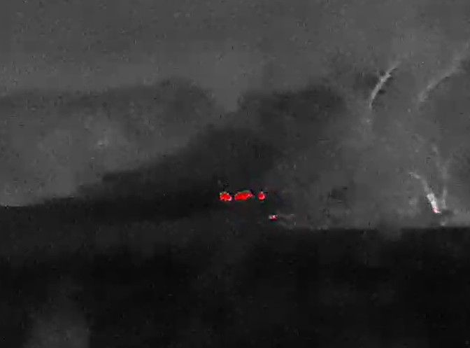

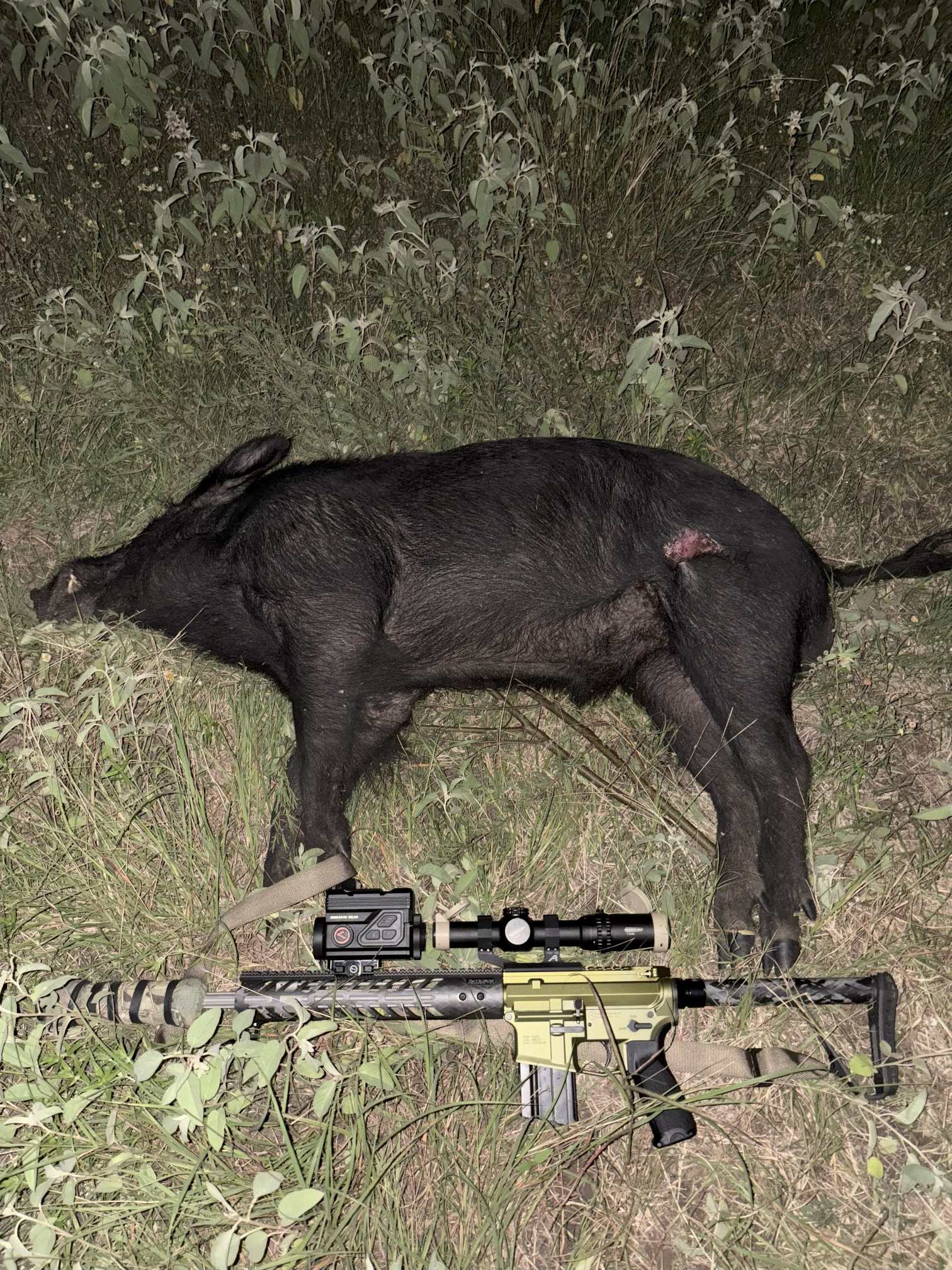

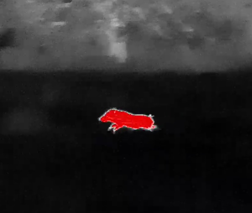

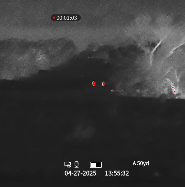

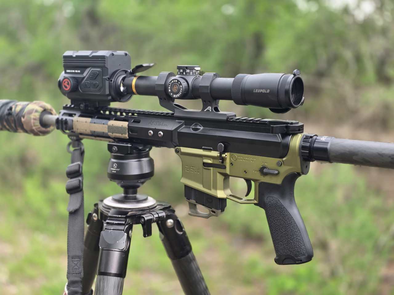

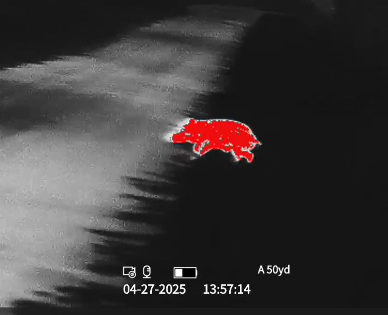

    The Athlon was being used side by side with a Steiner C35 Gen 2. The photos below shouldn't be taken as a comparison per se - we have a year on the Steiner, and barely adjusted the Athlon. The Athlon was on a 12.5" Grendel with a Leupold VX6HD 1-6x, and the Steiner on a 14.5" 556 with an old school first gen Vortex Razor 1-4X. The pigs were at 180 yards per the laser. The pigs decided to charge, which didn't prove to be the move. In both cases, through the scope, species ID was easy and absolute. The shots below are all taken from video.
    I've come to really appreciate scanning with the handheld. Even a first gen Burris with a 400x300 sensor makes life much easier, and minimizes the amount of swinging guns around while scanning.

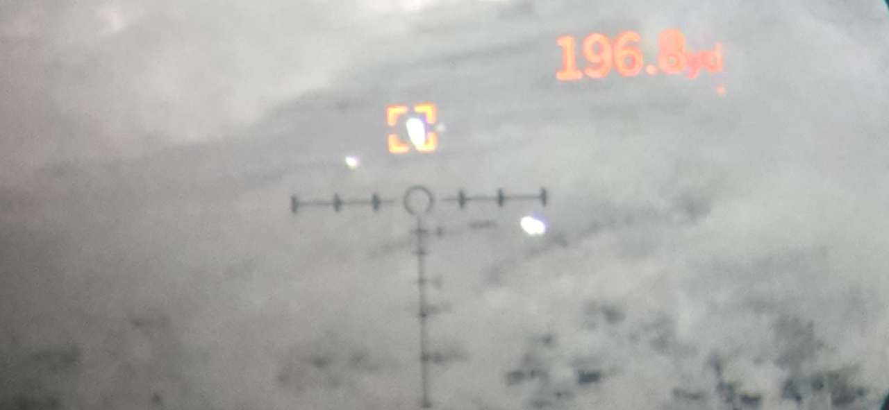

    The view that shows the 196 yard laser shot is taken through a cell phone cam, so again doesn't begin to capture the clarity you're actually getting to the eye.

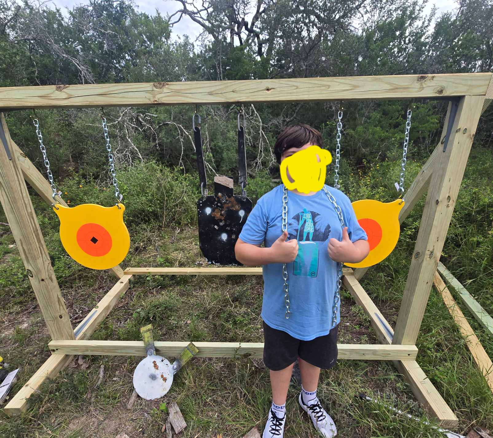

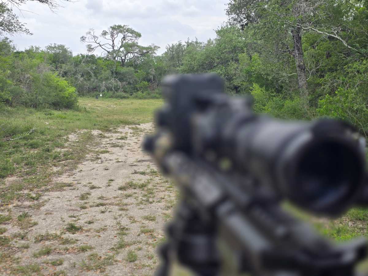

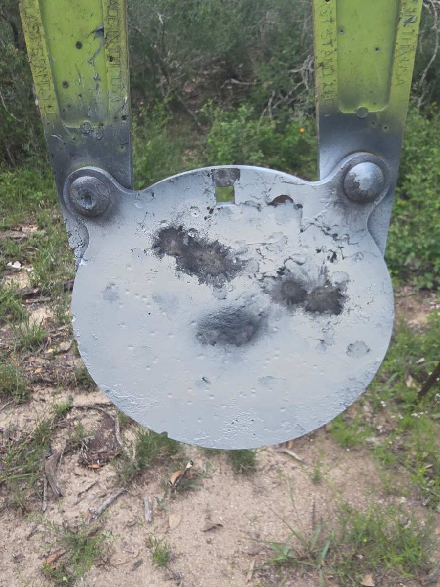

    On the gong, the two shots above the center dot was with the scope, and the two to the right were just clipping on without touching zero. I let well enough alone and it was indeed minute of pig.

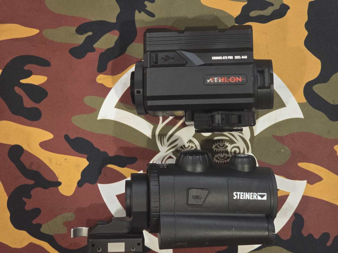

    It isn't even a contest. The laser puts it in another league and you can't disregard the mount. That is like saying - disregarding cats being from the devil, which do you prefer - cats or dogs?
    They are not the same species between the mount and laser. The Steiner clip Burris adaption isn't a real solution. If I could hit the Steiner and turn it into the Athlon, I'd roll the dice based on first impressions and the clip situation specifically. With the Steiner, the mount is 75% of my gripe, 20% is the 2 year warranty, 5% is that the power button is not super well positioned if you slide your gun in and out of carriers - sometimes it will activate the camera, sometimes power up or down, but when you're aware of the possibility it is easy enough to be aware and check it.
    The Athlon mounts exactly as you'd expect. I adjusted the tension to the rail and it seems to be solid and sufficient.
    I believe it is a 5 year warranty vs 2 years.

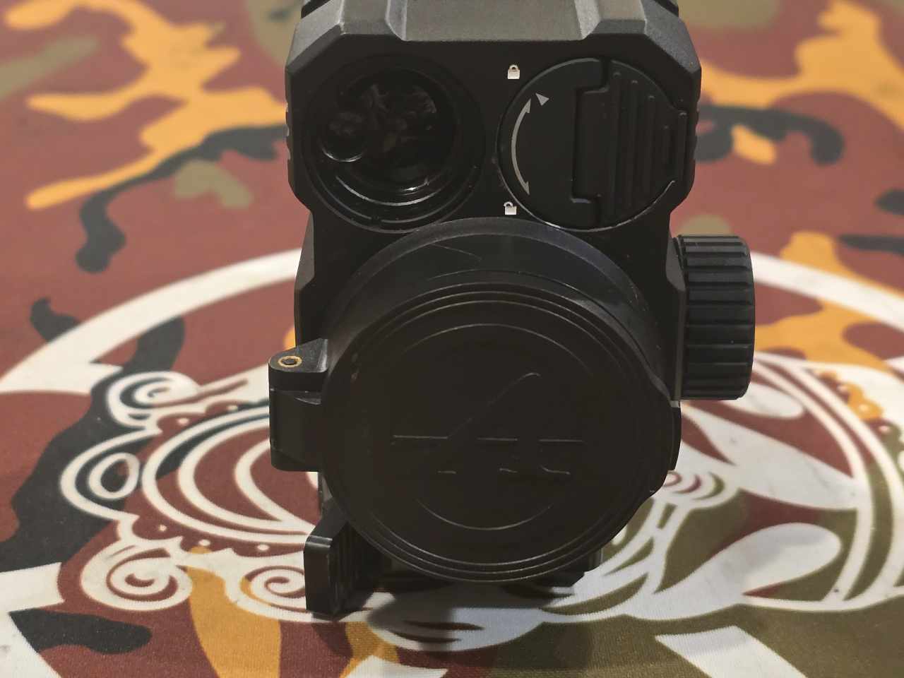

    The laser is super, super easy. One touch to activate, one touch to range. This is such a game changer in the dark.
