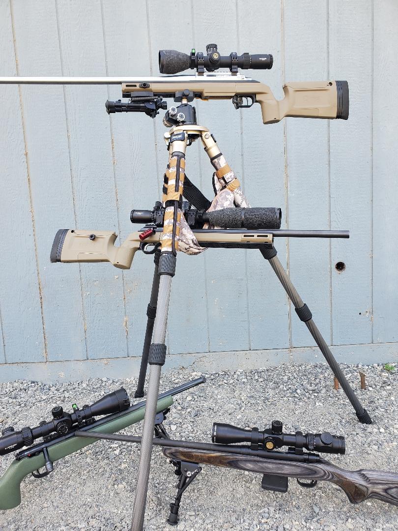

I purchased the CF36 a couple of months ago, and other than it being a bit on the heavy side, it is a great tripod. As a matter of clarification, the numbers do not refer to the ballhead size, rather to the leg thickness at widest point. I bought the 36 as it has the same 40mm ballhead as the 40 (numbers again refer to the legs). My CF36 is just shy of 8 lbs. One nice part of this tripod is it comes fully equipped with a hammock, leveling head AND ballhead (leveling head makes for more stable rifle shooting albeit while giving up some adjustability in my opinion), spike feet and rubber feet as well as a shoulder carry attachment which helps me move the tripod from stage to stage at PRS events. I really like this tripod over the aluminum ones I have been using up to this point.

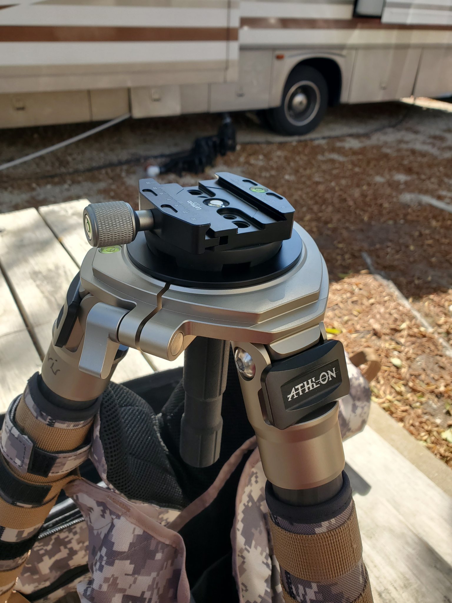

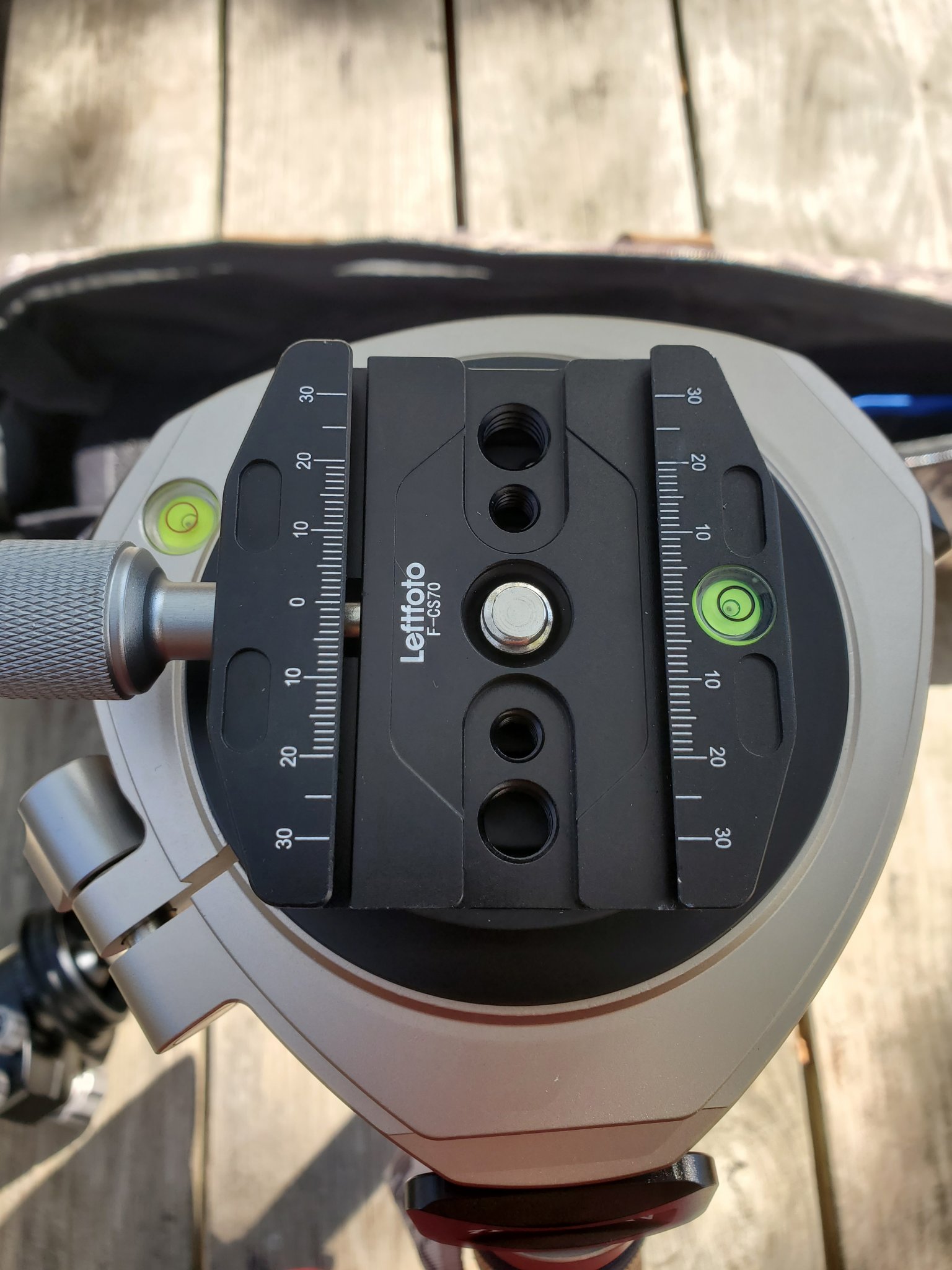

What clamp are you using on the leveling head? Ive got the 40mm but can't find an ARCA clamp that will take that single center screw.
It's an Athlon ball head on the tripod (though I don't know the OEM). Most 40mm photo ballheads screw onto tripods with a single 5/8 threaded screw like this one: https://amzn.to/3ggPw07
@JeffreyD
If that $20 clamp holds zero with your rifle on it, go for it. More power to ya!
Right. I've got no issues with the ball head, I just wanted to try out the leveling head but haven't found an ARCA clamp that will fit it. Maybe I'm missing something, this is my first tripod besides some small vortex go passing set ups.
I'll get a pic in a few and post it.
Got ya. I hadn't tried pulling the clamp off the ball head. I assumed it wasn't threaded because the ball head has the screw going in from the top. Guess I'll have to experiment.
I pulled nothing from the ballhead. I bought a Lephoto clamp. Keep in mind that you have to adjust the center screw depth so as to not interfere with the rail, and then use the set screw in the head to lock it down. I used blue locktite everywhere to ensure no backing off unless I meant it.
Reactions: sam4886
I track you now. Thanks for walking me through it.
Any idea what thread/screw size that center screw is? Or are they pretty much standard?
