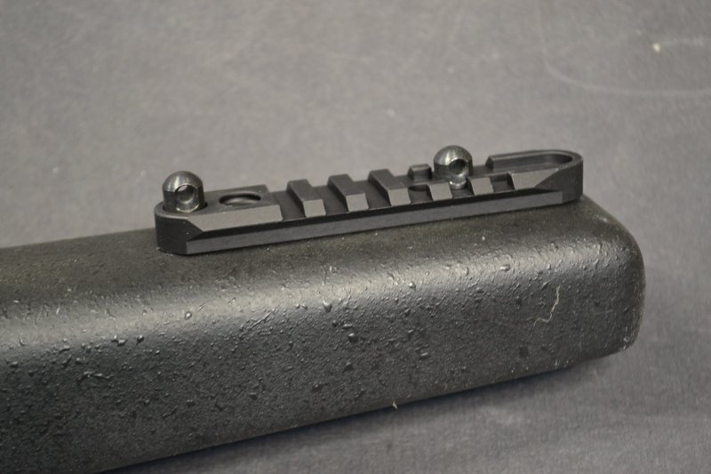

I believe you can buy from the B&T site a rail that will allow you to attach it using the threaded holes filled with the sling swivel studs. Remove the studs, use one at one end to secure the rail and then use a button head screw to finish attaching the rail at the other end. IIRC they have rails for different hole spacing.
Seekins also offers a rail that you can use the swivel stud holes to mount.
Added by edit:
Check this out. They do offer them and you just pick the one that fits your hole spacing. You have to order mounting screws and stud spacer separately but it's definitely a "No Drill" install.
http://www.accu-shot.com/catalog_new/48-atlas-bipod-accessories

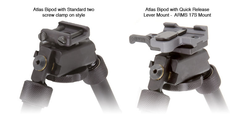

If I have a BT10, can I convert it to a BT-10NC? I saw that you can send it back to BT and they can do a conversion, but was wondering if it's possible to just do it yourself?
Short answer: No (as far as I know)
Long answer: The two screw clamp assembly of the BT10 and the NC assembly are different parts. The lack of the part for conversion is the road block.
Anyone that disassembles their bipod, loses or break parts in an attempt to disassemble or cannot reassemble the Atlas Bipod will be charged 75.95 for this service.
Anyone choosing not to use this service does so at their own risk and liability voiding the bipods warranty.
B&T Industries L.L.C. does not sell or ship parts.

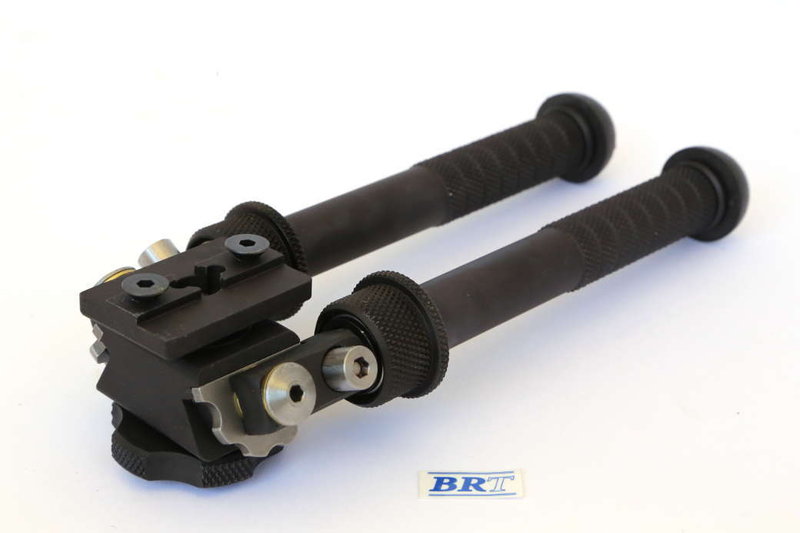

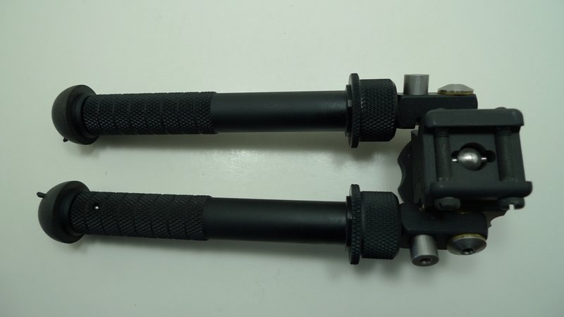

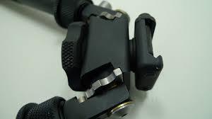

NC assembly - provisions for 2 bolts allowing for the various compatible attachments. $$$Atlas%20Bipod%20BT10%20No%20Clamp%20(for%20BT19%20spigot)$0.jpg
See below for more pictures of the differences between two screw clamp version vs NC version with a mount installed.

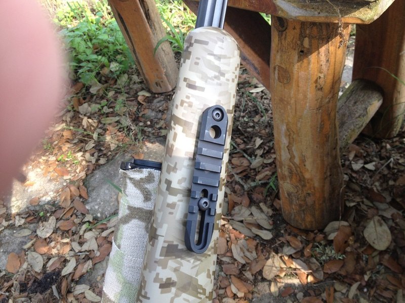

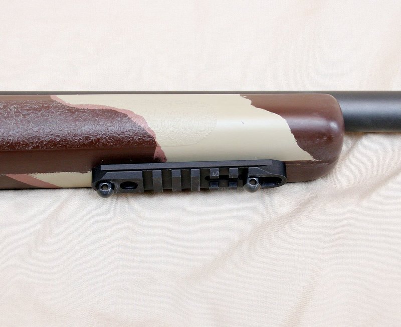

Thanks evintos so I have now established I need the BT17 base as the front of my rifle is fairly flat. I believe the BT15 base is for curves. My next question is the BT10 model the one that is $220 US on their website how does this get mounted to the base? Can this be mounted to the base without drilling any further holes ie can the 2 screws used to screw in the BT17 base be used to screw the BT10 bipod?? I don't need a quick release system once I mount it it will stay on there but I'm not sure if the non quick release model needs screwing into the stock?
.....My stock has 2 sling swivel mounts already in the front is there a way to attach one of these atlas bipods too these swivel mounts??
....My next question is the BT10 model the one that is $220 US on their website how does this get mounted to the base?
From what I can tell, you shouldn't have to drill anything and the only tools you would need is a screwdriver and something (like a punch) to remove swivel studs (if you have them).
BT10 comes with its own two screws "clamp" system (clamps with sideways pressure) around any MIL-STD-1913 rail.
In your case, since your stock has two sling swivel mounting holes, what you would want to do is install the BT17 base utilizing the existing sling swivel mounting holes (no drilling) and use button screws or use swivel studs (+spacers if necessary) to secure it. Optionally use medium strength thread locker (such as Loctite 242 or Permatex blue).
If you have swivel studs already, unscrew the swivel studs, line up the base with swivel mounting holes, screw swivel studs back in (you may need a spacer/washer if the swivel stud threads aren't long enough to engage) to secure the base. Optionally use medium strength thread locker (such as Loctite 242 or Permatex blue).

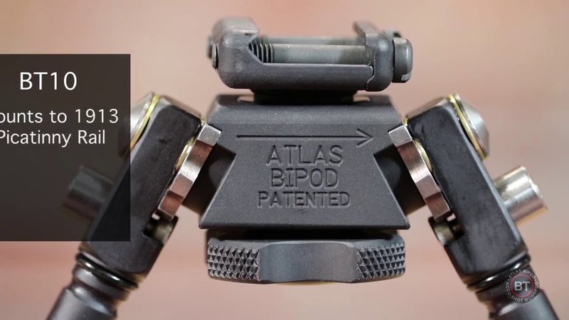

To mount BT10 see the video link. https://youtu.be/vjDOyvhQHJI?t=2m1s (the mounting of the bipod starts at 2 minutes into the video.) Hope this helps.

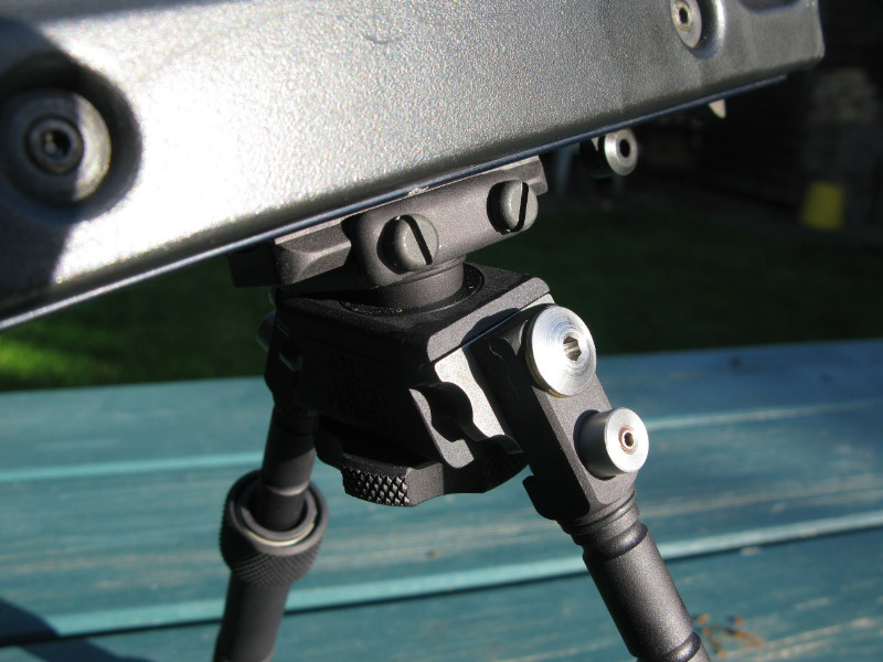

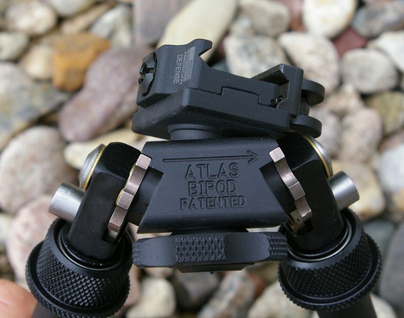

I know I'm late to the discussion, but found a way to use the BT-10 and a QD mount.
You need the Larue LT271, I have the old LT171, same thing, it came off an old pentagon light I have, and then you buy a Atlas BT20B, and bolt those together, I got mine off eBay for $20 from an Authorized Dealer. Adds a little weight and height, but I haven't voided the warranty, and can use it on any rifle quickly without tools needed.
