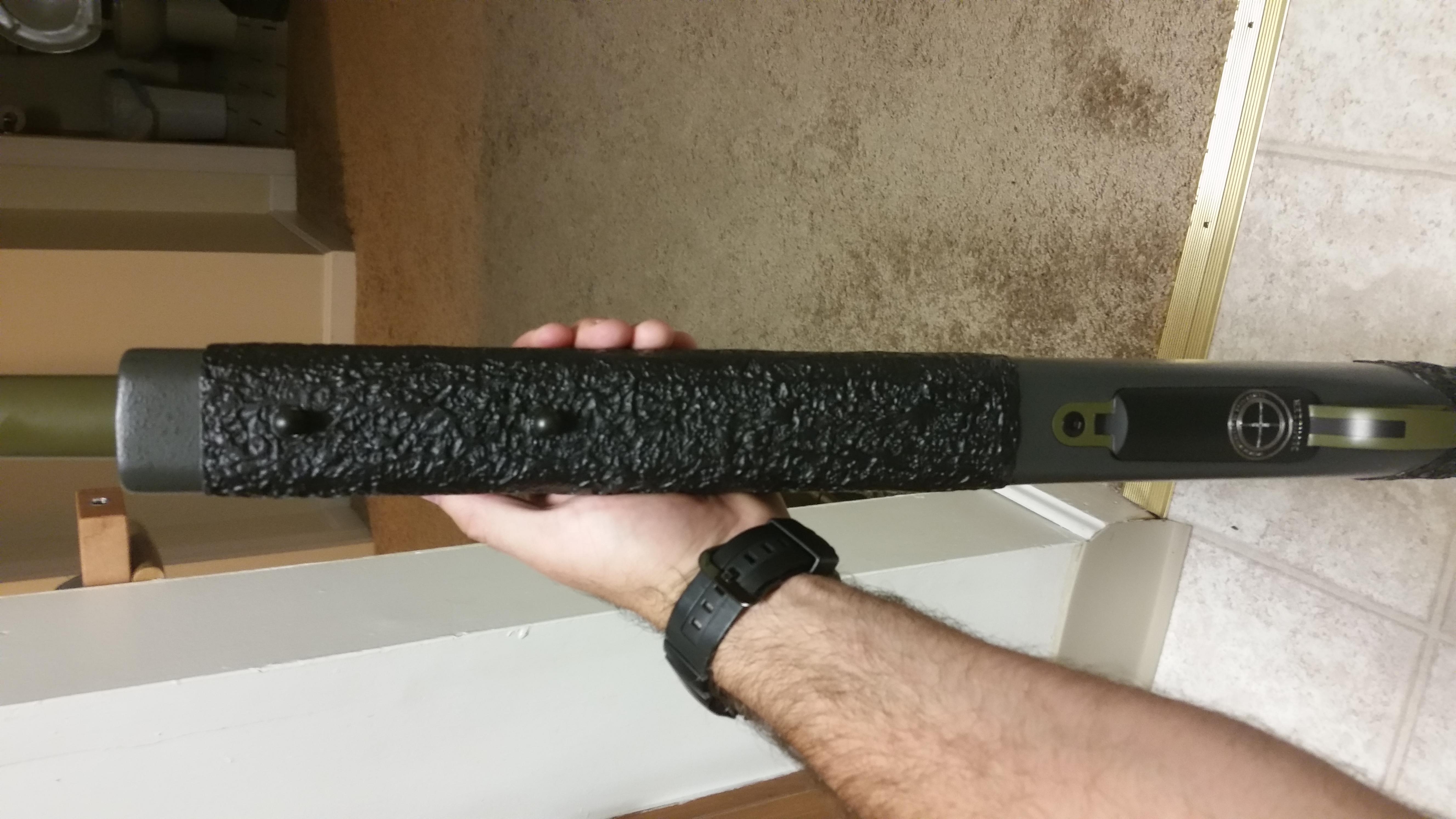

Anyone know what would be the best way to attach a Atlas PSR bipod to this?
A Seekins SRS or Atlas rail, with screw spacing for McMillan stocks is the best way.
Would be easier if you asked Mike to add his rail option to the stock.
Another non permanent option is a stud to rail adapter, if you dont want to mess up the perfect exterior of that stock.
CUrrently do not know of any useful adapters for doing this.
You'll be fine, worst case you need a little sandpaper. I think any of the rails mentioned will work, and your best option IMO.
I'm guessing that is a pliable material? You don't say what the hole spacing is but a rail that is relieved on the back would be a better option, reducing the contact surface, then just tighten it down "into" the material just enough to be solid. We sell the BT15, looks like it is probably too short for your hole spacing but you can always relieve some material from the back of any rail.
You might have to remove any exaggerated high spots on the stock as well.
It's got a standard McMillan screw spacing i think. The texture is marinetex, and looks like it is coated in Black T.
Sanding it down is possible, but you got to be a magician with it to make it look nice and clean after.
What you desire if you need a rail is a flat contact surafce with the rail footprint, doing it without chipping the surface it is the hard part.
Send Blackops a PM and ask how he does it?
It's quite apparent it is one of his rifles
You could always bed the rail to the stock with more marinetex if you don't want to remove material. It would be simple enough, and you could do a very clean job on it in about an hour. You'll probably be fine just tightening the rail on without worrying too much about it. I'd definitely try mounting it without modification first.
