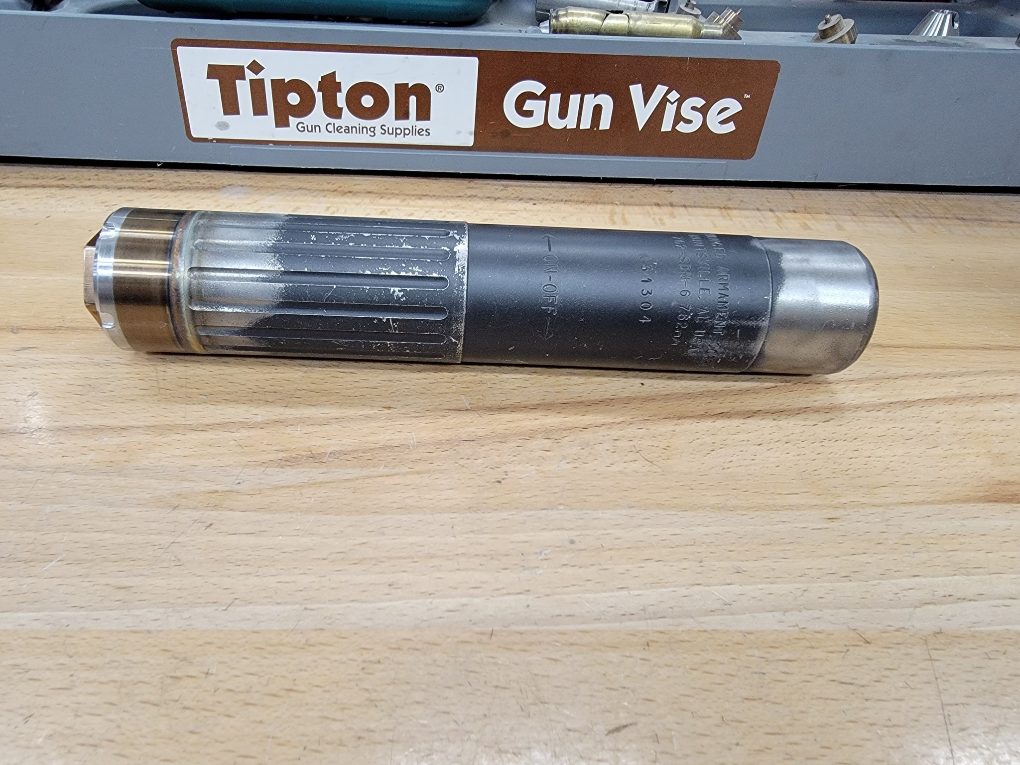

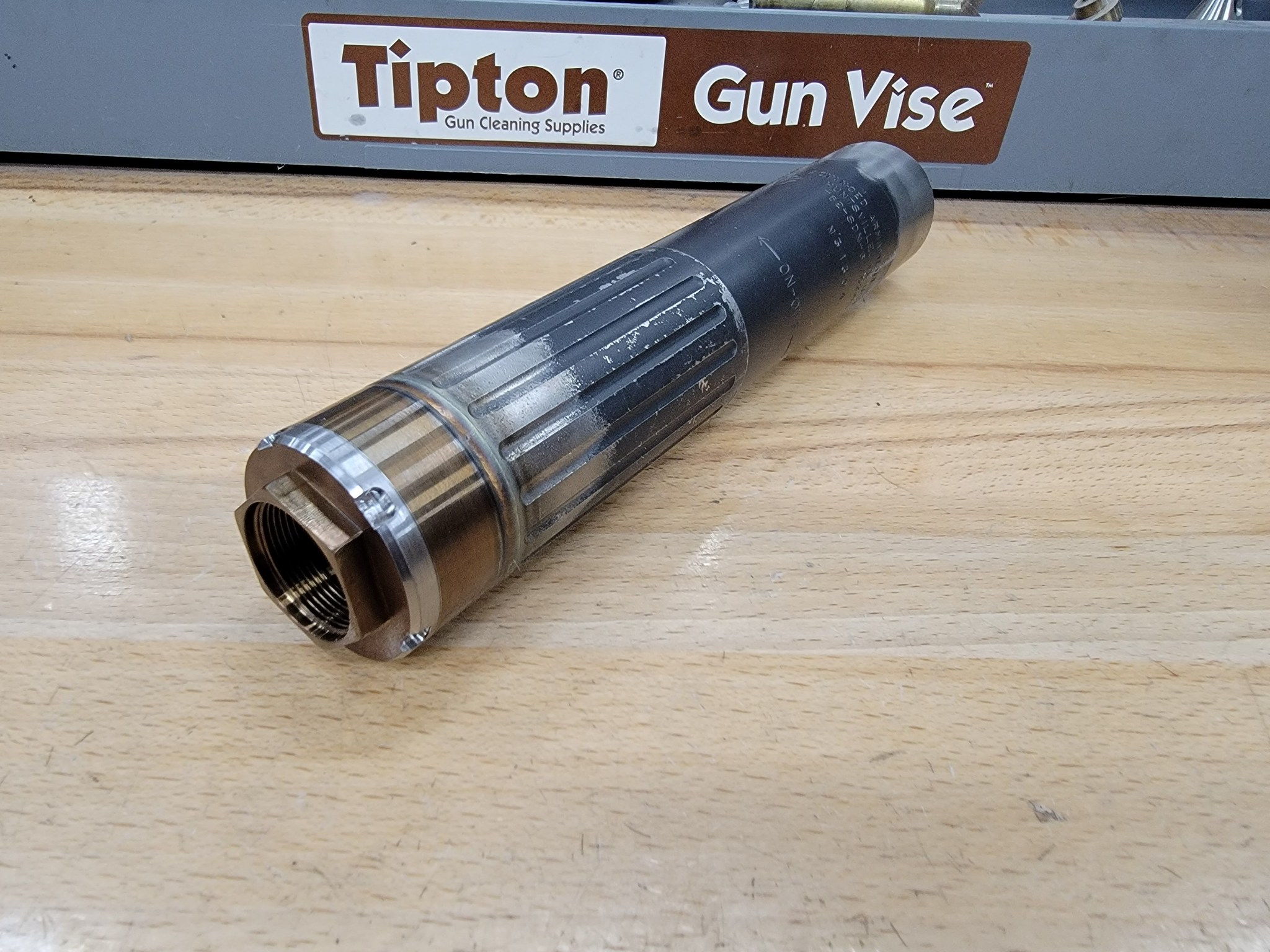

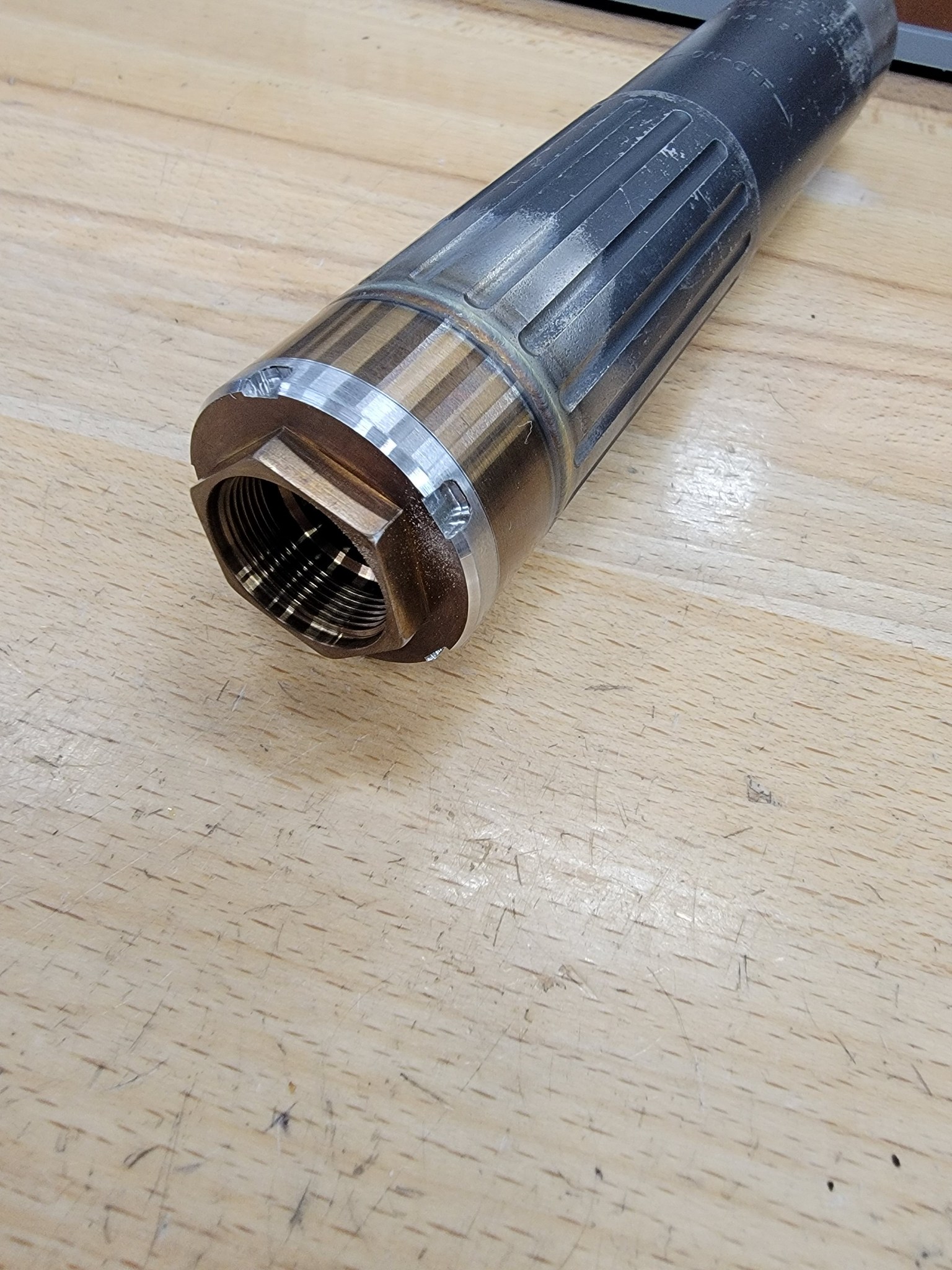

Are you tired of that shit 51t mount system? I was. I ended up contacting ECCO Machine & Fabrication out of Colorado. They offer a 51t mount conversion. Had mine threaded to accept a Q Plan B.
They do great work, and a great option to get rid of that trash 51t. They’ll also refinish it a color of your choice. I opted out of that option.

Looks good! i'm also on the list and going with the Plan B mount as well.
@Ferris Pewler Contact them on their facebook page and they will send you the info on the types of mounts and finishes you can get.
Not sure how many rounds you have through your Plan B, but mine have been stellar to the tune of ~ 12k rounds b/t 2. One on a Thunder Chicken and one on a form1 flawless and seals up perfectly.

Yep. In a bit of irony….once I got in queue with Ecco said WTH and decided I’d file away at one of my 7.62 mounts to try and get a solid lock….and I did….and paired it with a .308 AR10 pistol that holds zero.
I had ECCO do two for me about two years ago now. I guess he wasn’t that busy because I called him up, sent my cans in the next day, and had them back in about 2 weeks. I guess it must have caught on that he can fix these old shitty AAC cans. Had him do a 762-SD 18T that I had bought $1500 in mounts two get two that it sort of locked up on, and a Ranger 2 that had threads non concentric to the rear of the can and cause massive POI shifts and poor accuracy and AAC wouldn’t fix despite 4 trips to them.
