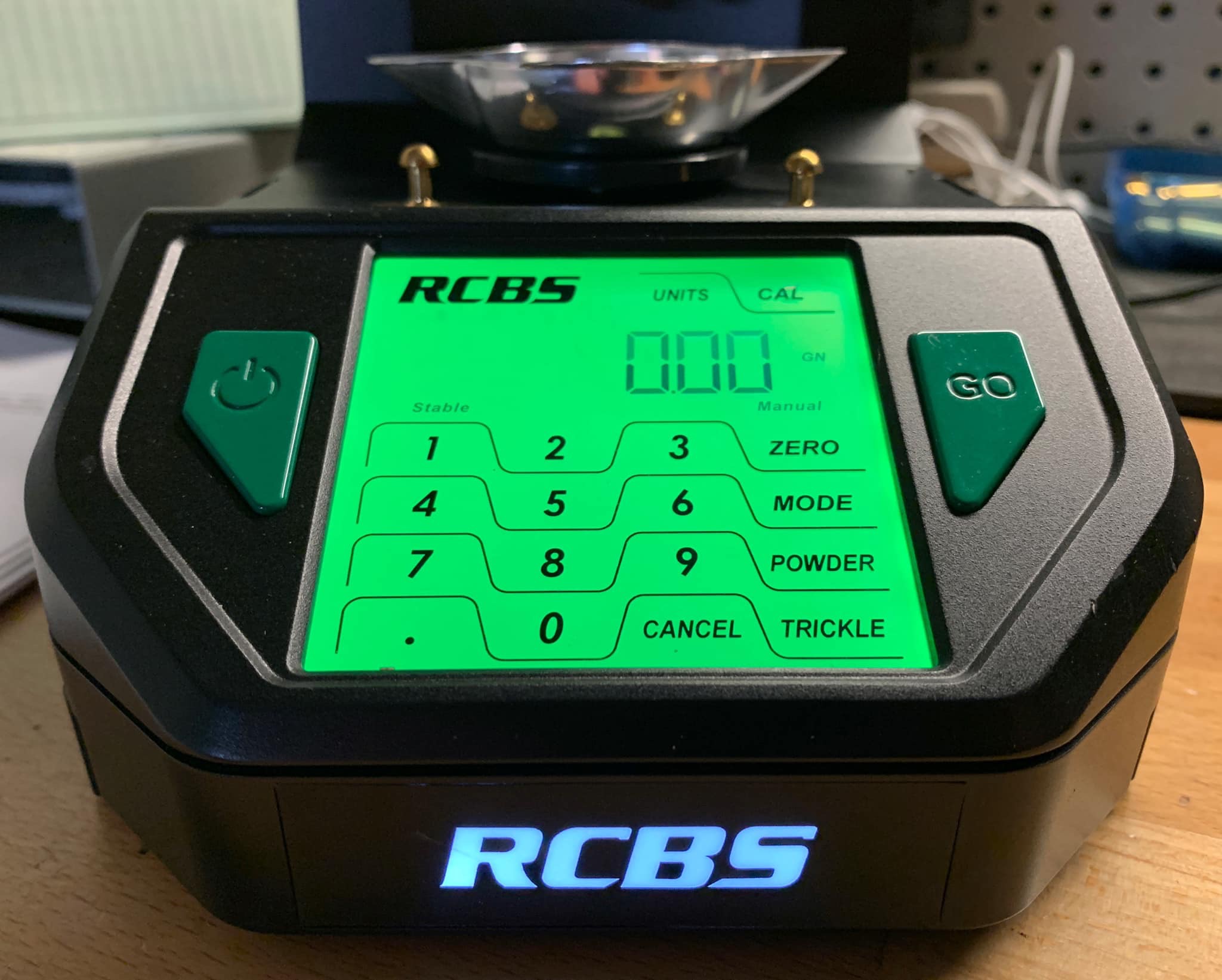

Where did you read this? Any right up on what’s improved?
Not sure but this photo was spotted in the wild. Looks like it’ll measure to two decimals which is a huge upgrade over the last.
Hopefully it no longer uses a load cell and they decided to go with magnetic force restoration sensor. But I doubt it. The issue with the current chargemaster, and also the reason I broke mine by punching it, that the scale portion doesn't communicate quickly enough with the dispenser, and is not in sync with it. It arrives at the requested charge, and keeps spinning, over-throwing by .2-.3 grains every single time now. I have a nozzle, I've reprogrammed it, I've used the straw mod, to no avail. It's just getting worse and I have had it. Put a deposit on the Autotrickler V3 but will also want a cheaper replacement for the Chargemaster.

It won't be mag force as just making a mag force balance is like $250 in manufacturing.
