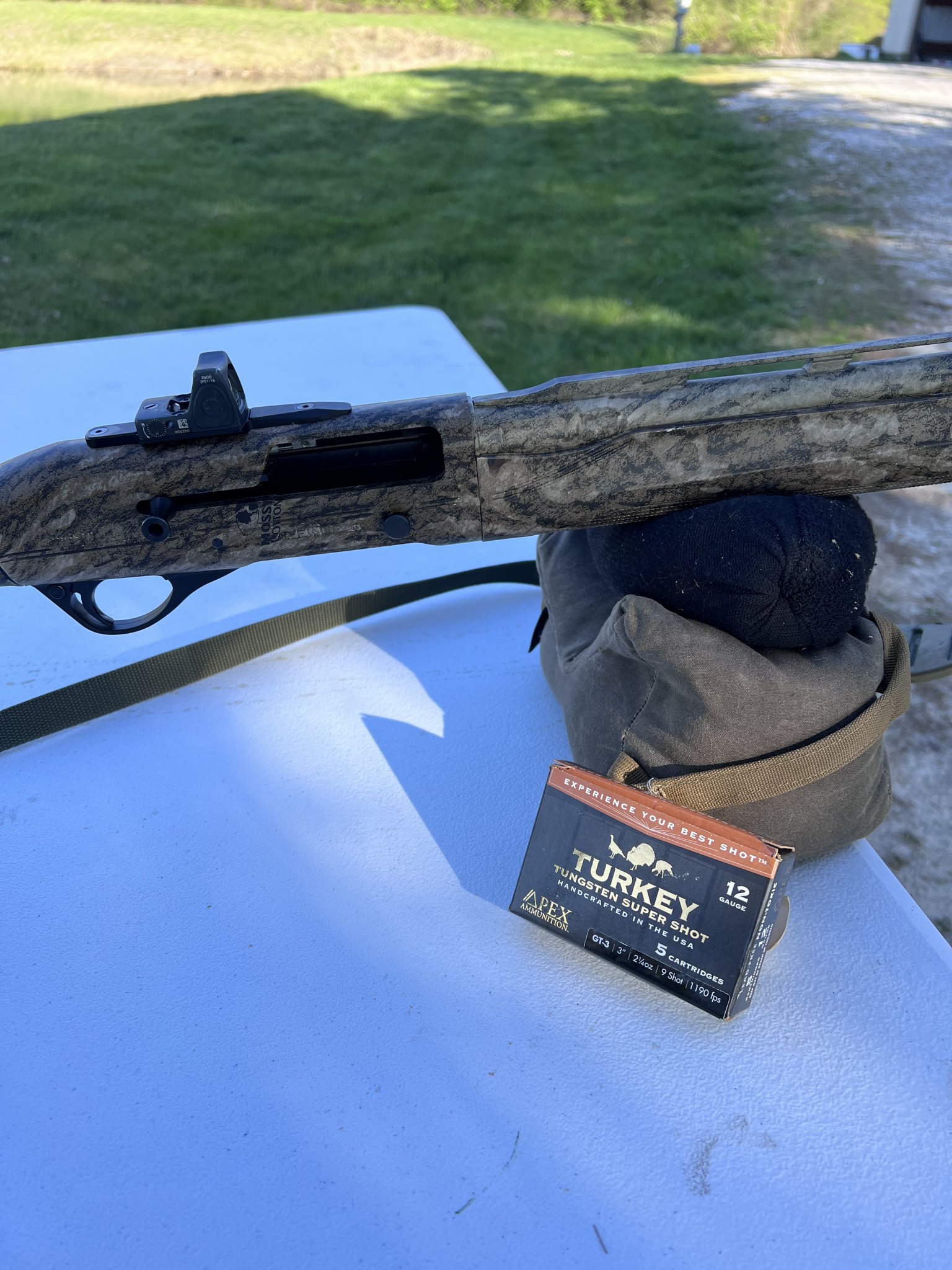

I don’t have a lot of rounds through my Affinity 3 but I absolutely love it. Primarily a turkey gun, but use it on rabbit and pheasant. Currently it’s sporting a rmr and a code black turkey choke. With Apex #9 TSS this thing hammers. Even with factory chokes it’s awesome. Was hoping to run it on annual all day pheasant trip this year and last but both got cancelled. I know you didn’t post interest with turkey but I was just giving you some info. Hopefully can get some goose/duck hunts with it in this year. I have the 26” barrel model fyi. The real tight pattern is at 25 the side by side are two shots at 50. I adjusted right in between the shots. Love love love it. I want one in 20 gauge as well
