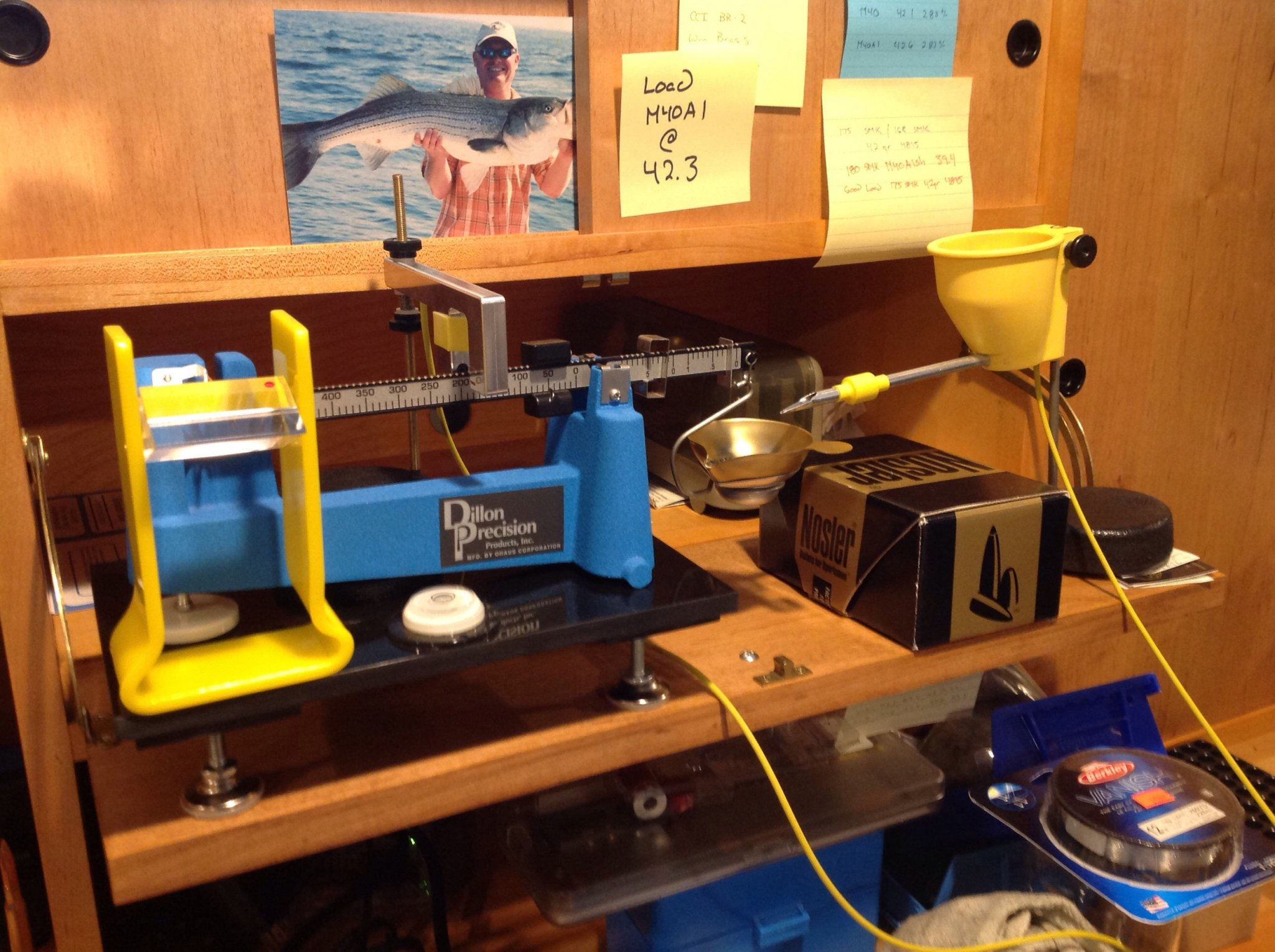

I load using an S1050.
With stick powders I set the drop to be slightly low.....and pull the brass after the powder drop.
This cheap rube goldberg device does its thing. I pour the powder from the scale pan back into the brass using this....
, replace brass on the shell plate and carry on.
Kind of a lot of transfers of powder but generally I only use stick powders for bigger cartridges where time doesnt matter and quantity is sufficient for needs.

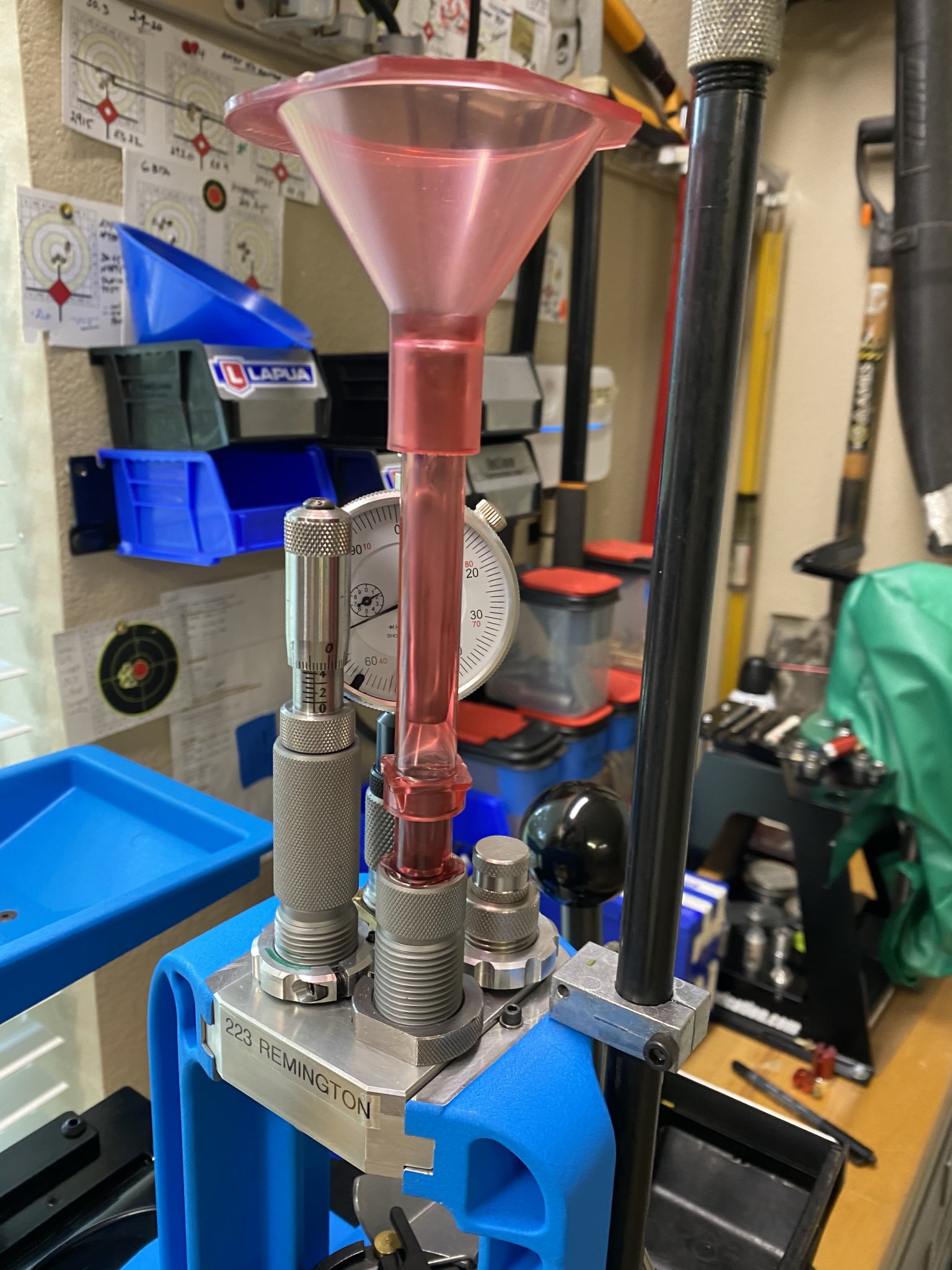

TBH, I’ve tried most combinations, Dillon, Area 419, Hornady etc., and the Hornady LNL Powder Funnel Die works best for me. Plastic has one major advantage - you can see through it. Every combination I’ve tried will bridge, and you won’t know till its too late. The setup below rarely bridges, the long drop tube helps with compressed loads, and the LNL tube is much more stable than Dillons.
(P.S. I really like the 4th stage Redding Instant Indicator to measure every round as it comes off the press)
Reactions: Gustav7 and ormandj

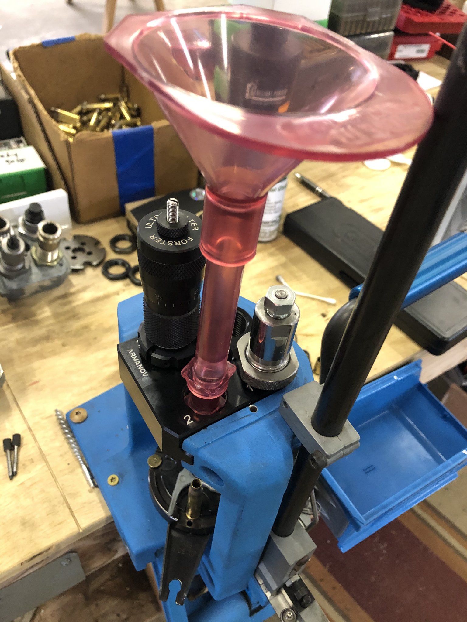

Haha I came down here to post basically the same thing. I've tried a few different funnels and the cheap MTM is what I use for 223 and 6.5 now. Although I don't use a die, I just stick the funnel in the toolhead hole.
