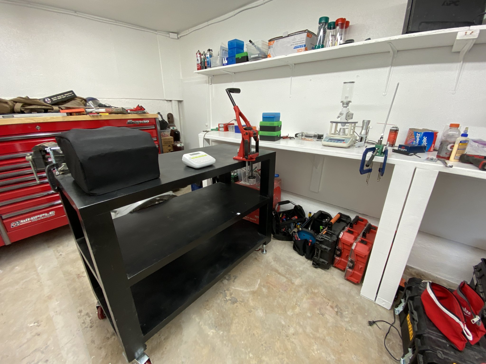

I got really sick of my press slowing down the AT or causing it to overthrow. So I put this black bench on casters that also have feet that screw down to firmly lock it in place. Then put the press on that.
When I’m not reloading I can just move the press bench out of the way for more room.
Or just move it around for optimal placement in relation of where the press is to the trickler.
