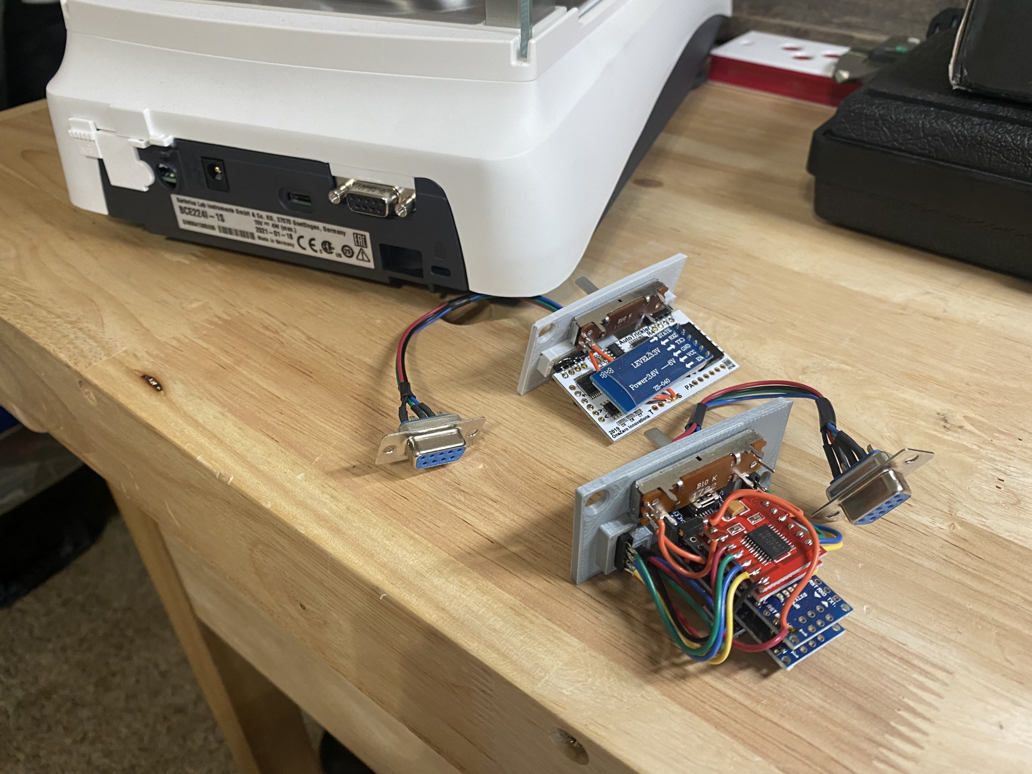

Ok guys… need a little help. I have a Sartorius scale, exact model Entris II BCE224i-1S, just like the one in this link:
Need help setting up a new to me autotrickler, V2 with V3 upgrades. I’ll post some pictures of the connections, the Autotrickler circuit board has a female plug, as does my scale, so not sure how that is gonna work, do I pull the plug off the autotrickler board and just plug in the wires in the same corresponding pattern? Or is there a separate Sartorius circuit board that I don’t have, that has the proper wiring? I’ll post some pics. Thanks!

Got it set up today, the new brain Adam sent plugs right into the scale and the manual he sent with it made it a no-brainer installation. Give him a shout and he can get you the right setup; so far this is looking really good, I tested initially with H4895 and it seems to throw the base charge very smooth even being a stick powder, and then trickles up pretty quick until it’s within about .5 grain and then slow trickles until it hits the designated charge. I believe this is going to get me within 1 kernel most of the time, a little more testing and I’ll know more; I have a dandy trickler that I could throw light with the autotrickler and then drop a couple kernels to be within 1 kernel every single time, but I don’t think that’s going to be necessary. I want to play with the tilt on the trickler a bit to fine tune the powder flow. All in all super happy, this is going to speed my process tremendously!!

Just got a new “brain” for it from Adam yesterday, going to try and get it set up today and see if that does the trick. Can let you know what I find out!

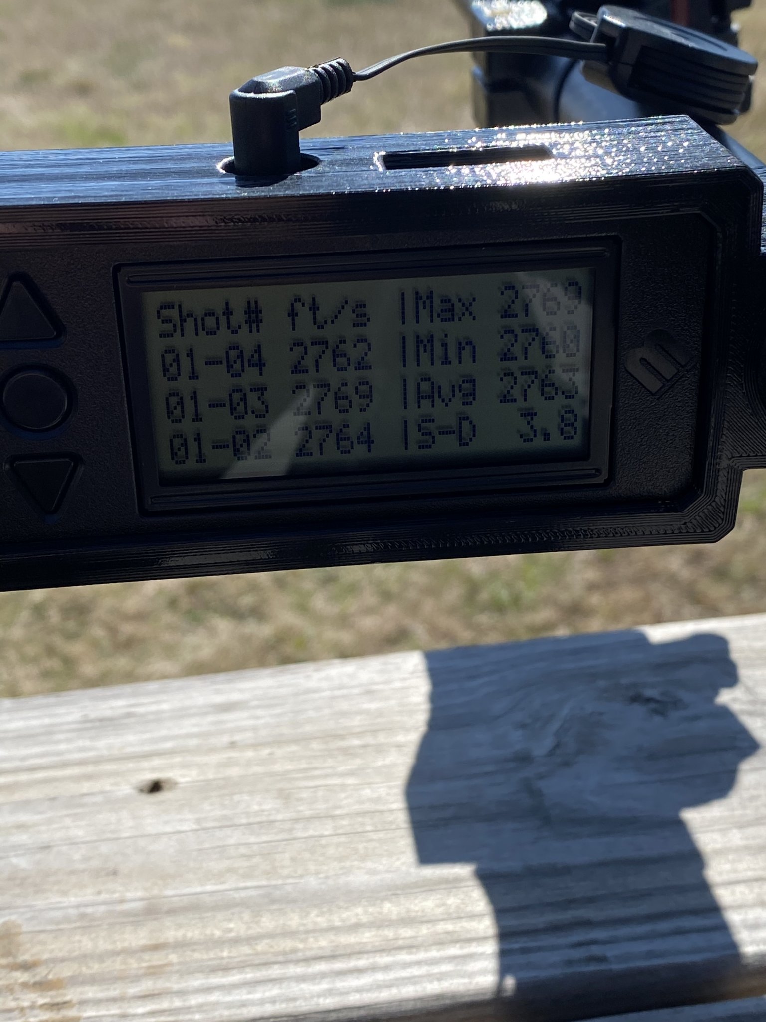

More shots will give you an idea on true ES/SD. For someone who shoots plenty of PRS matches I usually only chrono up to 10 rounds because that’s how many rounds most stages are. I use the Sartorious Entris 64-1S for weighing my loads and at a match where Applied Ballistics had their fancy radar I checked zero and fired 10 rounds with my MagnetoSpeed and got a SD of 2.7 around 2945fps with my 6 BRa. Couple hours later shooting a 10 round string with AB radar recording the results had a 3 SD at 2955. Anyone who used a MagnetoSpeed to get velocity that day all had velocities off by 10fps compared to the AB radar.
Really? That's interesting.... so with multiple people the magnetospeed wad consistently off by 10 fps or the two different chrono's just didn't agree with each other every time?
The MagnetoSpeed would show a 10fps slower speed that what Applied Ballistics radar would calculate for MV for every shooter there that day. Now here is the thing a 10fps difference in MV really has a negligible effect in the data you use for long range shooting. I still use what the MagnetoSpeed tells me because when I compared the difference on my Kestrel it didn’t really change my dope.

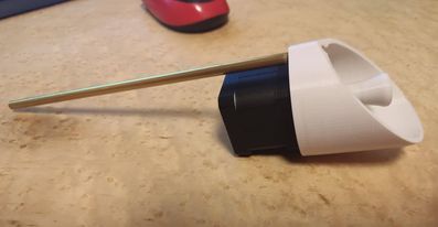

Have a V2 on entris64 and its slow on the trickling part , so kinda wanted to speed things up with disk type thrower like used on Prometheus , first try is just a 3d printed part , with 3d printed disc that has kernel notches at 20° interval . Anyways once i hooked it up to unmodified V2 it was way to fast and noisy as fuck .will make one out of aluminum and reduce the kernel notches to 60 or even 90° intervals to cure overspeeding
View attachment 7911795View attachment 7911796
That's pretty cool, but have you thought about just getting an ingenuity trickler?
Will likely end up with Ingenuity trickler at one point, especially since Adam is not going to develop any more Sartorius compatible Autotricklers. But as someone who develops own shit all the time i will still try DIY one for kicks
