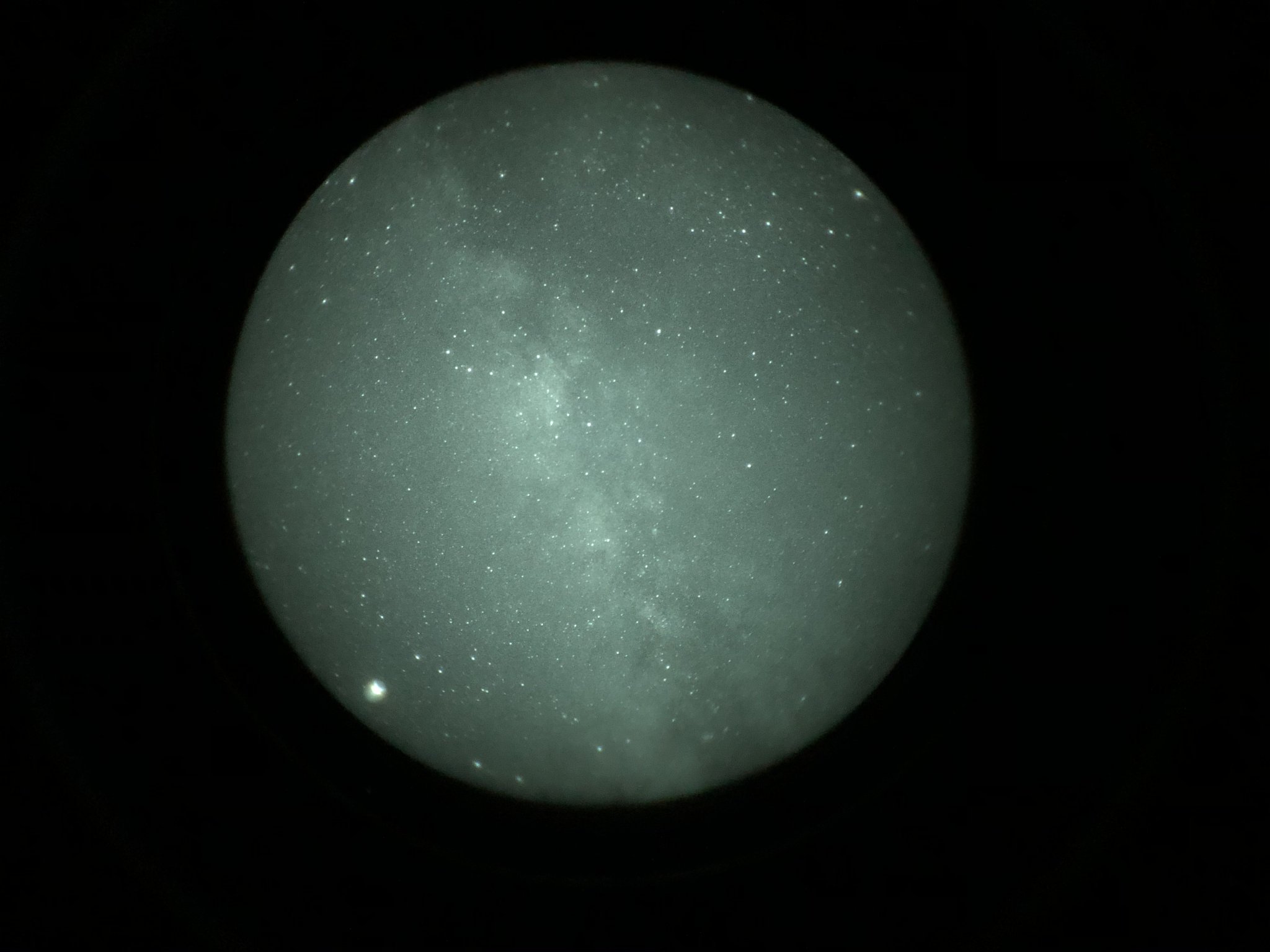

I know this isn’t really answering the OP, but...
Monster tube specs are great, and we all want them, but the rest of the package is just as important. I have a set of DTNVGs that have solid ~2300 FOM L3 tubes. Nothing special, but nothing to sneeze at either. I was never really impressed with them, so they got a total of about 3 hours of use in the first 12-18 months of ownership. After talking to a buddy who is a bit of a low-key legend, I sent them to him. He worked some mystical mojo and also installed a set of super rare, very expensive bespoke optics.
Night and day. I prefer these over 31A’s and another set of dual tubes with ~2700 FOM tubes installed.
So, if you put bare tubes in front of me, of course I’ll take the better specs. But inside a well-tuned system, tube specs only tell half the story. Since I buy my toys with the intent of using them, and not with an eye toward resale value, I’m less influenced amd impressed by bonkers FOM numbers than I used to be.
I get it, and I concur with you. But without having the ability to look through systems and compare them the numbers are basically what I have to go off of.

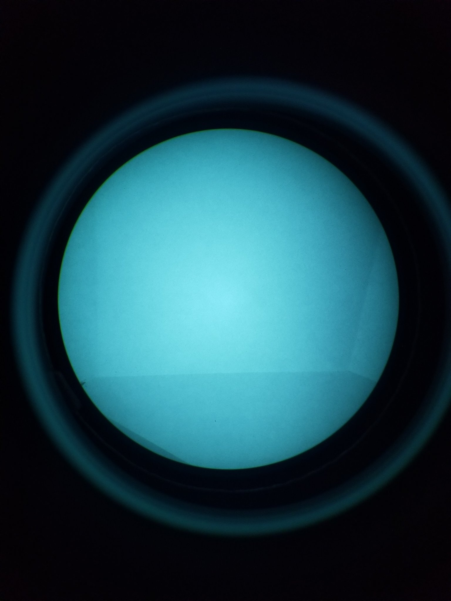

You seem pretty knowledgeable about tubes...what's the ghosting I'm seeing here? I can see it panningoutside, it's not illumination artifact. It's best seen at 0:10, over the upper corner of the doorframe. Video only kicked up a smaller section of it, but the tube there just seems...darker? In actual use, I can see a larger area there than the camera saw. No blurry or resolution issues, just...darker? Like I'm seeing a shadow.
Ill be interested to hear what otheres say. I just sent a tube back to be replaced because it was ghosting the line between trees and skyline. real bad. honestly I had a hard time describing it in a way that made sense. was almost like a coti like effect around the edge of the trees when i moved the nod side to side.
its hard to tell if thats what you have going on, but when you said ghosting that got my attention. I used those exact words in trying to describe it.
If there’s a fair amount of ambient light or your illuminator is on then you may be seeing a small amount of temp burn. Temp burn is typical, especially when the tube has just been powered on. After a few minutes of run time the temp burn effects begin to dissipate. Nate mentioned the tree line causing the same effect, thats very common. Some tubes are worse than others but it doesn’t hurt a thing and usually fades after a few minutes of being powered on.
Jay
Reactions: WhereNow&How
Jay
What mine did was very very pronounced and got worse over time. and it honestly didnt do it when I first got it. it was so bad it was a complete distraction and when it was doing it it seemed to reduce the resolution of the whole screen noticeably. I spent probably an hour trying to get a good video of it but due to having to move it and keep the phone behind it i just couldnt ever capture what was going on. was pretty disappointing, it was a 2850 fom tube. all the other specs were really rock solid. Ive not looked thru ALOT of nightvision but I did serve a little and may have peaked thru quite a few pvs14s back in my day. never had seen anything like this. sometimes it was treeline silhouettes sometimes it was everything with a hard edge outline. Ill also say, Ive had a very hard time putting into words what Im seeing in a way that other people understand. so theres that.
didnt mean to hijack, apologize. saw an opportunity to educate myself.
Jay
This seems to have been there since I got it (30 minutes of runtime ago, its newnew). I shoeboxed it yesterday for 4 hours, and am shoeboxing it again today for even longer. Could it just be a tube quirk? Will it worsen?
This is a close-up of the unit with illumination on (the lines are ceiling topography). Doesn't really show up unless I am panning/moving.
